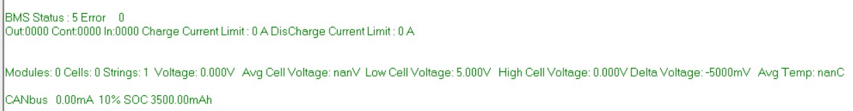

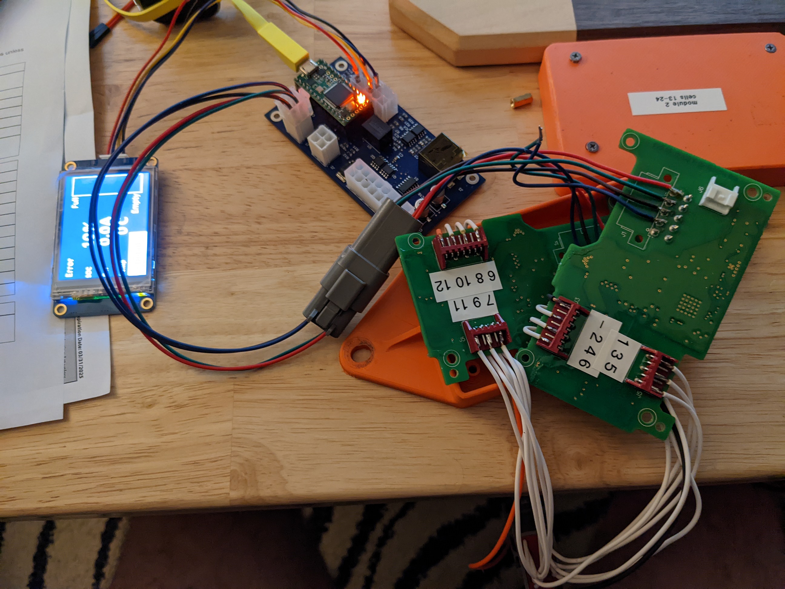

I got all 16 of my Model S BMS boards installed and started checking each individually. 1 of them is sending SimpBMS into an Error state. "Status 5 Error 0". So I took it out of the car to diagnose. all wires are hooked up correctly, but is there a way for me to further diagnose without batteries connected? or will I always get this error without batteries? The Setup manual makes me think voltages and temps can cause this to happen. am I misunderstanding something?
it's 2 boards wired in series to monitor a set of 12 cells. so i can't tell which board is acting up.
Posts: 2963
Has thanked: 330 times
Been thanked: 848 times
Re: Simp BMS
vwbrady wrote: Fri Jul 29, 2022 4:53 am "Status 5 Error 0".
This is the generic error message. But looking at the screenshot it clearly shows there is nothing connected but the bms is expecting how ever many cells you configured in the battery menu to be present.

tom91 wrote: Fri Jul 29, 2022 10:34 am
Ok, so this answers my question. I can't really diagnose without a battery connected. I really should have had a test battery accessible to test these as i built them up. Back under the car i go :\

vwbrady wrote: Fri Jul 29, 2022 1:52 pm Ok, so this answers my question. I can't really diagnose without a battery connected.
But you can connect any 6 cells that are wired in series and then you'll be able to check one board at a time, works well 😊

m.art.y wrote: Fri Jul 29, 2022 1:56 pm
i was thinking about doing that last night, but i thought there was some chance i could figure out what was wrong without them. When hooked up to the battery in the truck i get the same exact error.
i'll just grab some batteries i have handy and see what happens.

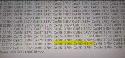

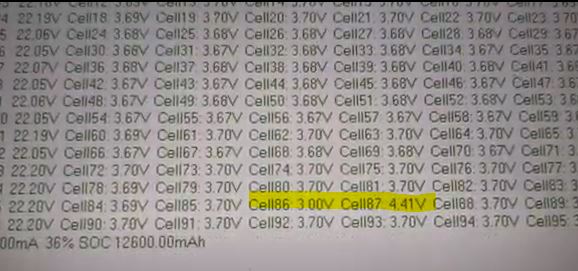

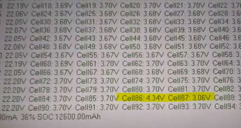

LRBen
Posts: 608
Location: Somerset, UK
Has thanked: 122 times
Been thanked: 290 times
Re: Simp BMS
Post by LRBen »
I'm getting some odd behaviour when balancing, this happened a couple times last week when I charged the battery every now and then. It has been balancing all week fine. Today I swapped out the Isashunt and his behaviour came back.
At first I thought it was another bad board, but it wasn't showing any errors. So I raised the balance threshold above all the cell voltages and the reading went back to normal.
not balancing.png (2.32 KiB) Viewed 10573 times
When I balance two cells bounce back and forth.
balancing 2.png (2.71 KiB) Viewed 10573 times
balancing 1.png (2.72 KiB) Viewed 10573 times
Could this be another bad board or something else?
Edit: I believe this may be another bad board. Just measured the cells manually and the readings for those two cells when there is no balancing is off by around .2v Will swap in another one and confirm.
