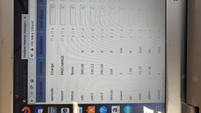

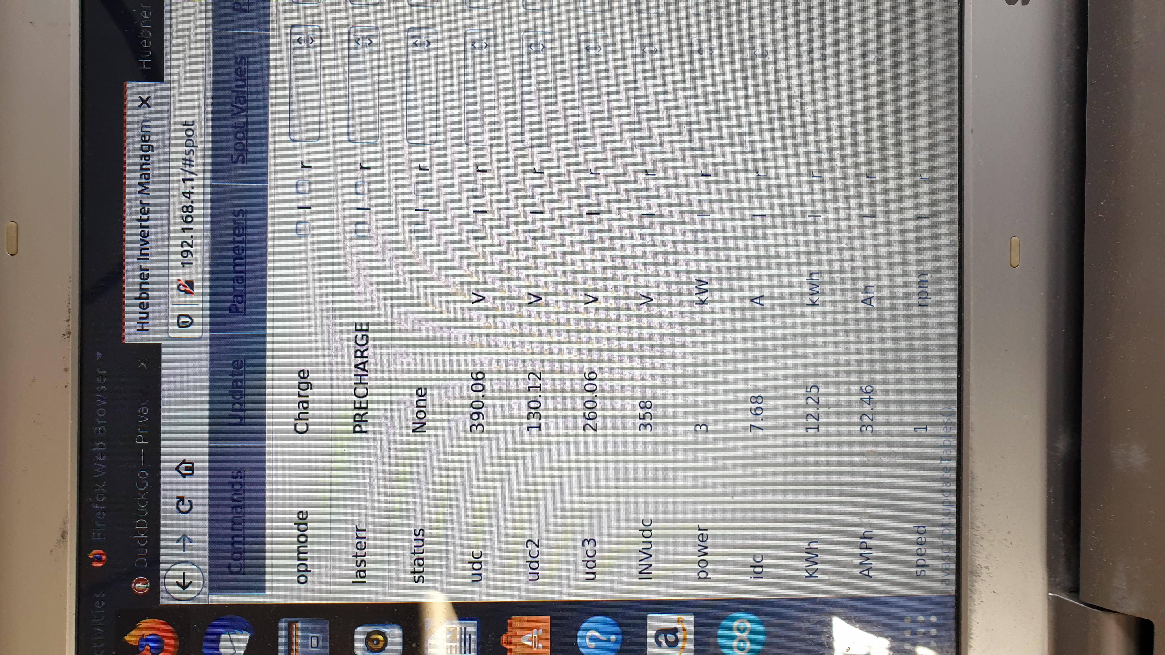

Finally some progress. Just did a push to the repo.
-Fix ISA voltage bugs.
-Change to floats on ISA params.
-Add charge mode HV control.
-Add HV on/off via web interface for testing.
-Fix Leaf INVudc reading.
-Added kWh and Ah display from isa shunt.
Not tested in a car as yet due to weather. turned out my ripped off evtv isa functions were waaayy over complex so simplified those down quite a bit.

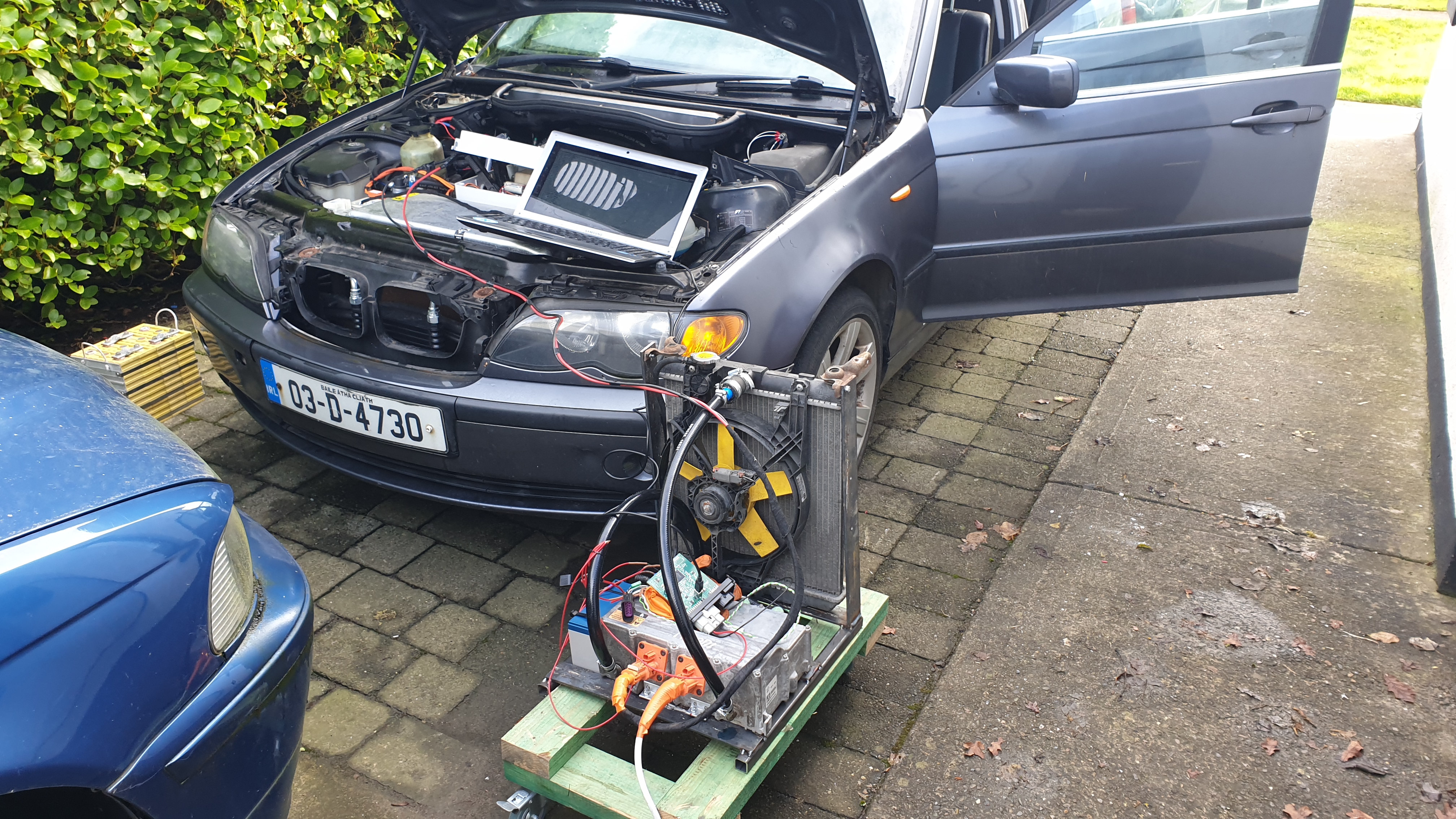

Charge mode now up and running and tested in the E46. Also ISA shunt data in float format is making sense. Think I'll add a delta voltage parameter.

Well, we have a regen tester :
Some interesting lessons :
1) Seems we can run non gen3 motors with a gen 3 inverter (estima starter generator in this case) which seems to be a gen1 motor.
2)It made monster torque in fwd but almost none in rev so I broke out the grinder and welder instead of the c compiler.
3)Running at 150v in the video it cranked the living s%^t out of the LT1 with only a smidge of throttle
Next up : Lexus mgr in the blue E39:)

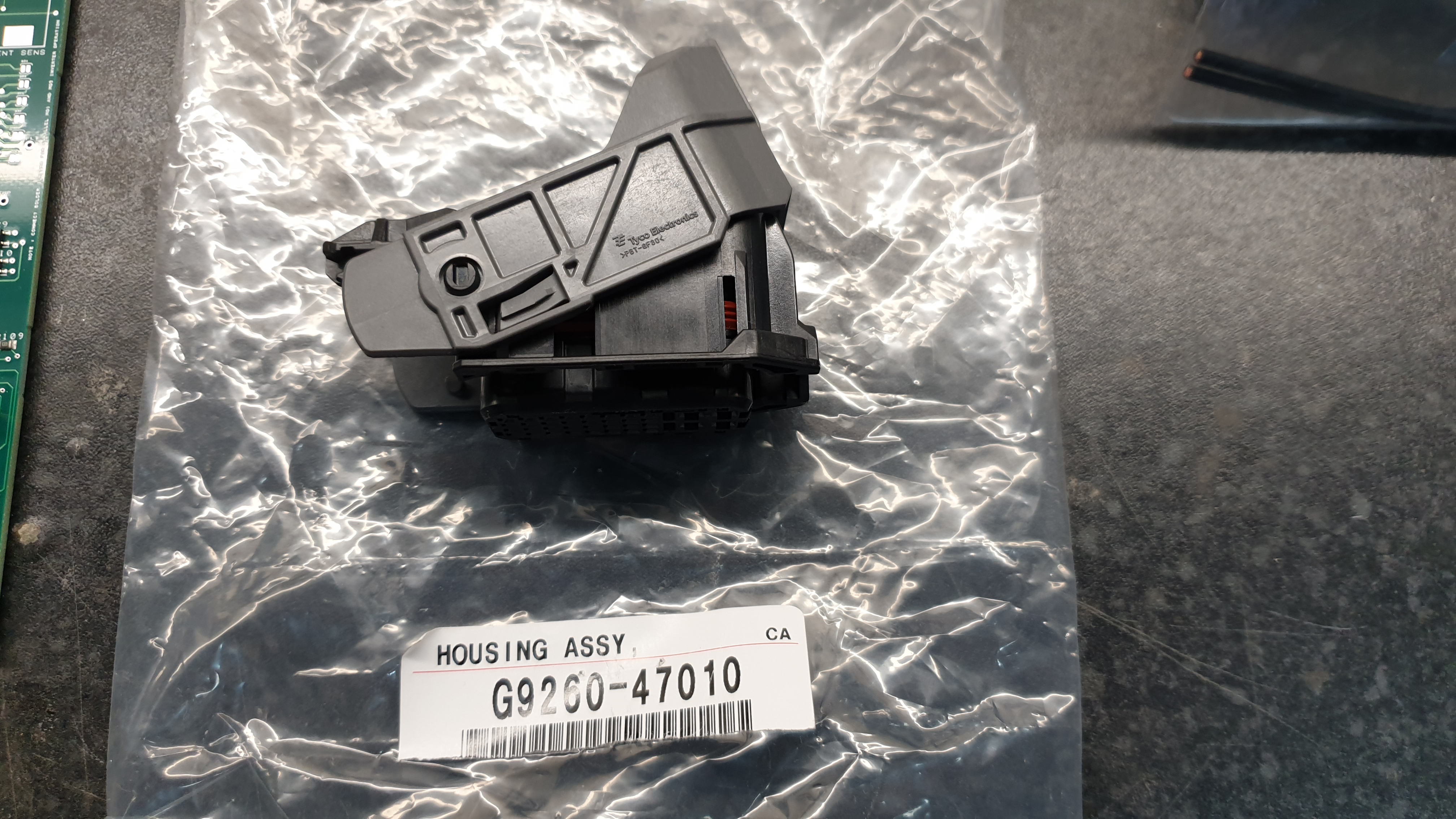

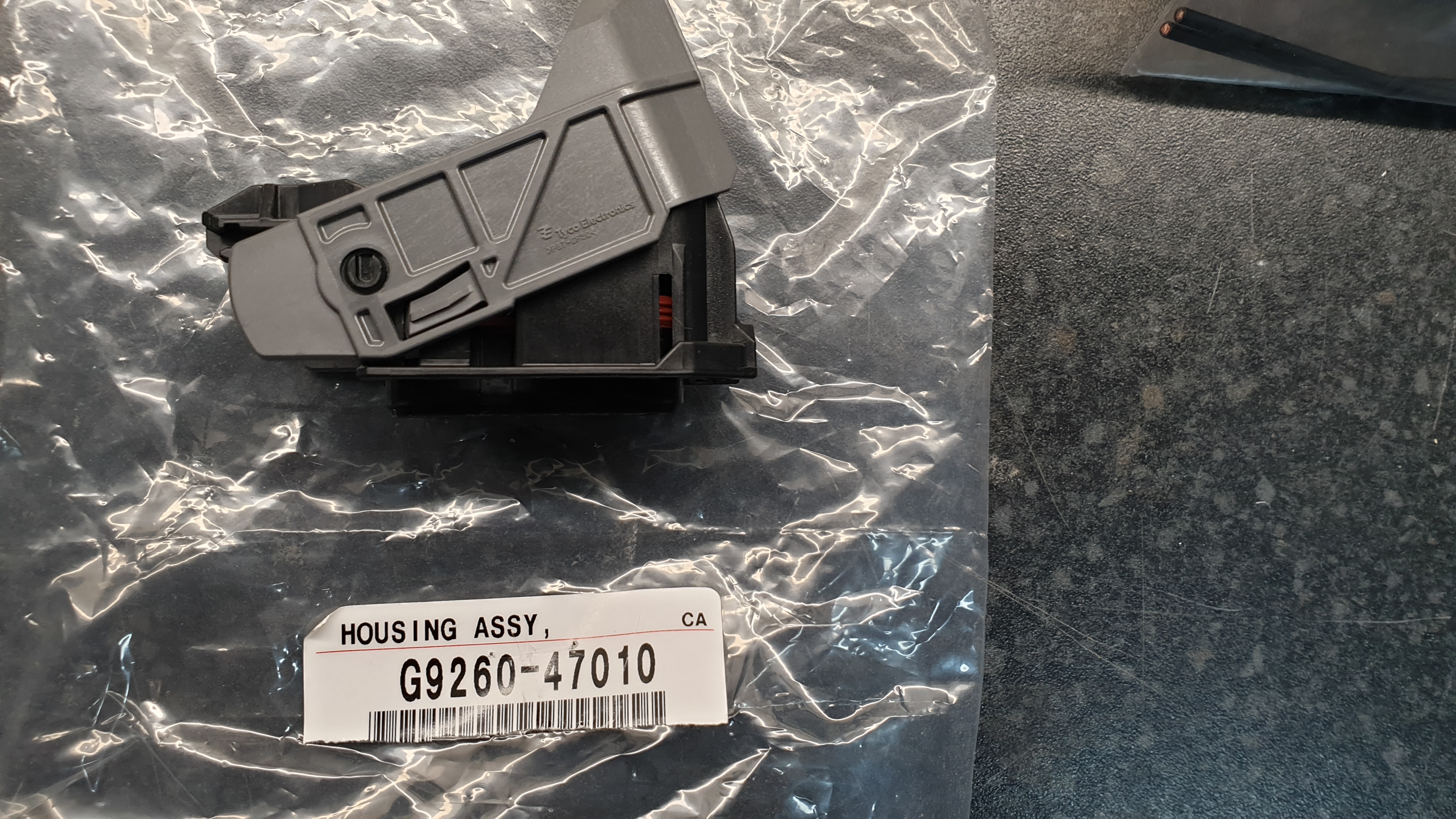

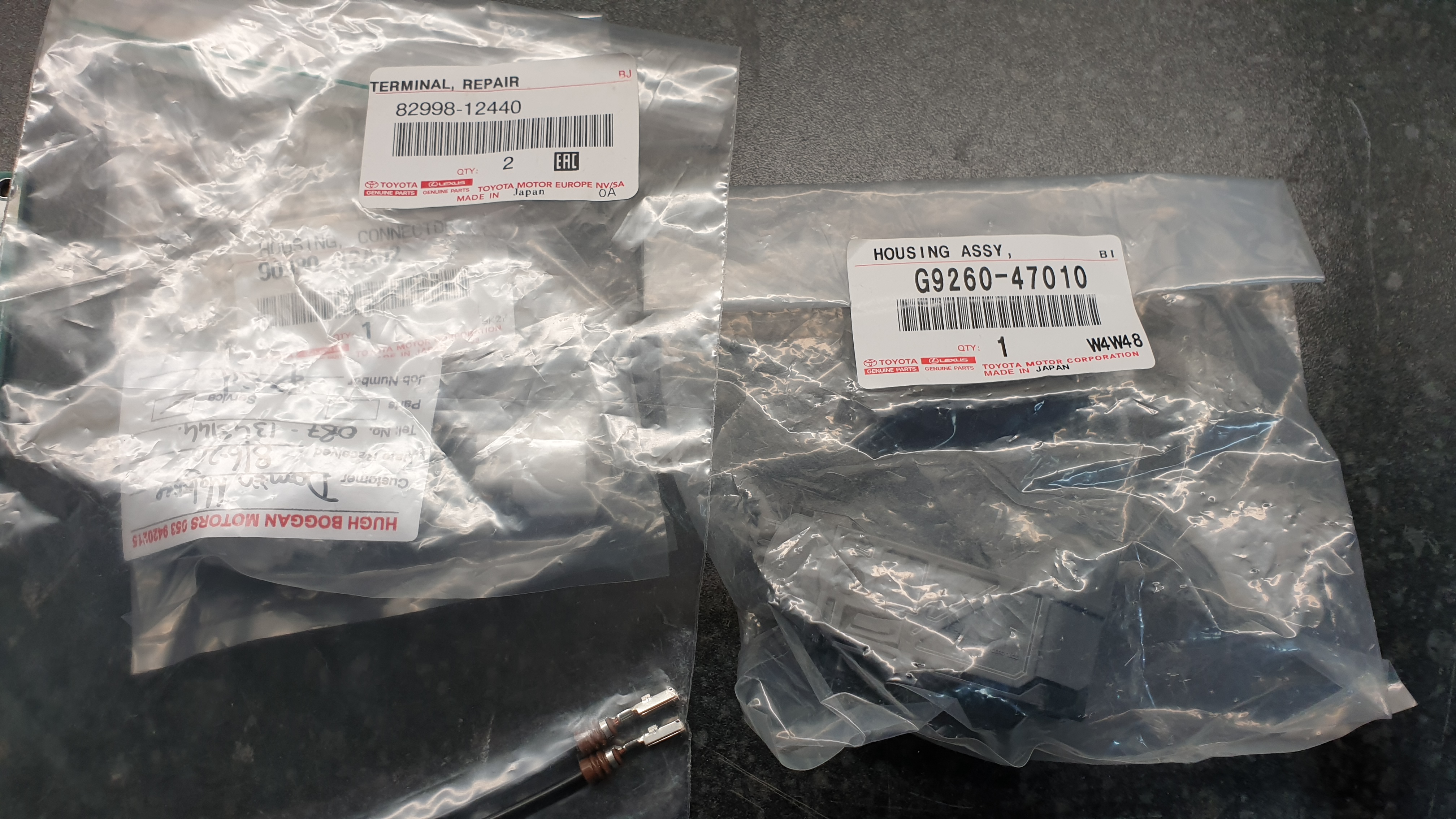

Here are some connectors and Toyota part number for connecting to the Prius/Yaris gen 3 inverter. Still need to find the tails for the small signal wires and the resolver plug.
Perfect, thanks for posting! So the repair wire is one of the main 12V/Ground connections to the inverter.
I'll see if i can identify a crimps for the smaller signal wires, i would guess the same crimp would be used for the resolver connector. I have measured the pitch of the connectors and they seem to be 3mm pitch. I guess from a manufacturing point of view they don't want to use too many different crimps, so they must be used in other connectors.
The larger repair wire (82998-12440), is listed here:- https://www.ih8mud.com/tech/pdf/WireHar ... pairwi.pdf
Looks like this is the larger crimp terminal https://www.bmotorsports.com/shop/produ ... ts_id/1762
Sumitomo TS 2.3II Female Terminal
It says that its a 6mm pitch on the larger terminals.
If the whole connector is Sumitono, the only crimp that seems close to the right pitch for the signal wires is the type 1.0II or 1.0III, which are 1.8mm wide...

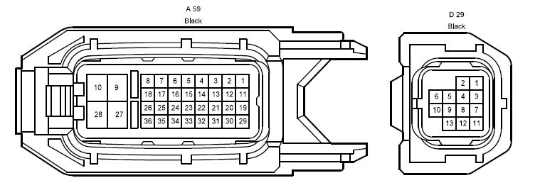

Here's the Pinouts for the GEN3 Toyota Inverters, we will probably move these over onto the wiki when there is some time.
gen3 pin out.xlsx- (37.3 KiB) Downloaded 230 times

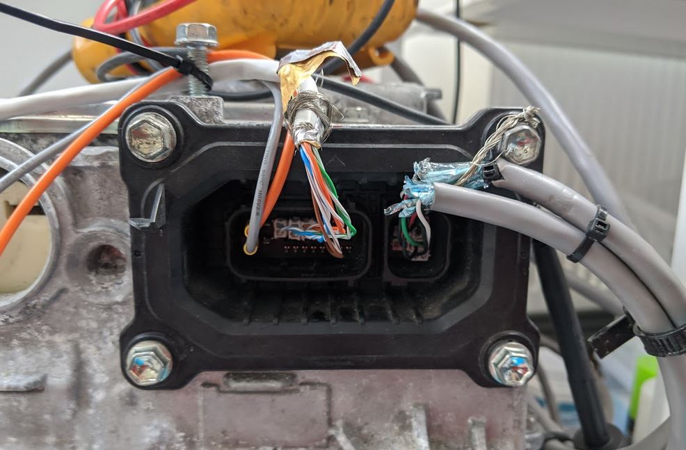

I got the Yaris converter connected up and it seems to be outputting a larger MTH frame, which is 2.8mS long rather than the 2.4mS. I haven't had a chance to connect up the FTDI Cables yet, but this to me would mean that the MTH frame has increased from 120 bytes to 140 bytes on the Yaris.
The part number of the yaris inverter i have is G9200-52031, i knew i should have got the Auris one, but this one was too cheap to pass up!
OK so i bumped up the MTH frame from 120 to 140 bytes and i now have valid frames coming in from the yaris inverter!
