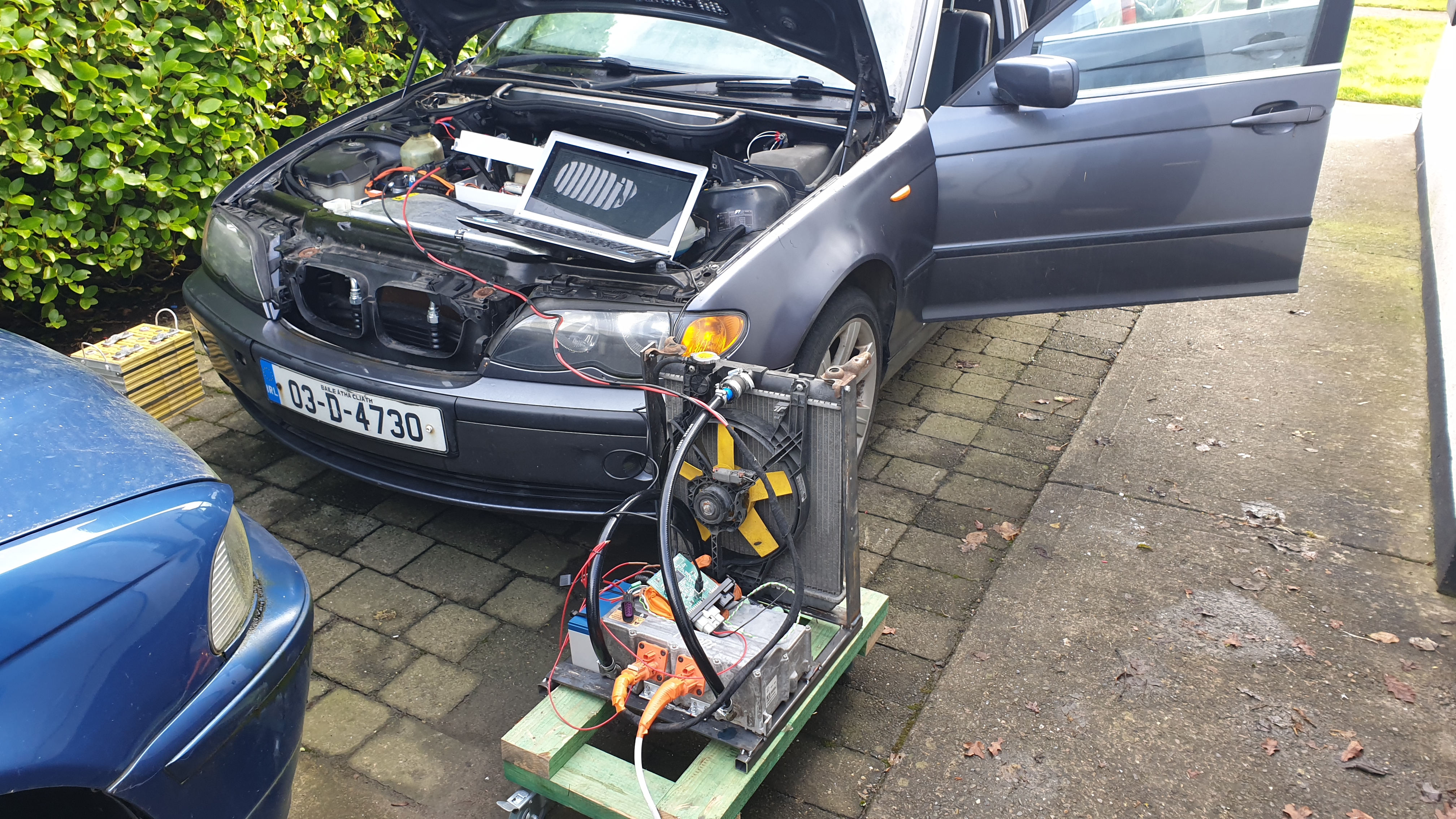

Charge mode now up and running and tested in the E46. Also ISA shunt data in float format is making sense. Think I'll add a delta voltage parameter.

Well, we have a regen tester :
Some interesting lessons :
1) Seems we can run non gen3 motors with a gen 3 inverter (estima starter generator in this case) which seems to be a gen1 motor.
2)It made monster torque in fwd but almost none in rev so I broke out the grinder and welder instead of the c compiler.
3)Running at 150v in the video it cranked the living s%^t out of the LT1 with only a smidge of throttle
Next up : Lexus mgr in the blue E39:)

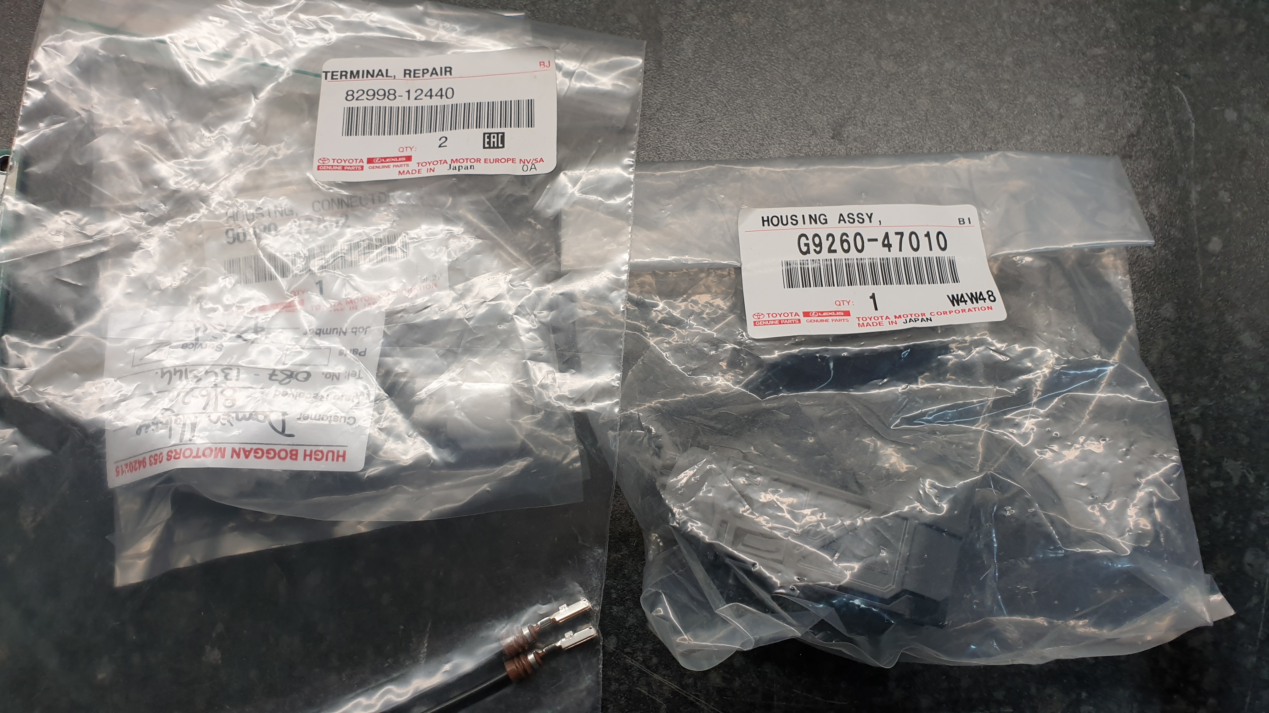

Here are some connectors and Toyota part number for connecting to the Prius/Yaris gen 3 inverter. Still need to find the tails for the small signal wires and the resolver plug.
Perfect, thanks for posting! So the repair wire is one of the main 12V/Ground connections to the inverter.
I'll see if i can identify a crimps for the smaller signal wires, i would guess the same crimp would be used for the resolver connector. I have measured the pitch of the connectors and they seem to be 3mm pitch. I guess from a manufacturing point of view they don't want to use too many different crimps, so they must be used in other connectors.
The larger repair wire (82998-12440), is listed here:- https://www.ih8mud.com/tech/pdf/WireHar ... pairwi.pdf
Looks like this is the larger crimp terminal https://www.bmotorsports.com/shop/produ ... ts_id/1762
Sumitomo TS 2.3II Female Terminal
It says that its a 6mm pitch on the larger terminals.
If the whole connector is Sumitono, the only crimp that seems close to the right pitch for the signal wires is the type 1.0II or 1.0III, which are 1.8mm wide...
