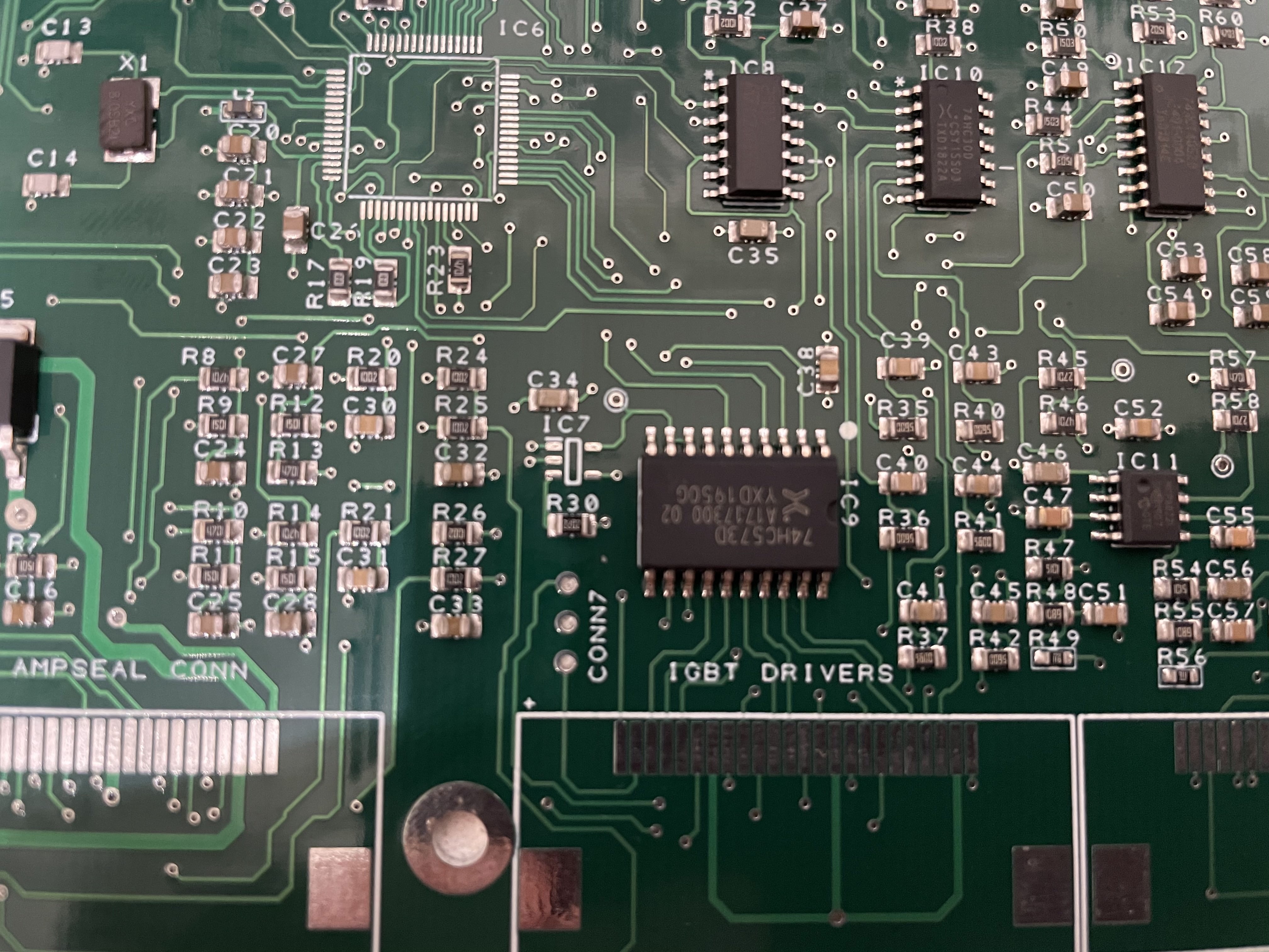

EDIT: The right part for IC7 is as follows: LTC1799CS5#TRMPBF
I think I might have found a Typo in the BOM for Tesla LDU V4b. I noticed that the OP amp part number on IC7 is a different package than on the V4b board.
Link to OP amp + Package info: https://www.arrow.com/en/products/mcp62 ... technology
It says its a 8 pin SOT package where as the board silkscreen and pads show a different package/pin arrangement.
