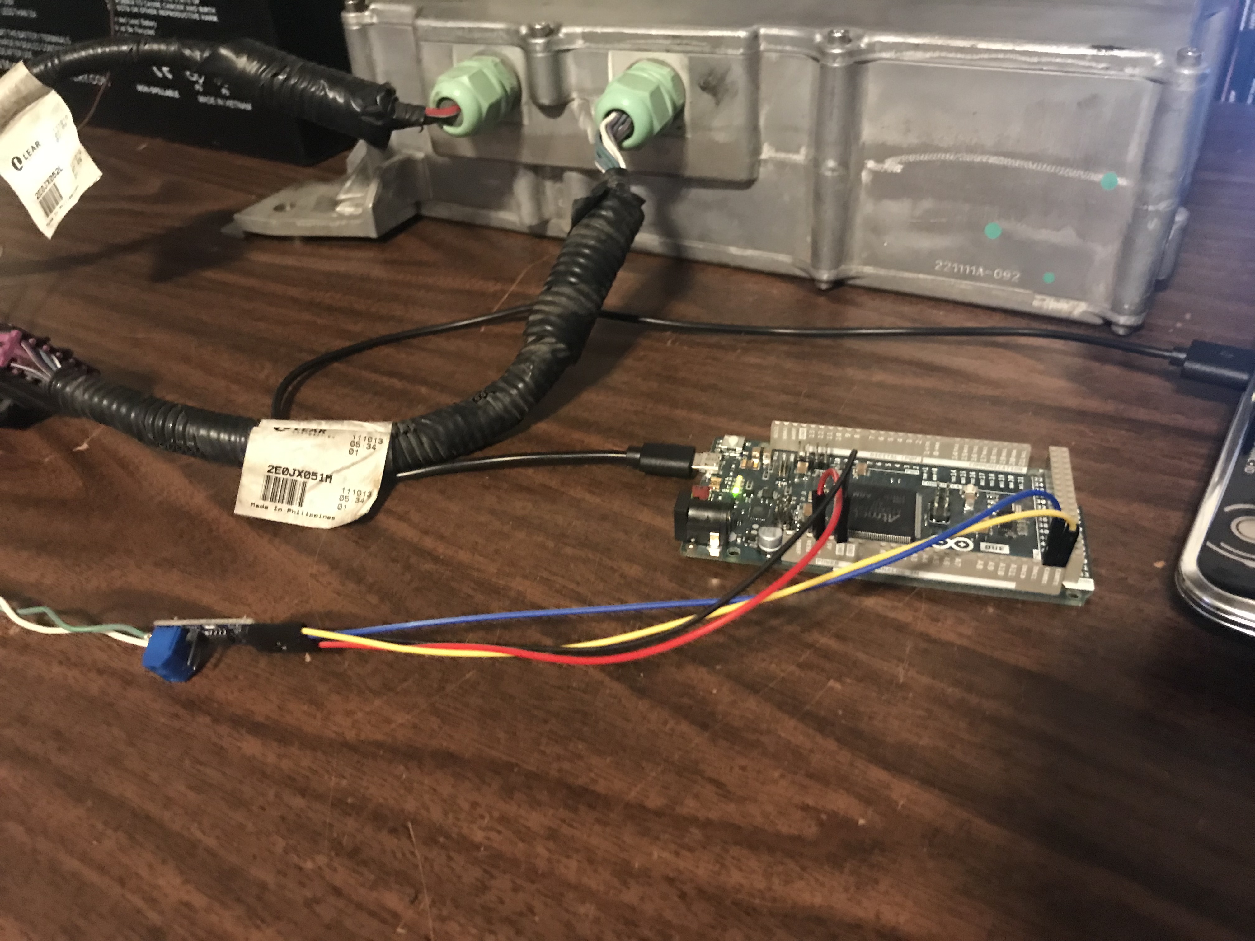

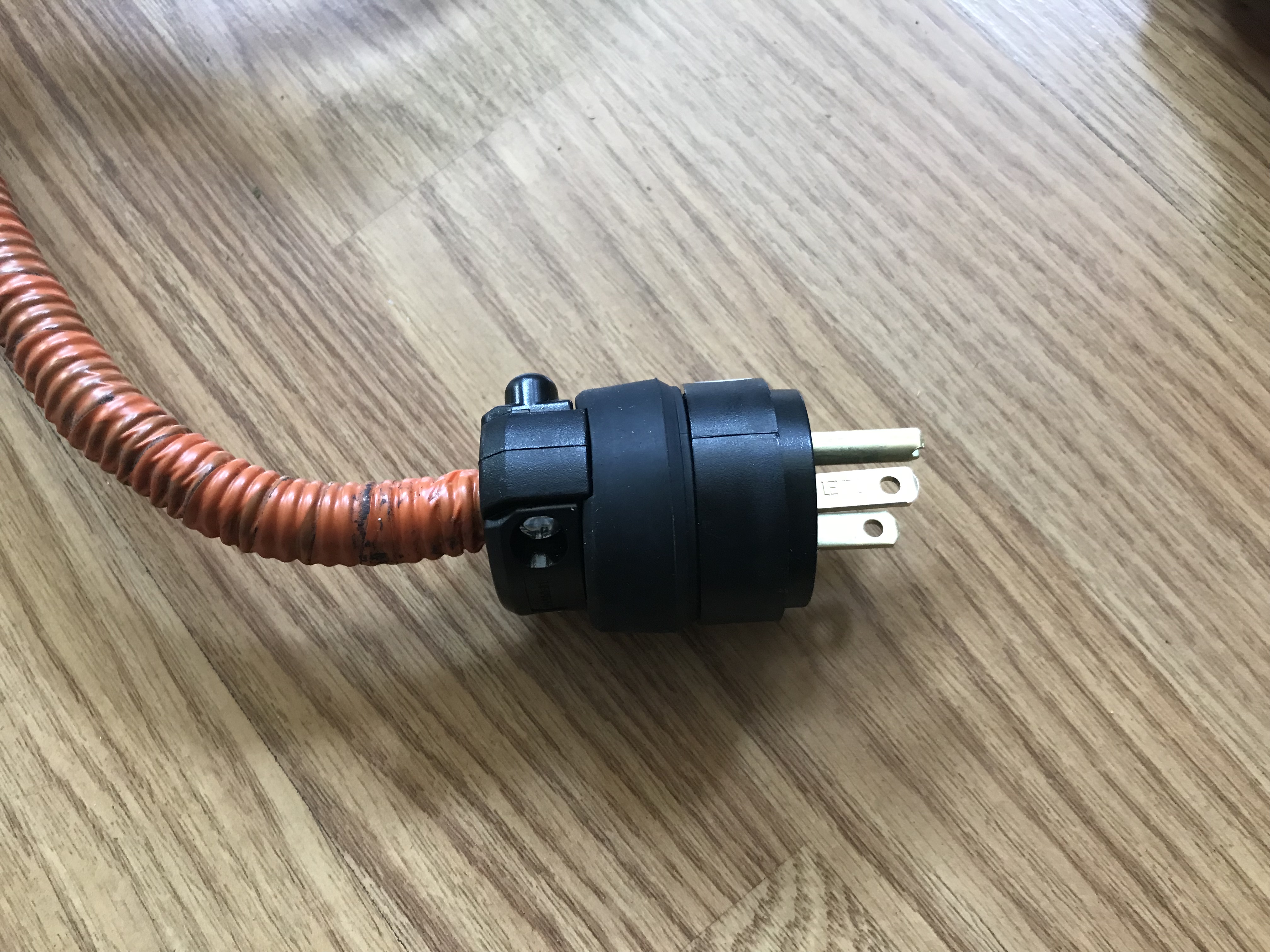

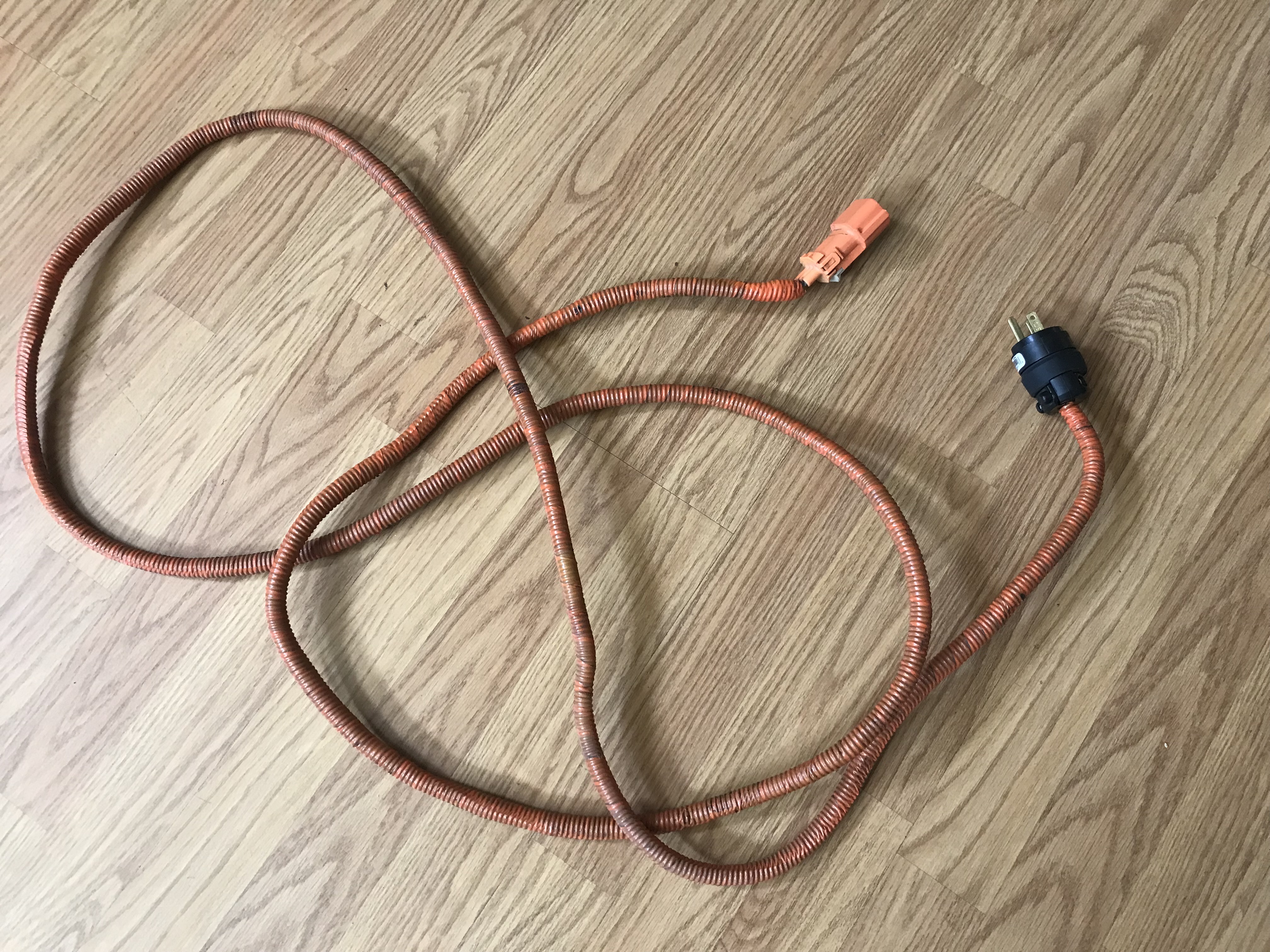

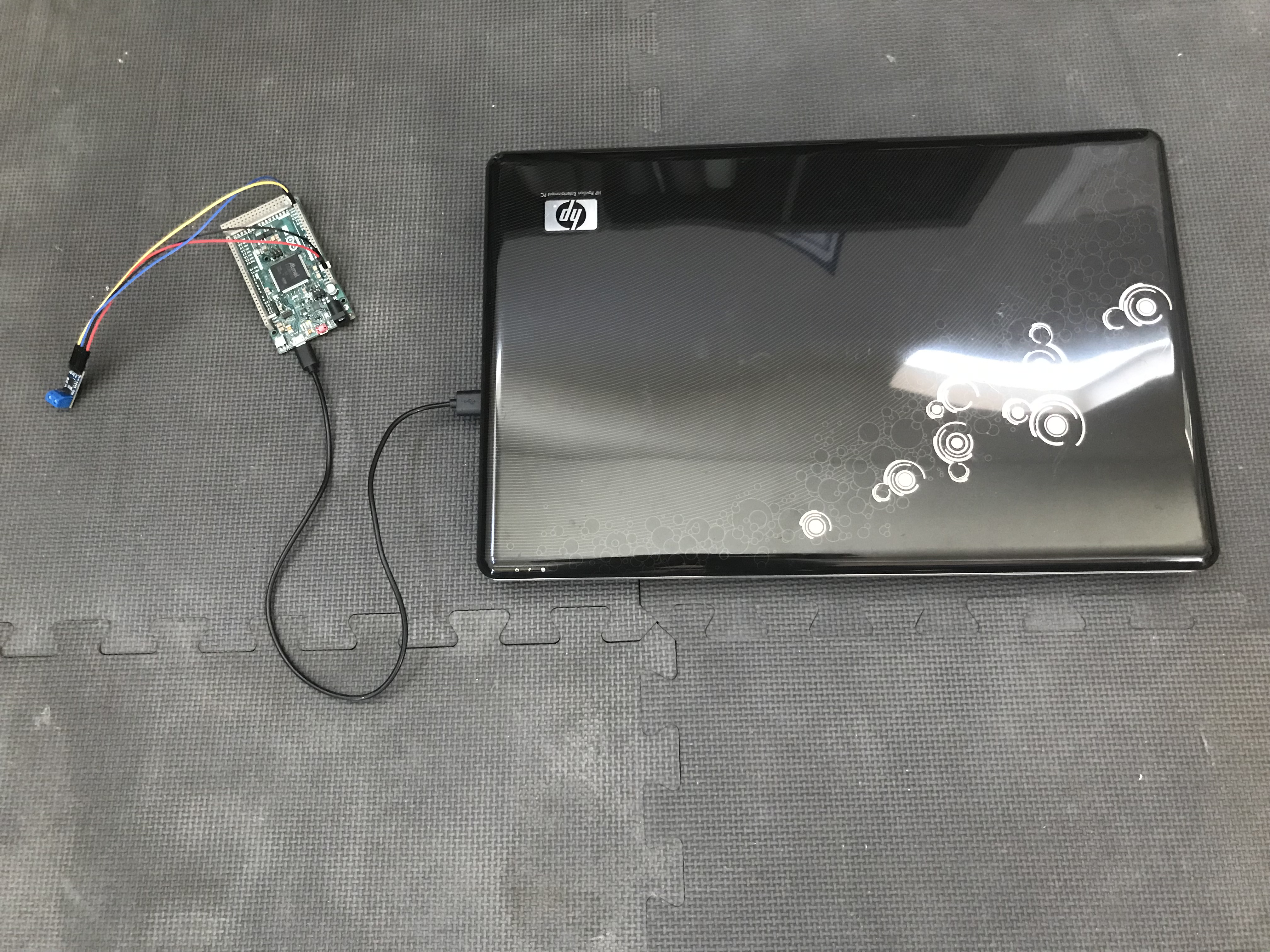

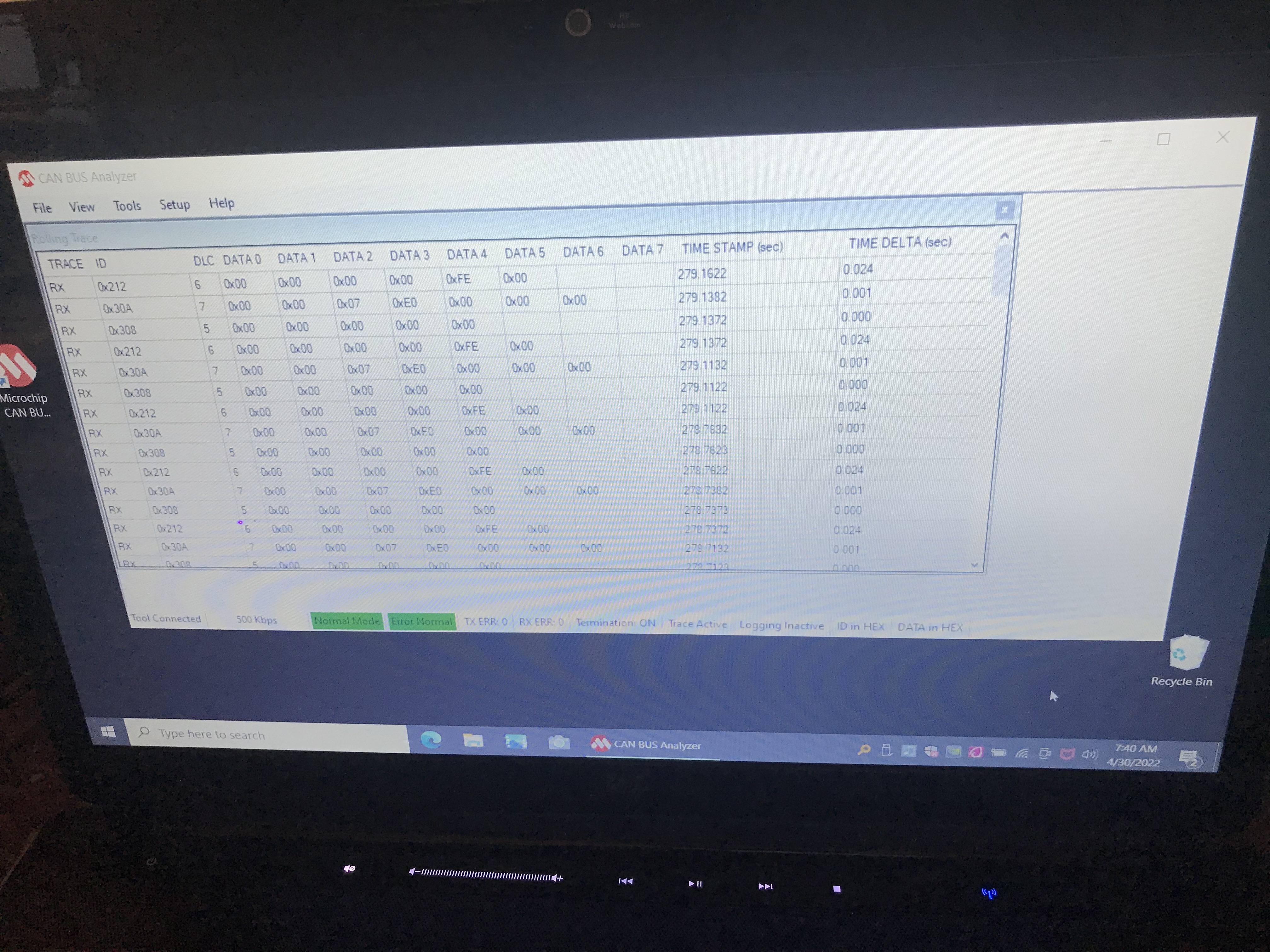

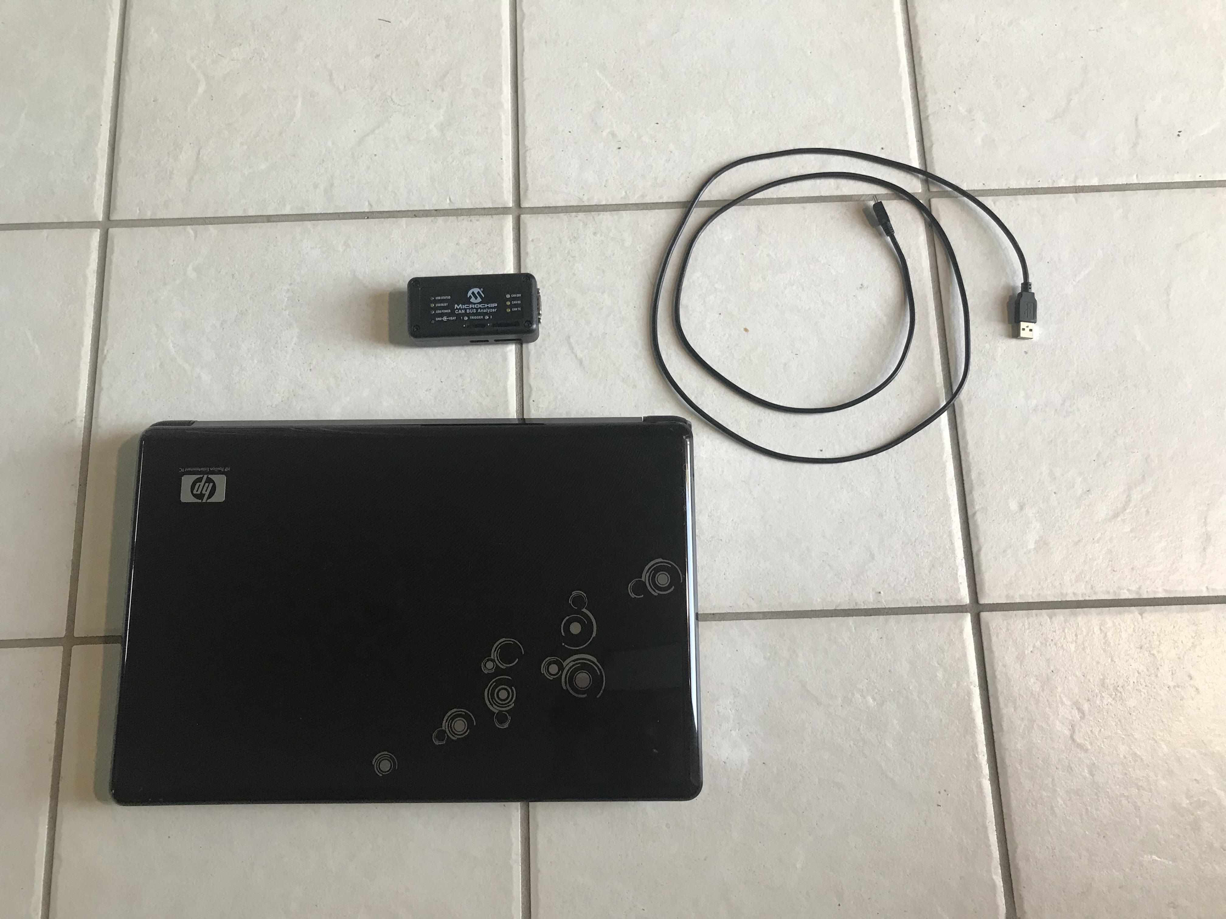

same concept here, just a bit less arcane USB cable
- Gregski
- Posts: 3157
- Has thanked: 628 times
- Been thanked: 1606 times

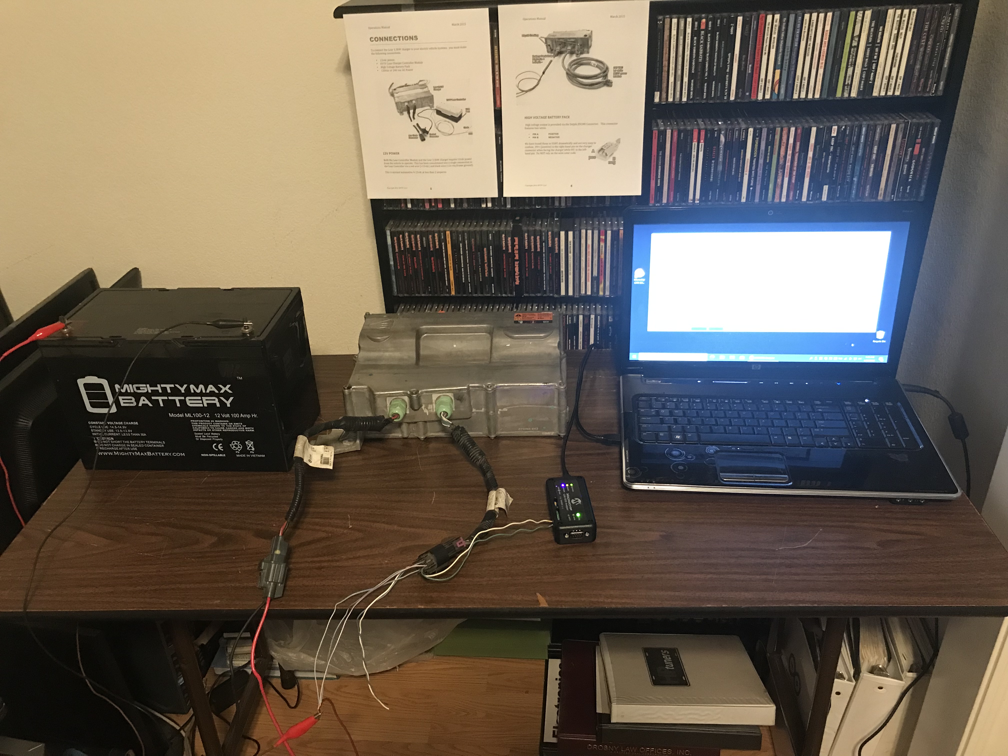

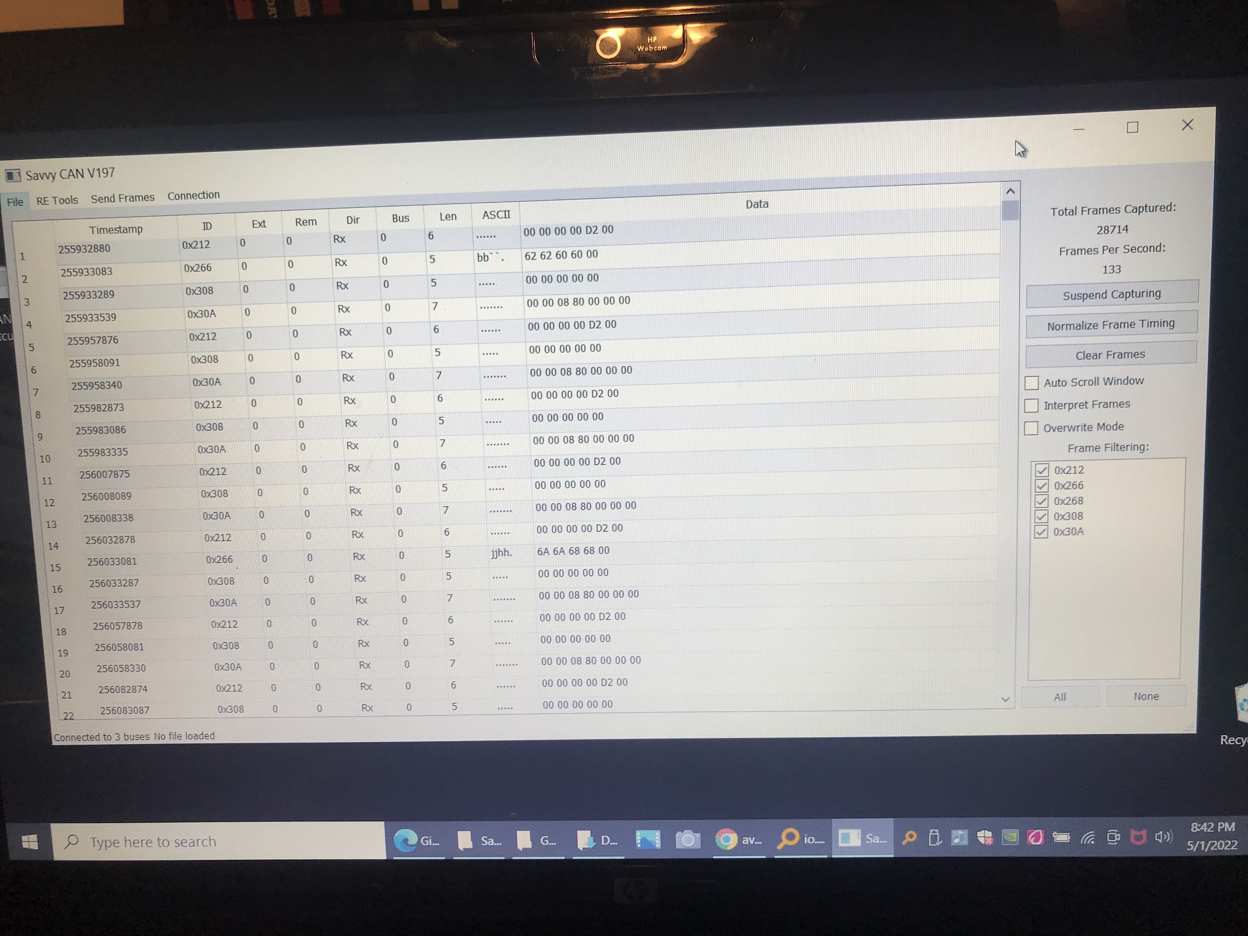

and just like that we were back to where we left off, but with a different CAN Bus analyzer tool, hopefully a more better one (at least this one has a manual)

So with the Microchip CAN Bus Analyzer, you're winning now?
It's just I want to get something to analyse can bus coms but not sure I want to spend $200AUD on one, but if it's superior and easier to use than other options then maybe I'll get one.

no sir, please check out that thread here: I think I CAN, I think I CAN...

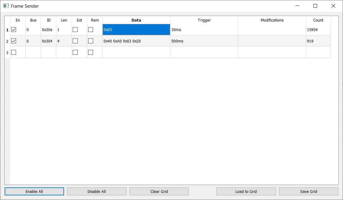

I even tried it with both, each analyzer responsible for sending only one message, and still no dice

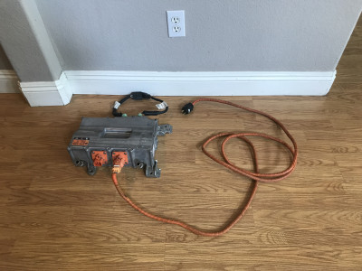

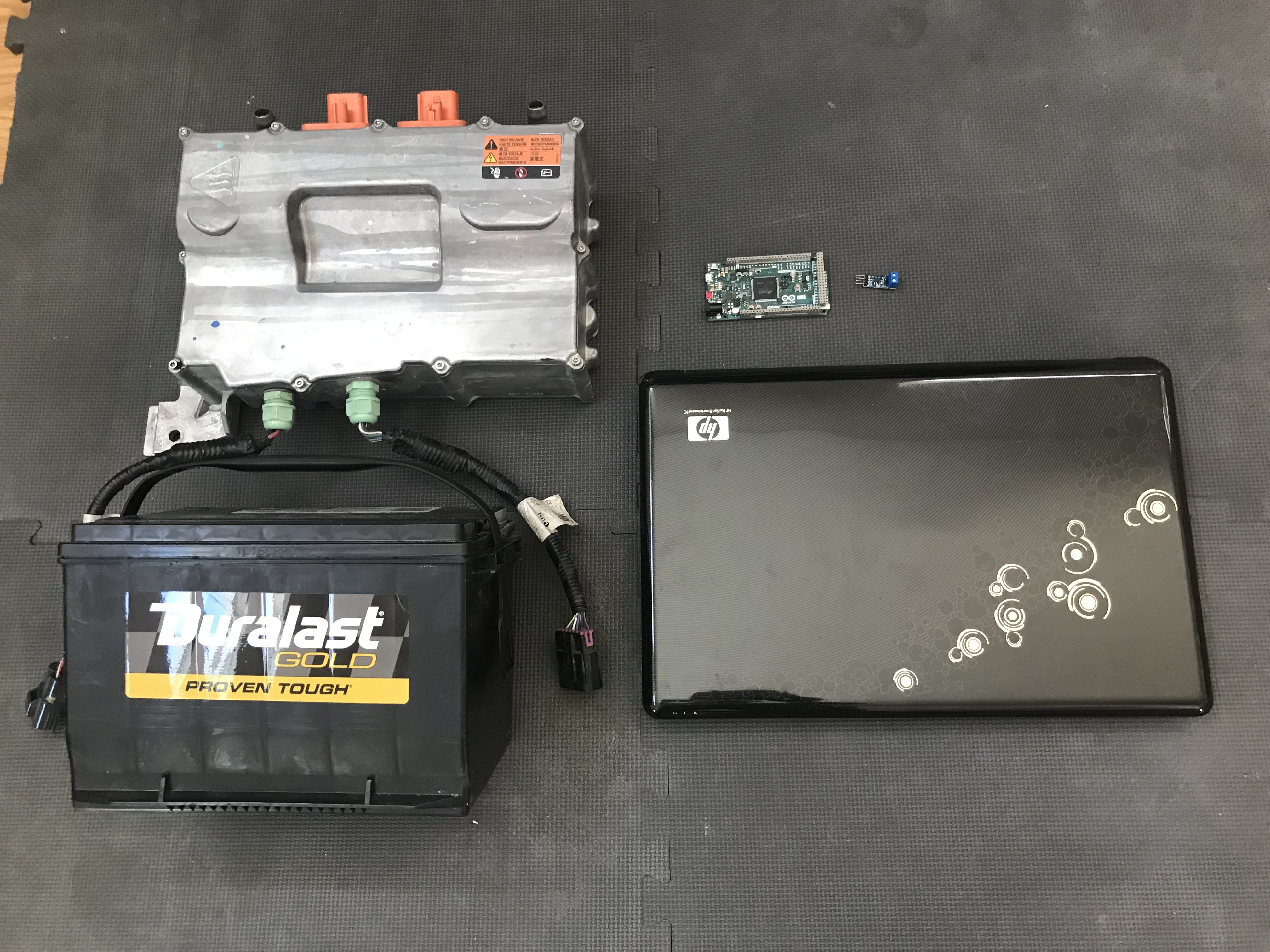

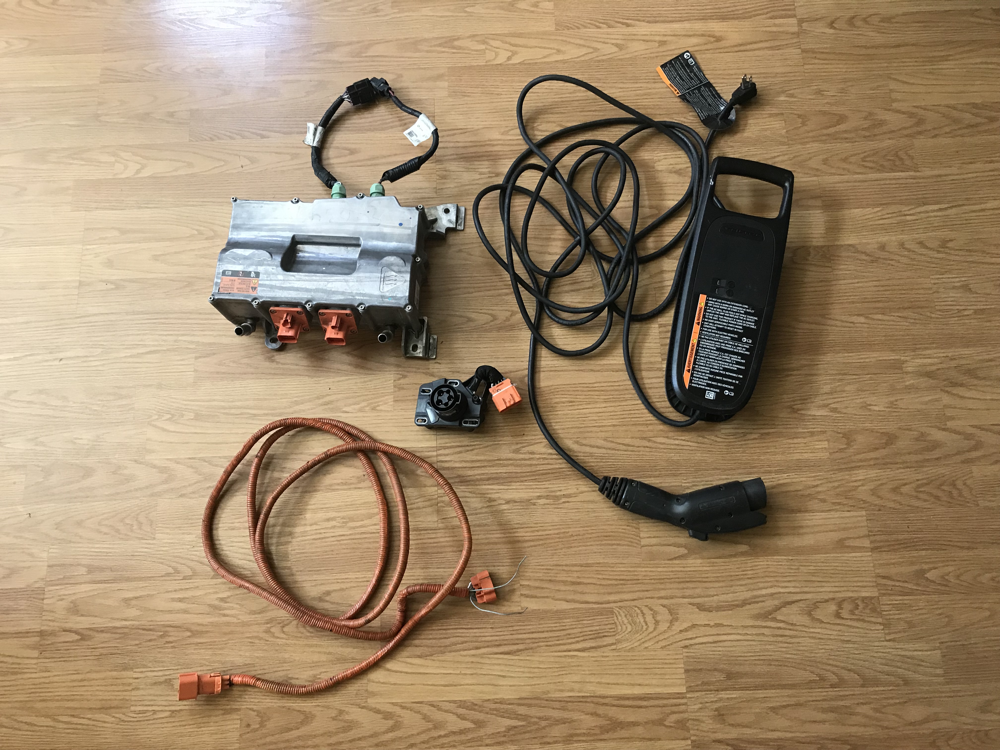

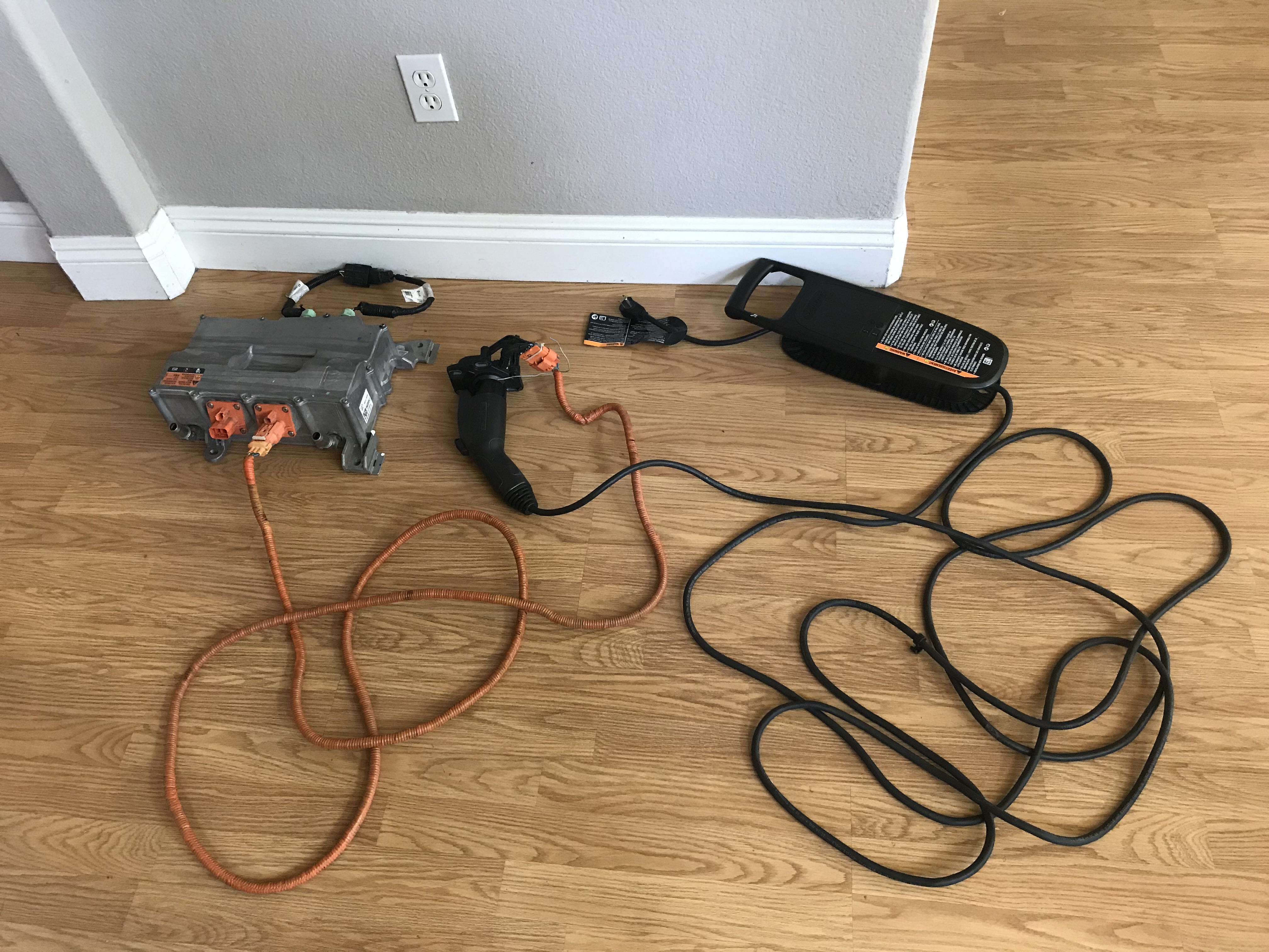

LESSONS LEARNED

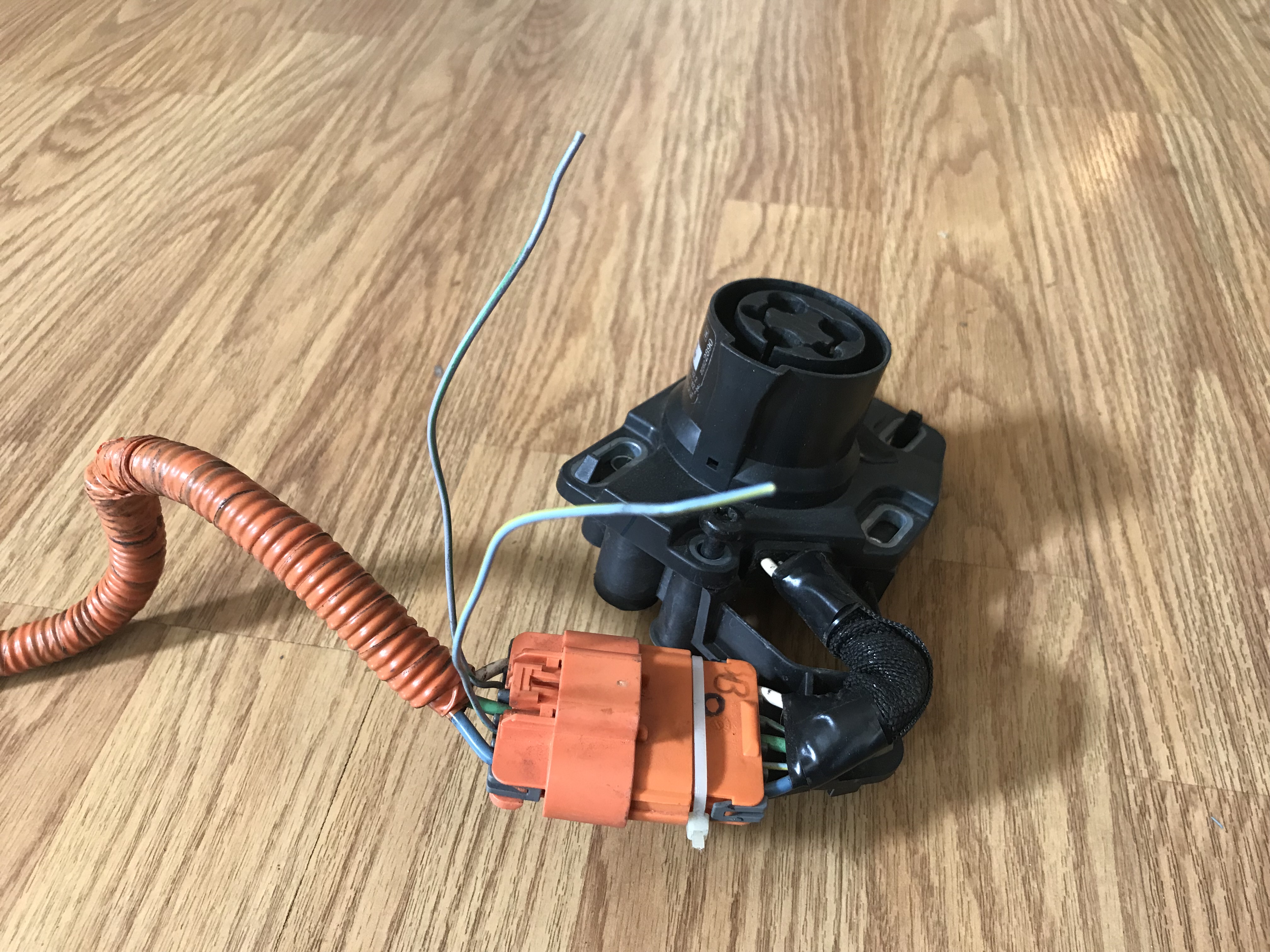

In the spirit of full disclosure thinking I would go out and buy a complete OEM Chevy Volt first gen J1772 charge port and wall charger, seemed like a good idea at the time, but i soon discovered it just complicates things, actually makes it impossible to control the charger, as the silly charge port or wall charger needs to be controlled itself do to the Pilot and Proximity connections

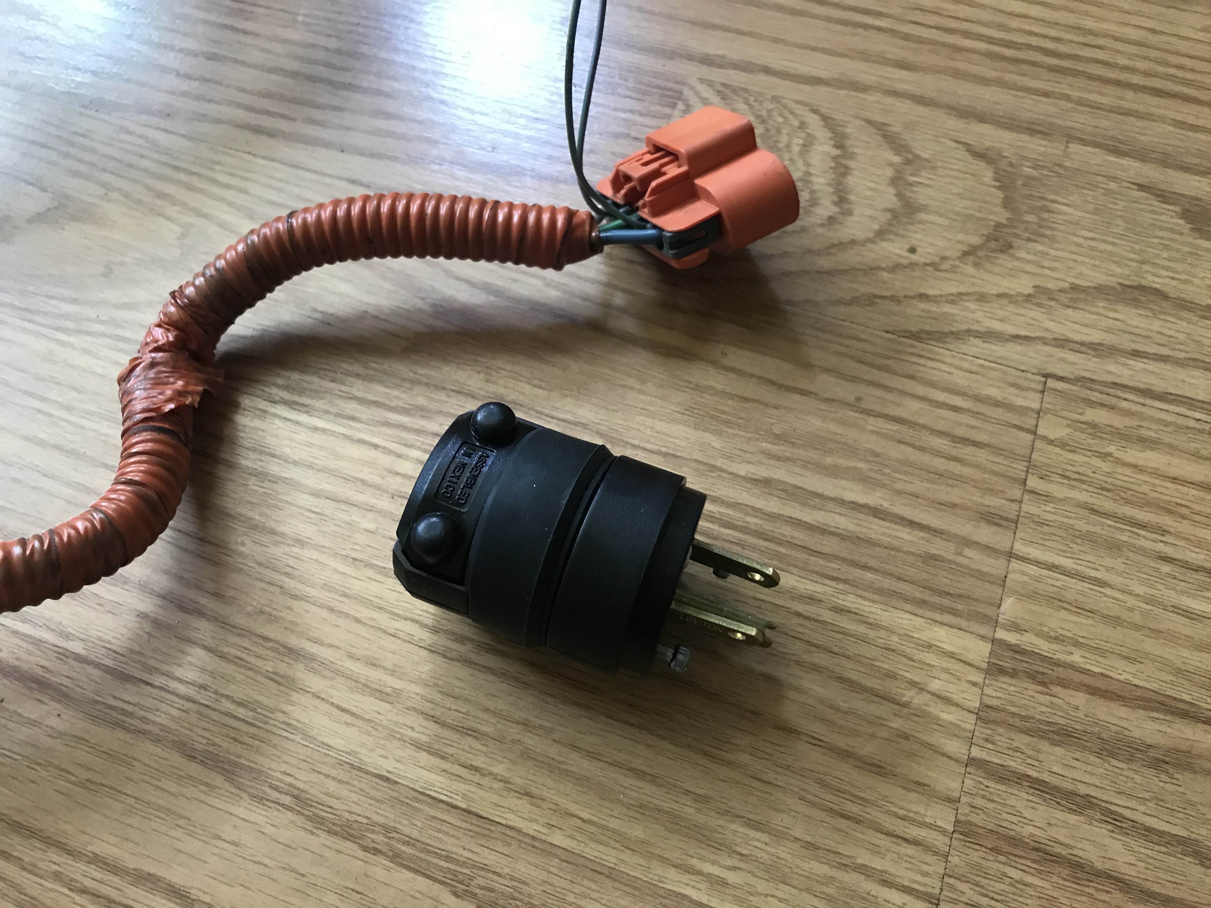

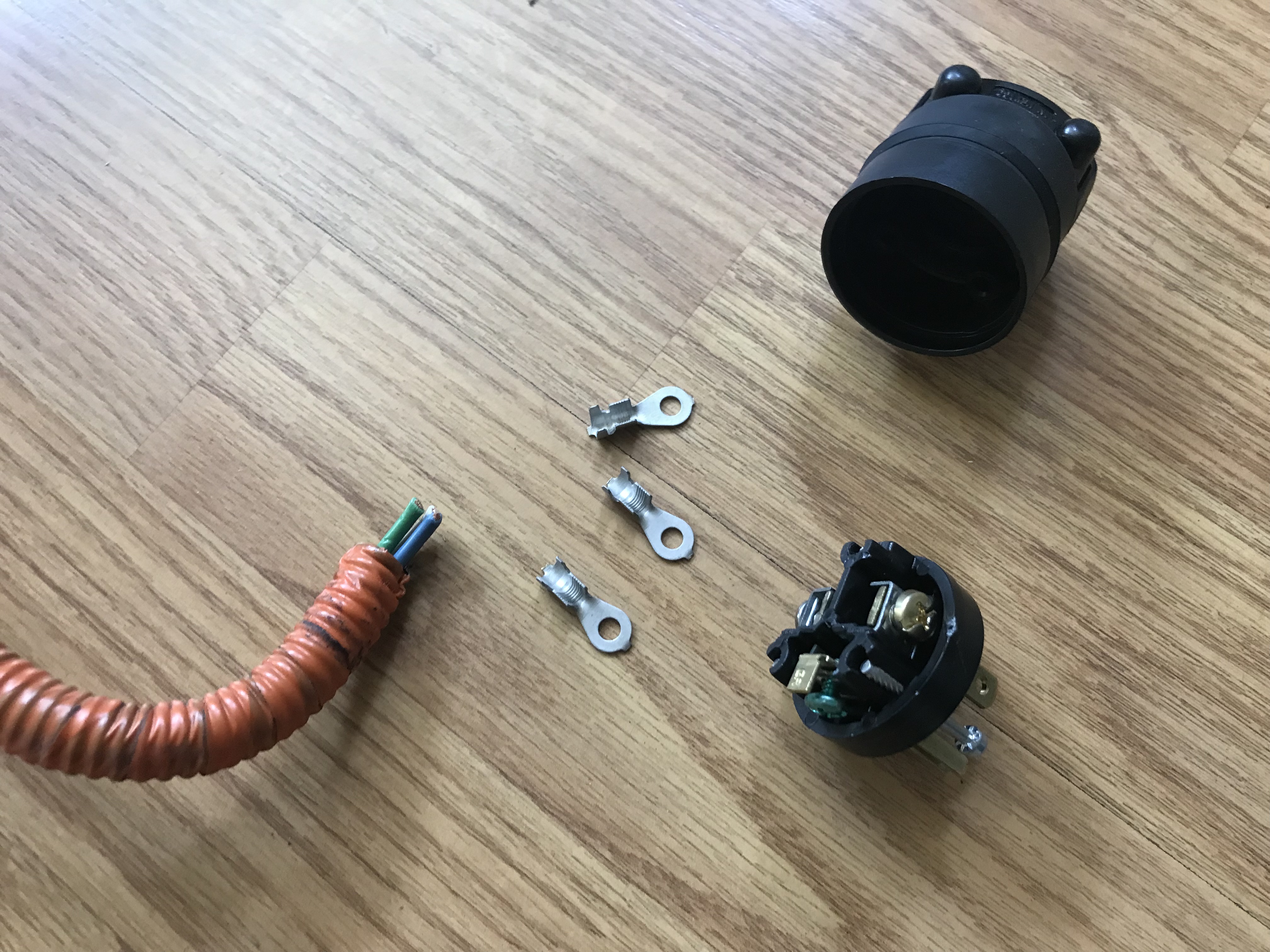

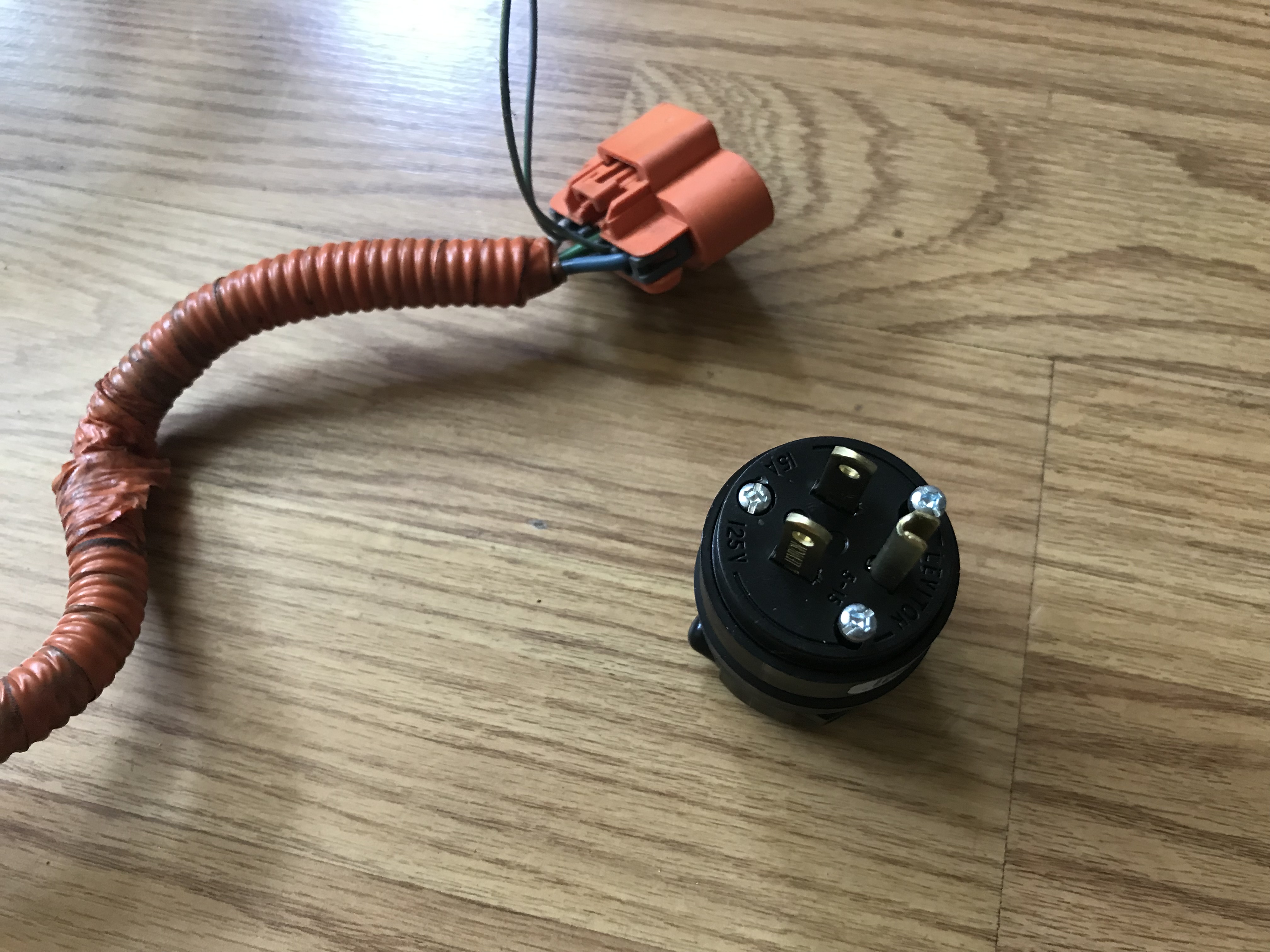

oh no he didn't....
- Gregski
- Posts: 3157

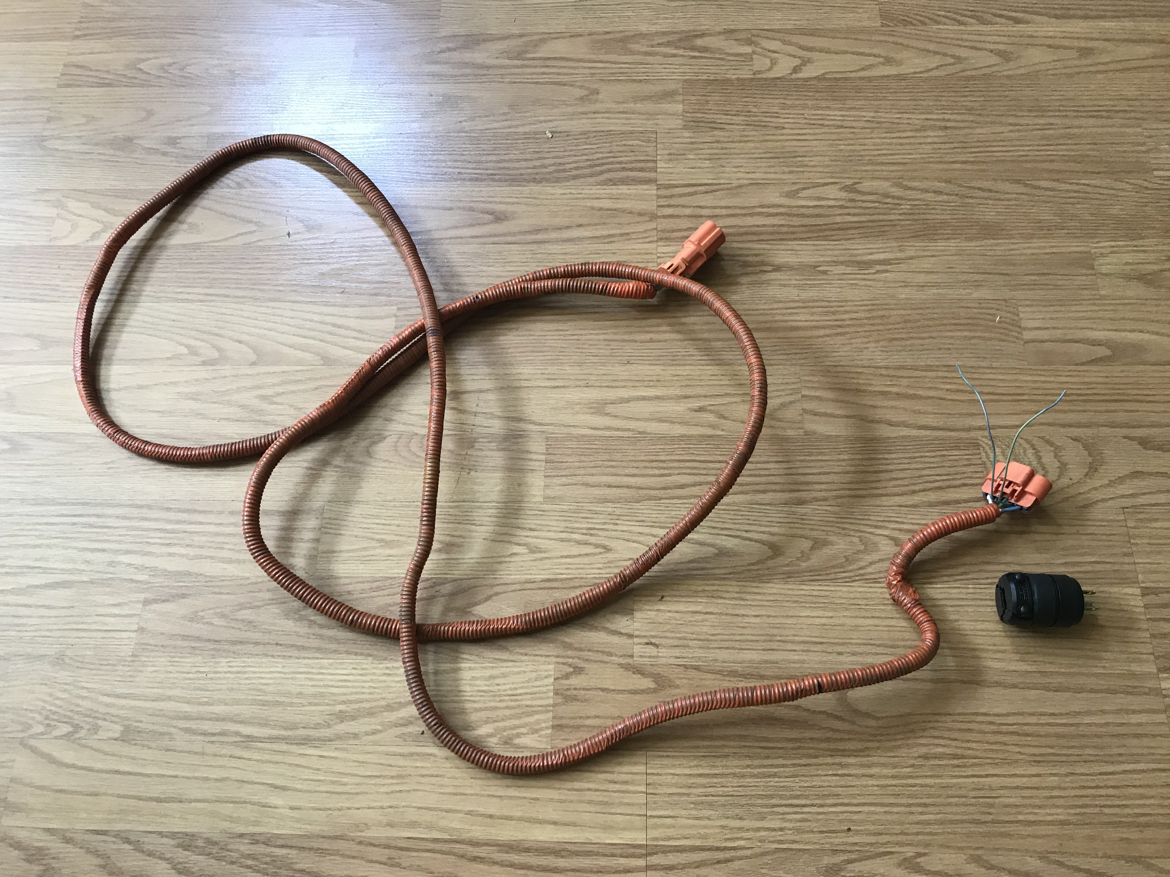

and we got ourselves a dime a dozen regular US 120 volt (pronounced: "one ten") 15 amp power cord, perfect for some troubleshootin'

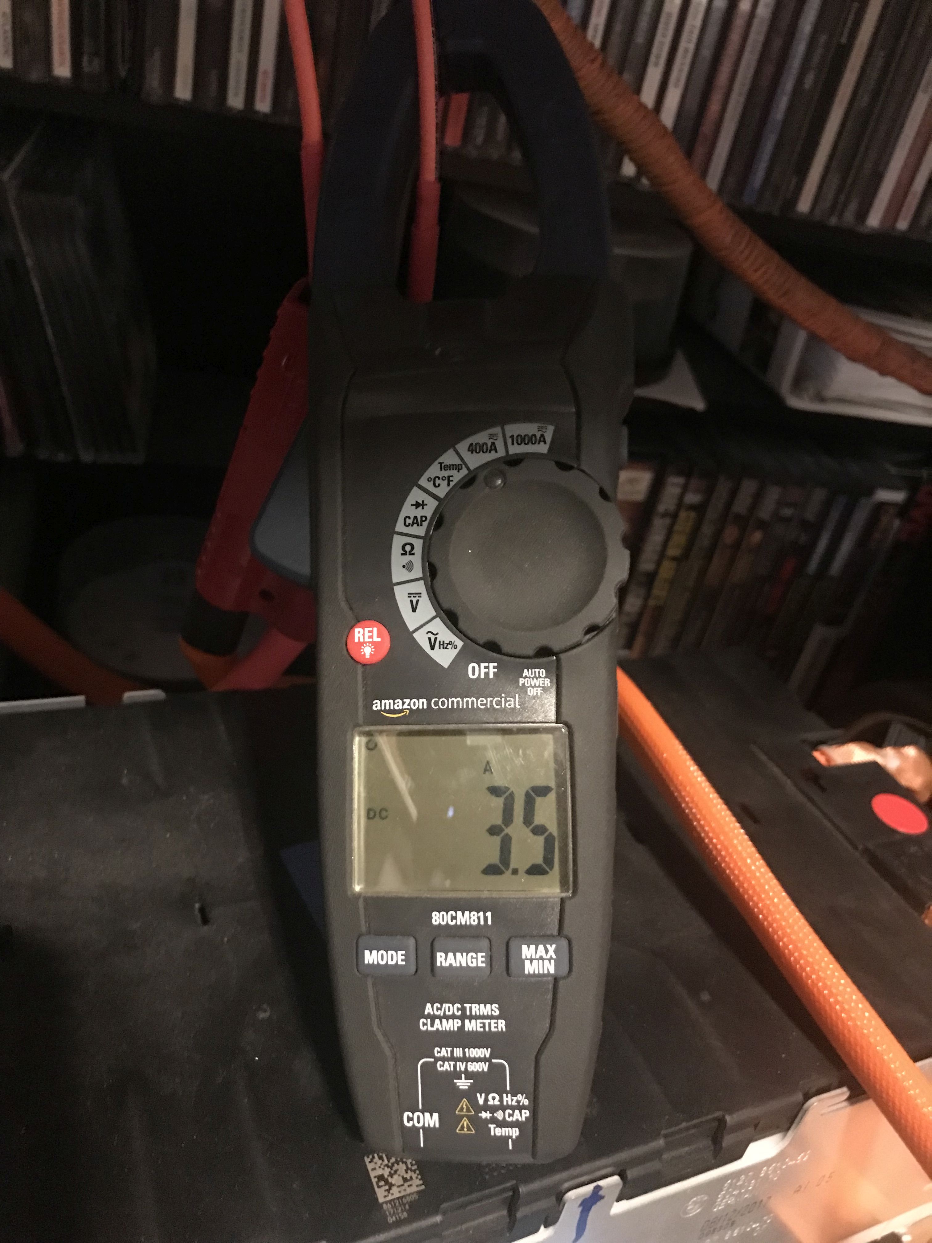

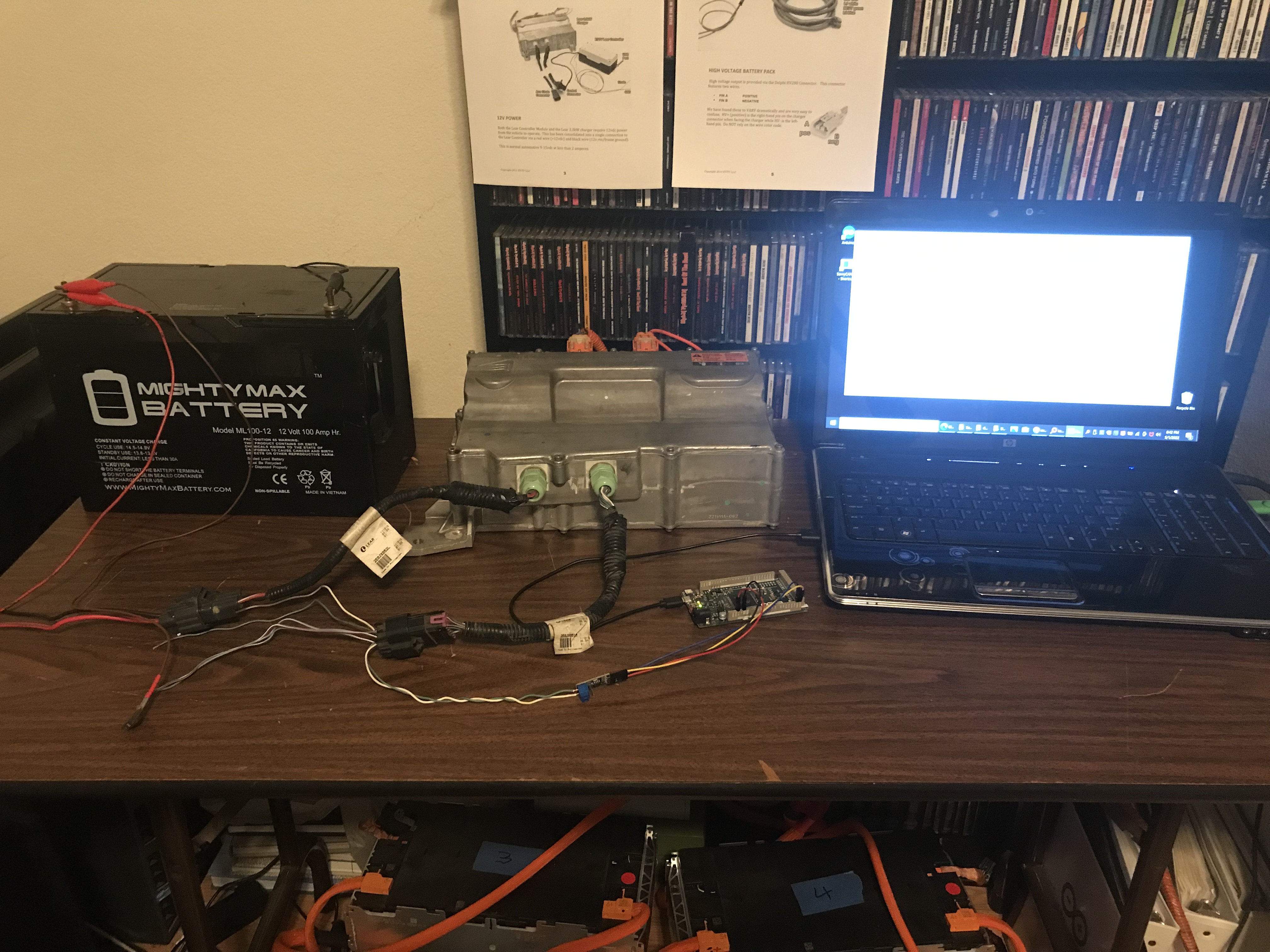

and literally in the 11th hour I got it working but only by enabling both the low voltage and the high voltage chargers using the 0x03 bit and when I do so I can see amps on the high voltage orange wire going into the battery, it reads 3.5 amps which is approximately half of what I have it set to ie 8 amps, but that's because I am on only 120 volts AC
- Gregski
- Posts: 3157
Oh my goodness, it all works, I figured it out, and you will not believe what was the problem!!!
I was trying to charge an AGM deep cycle battery and not a "real" car battery. Who knew that won't work?

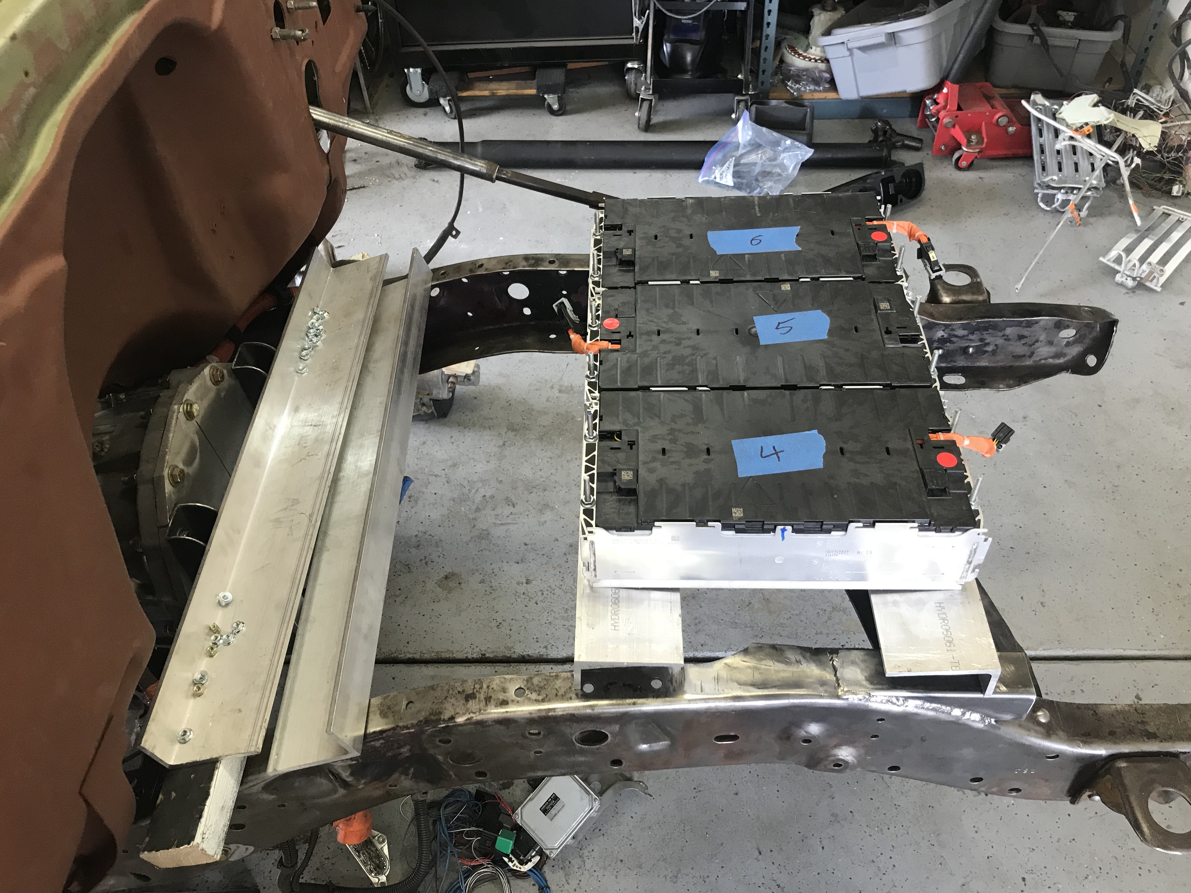

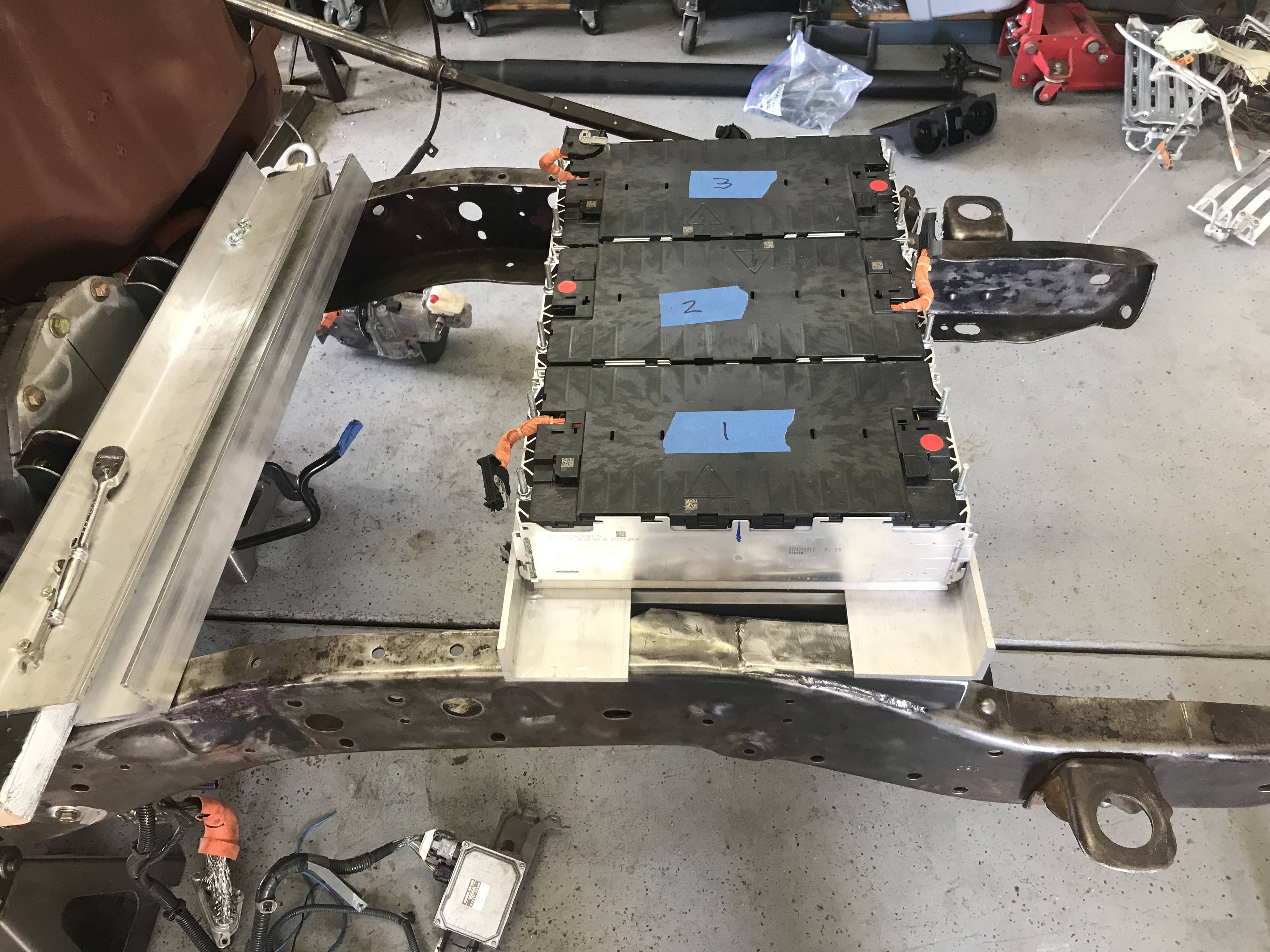

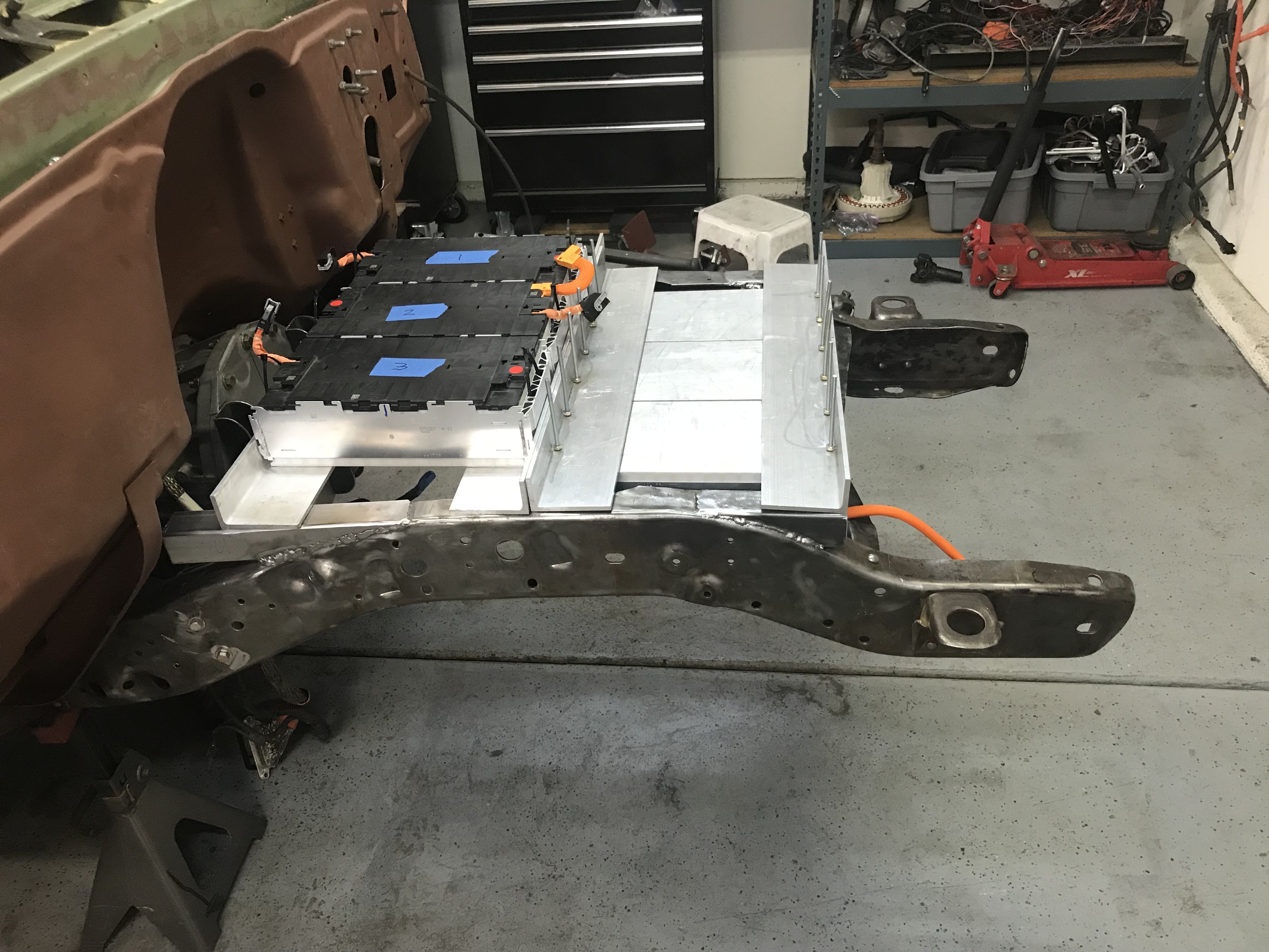

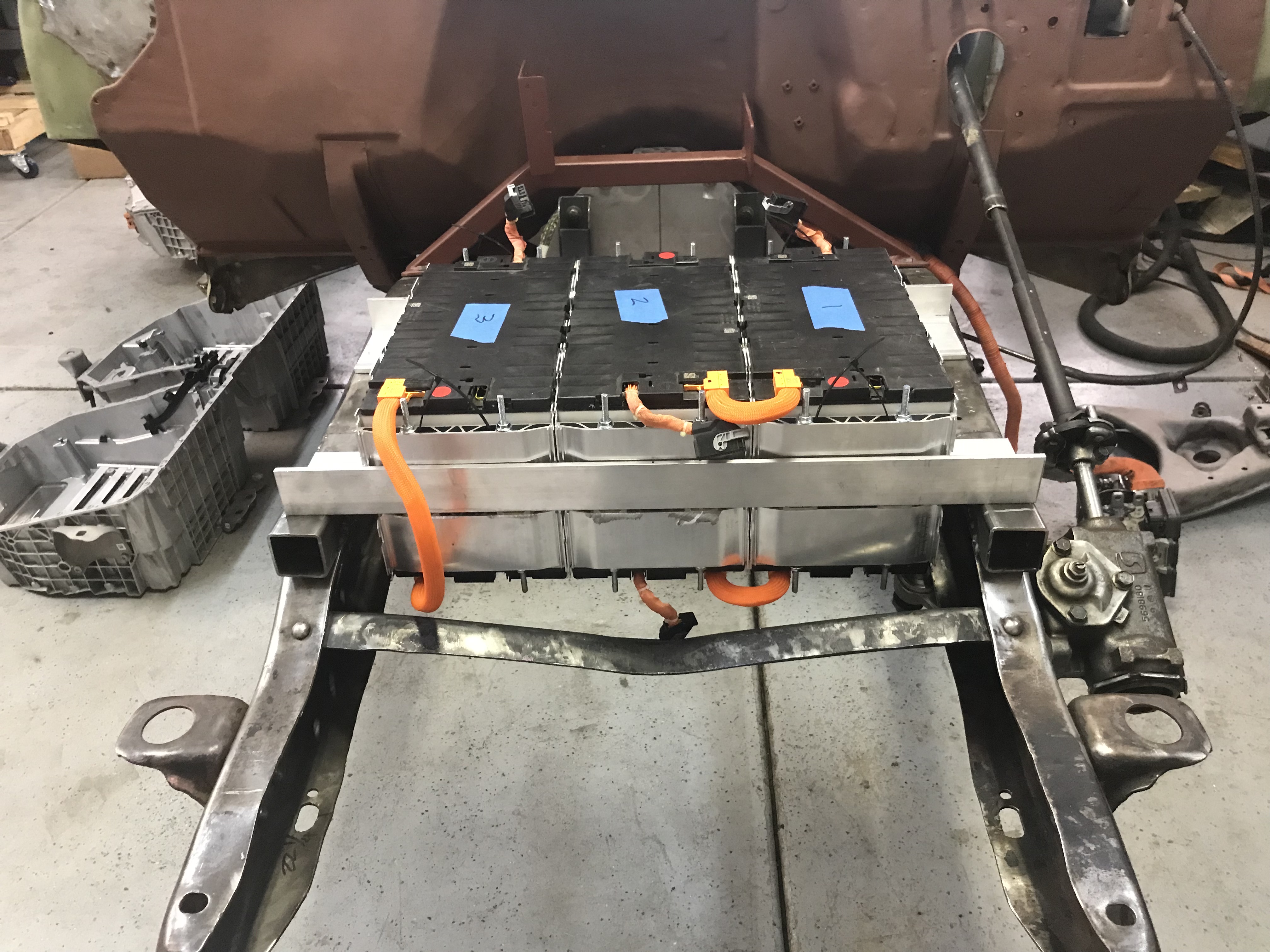

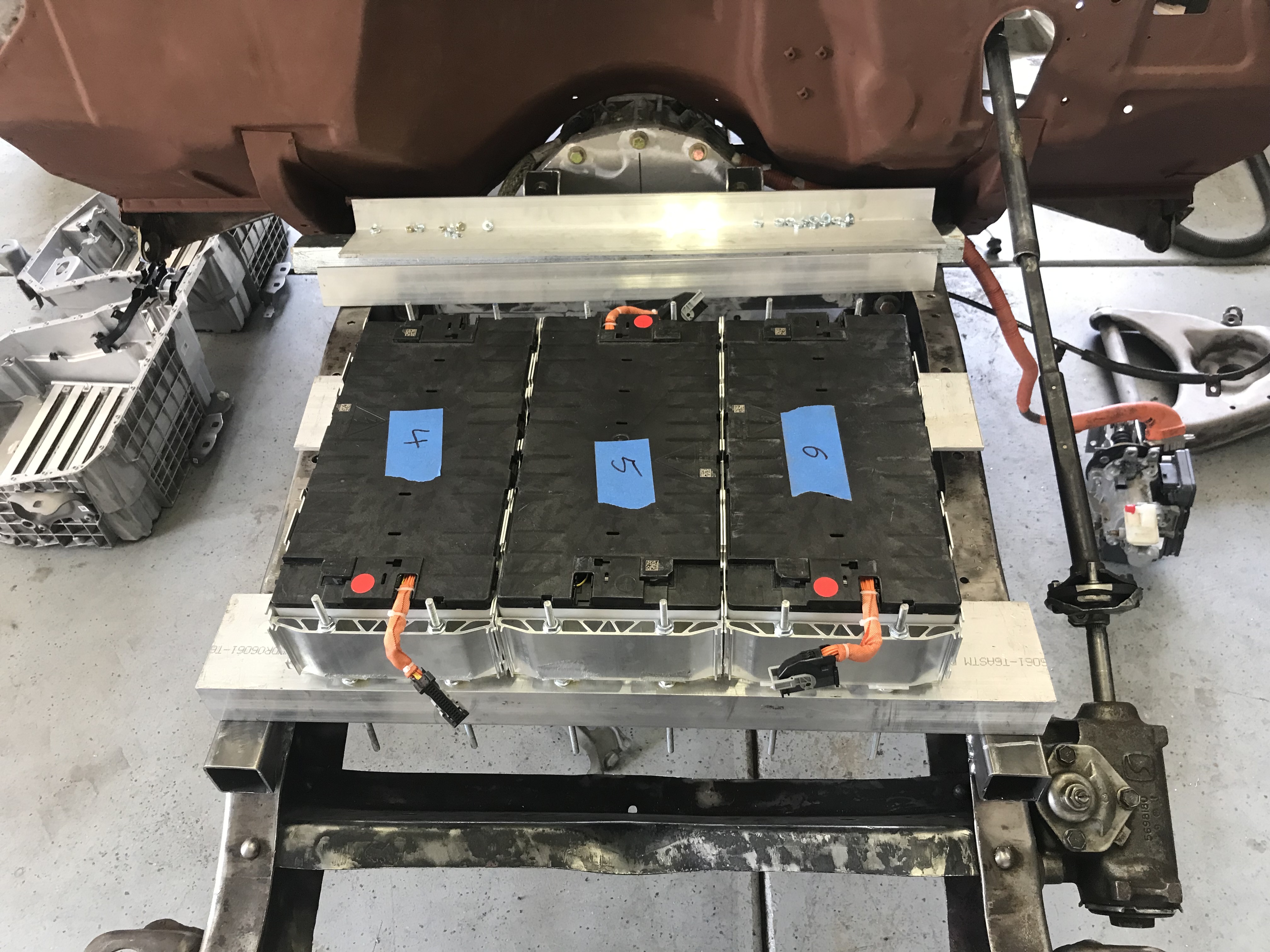

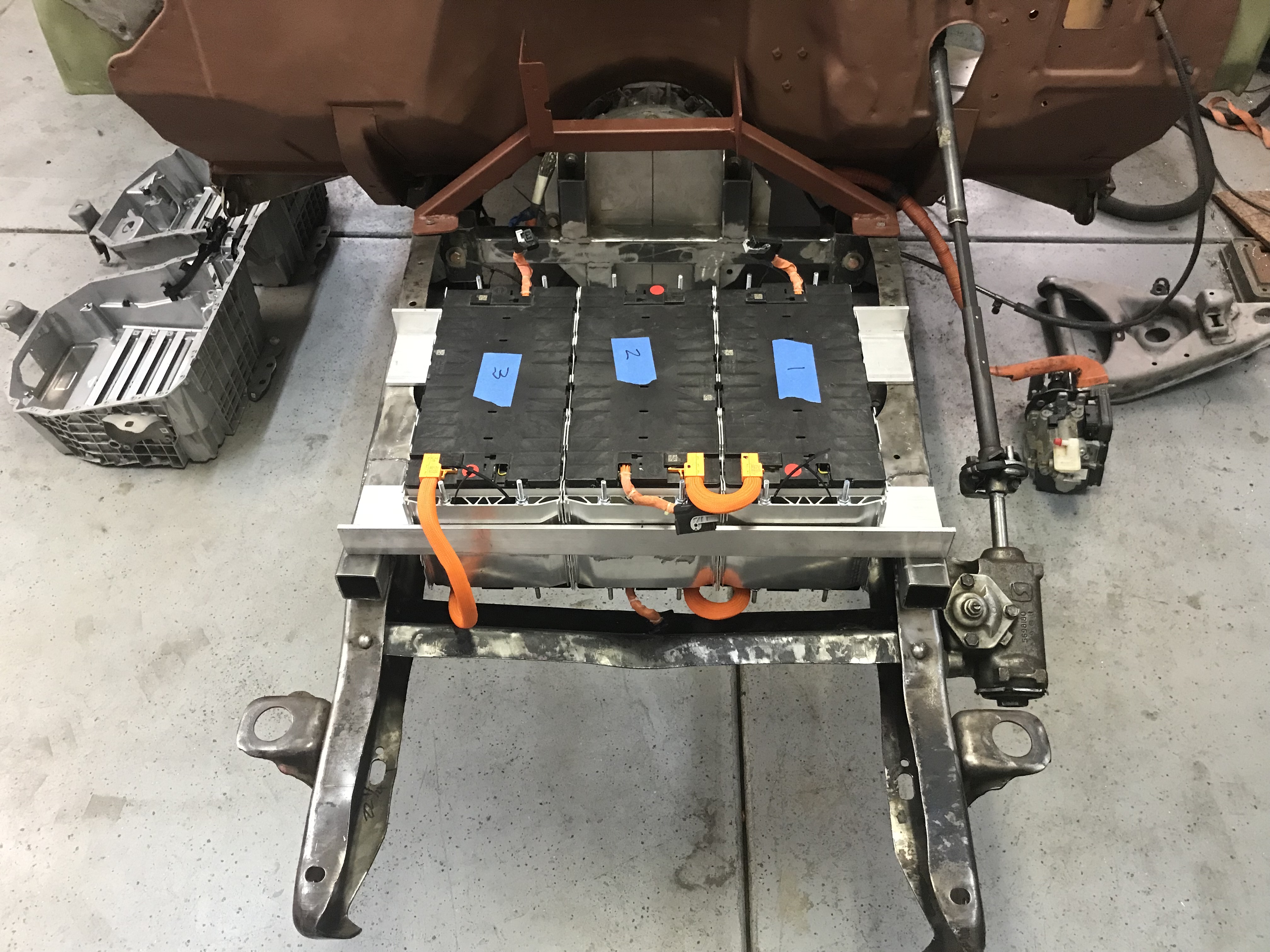

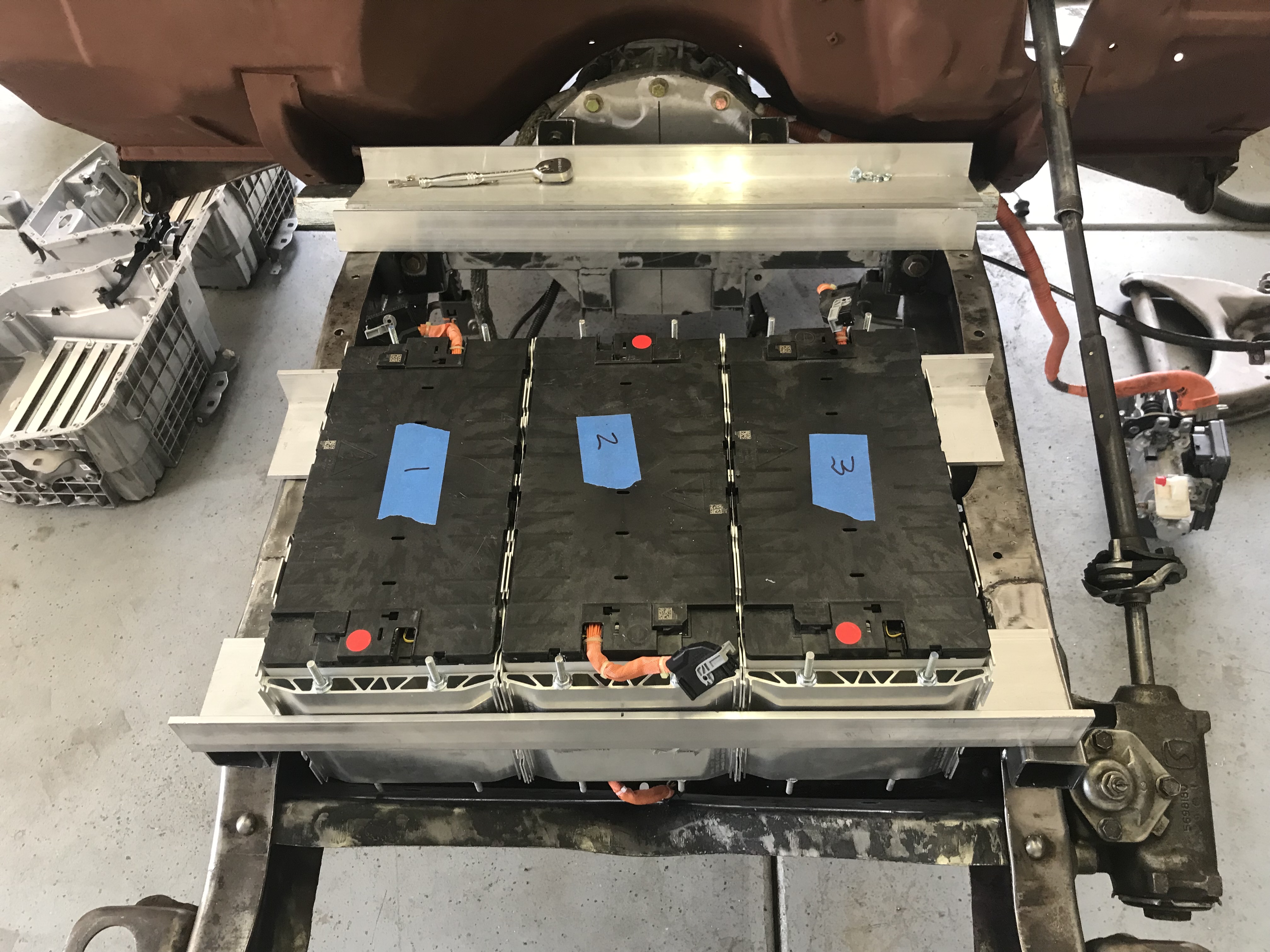

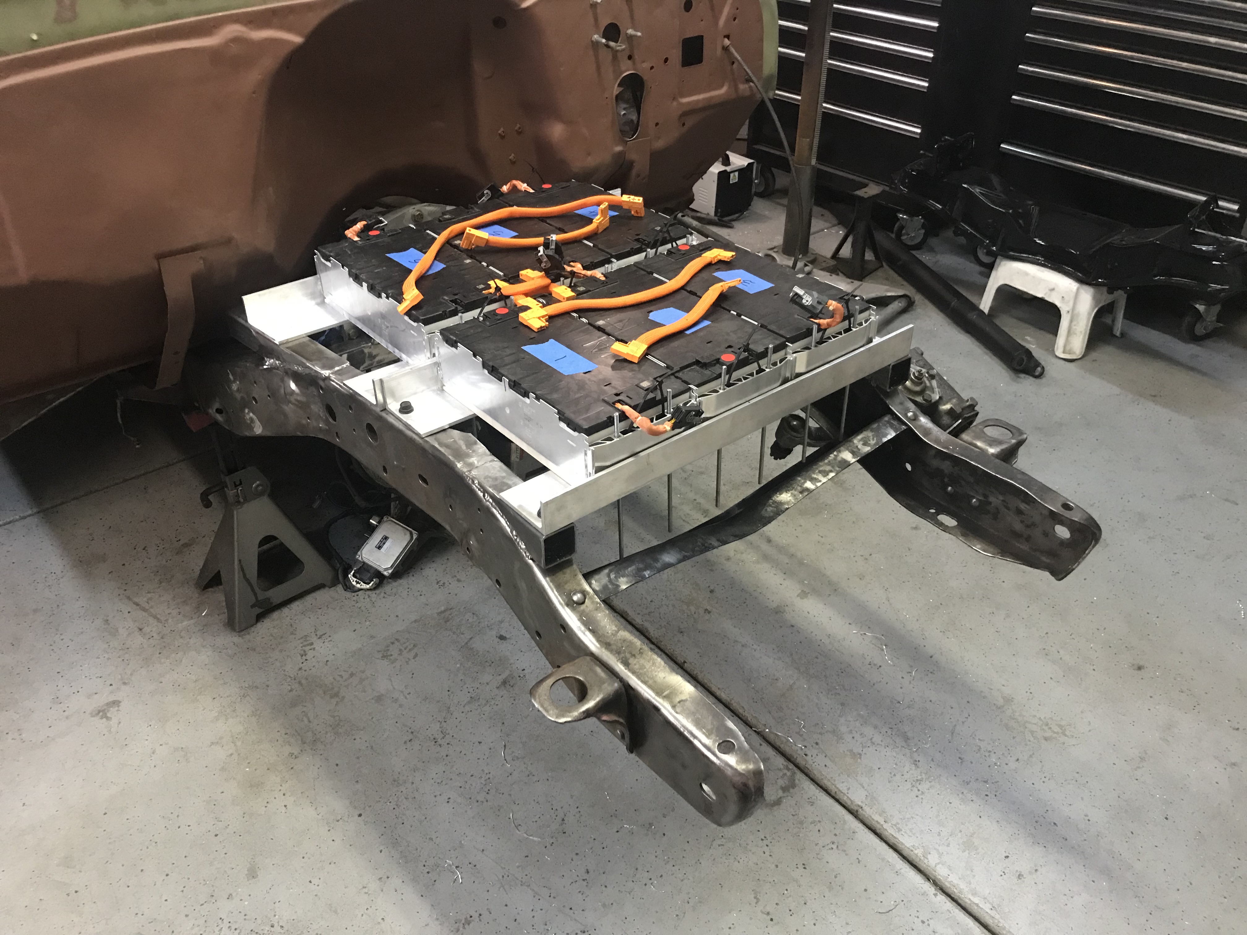

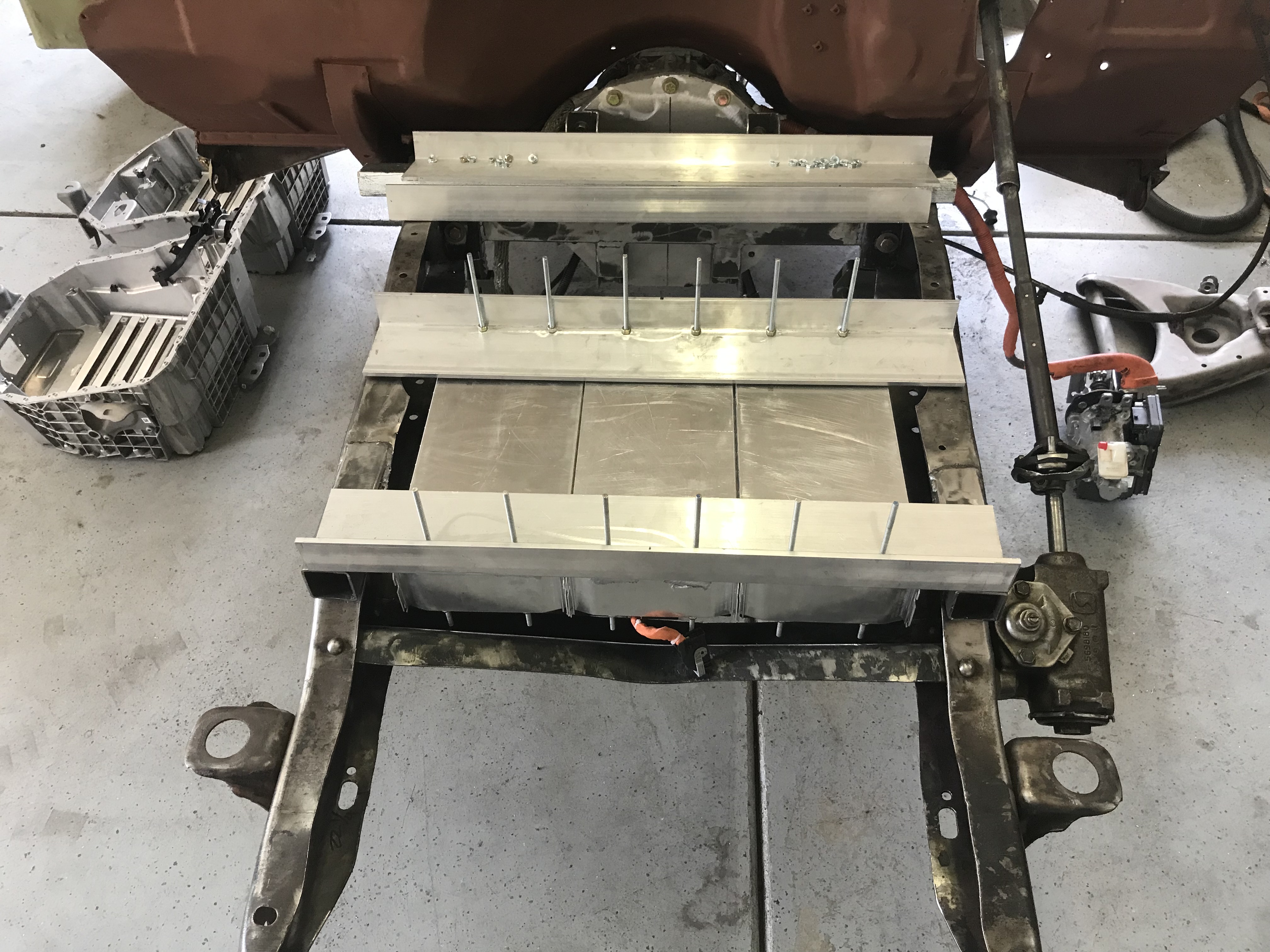

the idea is a modular design that will put crane operators out of business

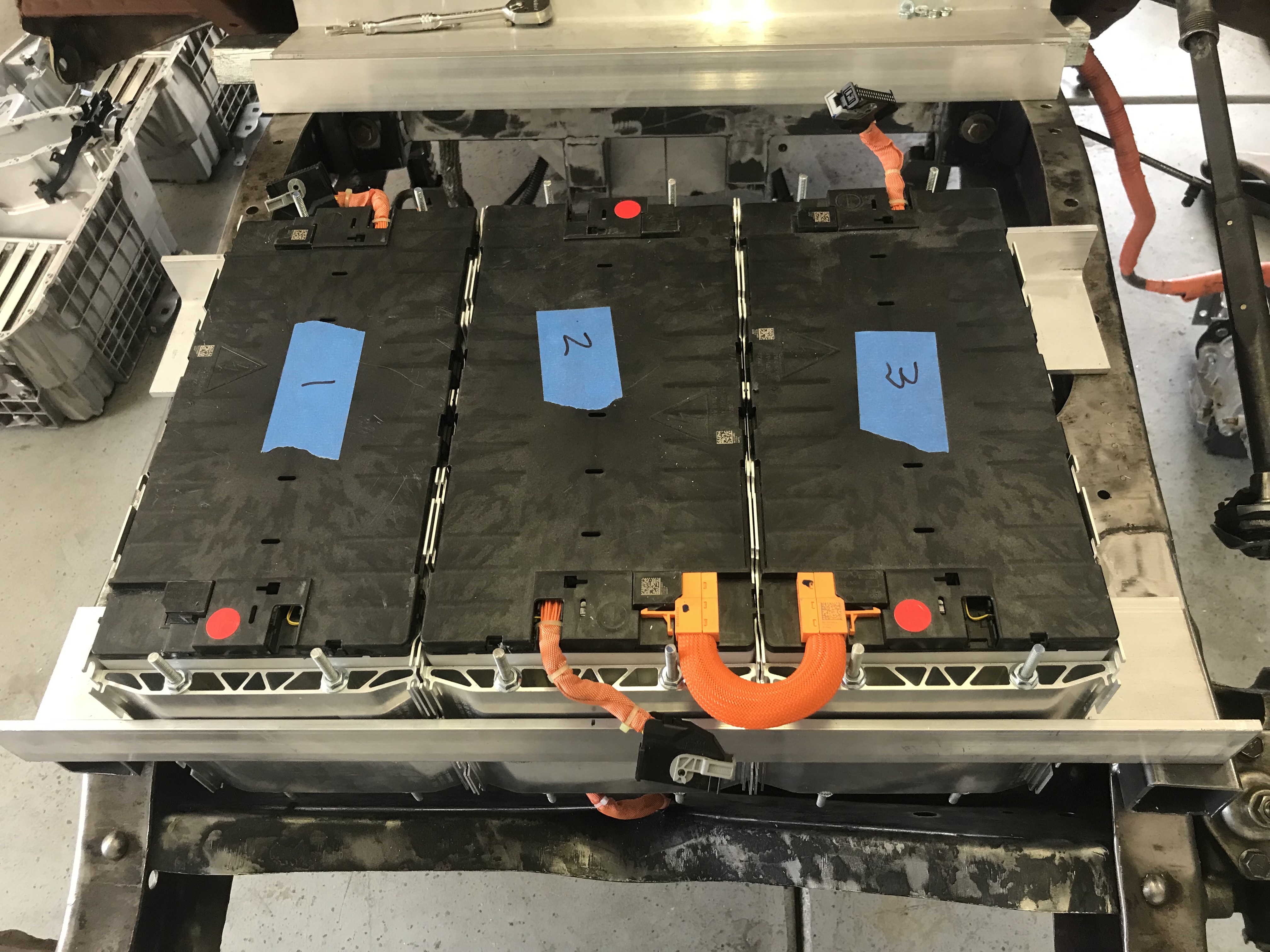

first we load up the bottom three cell modules (each weighing in at just under 30 lbs)
once those three are individually loaded and bolted up, we simply flip that batch over - right side up
and now we are ready for the top batch
and there we have it, "The Stack" configuration (genius I tell yah, genius!)

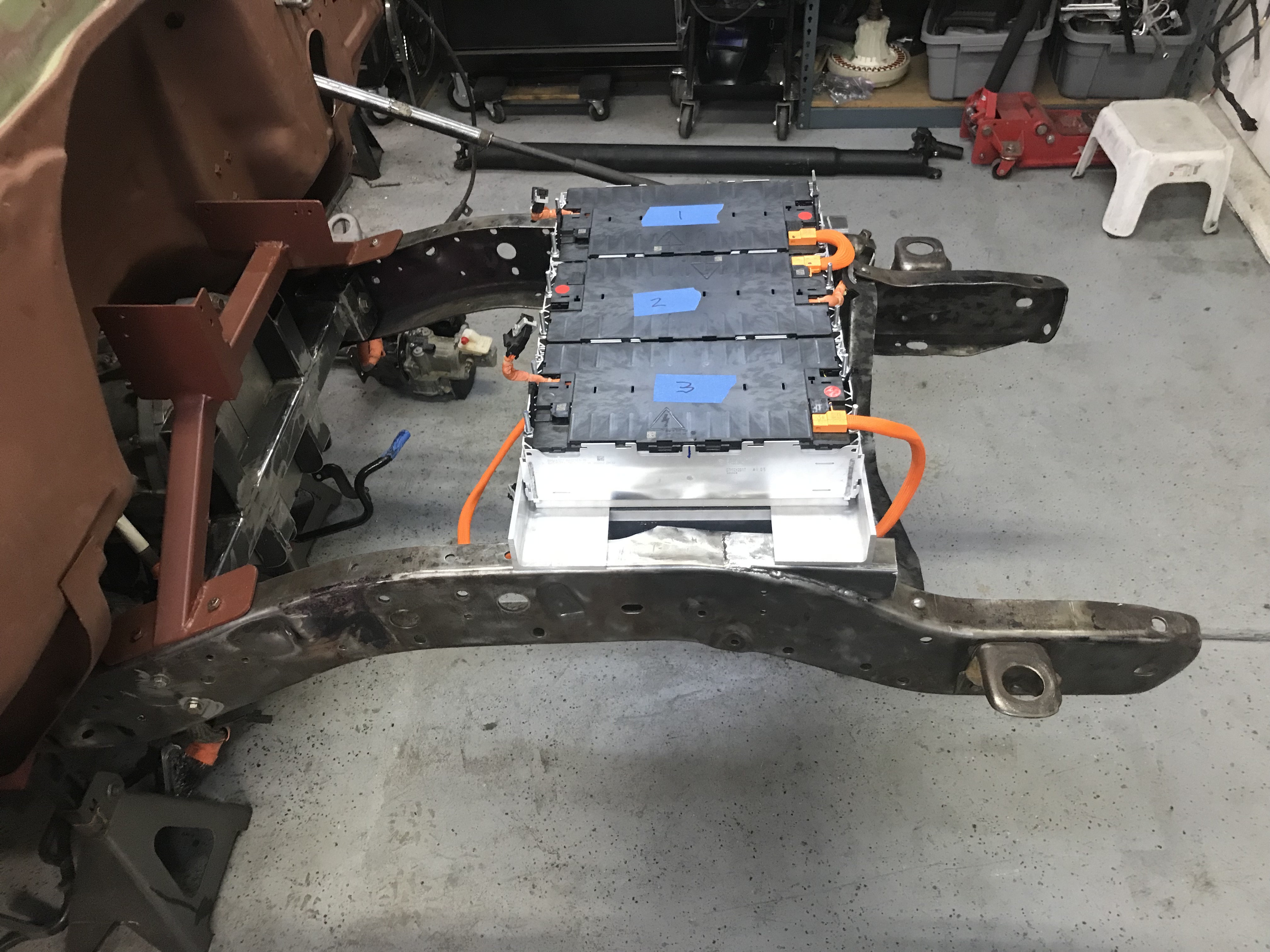

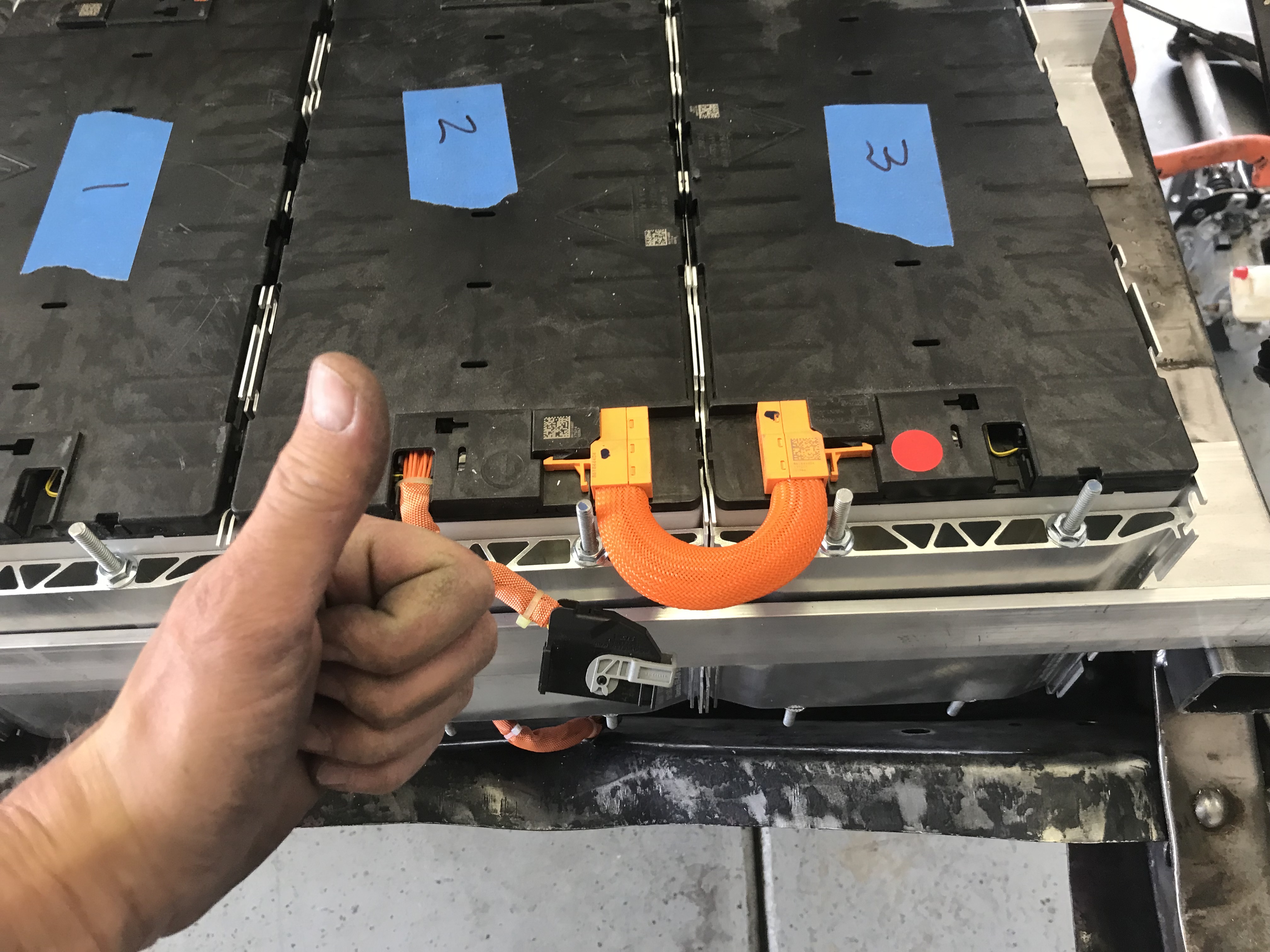

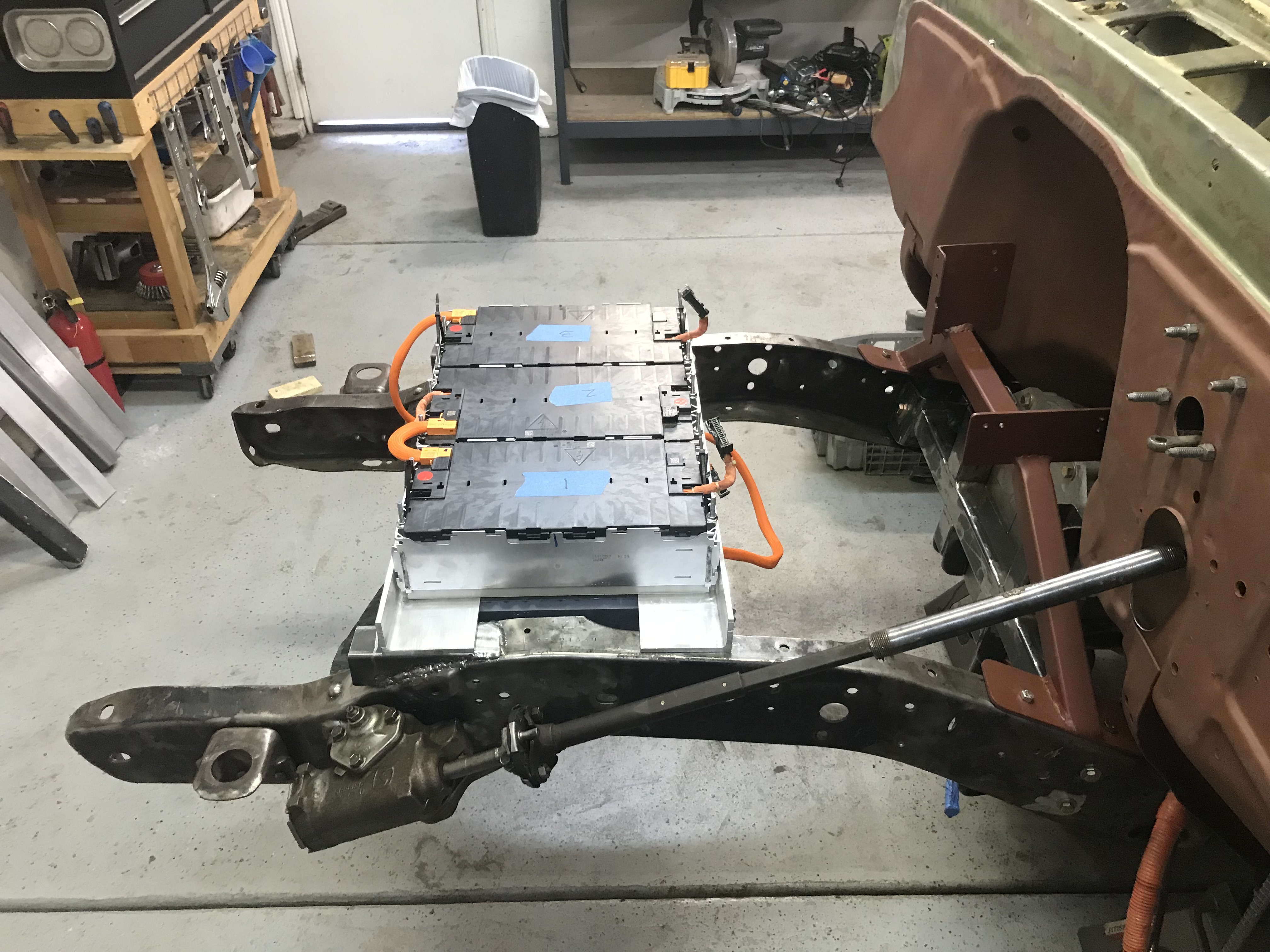

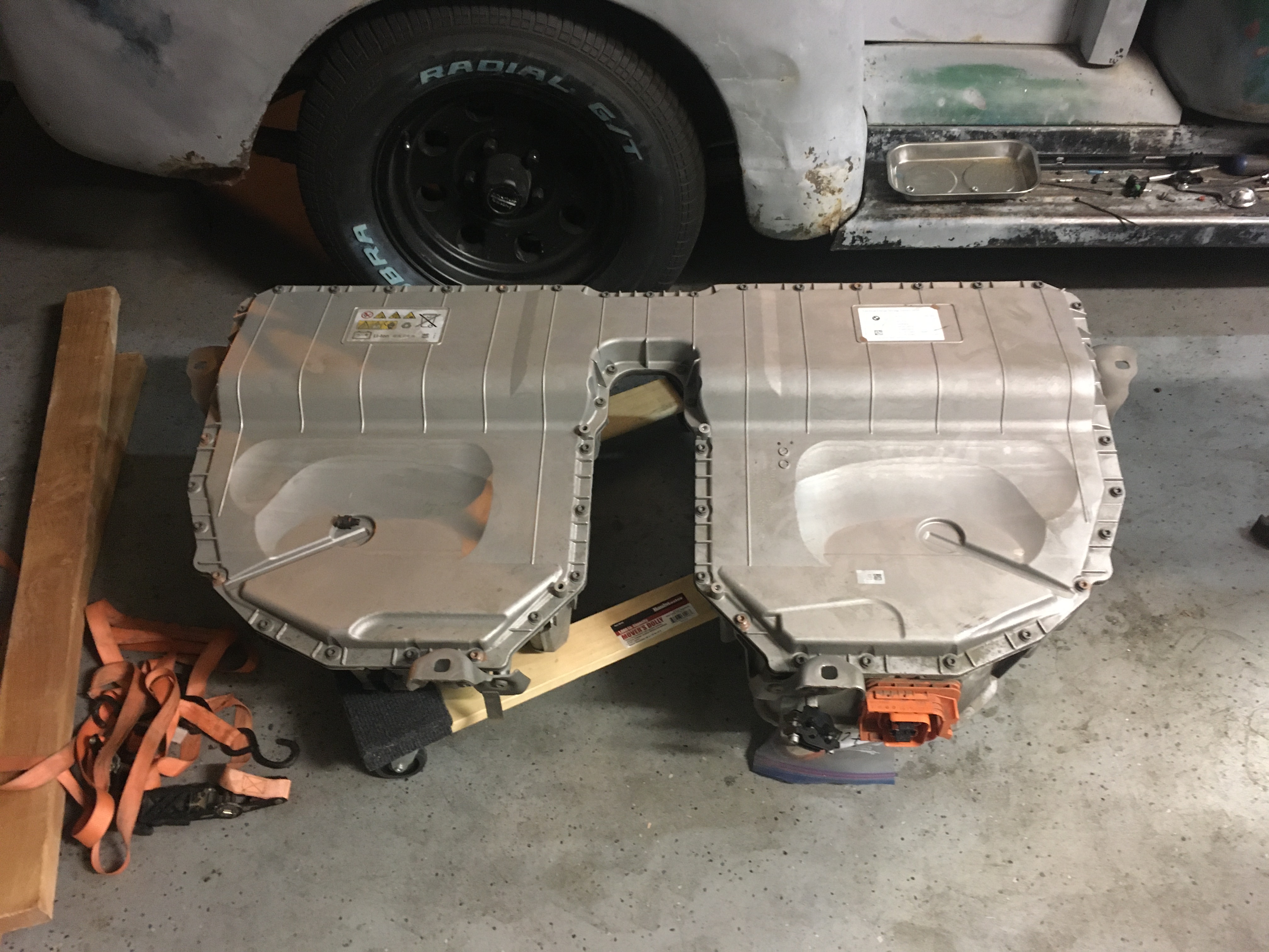

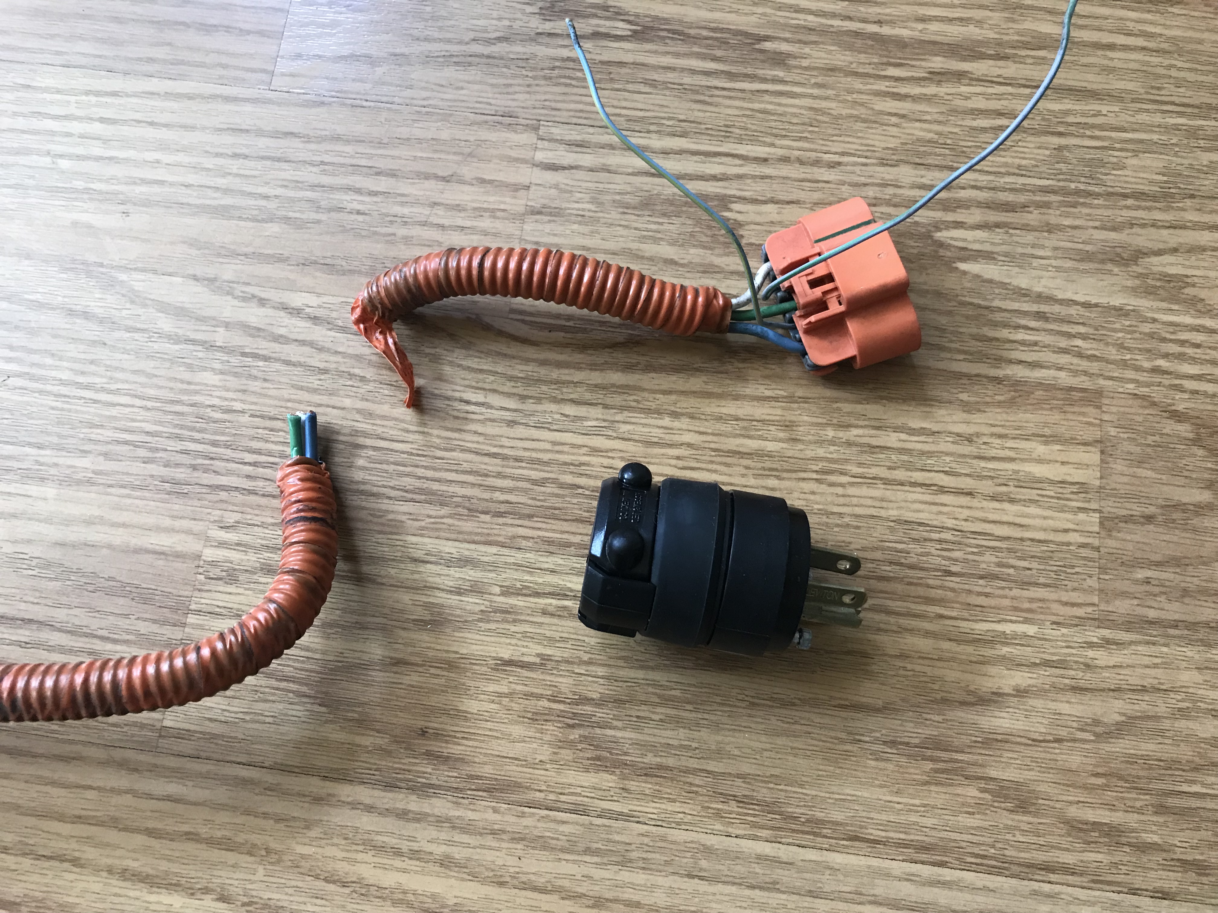

now every battery pack has it's pros and cons, be it a Tesla pack, a Nissan Leaf, or this BMW 530e, and this one is no different, one of the downsides of it is these unobtanium proprietary high voltage cables, it is a real challenge to reconfigure the standard pack layout whilst utilizing only the stock high voltage cables
some like this one joins two cell modules very smartly.... (we like, we approve)

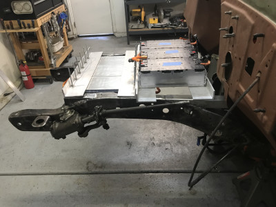

- Gregski
- Posts: 3157

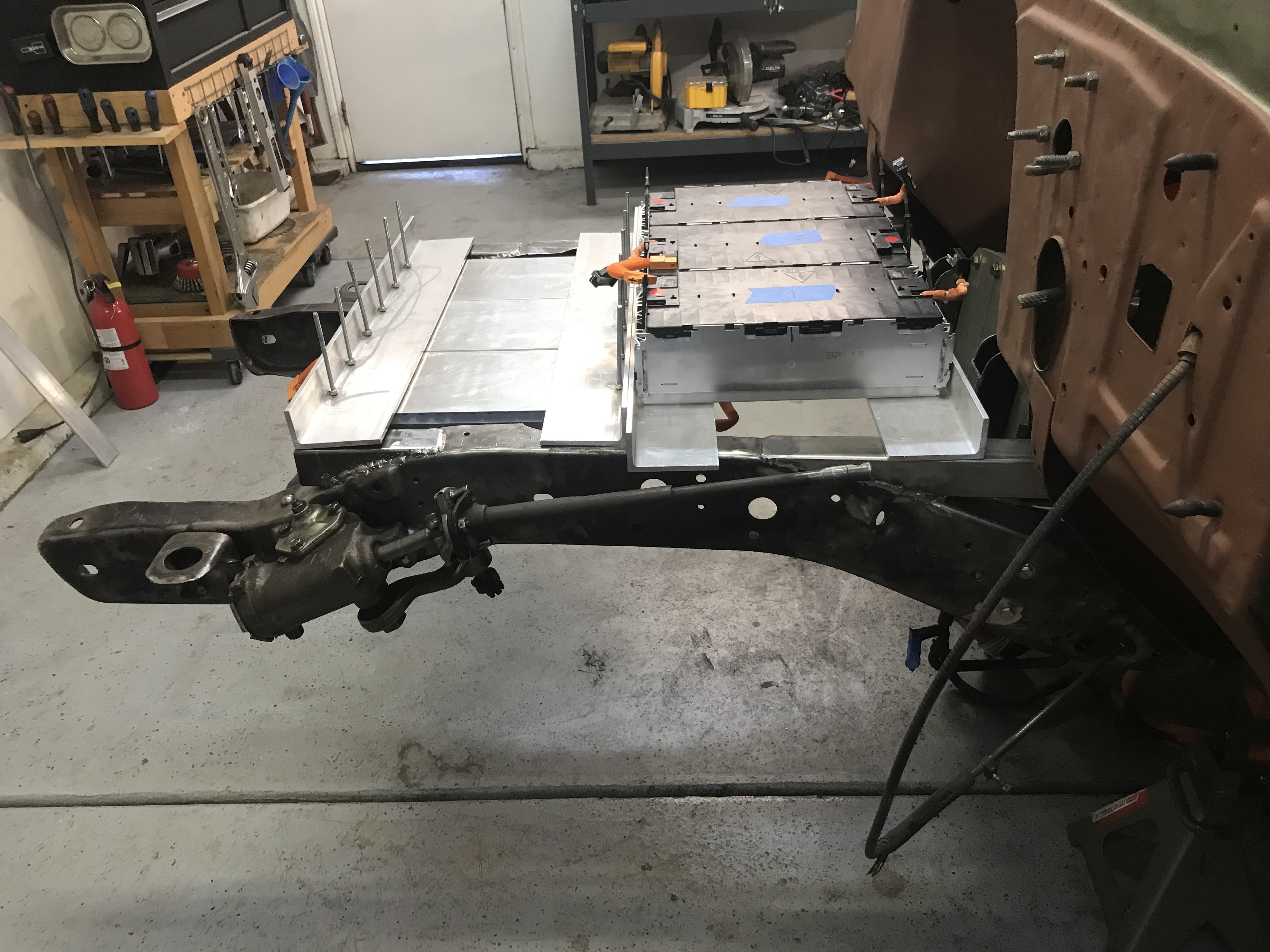

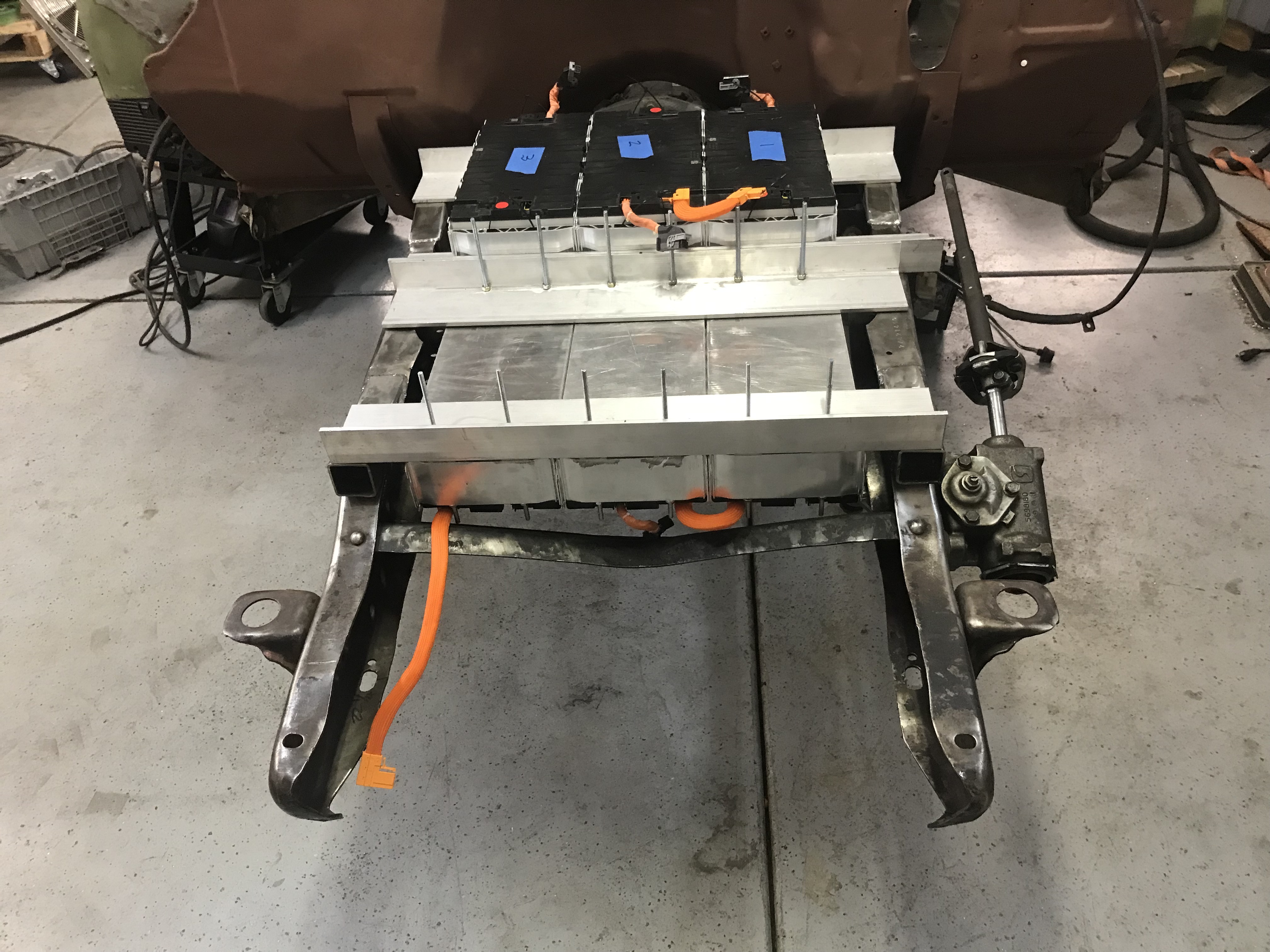

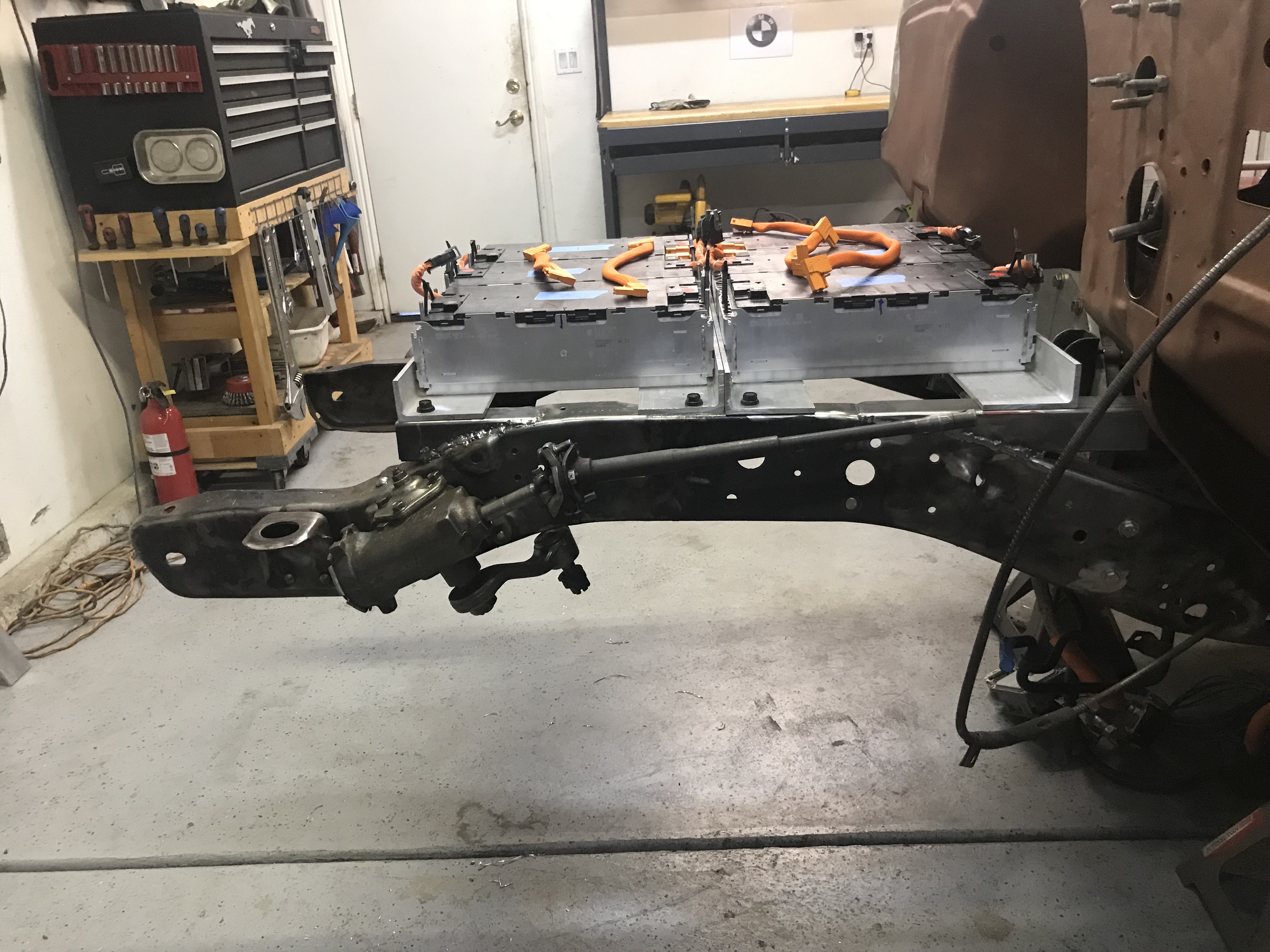

here is one BMW 530e battery pack (Embedded Fun Fact: which consists of six cell modules, unlike the 330e which only has five) reconfigured in The Stack Formation, unfortunately we are unable to complete this arrangement because we are one cable short, technically we have the cable but it is just too short to join Cell Module #2 to Cell Module #3
- Gregski
- Posts: 3157

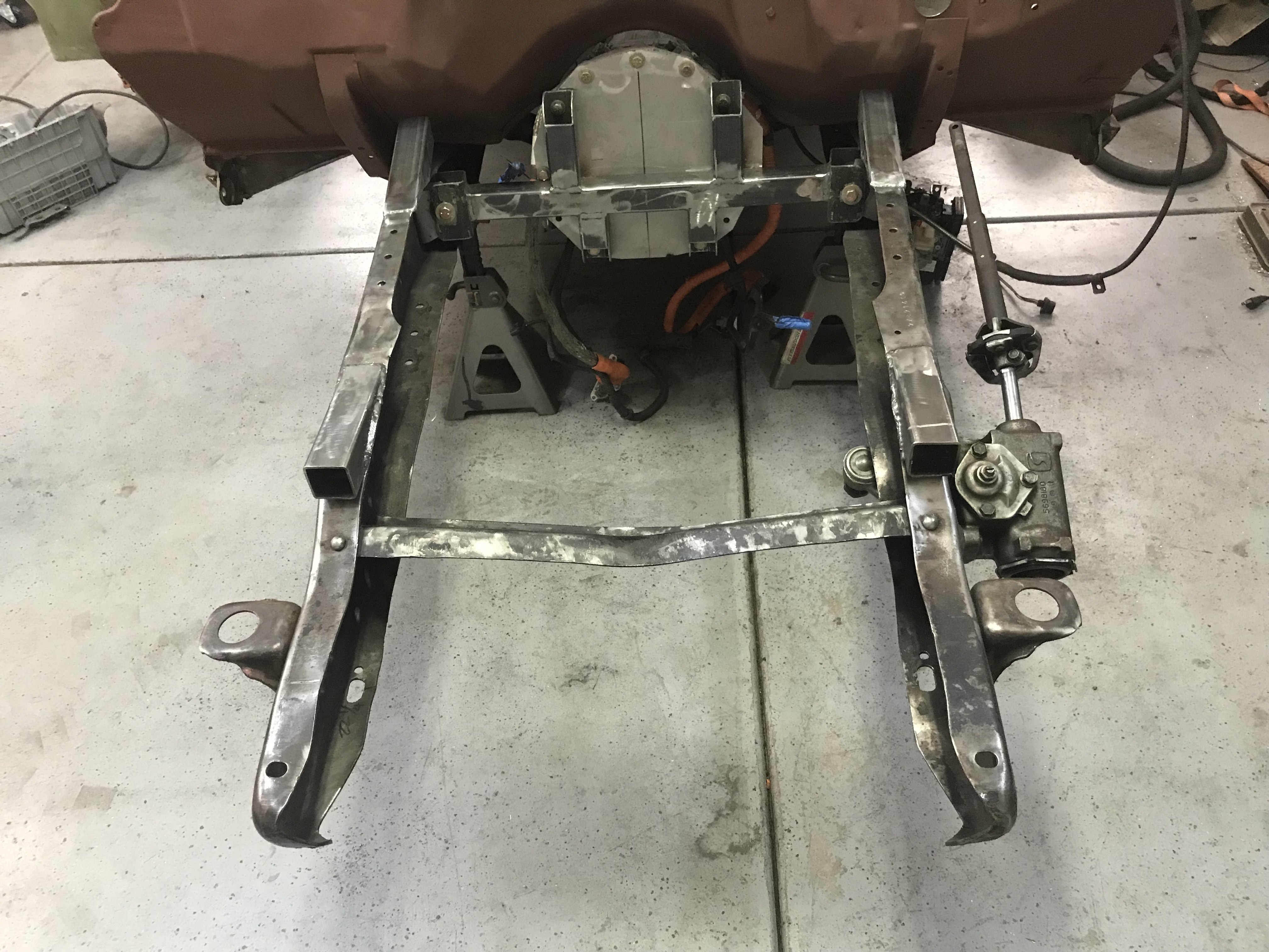

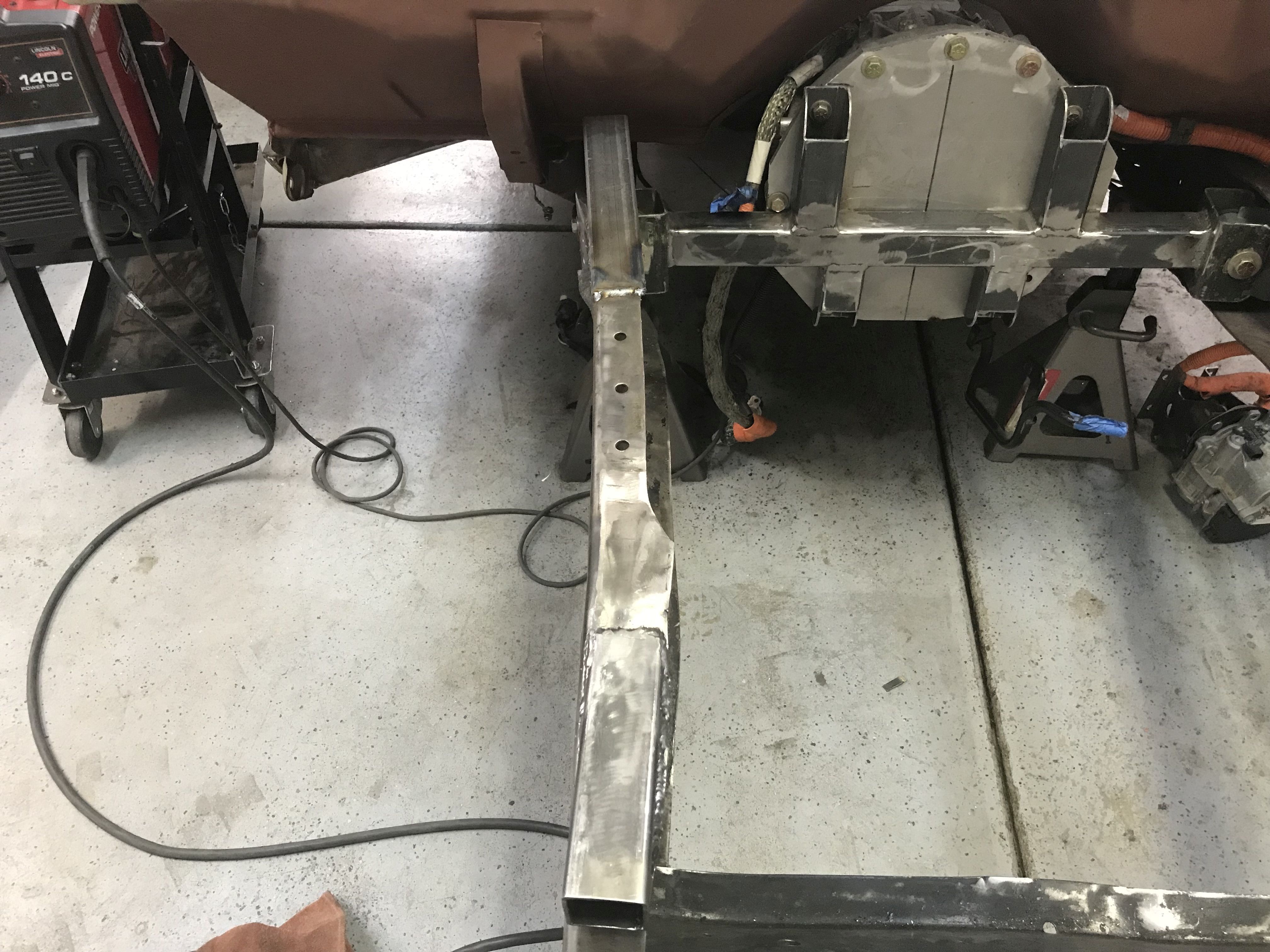

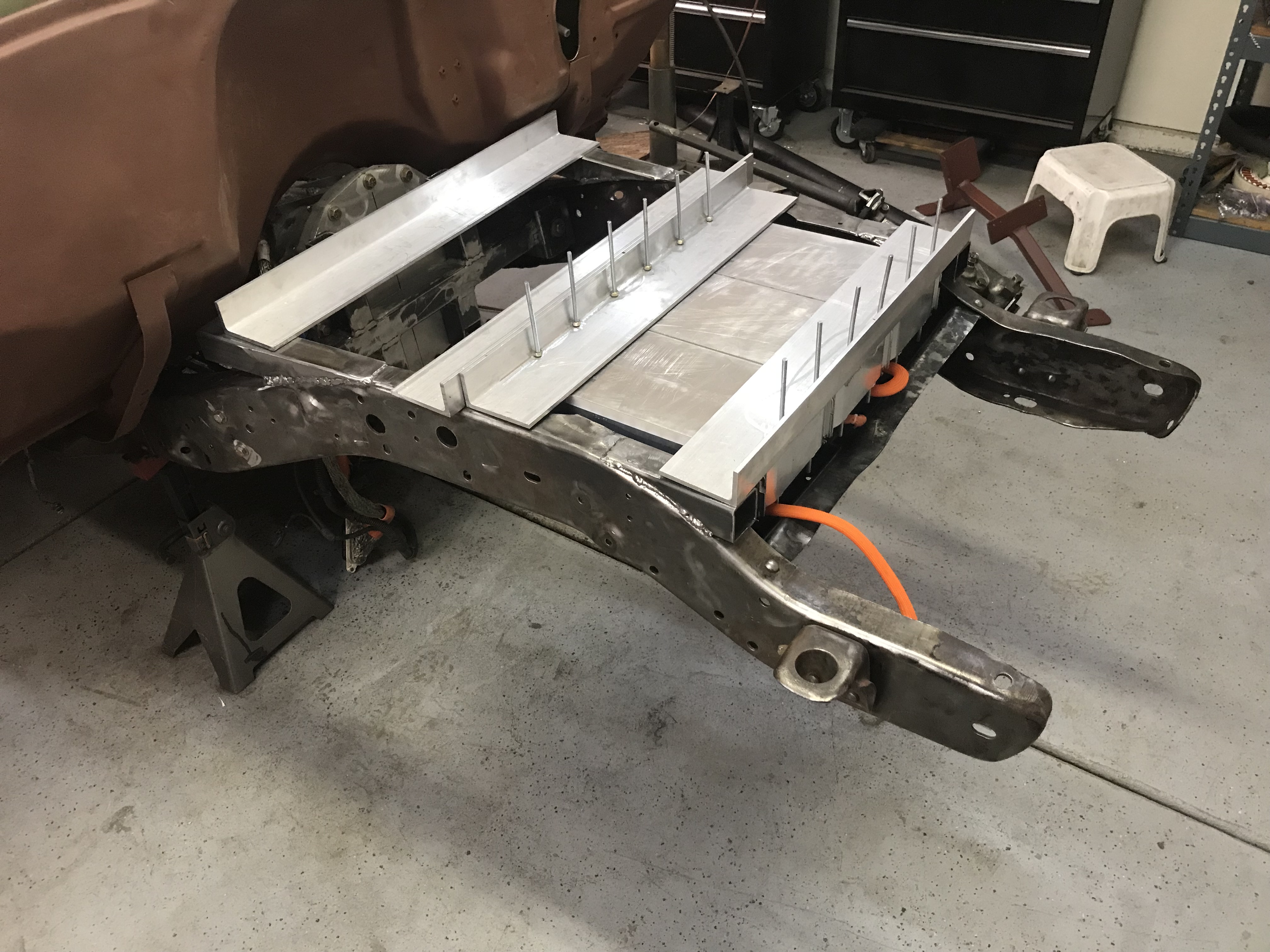

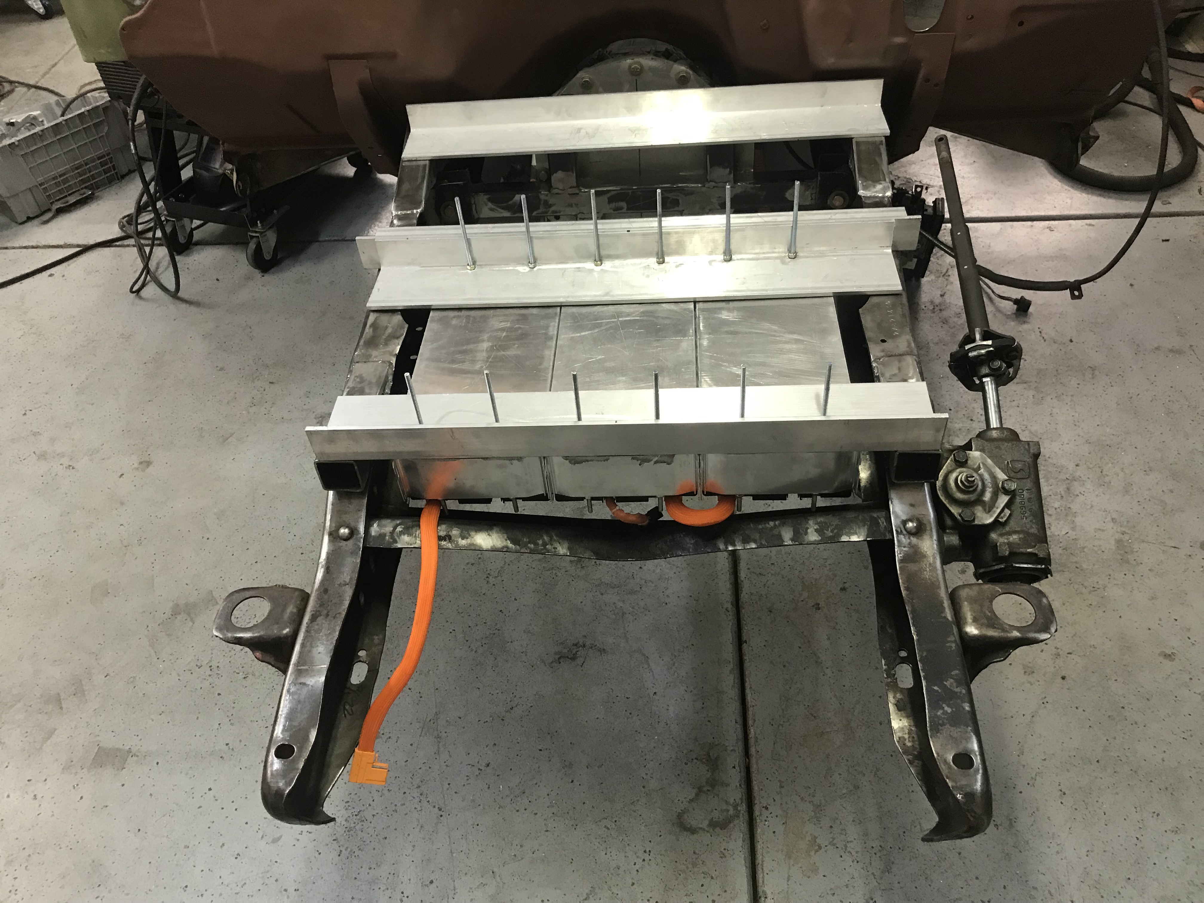

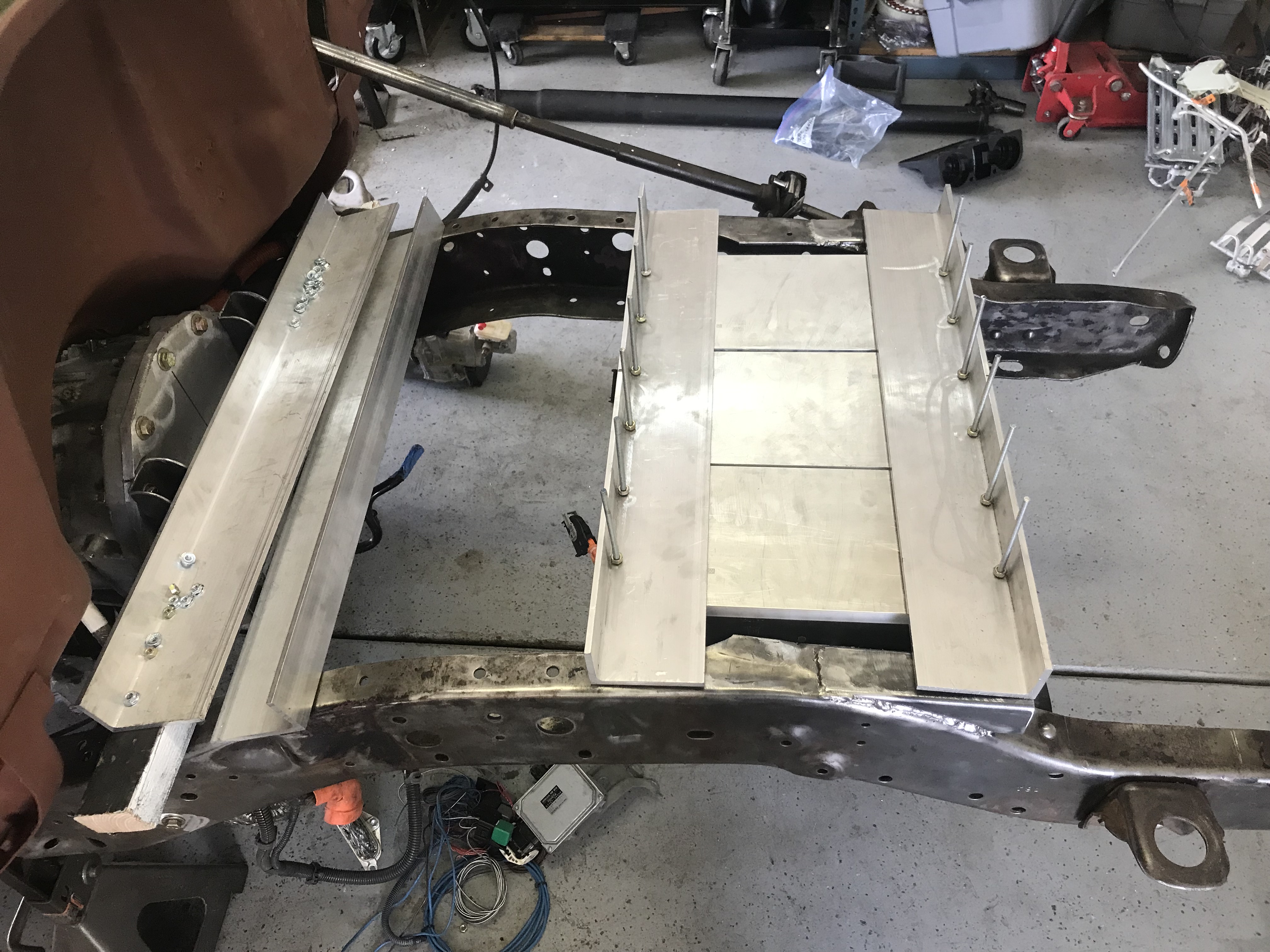

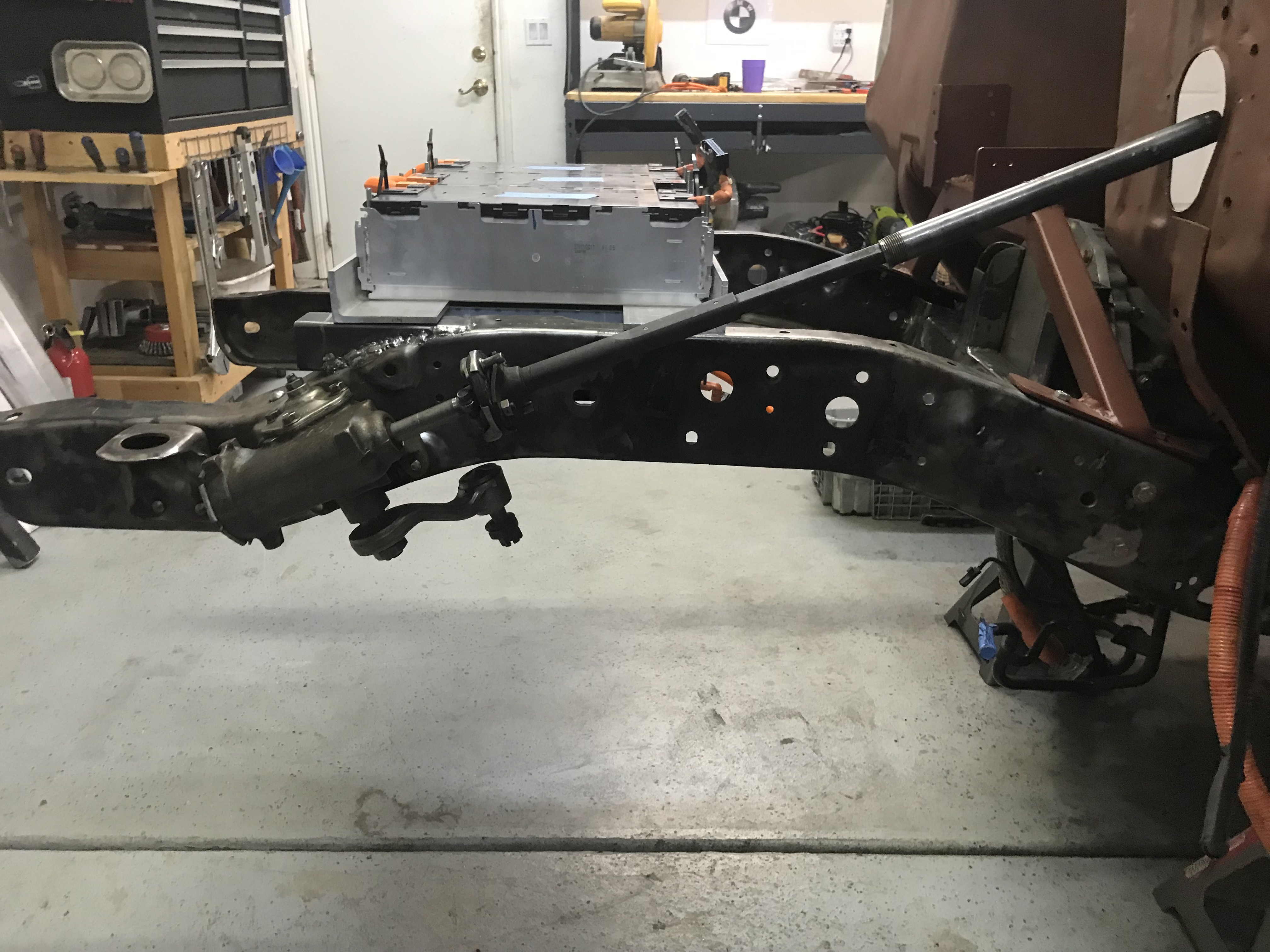

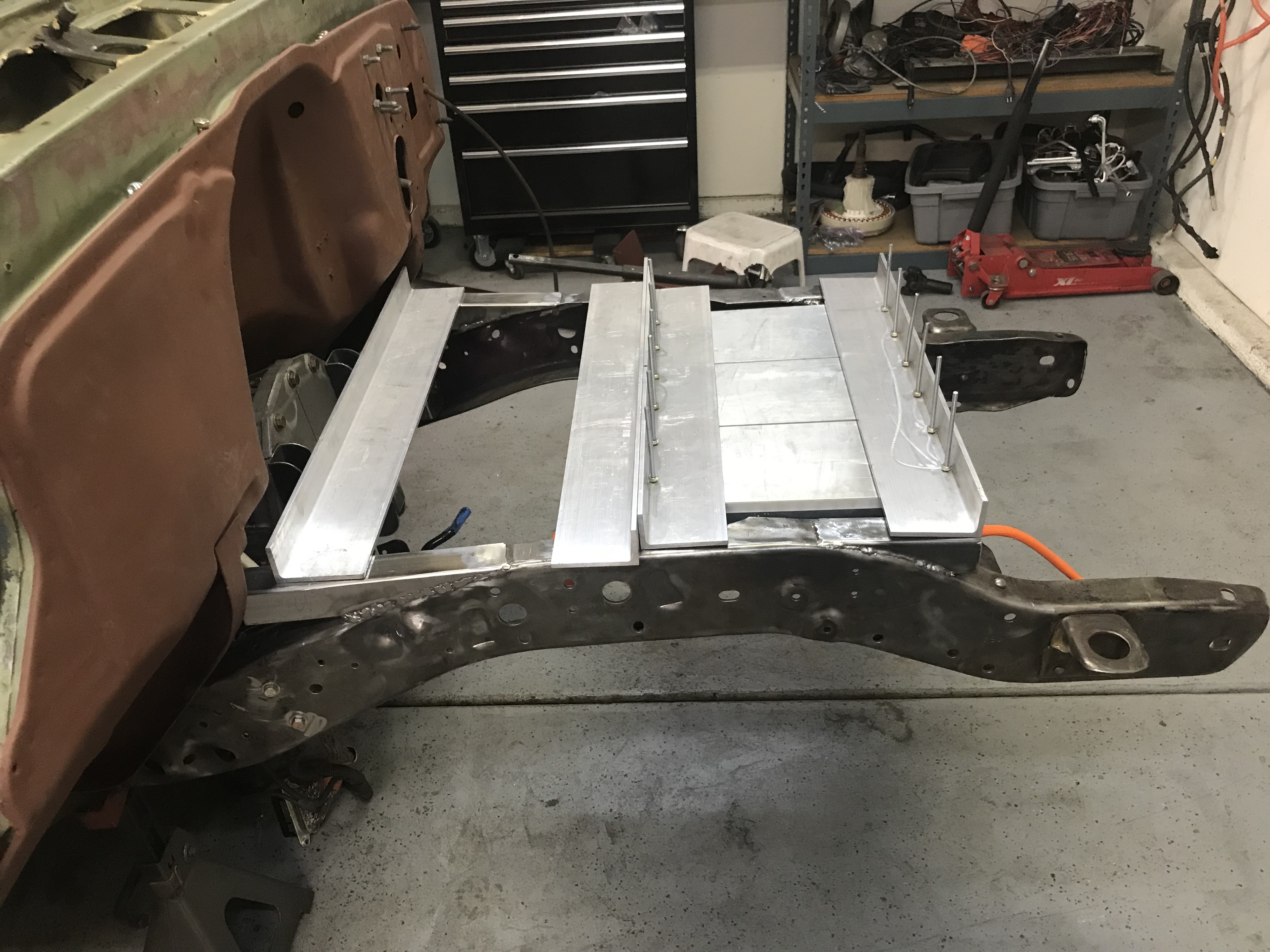

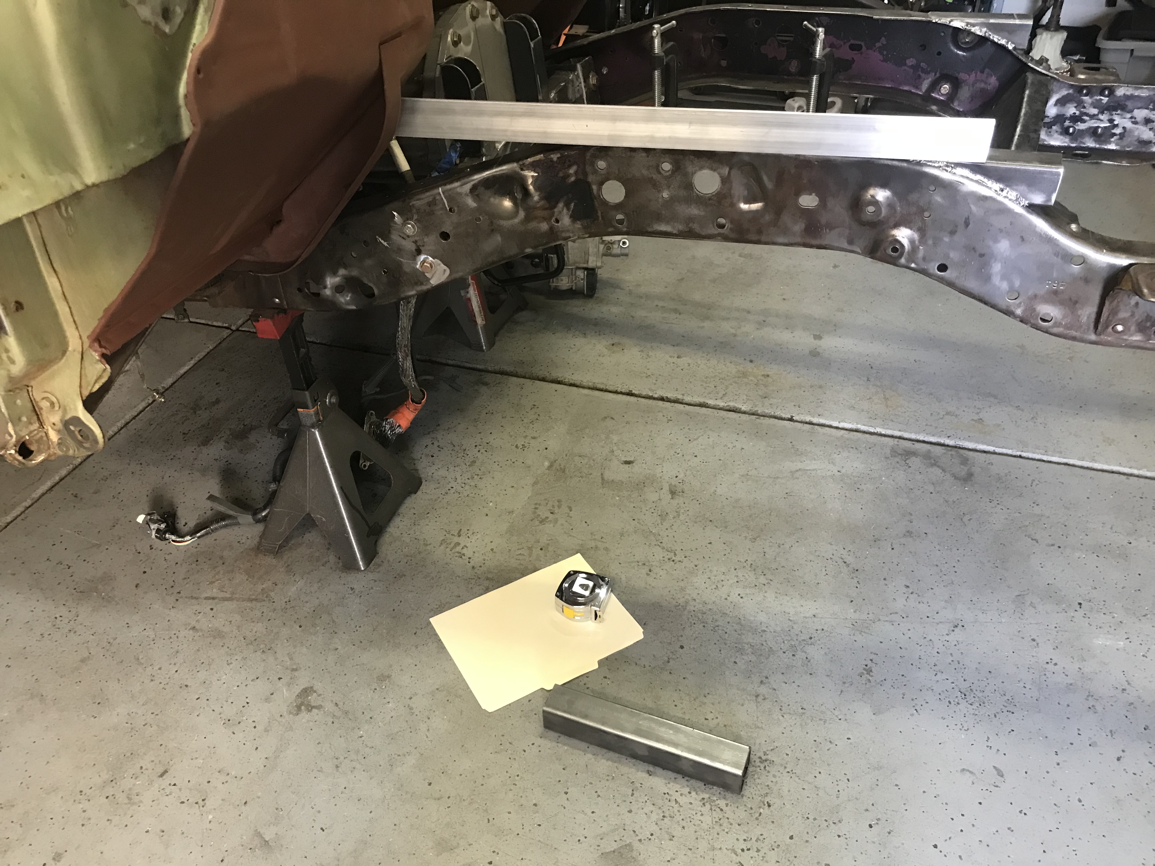

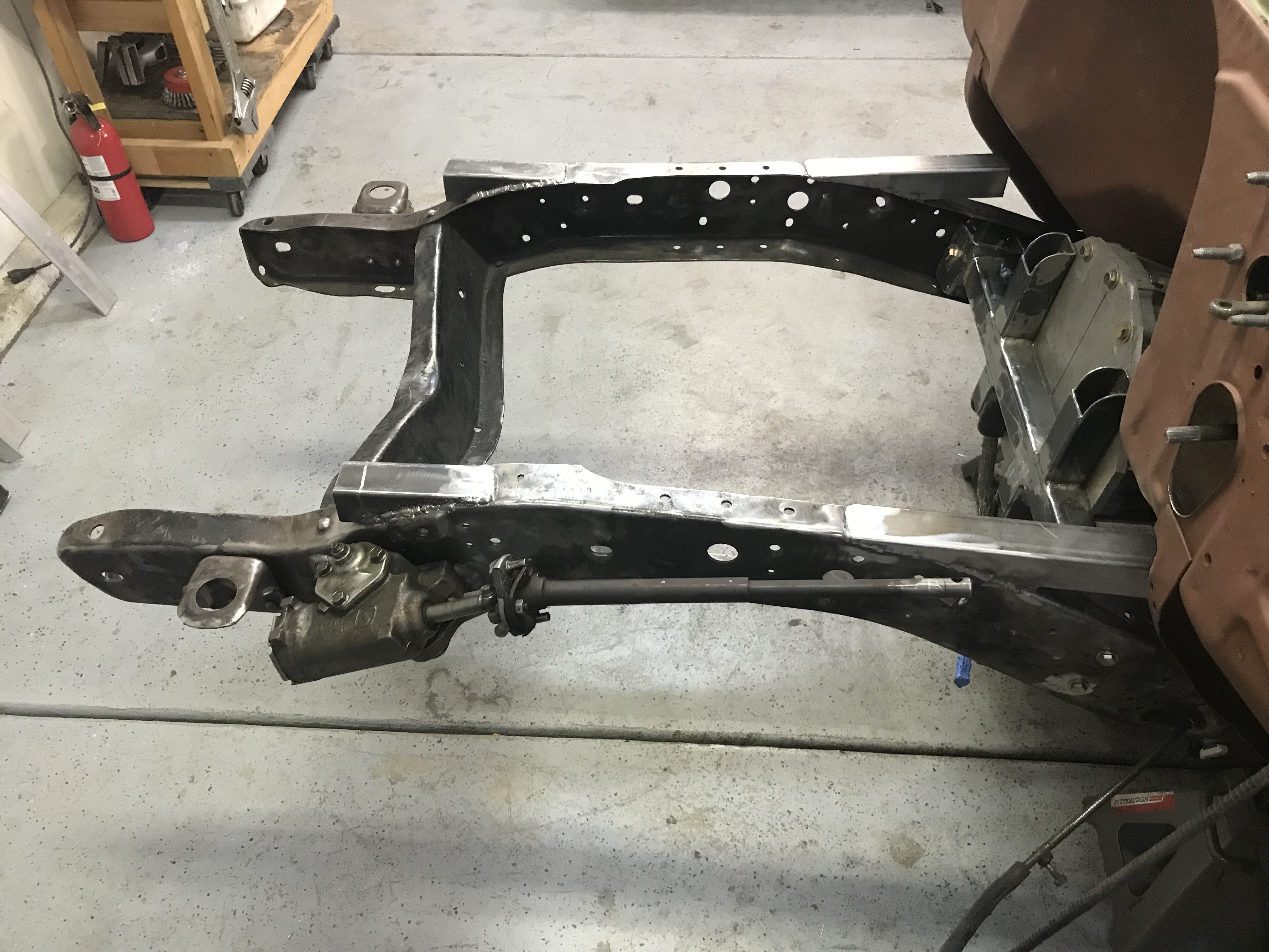

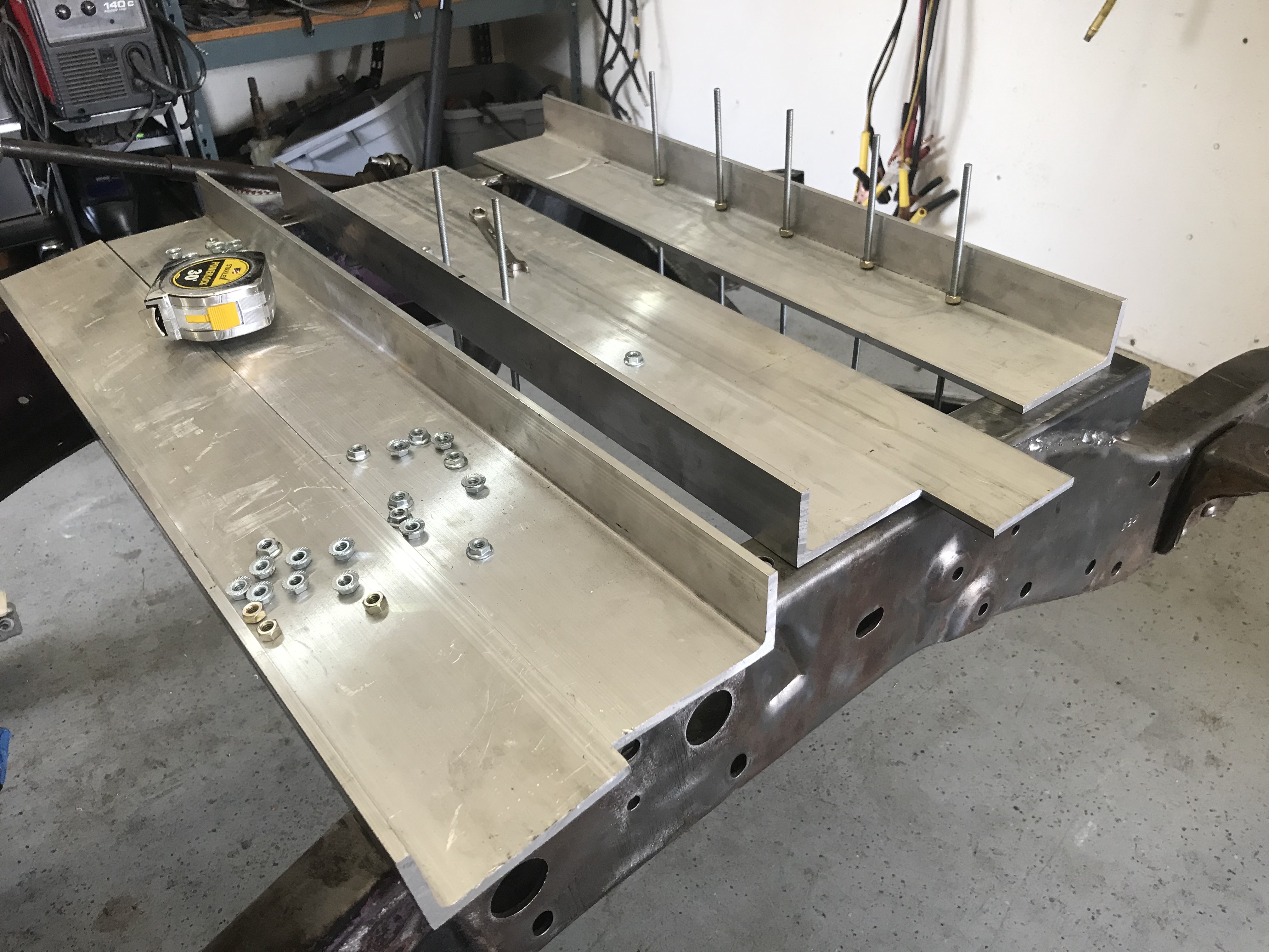

I'm a Simple Man, I see a gap... and I fill it!
yes we did run out of gas... (no literally)
but we recovered, and one side's done

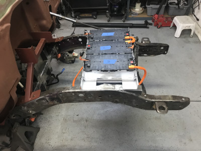

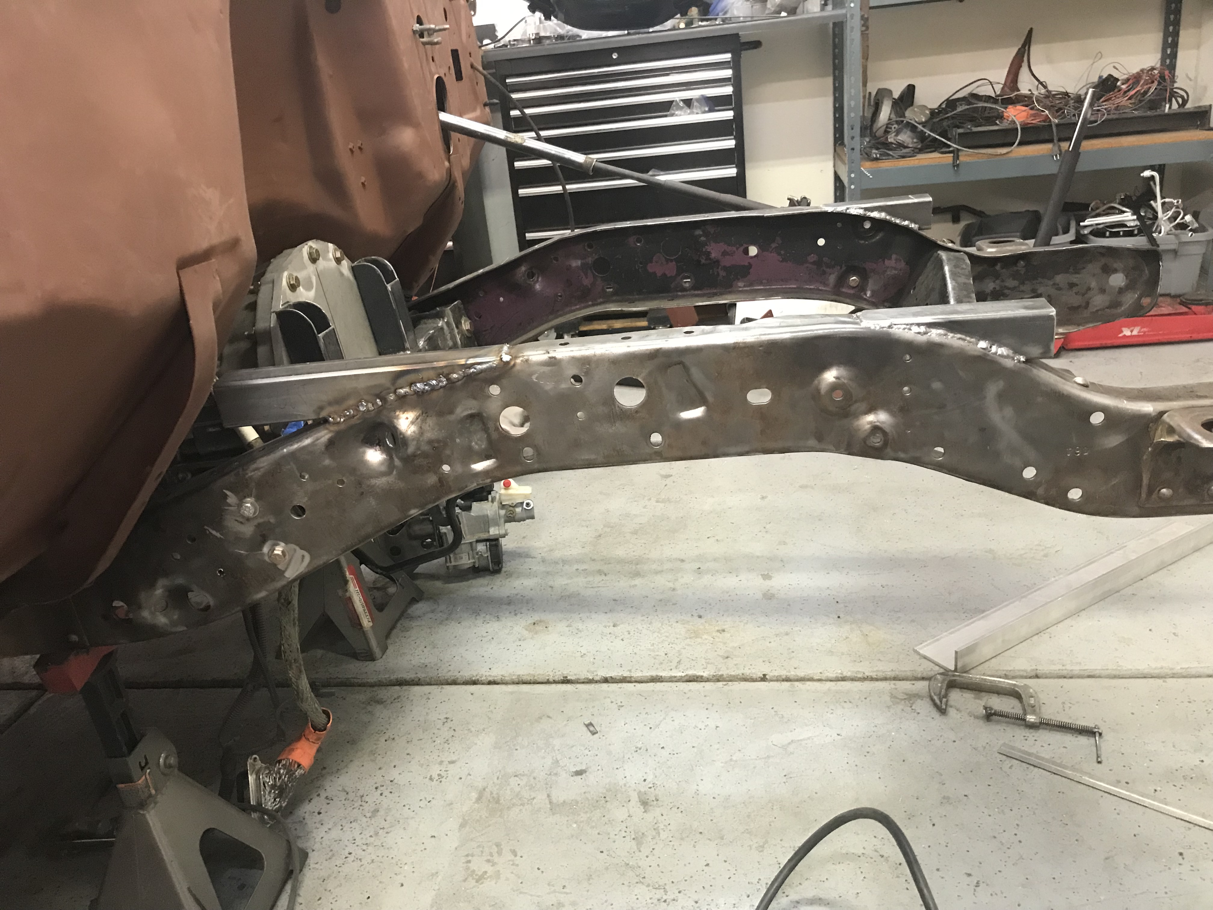

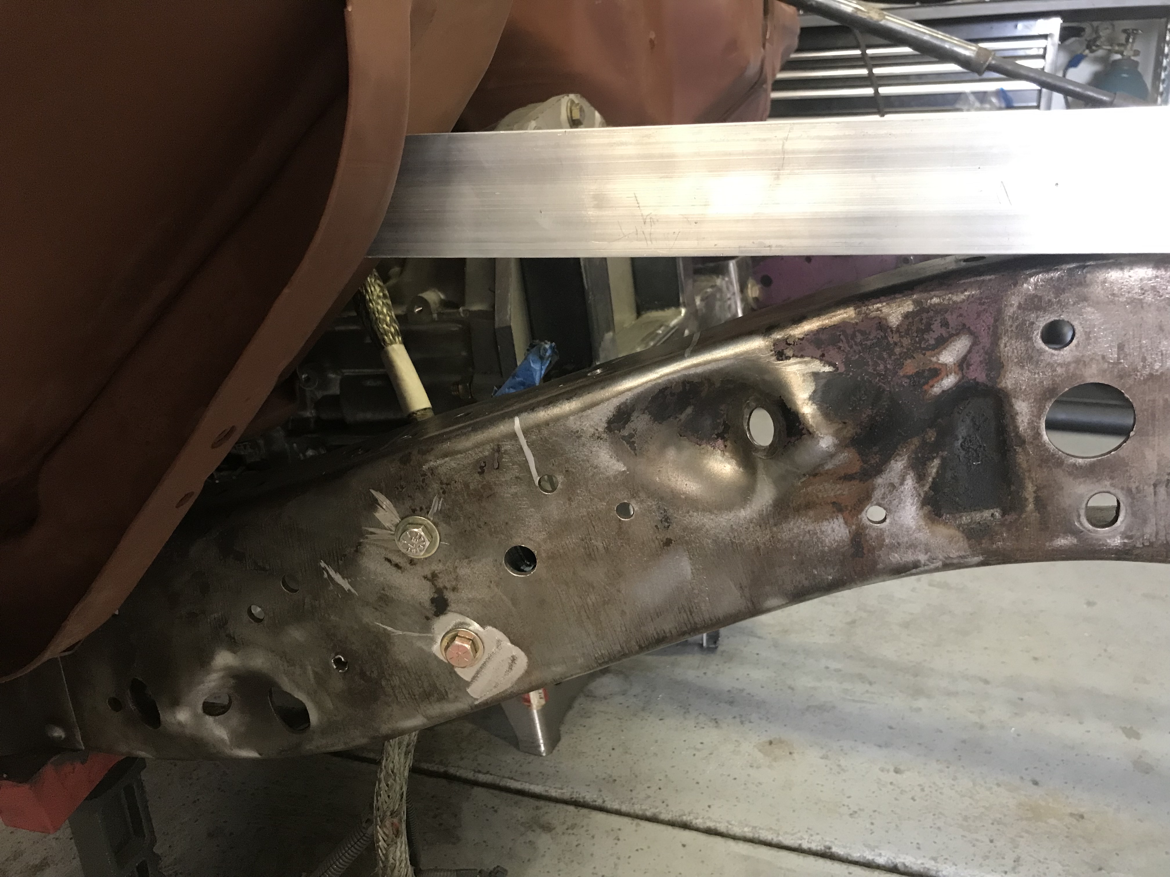

- Gregski
- Posts: 3157

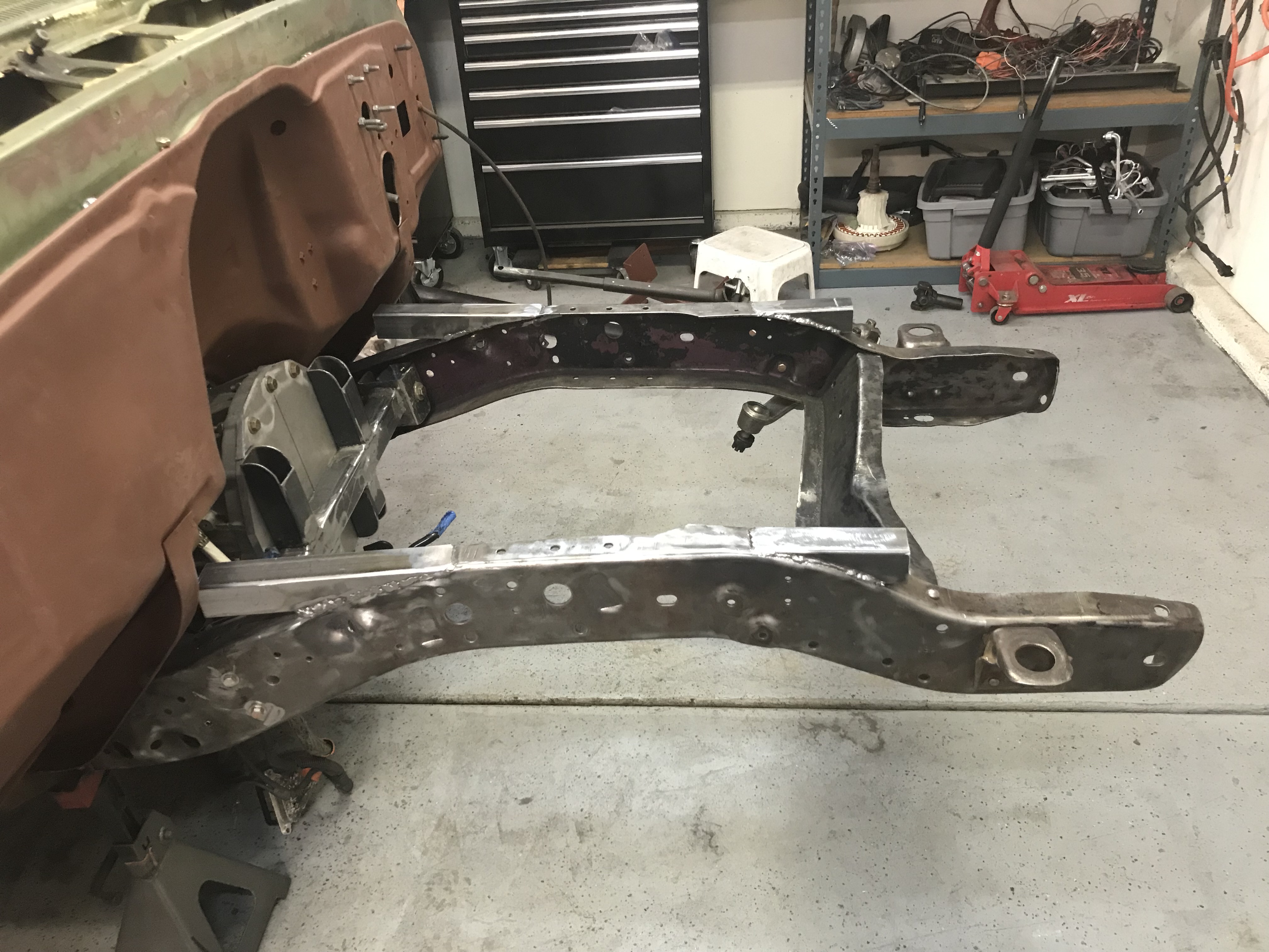

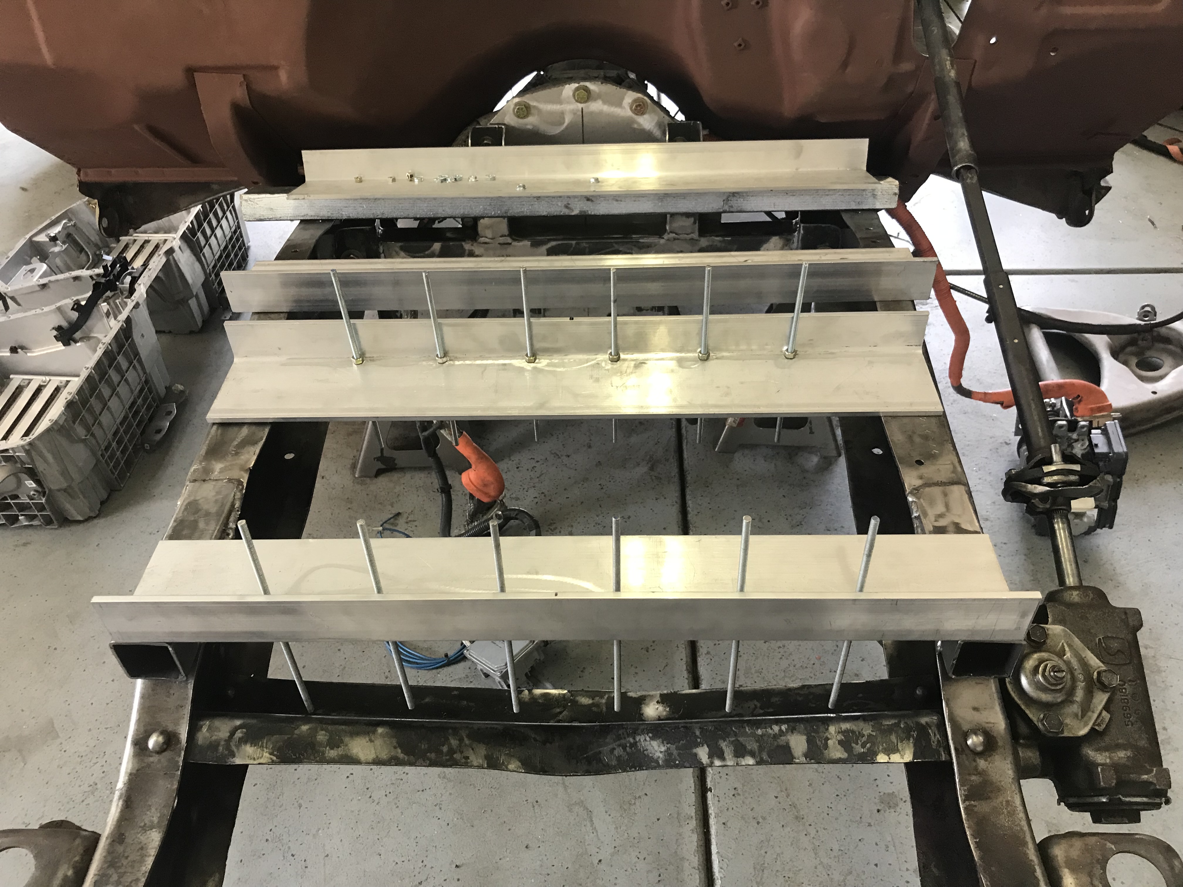

and onto the other side, having the frame rails level now is a total game changer
man I love a clean canvas

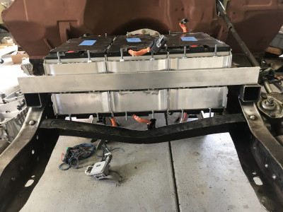

- Gregski
- Posts: 3157

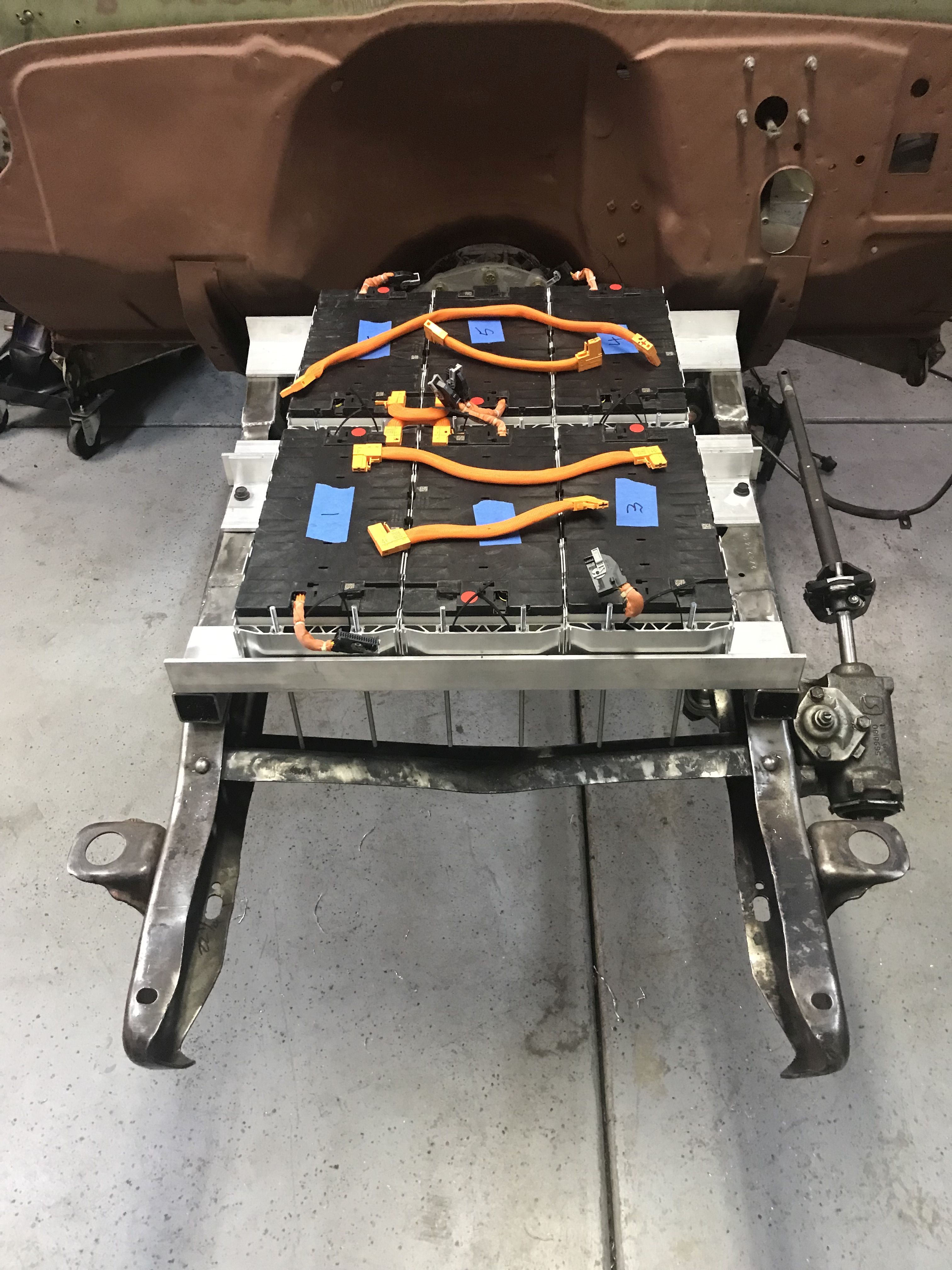

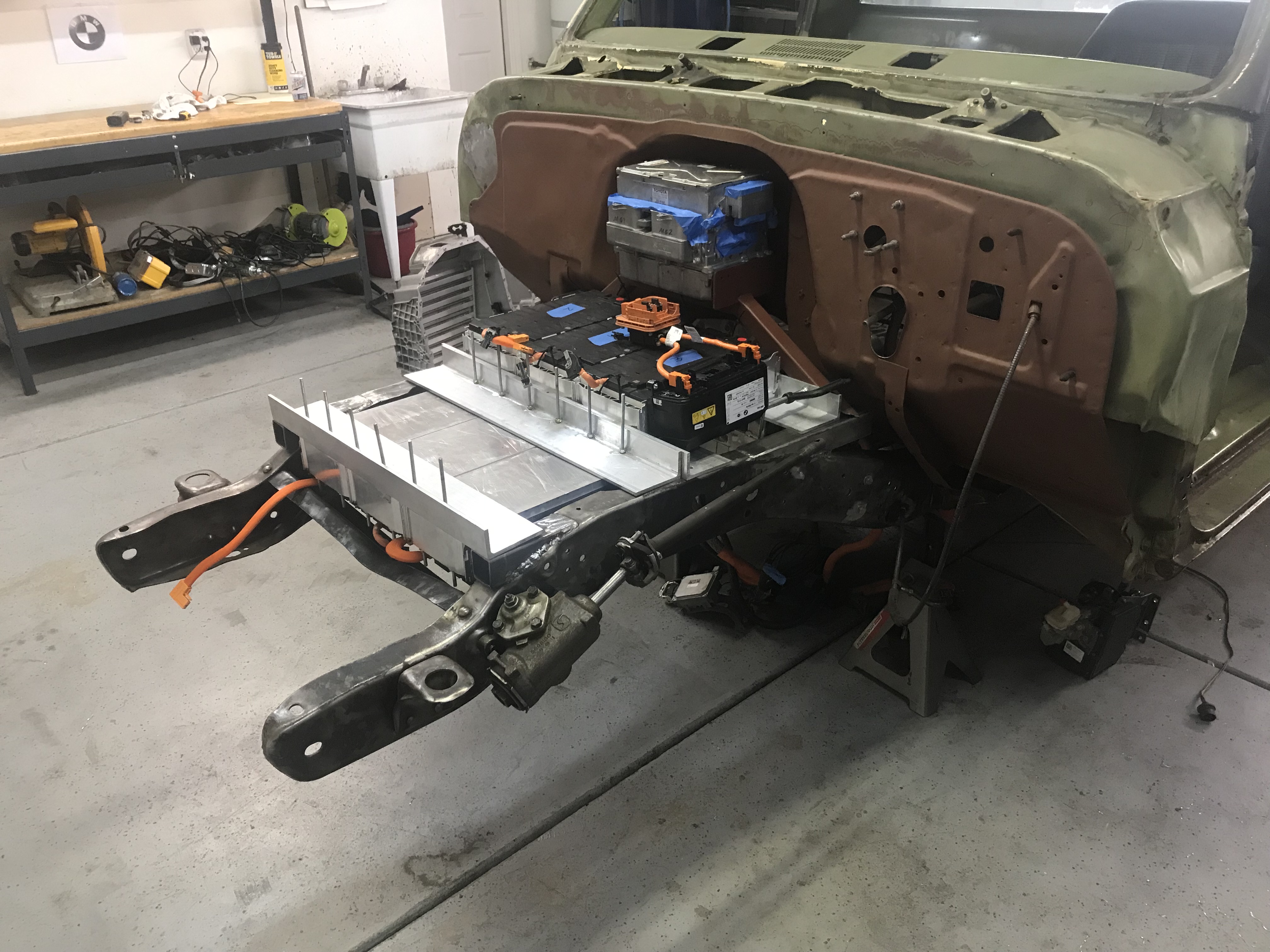

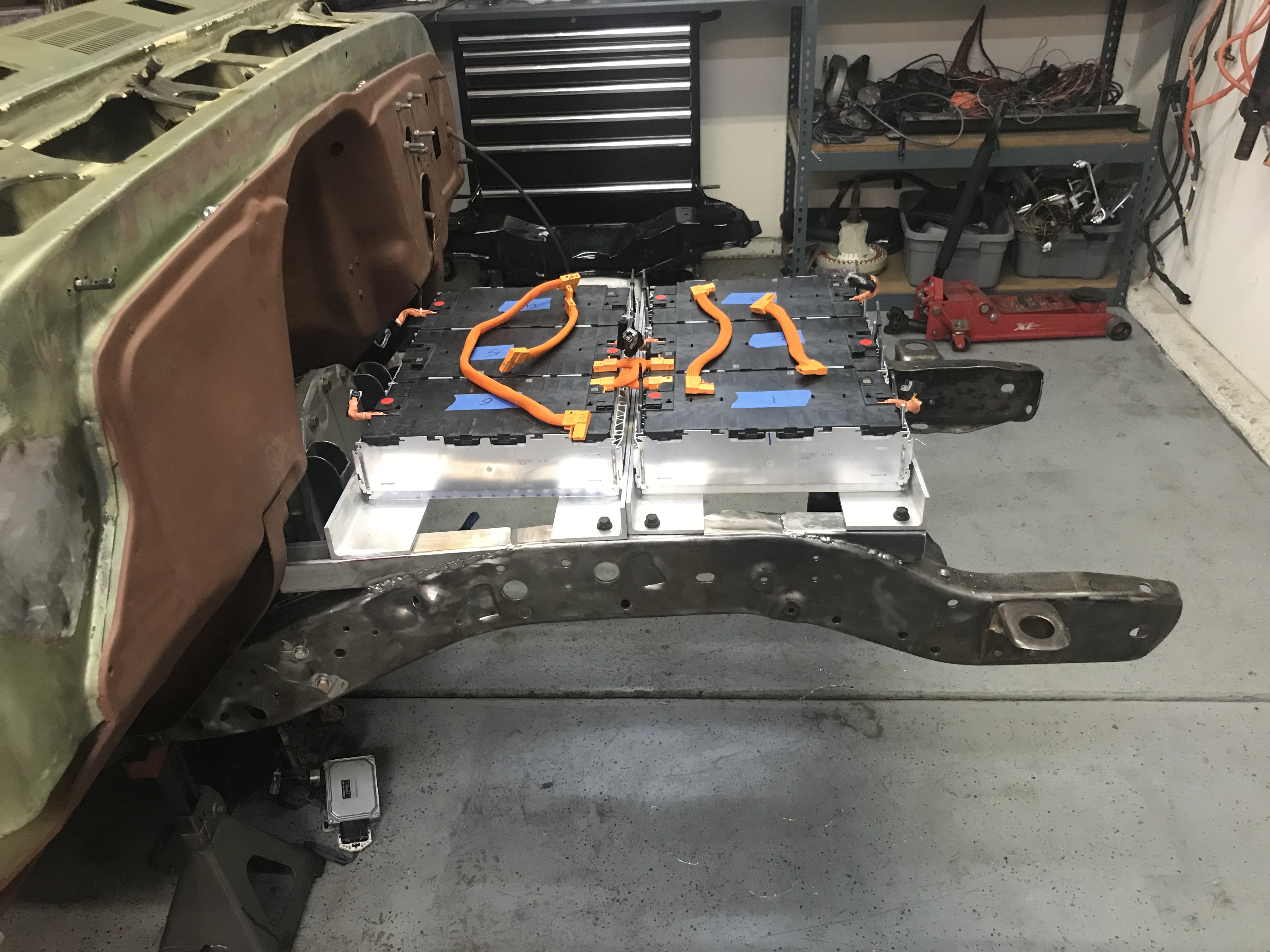

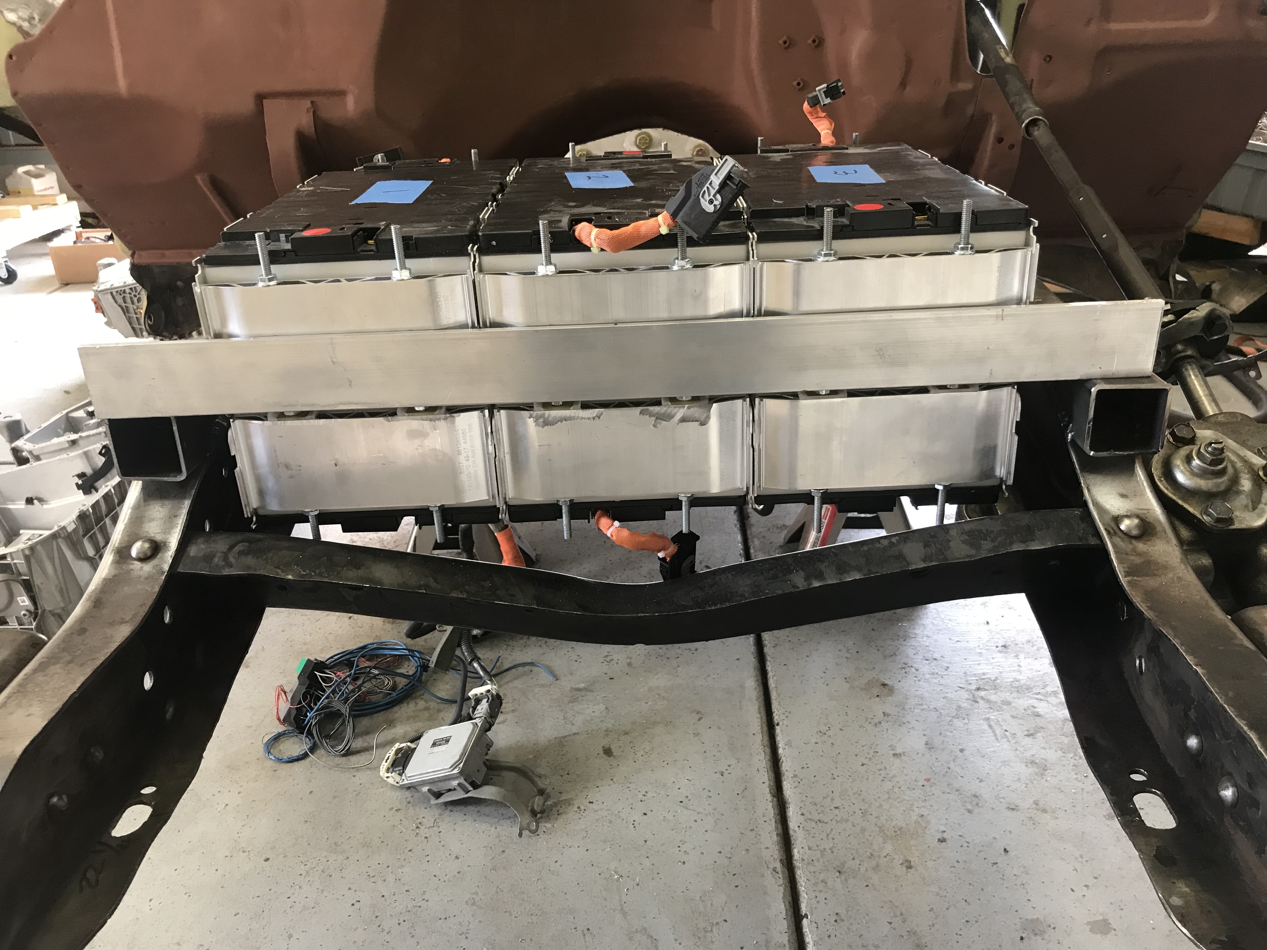

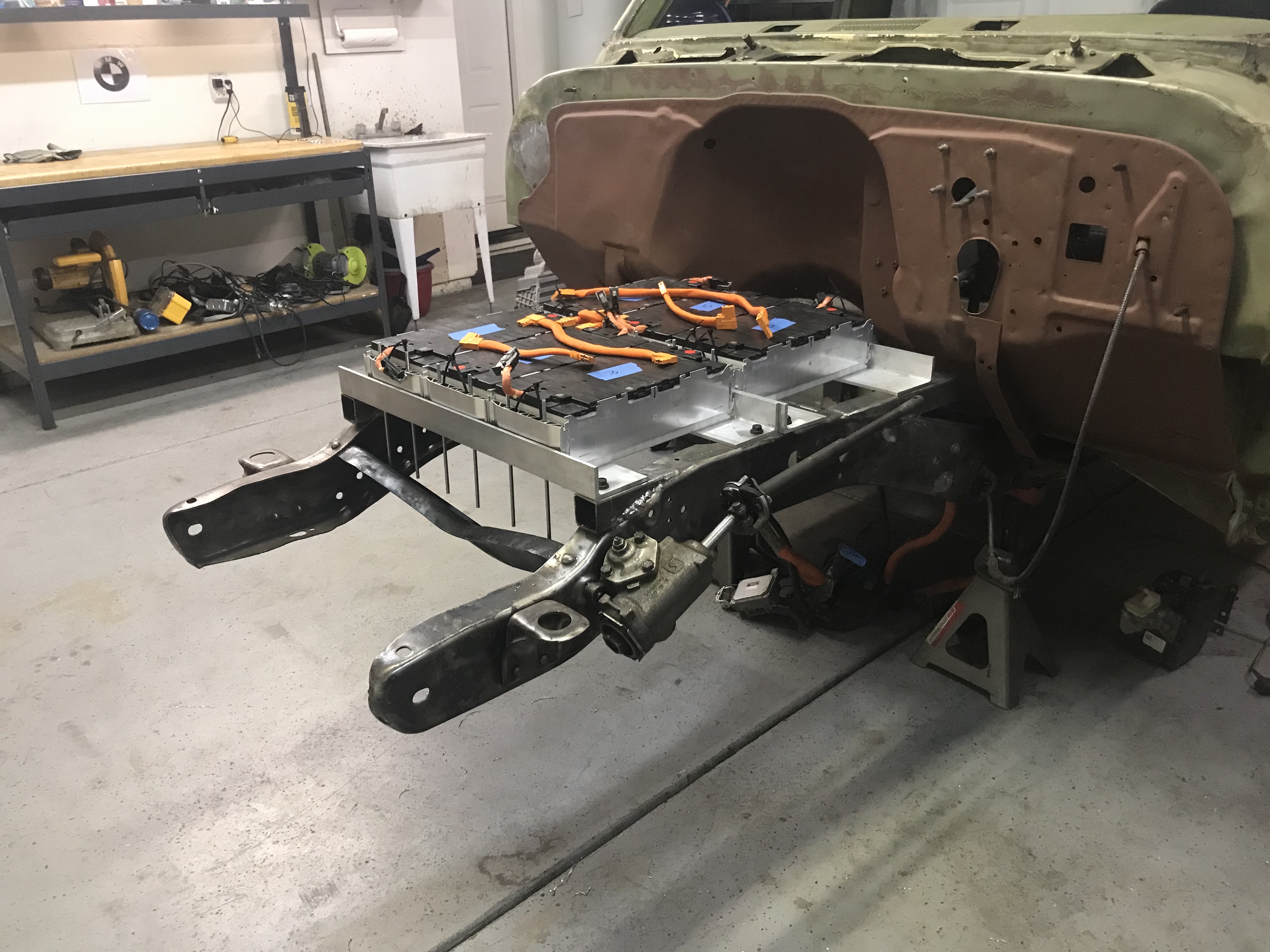

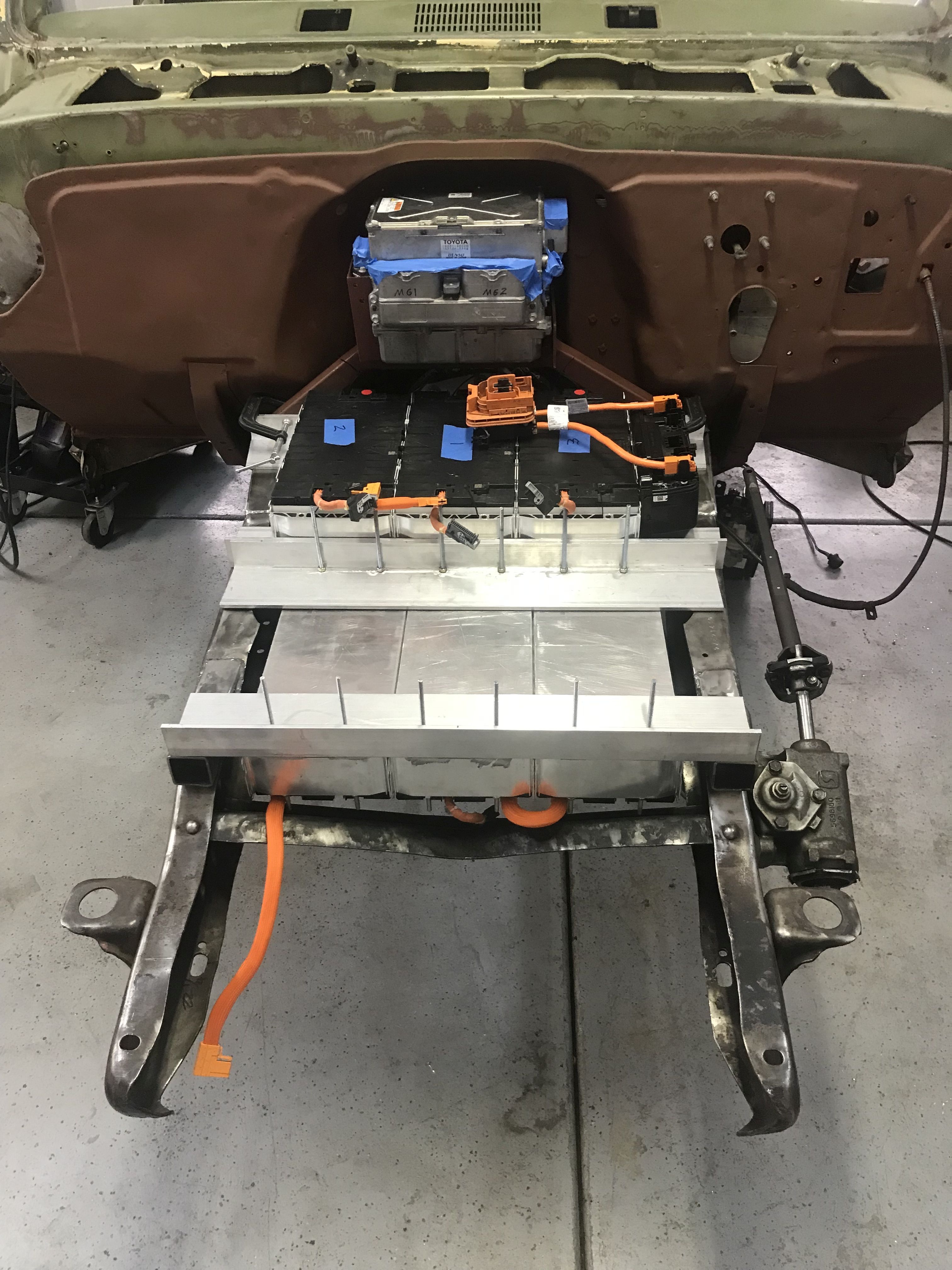

alright, let's load 'em up proper
- Gregski
- Posts: 3157

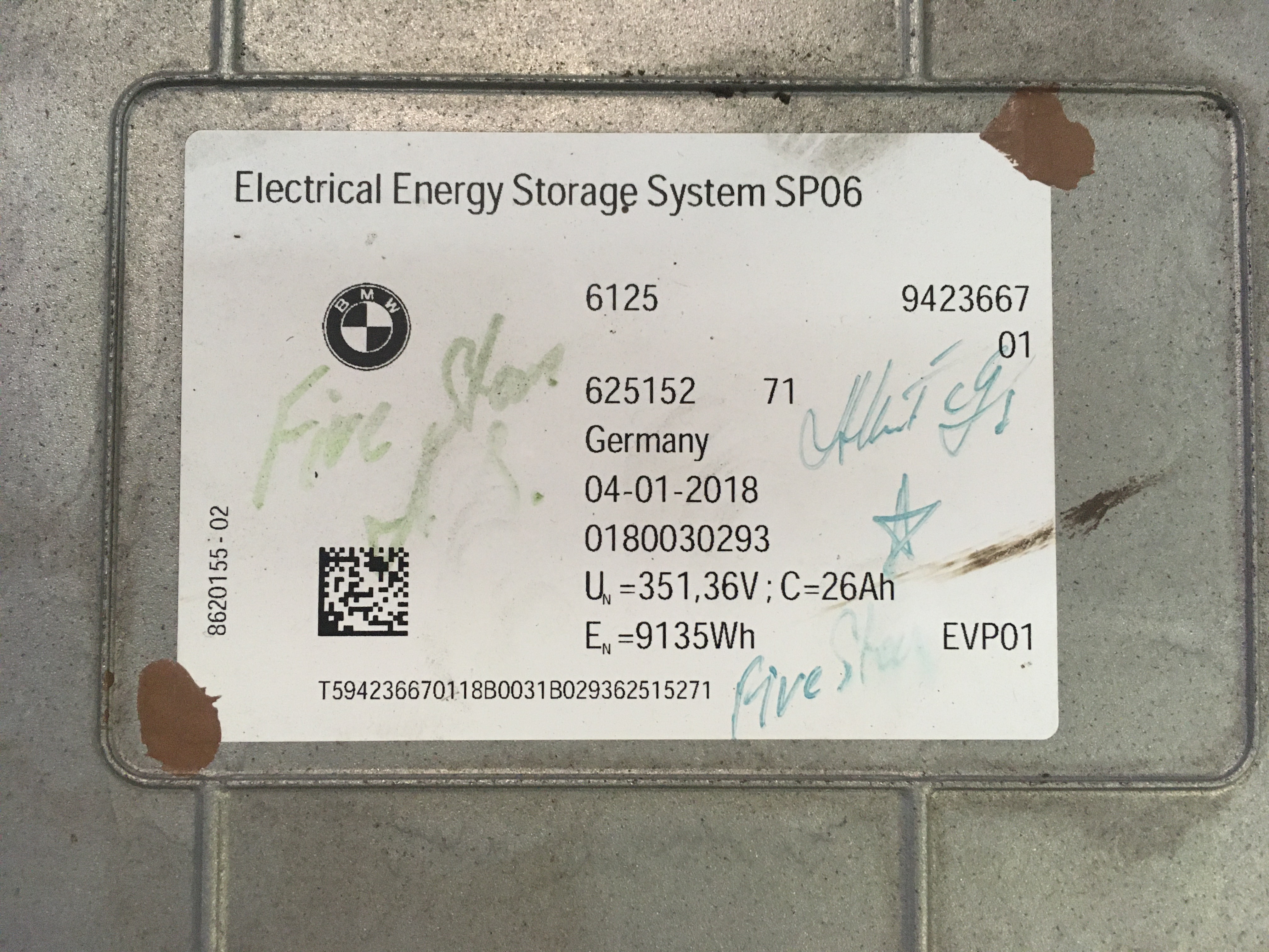

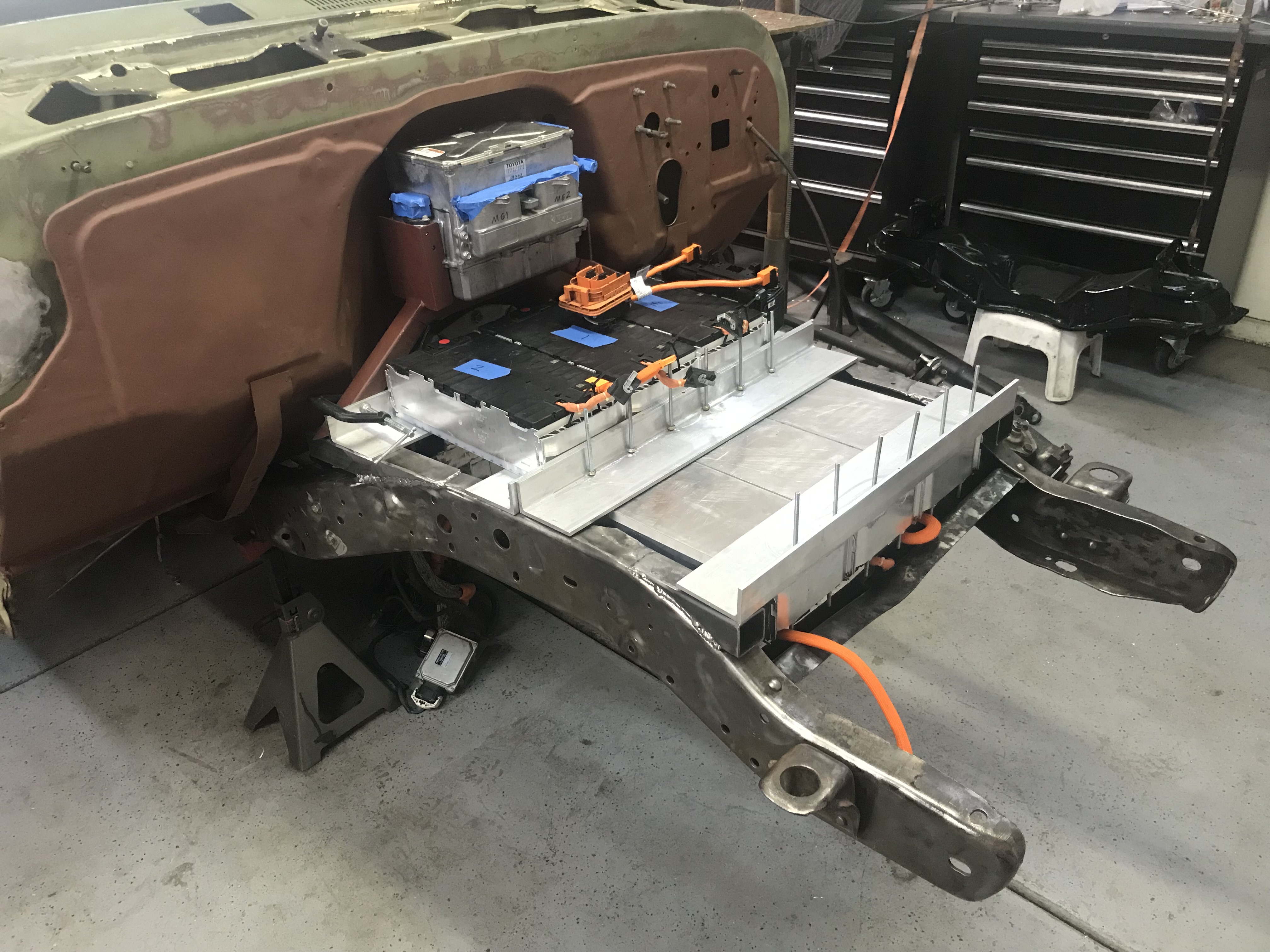

now I currently only have one pack installed here, but hopefully you'll get the idea how this design is meant to hold two of them, six cell modules on top and anther six upside down
- TheSilverBuick
- Posts: 187
- Has thanked: 3 times
Nice job on the Volt charger.
You're looking at 20-24 kwh of battery under the hood? Any plans for more capacity? Or did I under rate the batteries you have? I like the layout.
- Gregski
- Posts: 3157
thanks have you seen this write up I did on it: I think I CAN, I think I CAN...
only 18.2 kWh as these packs are only 9.1 each, by my guestimate 18.2 kWh times 3.5 miles per kW will give me roughly a 63.7 mile range, and my goal is 100 miles, so one more of these packs under the bed and I'm goldenTheSilverBuick wrote: ↑Tue May 03, 2022 4:37 amYou're looking at 20-24 kwh of battery under the hood? Any plans for more capacity? Or did I under rate the batteries you have? I like the layout.

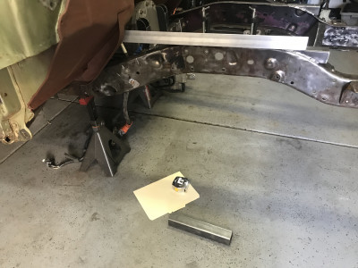

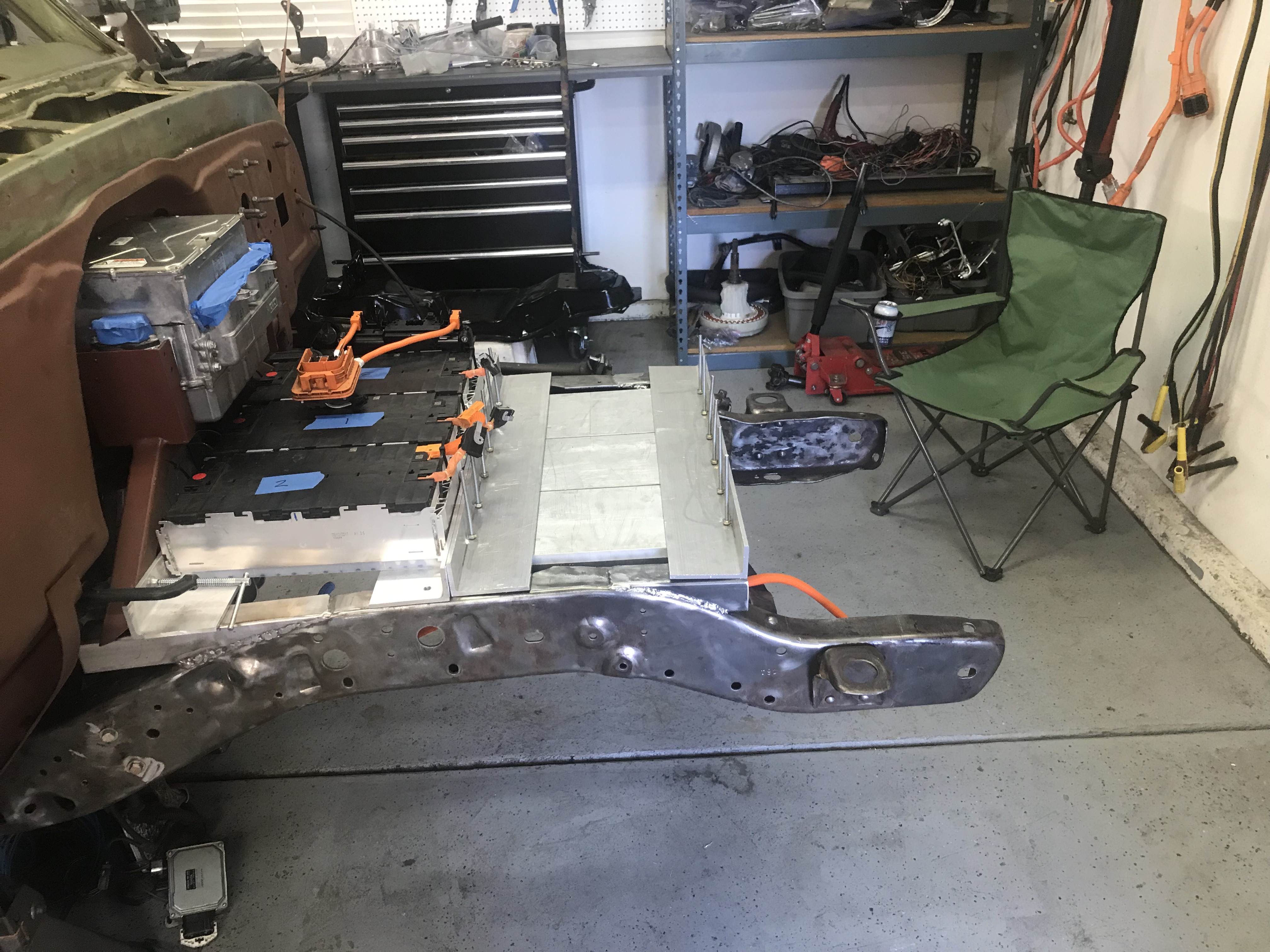

another day another mock up

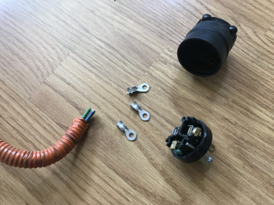

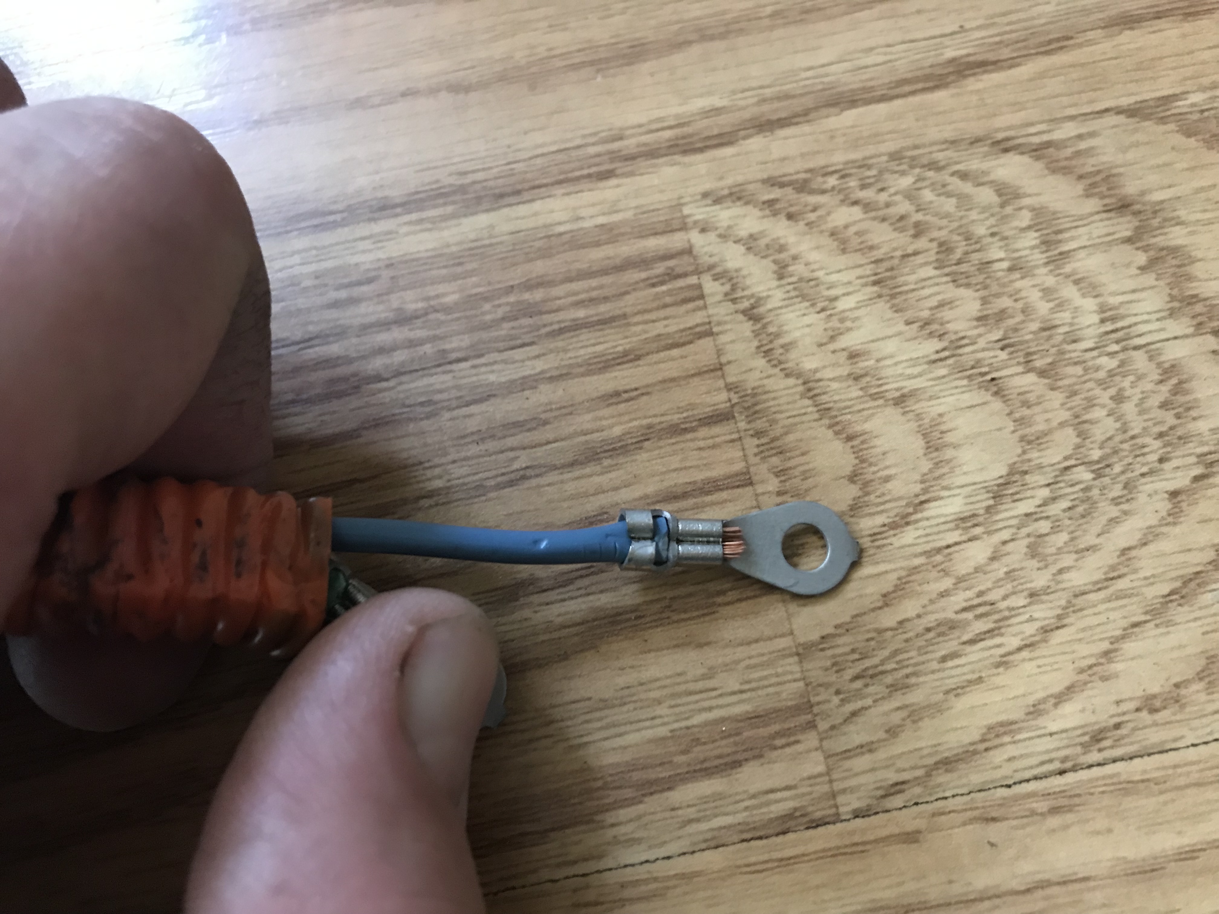

as much as I love this BMW 530e hybrid battery pack, it's Achille's heel has got to be the proprietary high voltage terminals, which call for the unobtanium plugs and wires, here I am trying to figure out how to use only the stock amount of high voltage cables to rewire it flat instead of two cell modules stacked on top like in the original implementation
