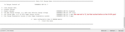

Re: Chevy Volt Gen1 Charger

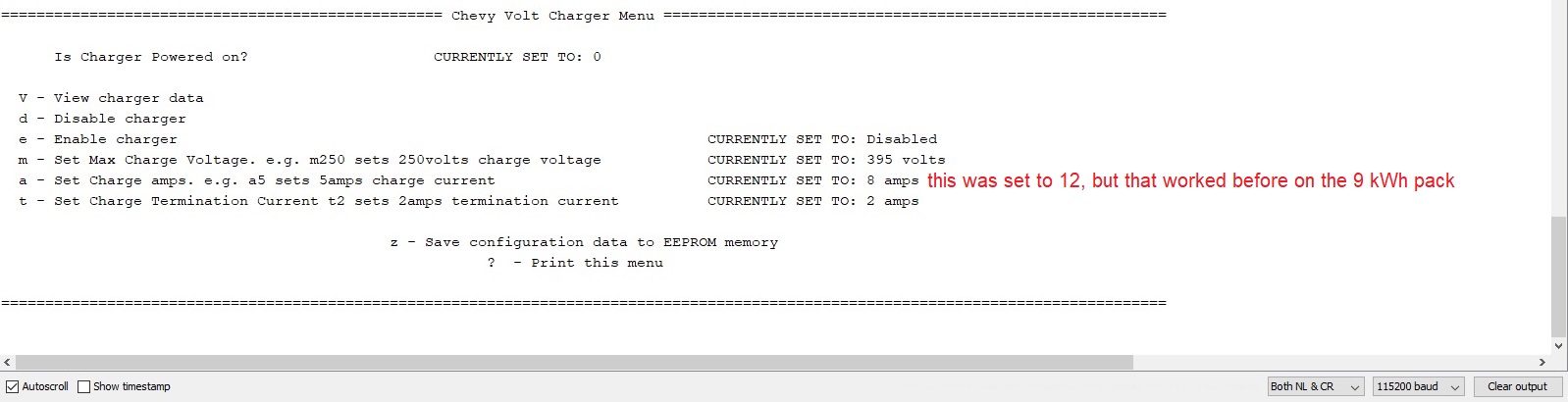

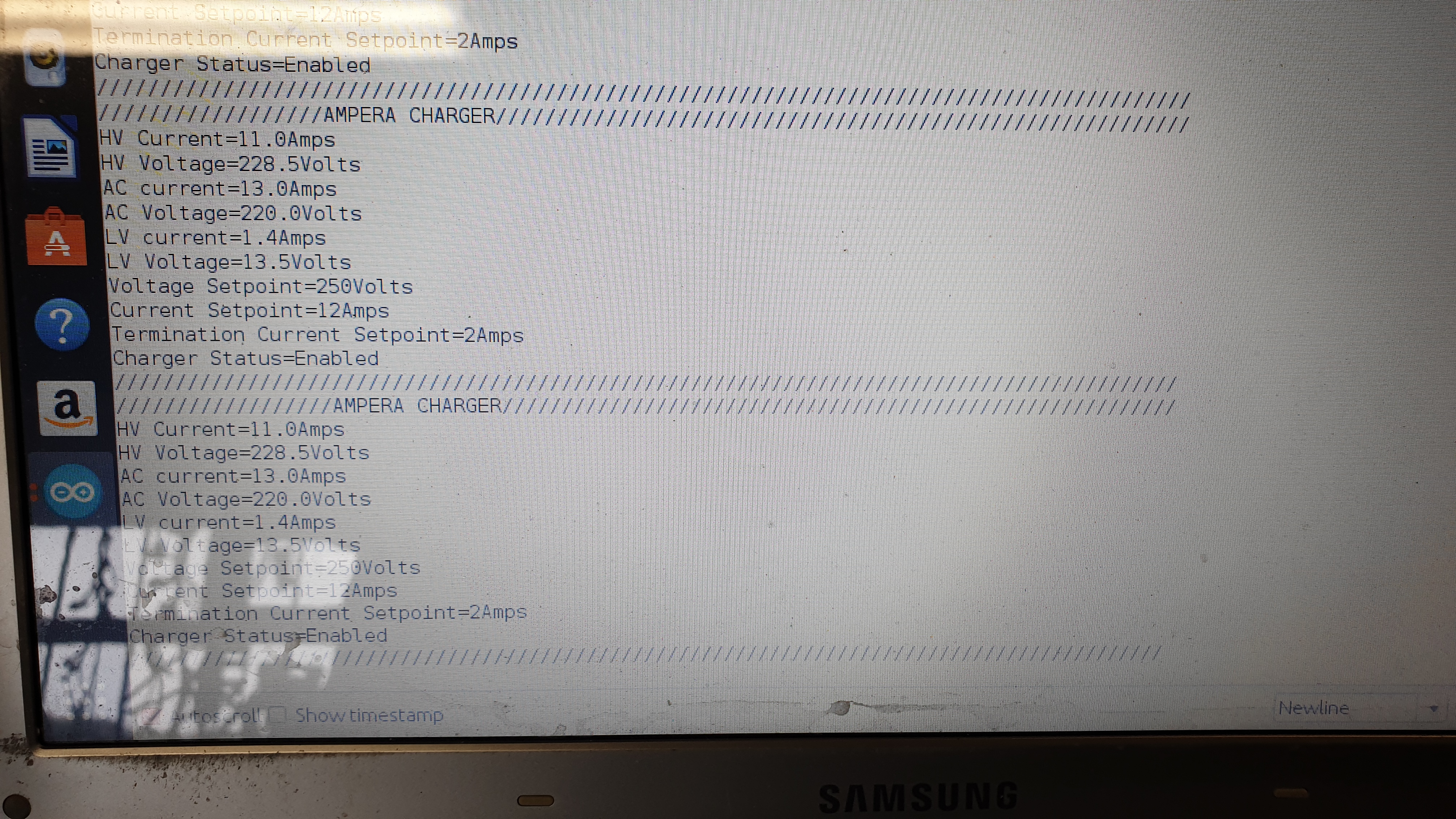

Figured I'd share this in case it helps anyone.
https://github.com/damienmaguire/AmperaCharger
Simple program to run on a due (sam3x8e) that controls an Ampera charger over a serial menu.
Confirmed working on my bench setup.
Posts: 2962
Has thanked: 328 times
Been thanked: 847 times
Jack Bauer wrote: Mon Feb 15, 2021 3:16 pm Figured I'd share this in case it helps anyone.
Good work there. :D
Have you confirmed the Canbus decoding actually yields realistic values?
Posts: 4000
Been thanked: 1114 times
Yep tested with my bench charger.

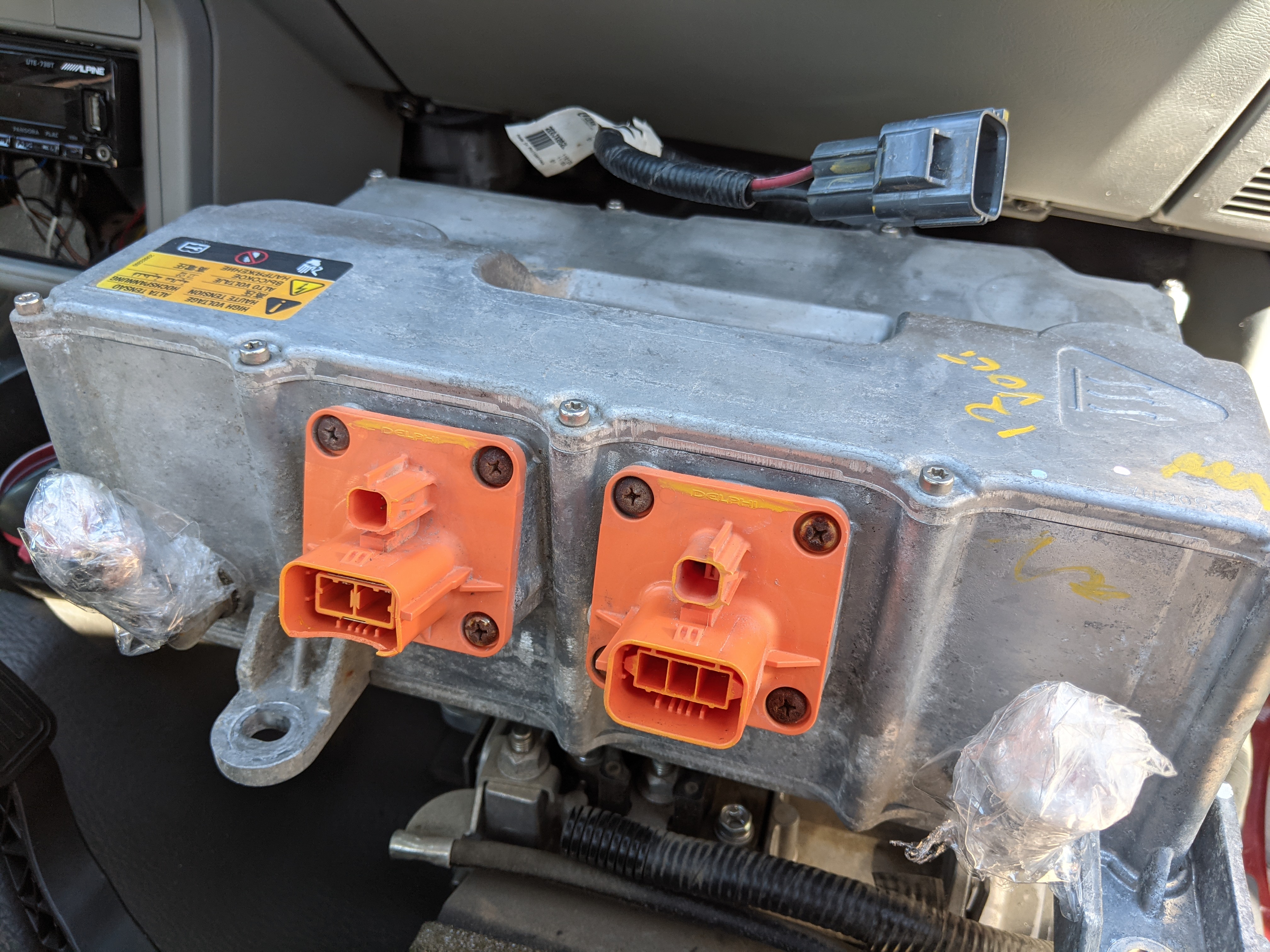

So I purchased the Chevy Volt charger, but now I need the Delphi connectors. The 2 pin connector seems to be Delphi / APTIV P/N 33107347 , but I cant find info on the 3 pin connector. Any help there?
Boxster EV
Posts: 489
Location: UK
Has thanked: 57 times
Been thanked: 50 times
Post by Boxster EV »
I tried to find the three pin last year but everywhere I looked they were NLA.
If you get a two pin one you could adapt it to fit, as the outer parts are the same. Think I might have a couple in the garage.
