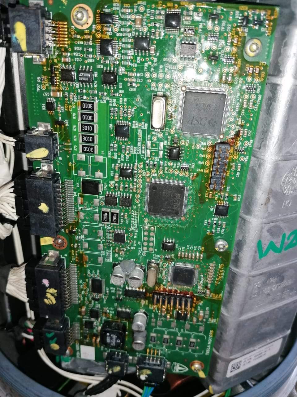

my question is can I replace the brain of the Tesla large drive unit (LDU) that is used on Mercedes b250e with the Tesla™ LDU drop-in logic board that found on the openinverter.org/shop, AND get the same function on the car?
my board brain looks like the on in the attached image

You'd have to replicate the CAN communication between the drive unit and the rest of the car. So not plug&play and certainly not a beginners project.

It is likely quite a rabbit hole with encryption going on and I have no special knowledge around B class. All I know is how to record CAN messages, how to make sense of them and how to configure the inverter to sort of replicate them. Everything else you'd have to find out and one possible outcome is that it just turns out unsolvable - as it is with experiments
thanks for replay.johu wrote: ↑Wed Oct 14, 2020 6:02 amIt is likely quite a rabbit hole with encryption going on and I have no special knowledge around B class. All I know is how to record CAN messages, how to make sense of them and how to configure the inverter to sort of replicate them. Everything else you'd have to find out and one possible outcome is that it just turns out unsolvable - as it is with experiments![]()

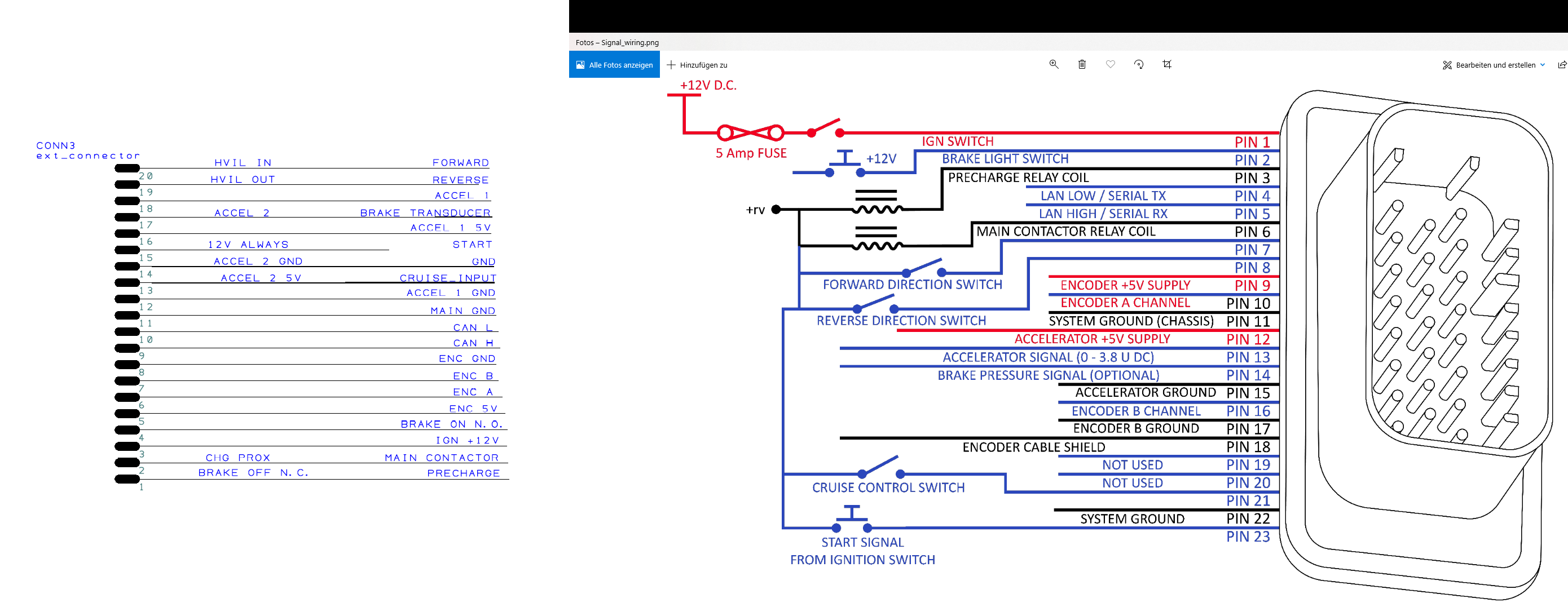

anyone know where I can find the pinout for the jst connector that comes off of my opensource board.
JST 24CPT-B-2A
trying to start soldering from the jst connector and harness to my 23 pin ampseal connector but not sure how the pinout is ordered. I do have this information.
JST 24CPT-B-2A
Did you not save the original cable between the old "Logicboard" and ampseal connector? i just replaced the board and all worked fine, do you want to make a new harness?leman2112 wrote: ↑Thu Dec 03, 2020 2:44 pm anyone know where I can find the pinout for the jst connector that comes off of my opensource board.

He's messing with a motor from a Mercedes installation.fredd90 wrote: ↑Thu Dec 03, 2020 6:19 pmDid you not save the original cable between the old "Logicboard" and ampseal connector? i just replaced the board and all worked fine, do you want to make a new harness?leman2112 wrote: ↑Thu Dec 03, 2020 2:44 pm anyone know where I can find the pinout for the jst connector that comes off of my opensource board.

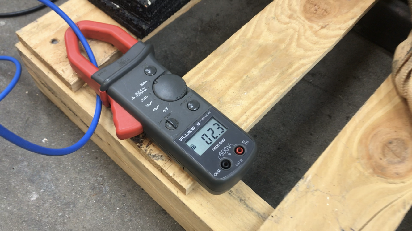

Looking to see if anyone has ideas to what is going on. Here is a rundown of where I'm at:
What is working:
1. 80v lithium ion battery - ran for a few seconds and then blew the internal fuse
2. 12v (thought backing it down would be safer) - melted 20 awg wire from negative
3. 12v - melted 16 awg wire on positive side. In this run I recorded a [1]: WARN - PWMSTUCK (parameter file attached)
4. 38v - unplugged encoder, ran in manual mode. Clunking during turning and smoke coming from jumper cables (this is the video below). No error message.
In the video below I walk through all my wiring at the end. I've quadruple checked all my wiring but I'm a novice at this so if there is something wrong please point it out. Excuse the messy wiring, I made the harnesses to length in the car and they are a mess with this test setup.
I took pictures of all the IGBTs when doing the board installation and I didn't see any discrepancies.
Video of the last run along

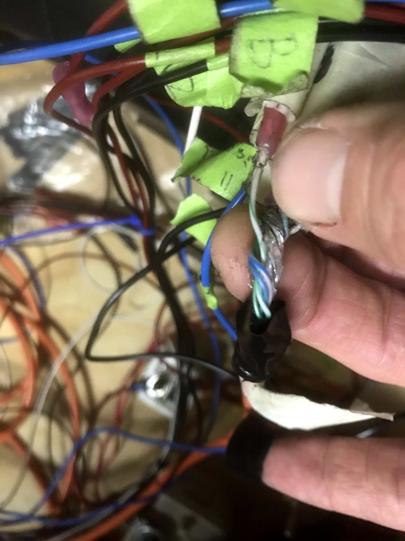

Picture of damaged encoder cable

- I found that two of my encoder plug wires were damaged during my first runs and some of the insulation may have come into contact with the shielding (this is because of several painful hours of tooling with that ampseal connector)

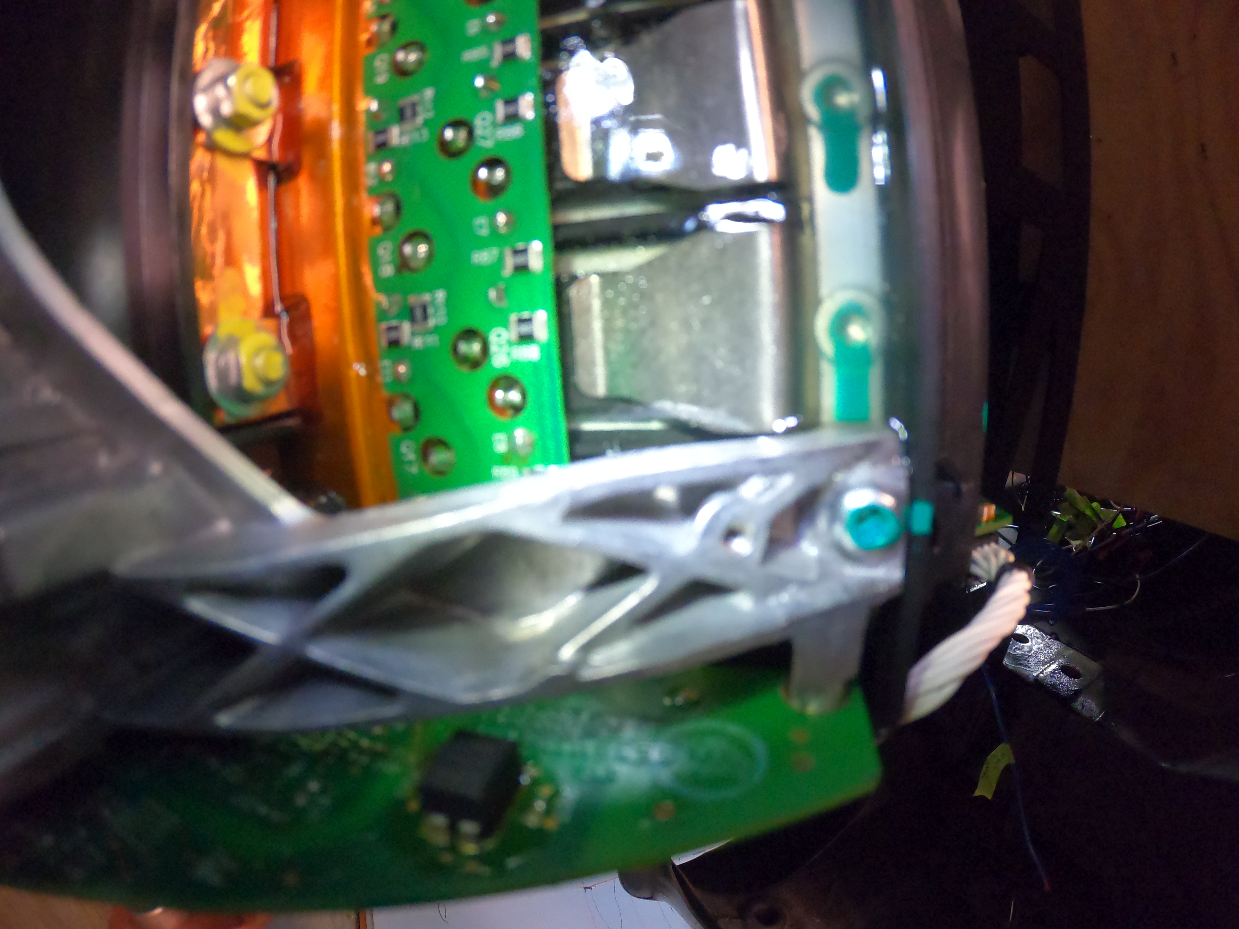

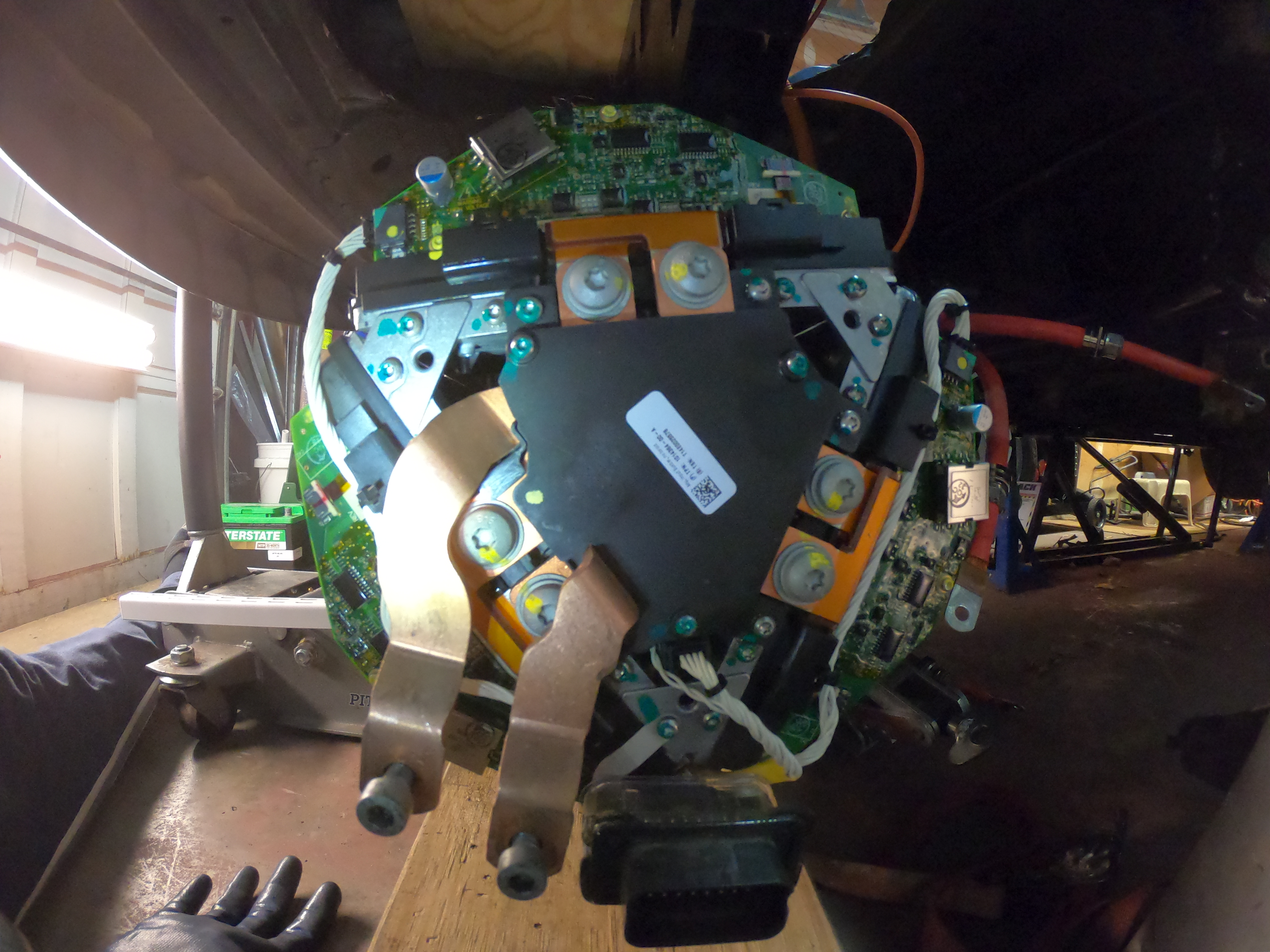

Sigh...well I dropped the drive unit out so that I could take the cover off and inspect it internally. I see small bubbles in the gel in the IGBTs, very small. No discoloring but I can see them. It's impossible to get a good picture of them because of glare. I don't think they were there before but maybe now that I'm looking closer I see them, who knows.
I'm looking for any suggestions on my next course of action. I assumed I kept melting wires because I wasn't accounting for the current that the tesla motor would pull but maybe there was another issue brewing. Is it possible that my encoder signal was all sorts of wrong so it kept telling the system to pour more current in to overcome the issue and then this lead to thermally stressing the IGBTs?
As of last test the motor was turning in manual mode, albeit clunkily.
Impossible to see in this photo but there are tiny tiny bubbles in the gel: Bratitude mentioned I should inspect the HV connections. Cursory look I don't see any obvious issues. I assume if there was a short here it would be present the second I applied HV and not be related to happening only when I press the throttle.

I just posted in your project thread before noticing this.
Is the encoder definitely wired correctly?
Does it still spin okay in manual mode?
Really needs a solid 40 and 100v dc power to turn over, closer to 100 is probably better. The motor will metallic clunking noise from the gear train if there's no load on it it. Even though you're just testing, put some 1/0 or 2/0 cable on it. Last, set UDCNOM to 0 or close to what your actual voltage is for testing. A large deviation from that is going to be manipulating values in the background.
Small bubbles in the good shouldnt really be cause for alarm. A large quantity of bubbles or ones that look like it captured a pressure wave from an exploding IGBT are reason to be concerned. If one was blown, you'd be seeing a DIN overcurrent fault.

A quick follow-up for the community on my issue in case others have the same symptoms. I did a support session with Johannes this morning and it was incredibly helpful. He connected to my board from the other side of the world and we did some quick troubleshooting. (Johannes chime in if I get anything incorrect)rjmcdermott81 wrote: ↑Mon Dec 21, 2020 4:56 am Issues:
- Motor runs but clunks. Sounds like what people described was happening when the A/B signals were swapped
- MAIN ISSUE - every time I run it, it overheats whatever wiring I have connect to the high-voltage side. This last run I had thick wiring so I'm worried there is a bigger problem
The root cause was that my board wasn't getting any signal from the encoder at all. This was a quick fix because I was suspicious that I didn't have the pins fully engaged. It's possible that because there wasn't a signal coming from the encoder, the motor kept pulling more current to spin which overheated my under-spec'd wires.
We ran the test with 60v (5 x car batteries) and 2/00 wiring on the HV side. Everything is now working great.
In hindsight, if I had to do it all over again I would pay for a few hours with Johannes to be there for the first test runs. Really great resource to have. Thanks Johannes!
