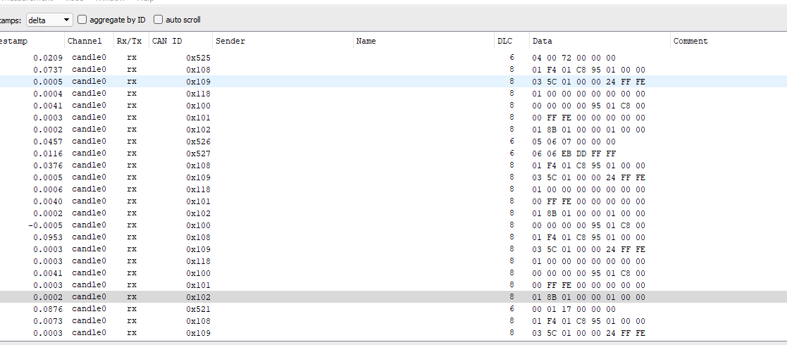

I took a quick CAN log today, unfortunately the software i'm using won't convert to an easily readable file. Here is a screenshot from after the isolation test and the contactors were closed. I need to read up on chademo protocol, but it seems like the controller isn't sending any current request.

Can your software load DBC files? Might be easier to debug with the frames interpreted
https://github.com/dalathegreat/leaf_ca ... AN_ALL.dbc

Nope. I'm using Cangaroo, with a canable dongle.. I'll look into something a bit better.

Dusty4 wrote: Thu Jul 07, 2022 1:36 pm Nope. I'm using Cangaroo, with a canable dongle.. I'll look into something a bit better.
For can sniffing try https://www.savvycan.com/

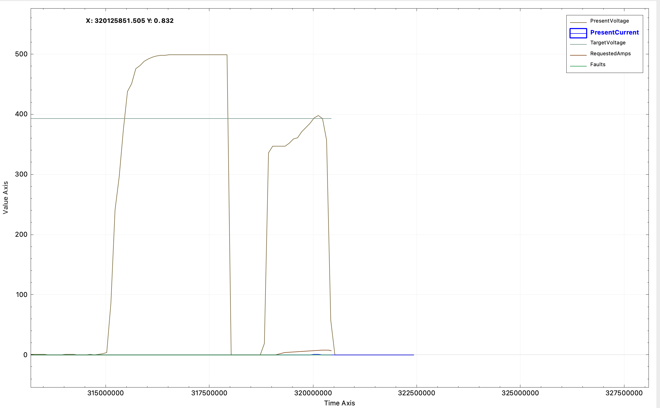

Still having Chademo issues, I've managed a couple of sessions, but more often than not I get failures.
I hear the lock in the connector click, then my chademo contactors click closed, then they open again after 5 seconds or so.
Any pointers?
EVSE:fault code 27 Abort, then EVSE:fault code 26 Abort. then EVSE:fault code 22 Abort.

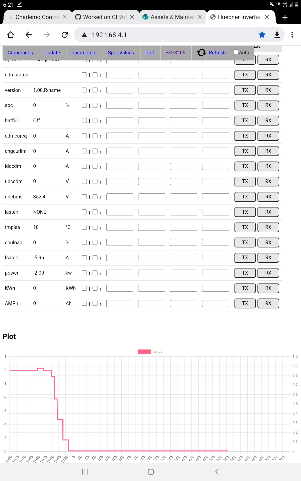

The same happened to me couple of posts back. I solved that by first changing ISA direction (simply turned it over) and later i reprogrammed it via CAN to show negative current when charging. It seems it works on all but one ultra fast EVSE.

The EVSE never reports any current flow, Im not sure that's the issue, but can give it a go. I'm wondering if I've got a dodgy pin in the inlet.
*EDIT* My shunt already reports positive for discharging and negative for charging.
Current = Sensor.Amperes;
to
Current = Sensor.Amperes * -1;
I assume?

Not so easy... i tried the same and failed. Out of desparation i reversed the shunt physicaly. It worked! Then i went to reprogram ISA shunt so i could have good mounting for the shunt. Correct orientation is what solved it for me.
Yes, there was still the case of explicetly declaring CAN msg as not extended! That did also help.

It's strange, the station matches my voltage then just goes right up after requesting a small amount of current. Sort of like the conactors have opened.

Charging worked again on other units, but the Instavolts still refusing to go, same deal, they switch IN2 first, that doesn't prevent it carrying on to closing the contactors but current doesn't seem to flow despite requesting so.
Forgot my can logger again, doh.
12:10:16.010 -> CAR: Protocol:2 Target Voltage: 393 Current Command: 14 Target Amps: 50 Faults: 0 Status: 1 kWh: 6.61 Time:0:0:49.708
12:10:16.082 -> CAR: Absolute MAX Voltage:400 Pack size: 18.00 Time:0:0:49.783
12:10:16.117 -> EVSE: MaxVoltage: 950 Max Current:78 Threshold Voltage:475 Time:0:0:49.791
12:10:16.117 -> EVSE: Measured Voltage: 352 Current: 0 Time remaining: 0 Status: 100100 Time:0:0:49.791
12:10:16.154 -> CAR: Charging Time Time:0:0:49.857
12:10:16.192 -> EVSE: MaxVoltage: 950 Max Current:78 Threshold Voltage:475 Time:0:0:49.891
12:10:16.192 -> EVSE: Measured Voltage: 352 Current: 0 Time remaining: 0 Status: 100100 Time:0:0:49.892
12:10:16.230 -> CAR: Protocol:2 Target Voltage: 393 Current Command: 15 Target Amps: 50 Faults: 0 Status: 1 kWh: 6.61 Time:0:0:49.933
12:10:16.301 -> CAR: VCU Wake Up Time:0:0:49.991
12:10:16.301 -> JLD505: 351.301v -0.54A 24.7Ah -0.2kW 6.6kWh OUT1:1 OUT2:1 OUT3:1 IN1:1 IN2:0 POS:Cl NEG:Cl CHG T: 4
12:10:16.301 -> Chademo Mode: 6
12:10:16.301 -> EVSE: MaxVoltage: 950 Max Current:78 Threshold Voltage:475 Time:0:0:49.992
12:10:16.301 -> EVSE: Measured Voltage: 352 Current: 0 Time remaining: 0 Status: 100100 Time:0:0:49.992
12:10:16.336 -> CAR: Absolute MAX Voltage:400 Pack size: 18.00 Time:0:0:50.7
12:10:16.336 -> Stopping chademo process.
