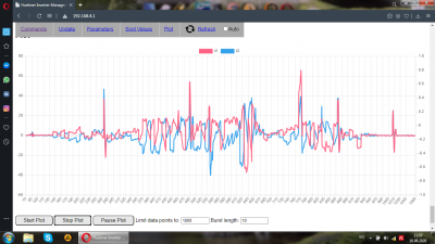

So, it runs smooth but only in reverse.Only in MGR reverse. If only schaft starts spin forward, and accelerator is released, motor starts to jump uncontrolled. It happens only if I release accelerator. What could it be?

konstantin8818 wrote: ↑Fri Aug 14, 2020 5:06 pm So, it runs smooth but only in reverse.Only in MGR reverse. If only schaft starts spin forward, and accelerator is released, motor starts to jump uncontrolled. It happens only if I release accelerator. What could it be?
Following on from Damiens post can I suggest you video the tuning process you are following? It was clear from last weekends workshop that you must be thorough and maybe something in the procedure is open to misinterpretationDylan Witt wrote: ↑Sat Aug 15, 2020 11:13 am having the same problems im having, i still dont know what is causing the problem. goes good reverse but shakes the entire car going forward

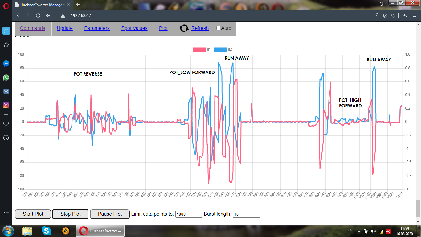

Ok, lets pretend ,I believed Martin1775 blindly and set polepais to 2 and respolepairs to 1, and connected U,V,W of inverter straight to U,V,W of MGR.
I've used Damien's custom Prius GEN3 FOC software, and pwmswap was already set to "PWMoutput13"
When I reached syncofs from 0 to 22000 even manualid of 300 Amps couldn't move rotor, all it did only jitter a little, at 21850 it only did whining noise, and didn't move at all, from gas pedal however in forward it run away....
Here are parameters I read:
id and iq while running smooth from accelerator pedal in reverse: il1 and il2 while running smooth from accelerator pedal in reverse: il1 and il2 when running smooth in reverse, when running smooth forward at high speed and in run away when accelerator is released: No matter the direction, position caprure seems good in both directions: and video of process. Sorry for my English
hard to think at two languages at once
So problem #1 is to find out correct value of respolepairs and polepairs... and max_motor_current

I managed to spin it smoothly with this set of parameteres. FW: 4.87R FOC.
I have checked/measured the resolver pole pairs for the MGR and to my understanding, 2 is the correct value.
Also motor pole pair is 4.

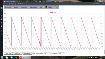

When I did the syncofs test my motor started spinning at manualid = 20, if it was offset (0 or 32768 was the ones for me). Using a 36V 44A power supply to power the inverter HV side.
In manual mode when I spin the driveshaft flanges in forward direction the angle plot rises, if that makes any sens?

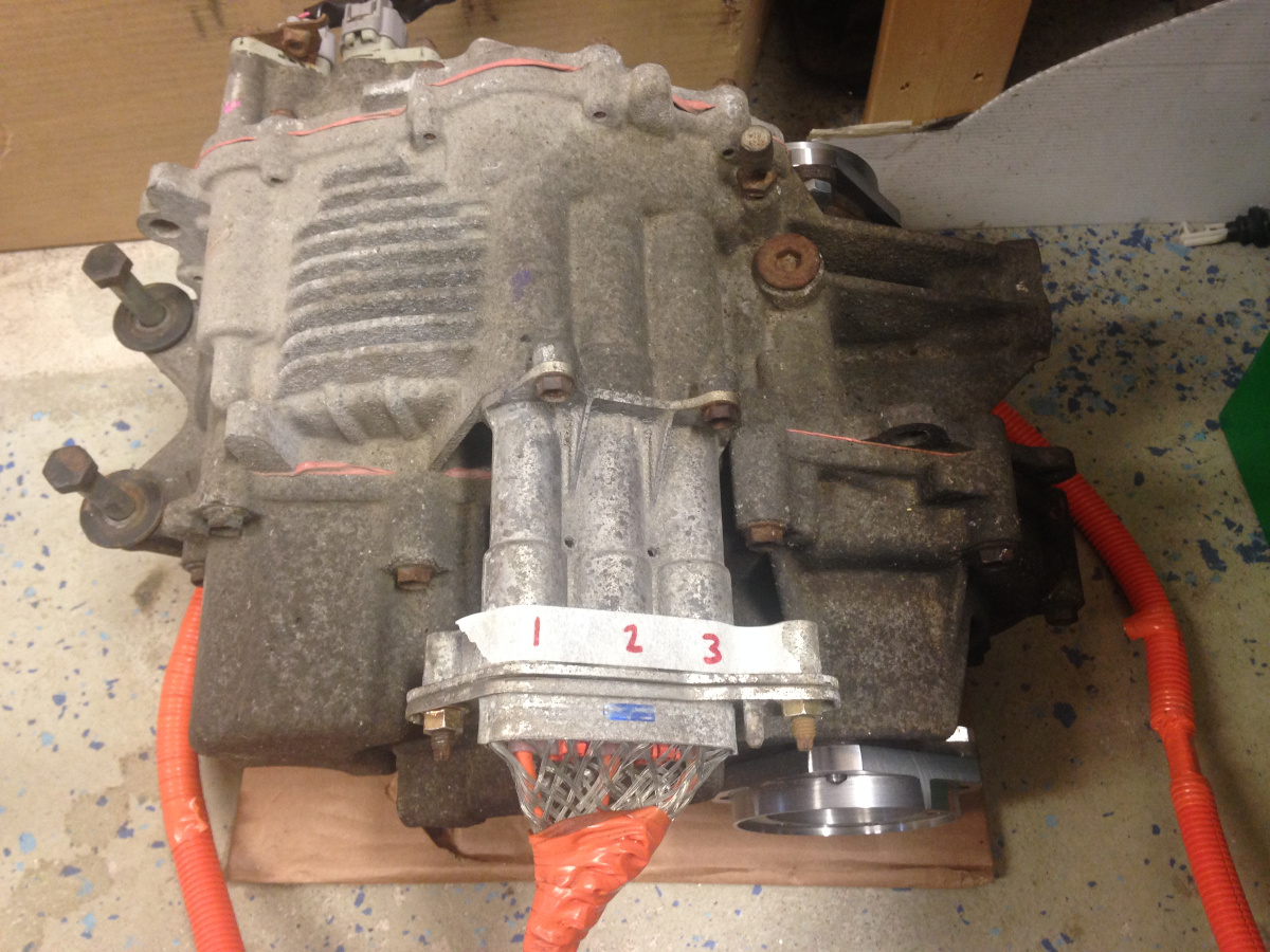

Pictures of my phase order.

I use a Yaris inverter. The current sensors are on 1 and 3.
To be clear, I use pinswap 10 which is 2+8 where 2 = Swap Resolver sin/cos and 8 = Swap PWM output 2/3.
Pinswap 8 is, as to my understanding, a must if not using Damiens special software for inverters with current sensor on 1&3.
To use both 2 and 8 you need to send command (set pinswap 10). It can not be set using the selection menu.
Strange however that you get no motion with 4.87? No errors present? Direction selection confirmed?

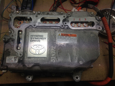

Dylan Witt
- Posts: 117
- Location: Kentucky, USA
im sure his is a yaris inverter, here is a gen three prius inverter, sorry this is all i could find on my inverter, but this is a 2013 gen three inverter time 0.15 in video..

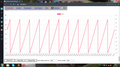

I think about resolver and motor pole pairs. One revolution of output shaft in mgr must cause 6.8 revolutions of motor rotor. I've started invertor, started revolutions plot and rotate output shaft. With respolepairs =2 it showed up to 21 revolutions. With respolepairs =6 it showed 7 revolutions per one output shaft revolution. So I believe 6 is the correct count of resolver pole pairs. And rotor started to spin only when I've set polepairs=12. With the same effect as before unfortunately...
FOC is hell of a complicated control system. It rely on accurate data. Now when I sure about correct resolver pole pairs, I'm not sure about motor pole pairs. Is it mandatory that motor pole pairs must be twice as resolver pole pairs? Or it could be any amount of them?
Does that mean that +-300 digits is accurate enough to set correct syncofs?Wiki wrote:If manualid is less than about max_motor_current/2 go back to 4. When approaching rated_motor_current/2 make your increments/decrements smaller, like down to 300 digits

I will describe in text how I concluded that resolver poleparis is 2 and motor polepairs is 4 for the MGR. If I screwed up, please let me know.
Slowly spinning the motor using sine firmware in manual mode. Check the time it takes for a complete revolution on the flanges. Say it took 5s. One revolution on the motor then takes 5s/6,86 = 0,73s.
Using a signal generator generating a sinewave at 4kHz and an opamp supplying it to the resolver excitation and then measure with the oscilloscope on one of the two resolver windings. For a time of 730ms I got 4 peaks, which I interpret as two "electrical revolutions" on the resolver, hence two pole pairs.
(Absolute value of sine will have two maxima for one revolution (0-360 degrees).)
To check motor pole pairs I now disconnect the motor phases and measure with the osilloscope between any two motor phases. Now spinning the motor by hand I got 4 full cycles of sinewave while having 4 resolver peaks. My conclusion is that for one motor revolution I got four "electrica revolutions" on the motor, hence 4 pole pairs.
Now I will, also tomorrow, try to check the actual flange/motor rpm agains the software reported rpm. If they match the resolver is at least correct.
