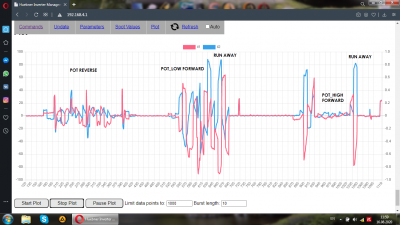

So, it runs smooth but only in reverse.Only in MGR reverse. If only schaft starts spin forward, and accelerator is released, motor starts to jump uncontrolled. It happens only if I release accelerator. What could it be?

I'm following procedure carefully, but:
I don't know what is max_motor_current, and what will happen if I exceed max_motor_current/2
Also, how incorrect value of polepairs and respolepairs will affect tuning process.
That is all, actually.

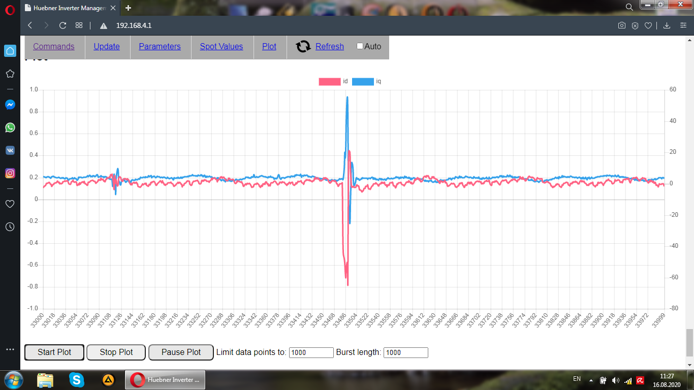

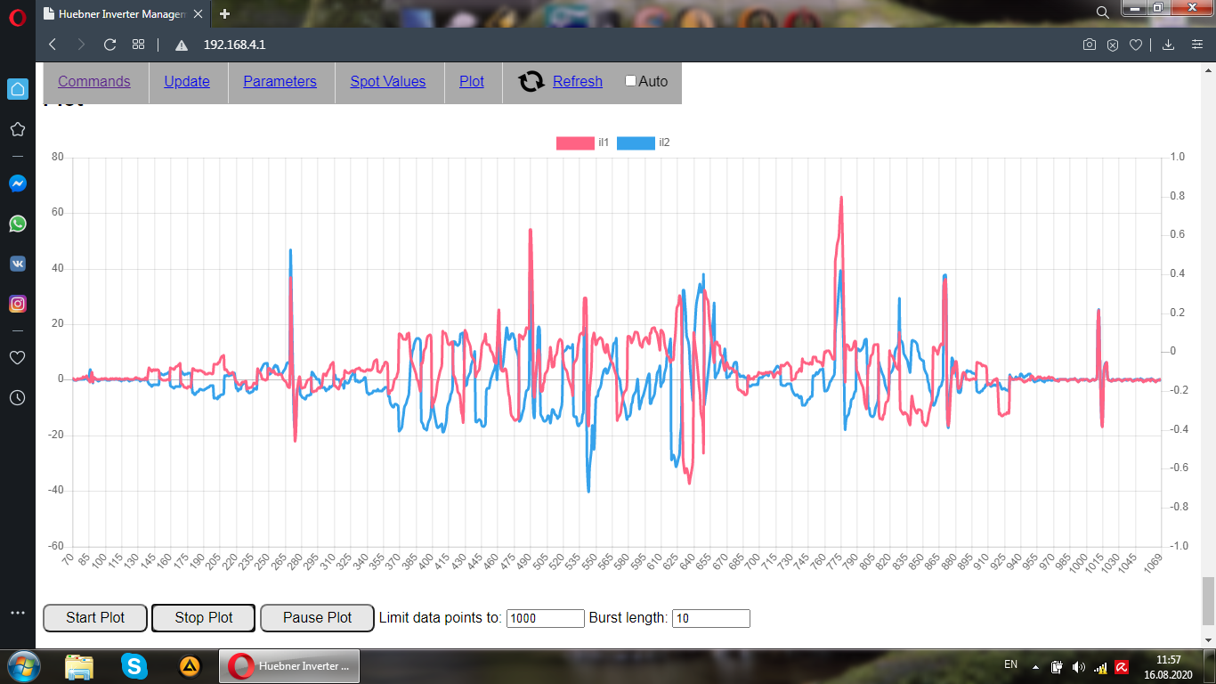

Ok, lets pretend ,I believed Martin1775 blindly and set polepais to 2 and respolepairs to 1, and connected U,V,W of inverter straight to U,V,W of MGR.
I've used Damien's custom Prius GEN3 FOC software, and pwmswap was already set to "PWMoutput13"
When I reached syncofs from 0 to 22000 even manualid of 300 Amps couldn't move rotor, all it did only jitter a little, at 21850 it only did whining noise, and didn't move at all, from gas pedal however in forward it run away....
Here are parameters I read:
id and iq while running smooth from accelerator pedal in reverse: il1 and il2 while running smooth from accelerator pedal in reverse: il1 and il2 when running smooth in reverse, when running smooth forward at high speed and in run away when accelerator is released: No matter the direction, position caprure seems good in both directions: and video of process. Sorry for my English

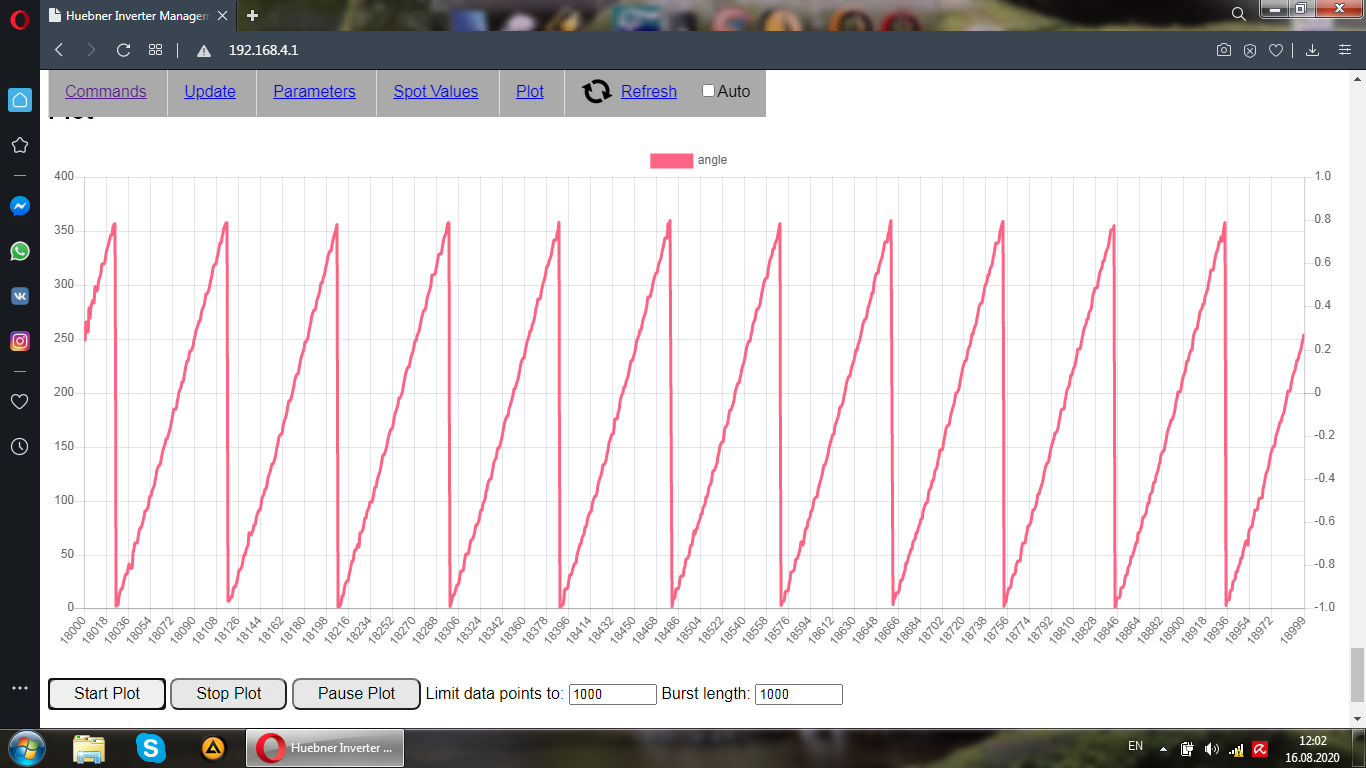

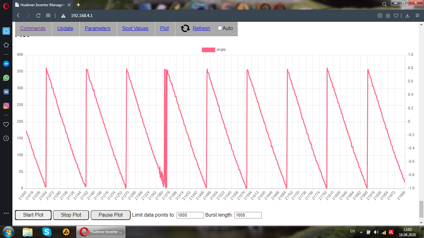

When I did the syncofs test my motor started spinning at manualid = 20, if it was offset (0 or 32768 was the ones for me). Using a 36V 44A power supply to power the inverter HV side.
In manual mode when I spin the driveshaft flanges in forward direction the angle plot rises, if that makes any sens?
Have you selected a direction when doing syncofs test?

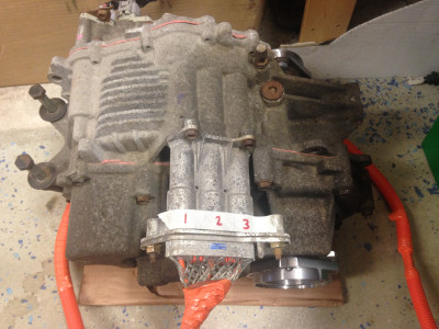

Pictures of my phase order.

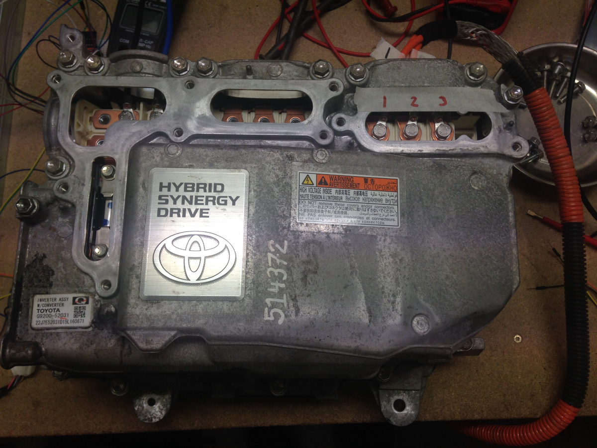

Dylan Witt
- Posts: 123
- Location: Kentucky, USA
- Been thanked: 5 times
im sure his is a yaris inverter, here is a gen three prius inverter, sorry this is all i could find on my inverter, but this is a 2013 gen three inverter time 0.15 in video..

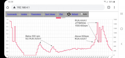

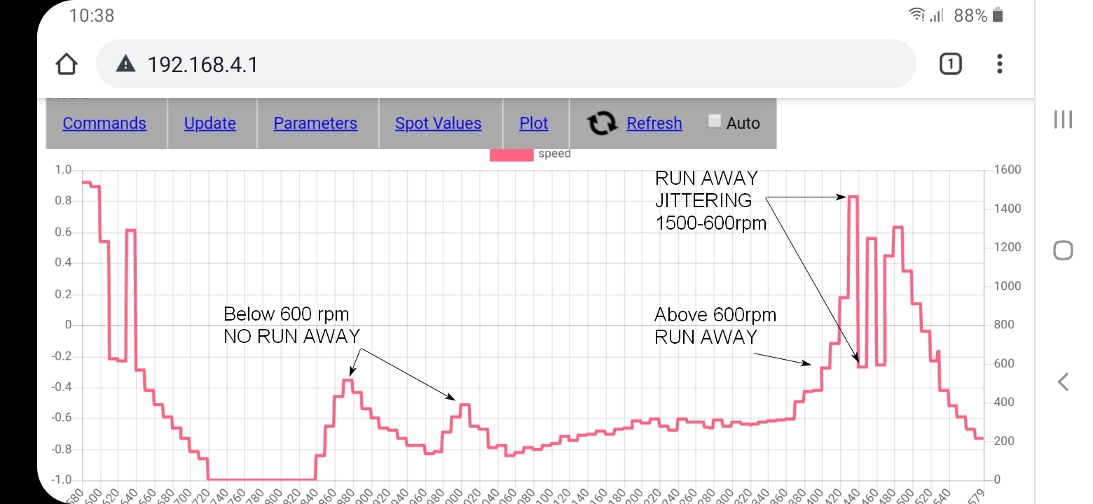

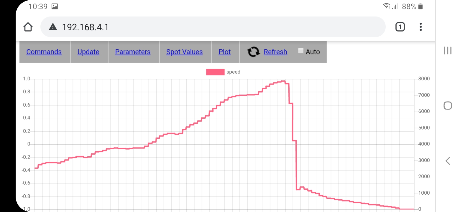

Ok. Firmware 4.87R-FOC. Set pinswap 10.
Started tuning and from the very begining syncofs = 0 it doesnt spin no matter the manualid. With manualid =0.1 manualiq=5 it spins CW, but it is reverse for MGR. So I've set syncofs = 32768.
Now from gas pedal it spins forward no problem. I've spun it up to 8000rpm smooth and easy. In reverse it now runs away, BUT only if speed exceeds 600rpm
and jittering itself goes from 1500rpm to 600rpm and not going lower then 600rpm

I think about resolver and motor pole pairs. One revolution of output shaft in mgr must cause 6.8 revolutions of motor rotor. I've started invertor, started revolutions plot and rotate output shaft. With respolepairs =2 it showed up to 21 revolutions. With respolepairs =6 it showed 7 revolutions per one output shaft revolution. So I believe 6 is the correct count of resolver pole pairs. And rotor started to spin only when I've set polepairs=12. With the same effect as before unfortunately...
FOC is hell of a complicated control system. It rely on accurate data. Now when I sure about correct resolver pole pairs, I'm not sure about motor pole pairs. Is it mandatory that motor pole pairs must be twice as resolver pole pairs? Or it could be any amount of them?
Does that mean that +-300 digits is accurate enough to set correct syncofs?Wiki wrote:If manualid is less than about max_motor_current/2 go back to 4. When approaching rated_motor_current/2 make your increments/decrements smaller, like down to 300 digits

I will describe in text how I concluded that resolver poleparis is 2 and motor polepairs is 4 for the MGR. If I screwed up, please let me know.
Slowly spinning the motor using sine firmware in manual mode. Check the time it takes for a complete revolution on the flanges. Say it took 5s. One revolution on the motor then takes 5s/6,86 = 0,73s.
Using a signal generator generating a sinewave at 4kHz and an opamp supplying it to the resolver excitation and then measure with the oscilloscope on one of the two resolver windings. For a time of 730ms I got 4 peaks, which I interpret as two "electrical revolutions" on the resolver, hence two pole pairs.
(Absolute value of sine will have two maxima for one revolution (0-360 degrees).)
To check motor pole pairs I now disconnect the motor phases and measure with the osilloscope between any two motor phases. Now spinning the motor by hand I got 4 full cycles of sinewave while having 4 resolver peaks. My conclusion is that for one motor revolution I got four "electrica revolutions" on the motor, hence 4 pole pairs.
Now I will, also tomorrow, try to check the actual flange/motor rpm agains the software reported rpm. If they match the resolver is at least correct.
<Edit: I cannot explain why, but I saw no difference in behavior between your and Konstantine's resolver settings>
