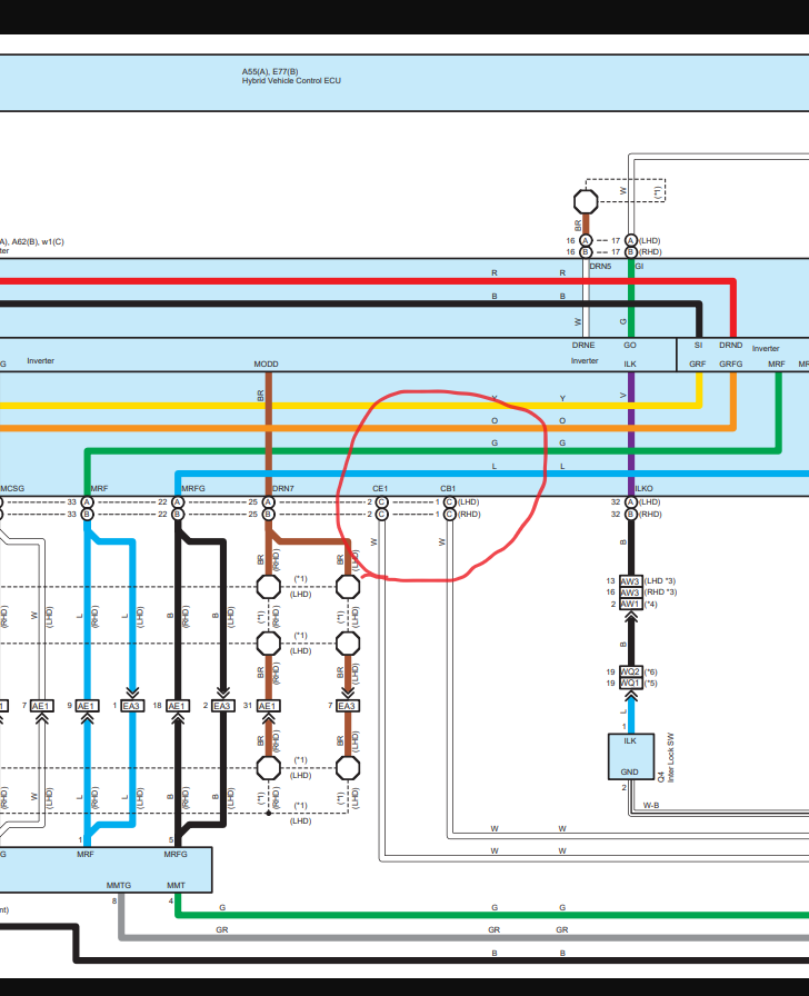

5. explain the purpose of the following pins (HSDN, GI, ILKO, CE1, CB1 on the inverter) You mentioned some of these are not required but what do we do with them?

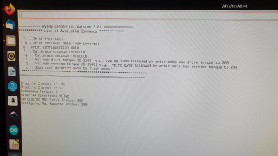

Ok I've worked out the guts of a simple little serial menu system to allow setup and configuration. No programming required. Just a usb cable , pc or laptop, any operating system with a serial terminal. Its super simple (as dictated by my programming skills!) and should get people off the ground.
Unused pins just ignore. Tape them up and forget about them. The only one that may be of use is HSDN (Hybrid Shuntdown). Pulling this to 12v I seem to remember shuts down the inverter but leaves the comms running.

TonyV wrote: Sat Jan 16, 2021 3:26 pm 5. explain the purpose of the following pins (HSDN, GI, ILKO, CE1, CB1 on the inverter) You mentioned some of these are not required but what do we
This should be covered in the wiki?
HSDN - high voltage shutdown - pull to 12v to shut down the inverter power stage, pull to ground or leave connected to use the inverter.
GI - engine speed from the GS450h combustion engine. Not used.
ILKI / ILKO - interlock signal for the various covers over high voltage components in the GS450h (fuse, service plug, etc). These signals are sent to the HVECU in the GS450h, they are not used by the inverter.
CE1, CB1 - these do not exist. I'm not sure what you're talking about. Maybe they are on the Camry inverter?
I was pretty sure that these weren't required for the VCU or Inverter but, I was running out of options trying to figure out why the transmission wasn't turning.
I just doubled checked the wiki and did not see this info there.
So...I vote "YES" to have this info added. :)

Well folks this one turned it to a bit more of a tour de force than expected. One of the reasons I had not posted any video to youtube recently was down to changes in their terms of service. Well, when I went to upload the firmware tutorial today it seems to be having a bad hair day. Emailing the "support" just gets a canned response.
Nothing like a crises to force change so the firmware tutorial is now processing on Vimeo :
The new firmware is available on Github following successful testing on the bench: https://github.com/damienmaguire/Lexus- ... 3_user.ino

TonyV wrote: Sun Jan 17, 2021 1:23 am Image was taken from the GS450H Wiki
Those are probably the 288v DC cables from the battery? I don't have access to the full schematic right now. Either way, they are not present on the control connector for the inverter.
