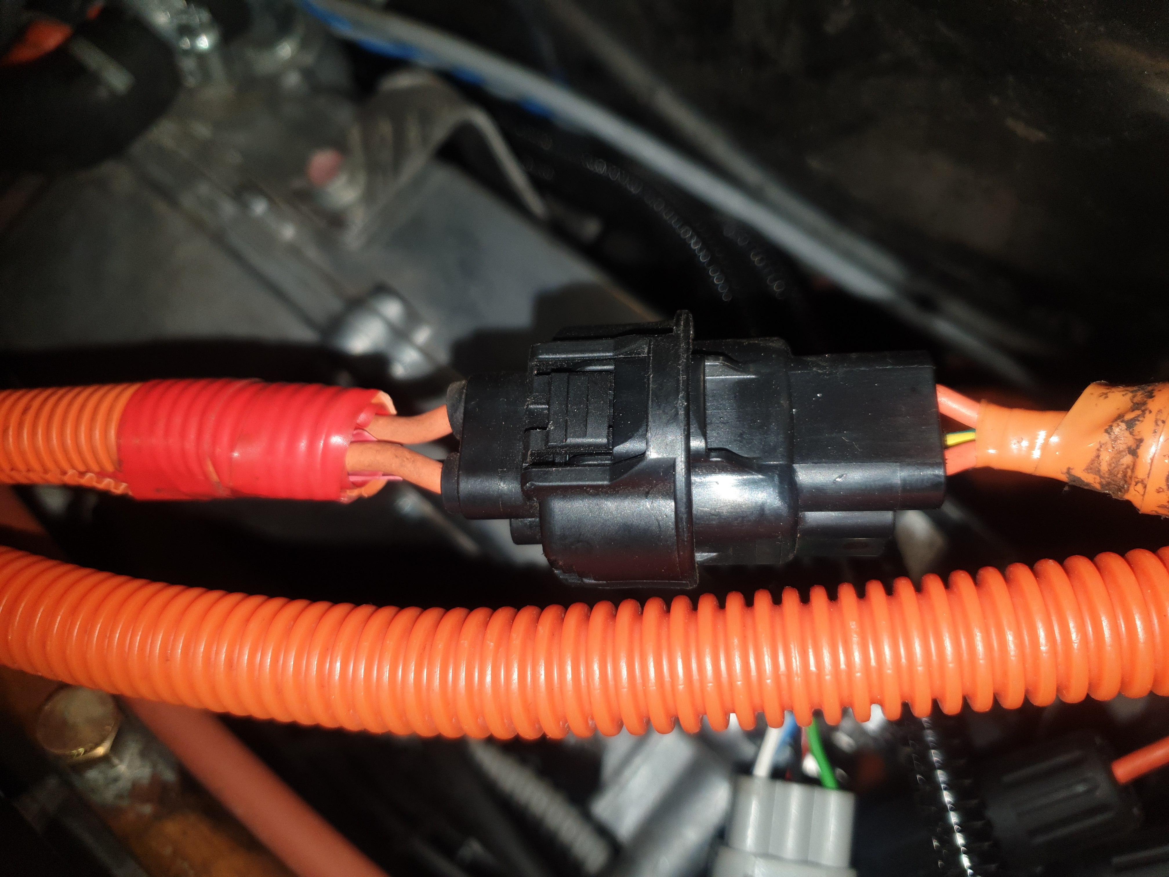

After some serious driving with Outlander VCU, for more than 200km stretch... i may share some thought about this VCU.
Teensy works really well when it works inside its loop. That means when VCU is activated and car is in FWD or RWD mode drive is very smooth, no jumps or glitches. Torque is somewhat precise and fairly strong for such a small motor. At lower RPM motor is a bit sluggish but when upwards from 2000rpm i can get off the ramp really quick. I am surprised motor provides great acceleration torque up to 10000rpm.
Regen is marginal (-15A) up to 2000rpm, Good (-35A) up to 8000rpm and really humongous (-70A) upwards of 8000RPM!
I am really pleased with reliable CAN commands while driving. DC cables go really close to CAN lines and once i solved that MCU interrupt overload no such problems occured. Motor - inverter - charger - heater combo tested at 160km/h speed and up to 78kW electrical power.
I still want to install additional battery module for full 96S - 360Vdc nominal. I expect at least 85kW if not closed to 100kW!
There some downsides however...
1. After lengthy VCU inactivity CAN bus comes out of sync and causes all kinds of rock and roll on starting. To resolve this i need to cut the 12V power (disconnect cable harness) and then VCU starts a new. I tried to use WDT reset function and it didnt work. Only hard power reset helped with this.
My plan to resolve this is to change VCU wiring so ignition will provide power to VCU when only when active and a separate relay will turn VCU on when charger is connected. Some work to do still.
EDIT: On the 1st point it seems now if i cycle the direction switch in F N R and then R N F direction for several times, then i come to FWD the VCU would be in sync again. I still have to confirm this by multiple confirmed instances though.
EDIT2: Nope! I still get twitches from keeping VCU connected and at idle for extended time. I will have to implement VCU ignition starting.
2. I noticed motor does not provide much torque at driveoff from 0km/h. its late for about 0.5s even if i floor it. Like a giant rubber string. I dont know what the issue is but this happens no matter how i set up throttle map.
3. Flimsy Teensy
. Really delicate Teensy pins really require care when assembling and inpurs need to be secured by opto coupler. I had to replace analog input to different pin as i caused damage from 5V input. To combat this i use resistor divider and 3.6V zener diode reversed towards GND so if more than 3.6V shows it is drained to GND. Throttle pedal is 5V and its signals can go up to 4.2V...
4. Trouble with PP signal and charger activation. I am using PP signal from L2 EVSE port which is pulled down inside cable by 680R or 220R resistor to PE. This allowed me to attach 2K7 resistor from 5V to opto input. This means that in code PP pin is signalled as active when nothing is connected and will be seen as inactive if i connect EVSE. I had to invert PP reading for CAN to transmitt and VCU to disable the car when charging. I think for this to work propperly it would require a change of VCU board. If i do this i will also add a buzzer and use its function in case of errors.
5. I seem to leak gearbox oil from LH driveshaft socket, but that seems to be my bad, probably i damaged the seal on that side, have to investigate...

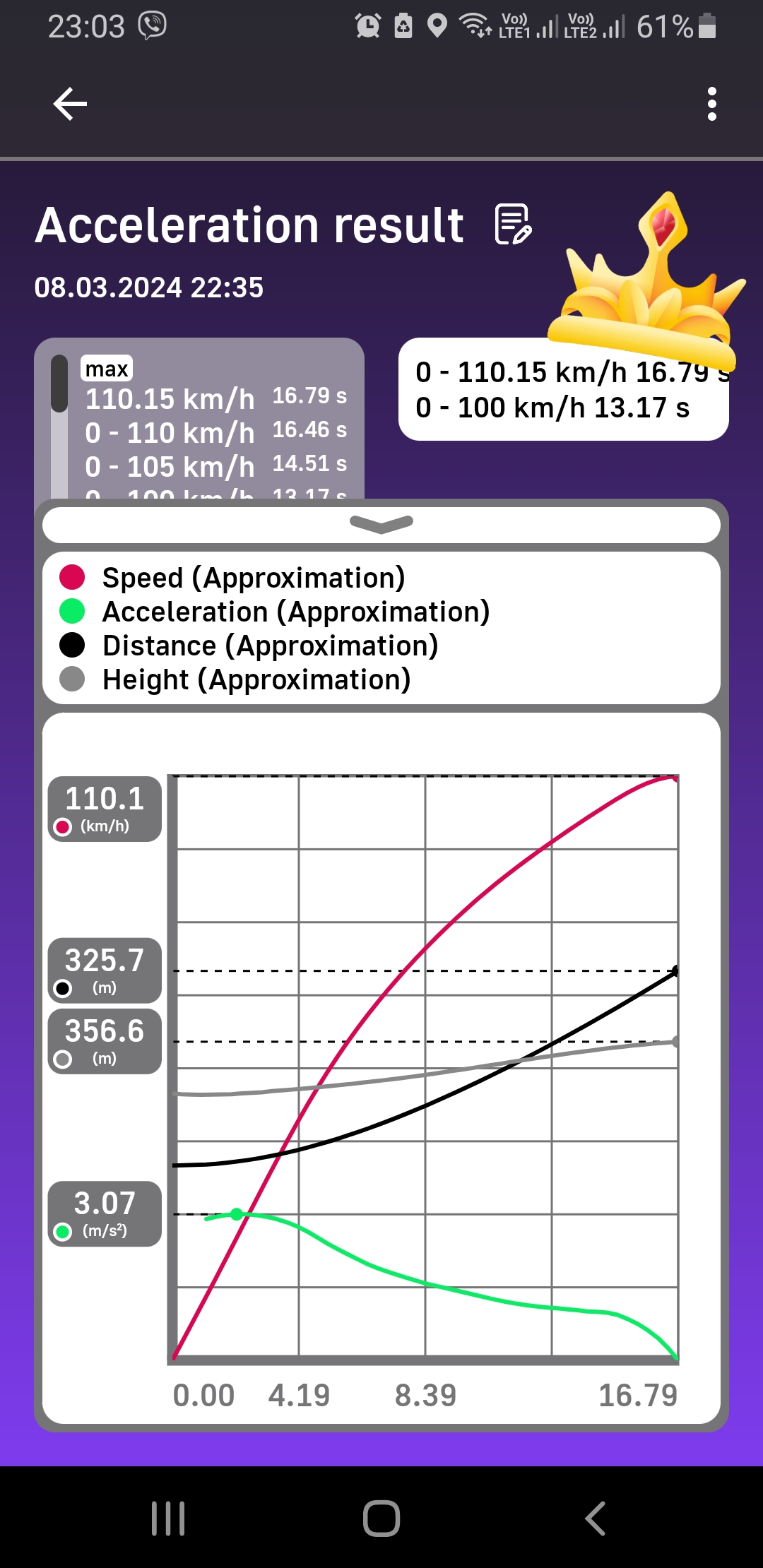

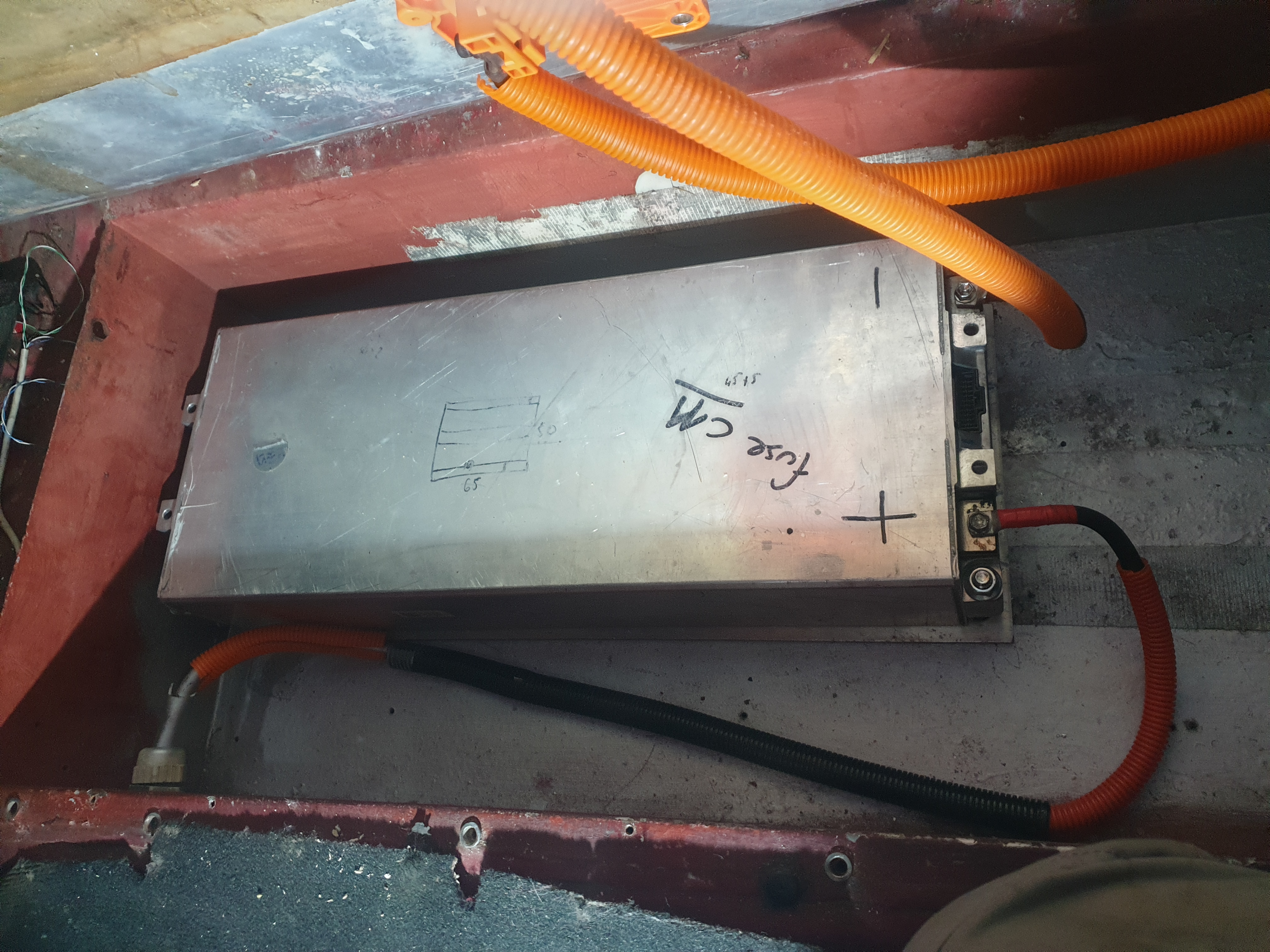

Ya...!
I am a little dissapointed...
I managed to add another module so 8 total ID3 modules in Mazda for 53kWh at 360V 96S.
Then i went on and calibrated my display and tested the power of the beast
Together 53kWh makes up for about 290km range conservatively on the highway... 185W/km i think.
It looks like Outlander inverter has a power limiter! Not amp limiter, but power limiter. When i had 84S battery inverter would let 230A go through which at 320V means 73kW. In the video i show steady acceleration and max current draw of 192A at 360V which makes about 70kW power from Outlander RWD motor. This means i will have to try to up the torque by software but the power will probably remain constant.

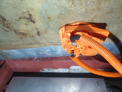

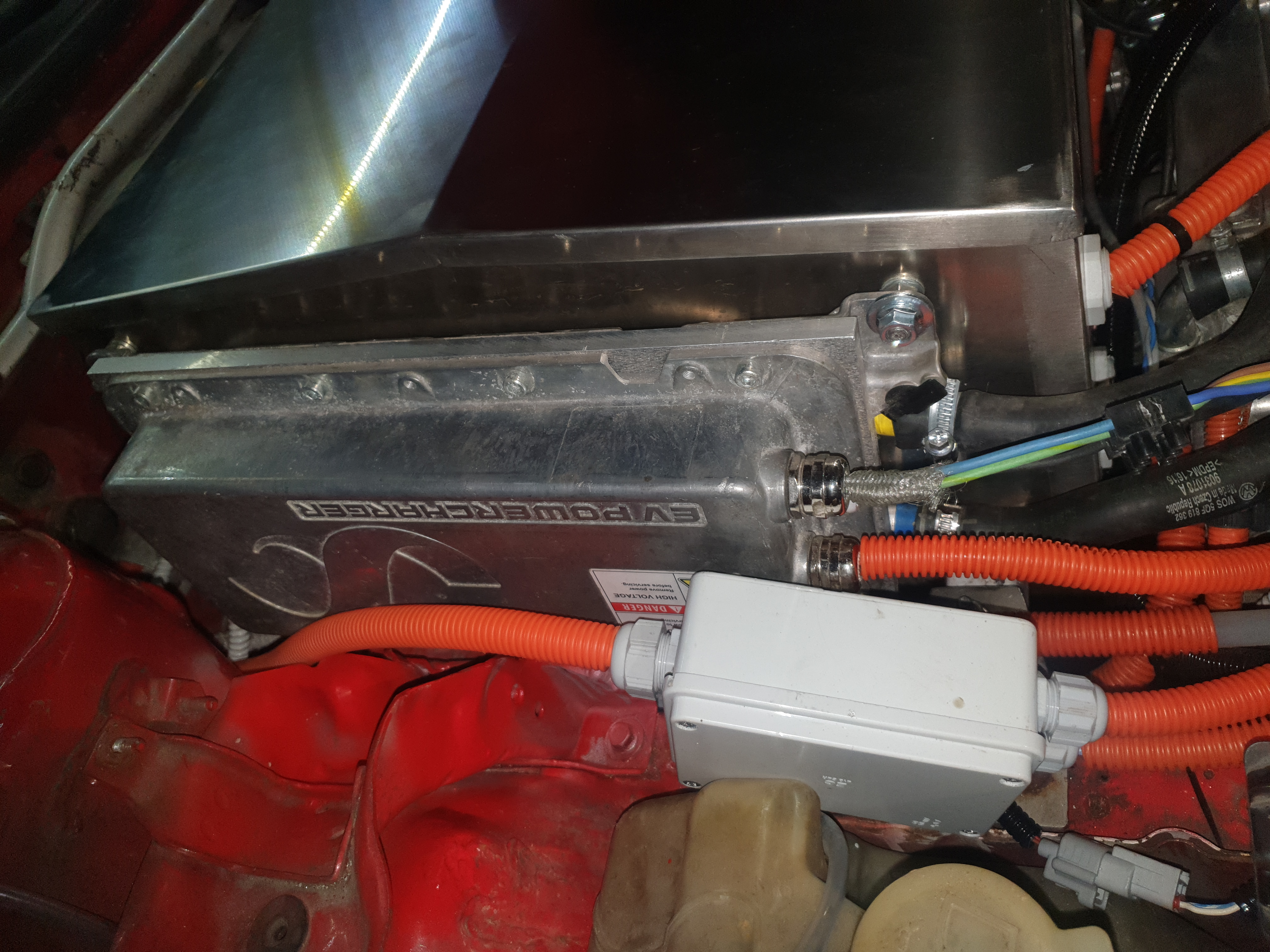

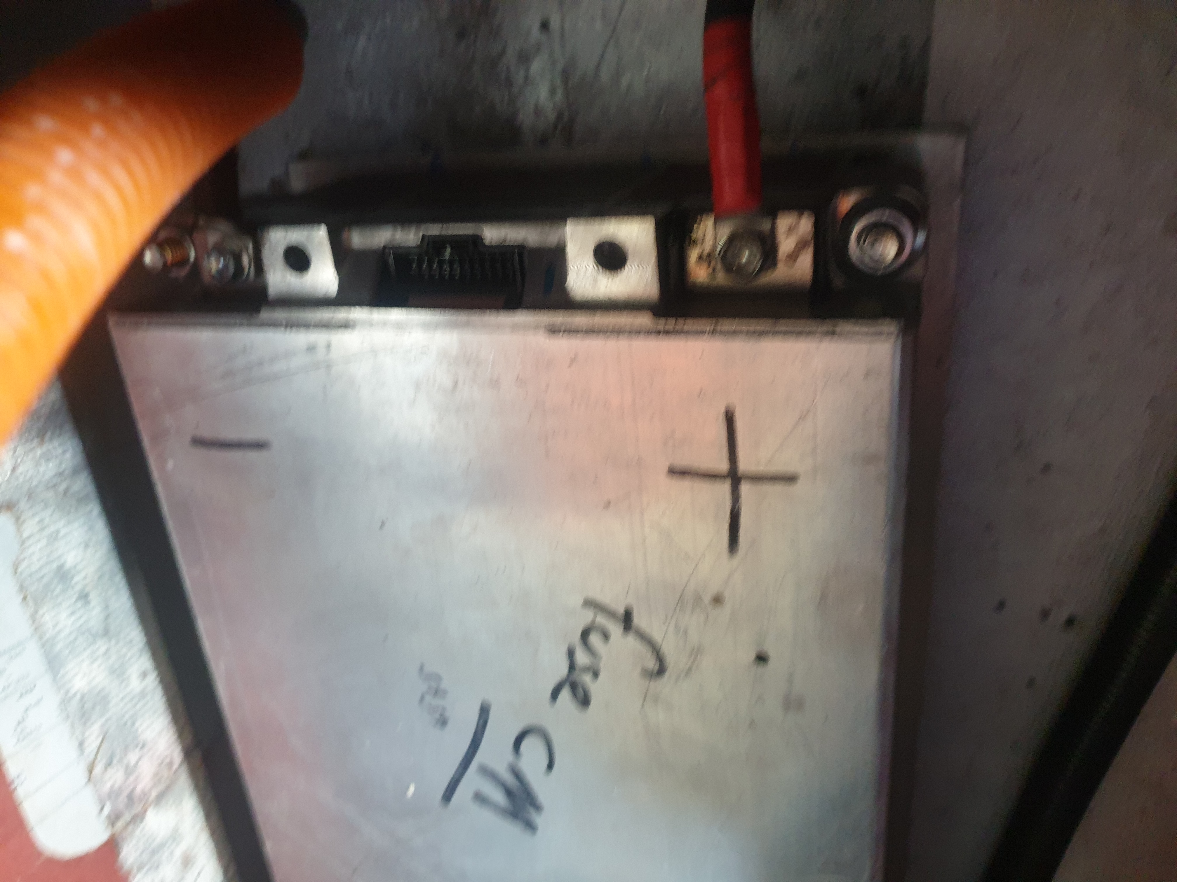

Beacause of difficulties charging using Tesla Gen2 charger, bulkiness and separate cooling circuit needed, i decided to implement two phase charging that i was thinking of in the beginning.
I will use already established Outlander single phase charger with control from VCU. VCU is set to start precharge and DC contactor immeadiately upon PP pin connection with EVSE. When precharge proces is complete VCU will start charging telegram and provide command to charge from EVSE on its PWM control from Cp pin. On the second phase i will add Eltek charger. I decided to fit 3phase 2.5mm2 cable under the car and connect it with EVSE cable in the trunk. This will allow me to transfer load between phases to calibrate house load.
Eltek charger is mounted to the side of the battey box by M8 bolts. DC connection is provided through solar DC cables 6mm2 and MC4 connectors. The main difference of Eltek charger from Outlander one is that it does not have an output diode. Eltek runs on some form of resonance circuit which can be detrimental in case if there is no load on the output and charger is commanded on. This is why i decided to connect charger permanently to the DC circuit behind the main contactor. There is already a 16A fuse inside the charger.
This way of installing charger is good for me because i will be able to use the same cooliong circuit that i use for the rest of the system and the same header tank and pump. This really makes theinstallation of charger a drop-in.
For AC connection i use Yazaki 7283-7350-30 AC connector from Mitsubishi with both chargers which connect to joint distribution box beside Eltek charger. I had to put new calls to code. I simply call new telegram within function EVSEstart.
I first observe telegram 0x38A from charger and convert data from it into command for DC current.
Then i call telegrams 0x286 and 0x2FF commands to run both chargers
Now when EVSE sends PWM at 25% this will convert to 8.3A command and less proportionally.
I tested this on my DYI EVSE as well as hend held granny cable with different AC current settings before each charge. Every time i plugged in i saw consistent AMP draw on charger DC side. So i can confirm the system can conform to EVSE command when needed.
EDIT: There is a problem! I connected my car to public EVSE and it failed to charge.
At first 3A DC was started and then nothing... I will have to setup some lines in code so parameters of charging will be displayed in serial so as to observe what is happening with chargers.
