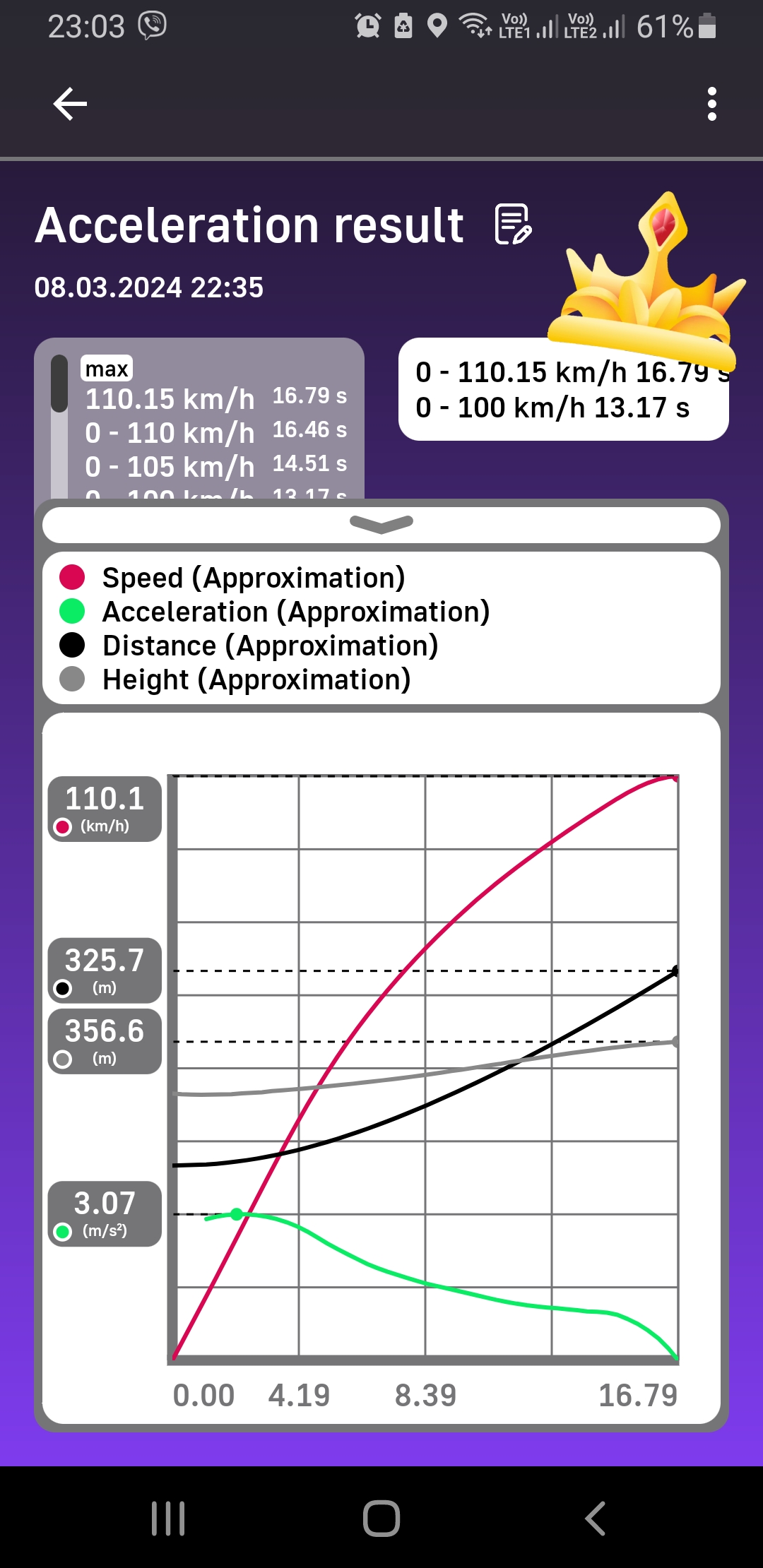

- Posts: 3796
- Has thanked: 166 times
- Been thanked: 413 times
Ya...!
I am a little dissapointed...
I managed to add another module so 8 total ID3 modules in Mazda for 53kWh at 360V 96S.
Then i went on and calibrated my display and tested the power of the beast
Together 53kWh makes up for about 290km range conservatively on the highway... 185W/km i think.
It looks like Outlander inverter has a power limiter! Not amp limiter, but power limiter. When i had 84S battery inverter would let 230A go through which at 320V means 73kW. In the video i show steady acceleration and max current draw of 192A at 360V which makes about 70kW power from Outlander RWD motor. This means i will have to try to up the torque by software but the power will probably remain constant.
