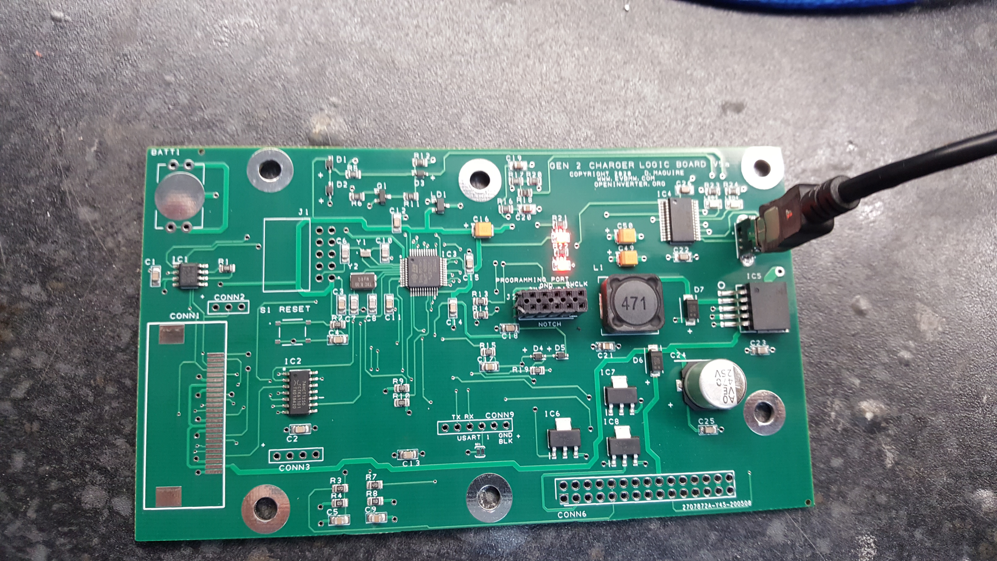

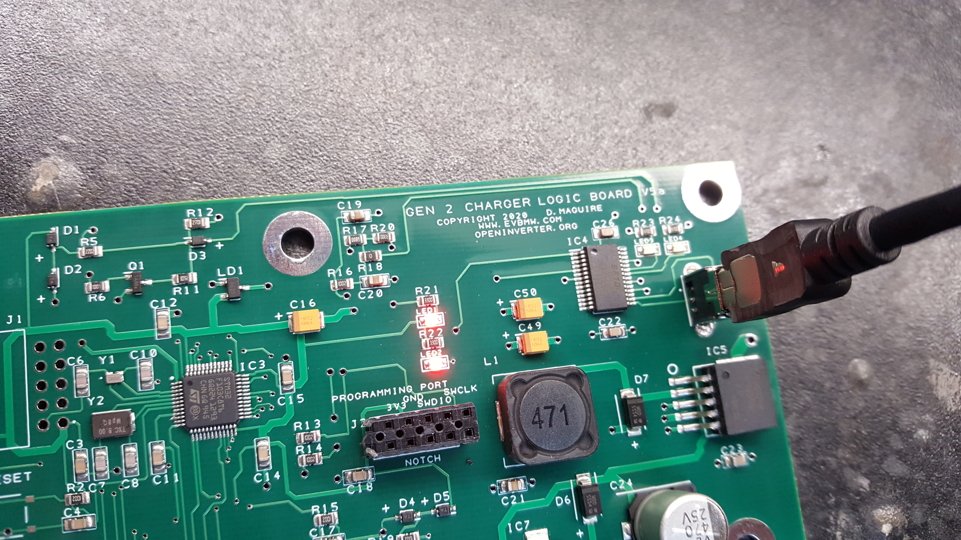

New rev of the V5 board now with usb onboard for configuration and monitoring.
Also ditched the ULN2003 in favor of the NCV8402 for contactor/relay driving so no more silly 12v feedback through the coils issue.
jon volk
Posts: 574
Location: Connecticut
Post by jon volk »
I like new programming port as well. Just shove the ST link on vs triple checking jumper polarity haha.

Jack Bauer wrote: Mon May 18, 2020 3:44 pm New rev of the V5 board now with usb onboard for configuration and monitoring.
Excellent. Are all backlog and future orders getting this version? Excited to contribute to this one.
Posts: 4006
Been thanked: 1135 times
Yep all backlog orders and new ones get this rev. Slight delay as the 24pin jst connector is out of stock for another week or two at Mouser.
