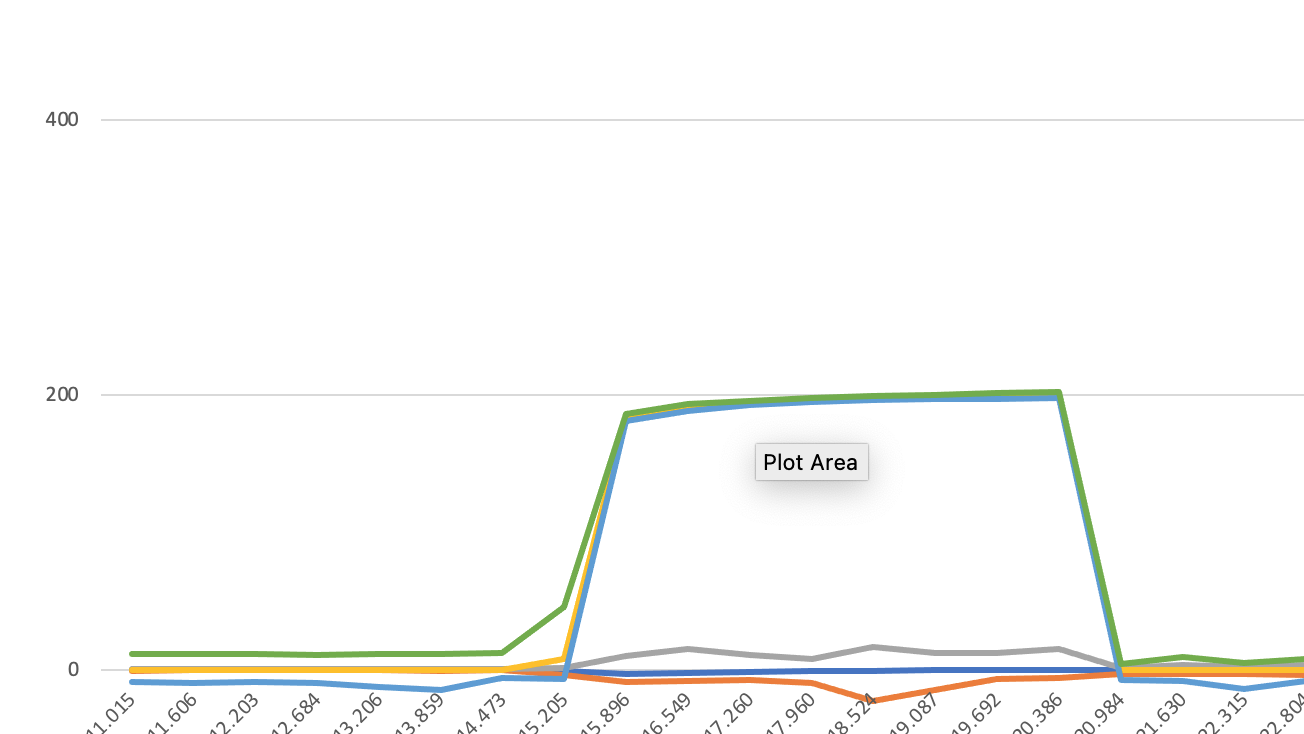

Pete9008 wrote: Mon Sep 19, 2022 4:04 pm No idea what's going on there :? there are numbers in the data that shouldn't be possible (196.12 and 1150 for potnom for example). Either they are data capture artefacts and not real (but then in previous plots they coincided with trips which indicates that they are real) or there is a noise problem in your install that can affect multiple ADC channels (Id, Id, resolver, potnom). Are there any other potential noise sources on the car?
Possibly duff data over the serial connection.

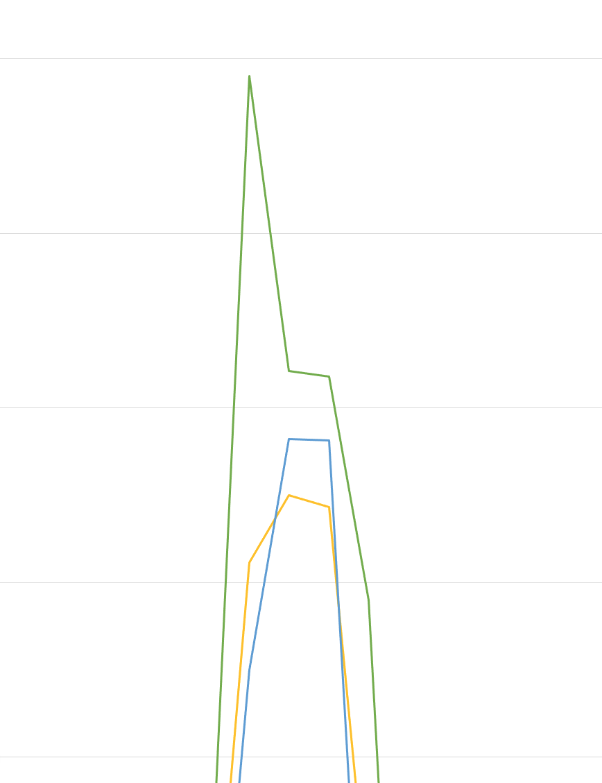

Just looking at the moving.csv and the iq overshoots a fair bit some times, but looking at the stationary they looks good (ignoring the middle where what appears to be duff data)

Bigpie wrote: Mon Sep 19, 2022 4:42 pm Possibly duff data over the serial connection.
Screenshot 2022-09-19 at 5.38.20 pm.png Just looking at the moving.csv and the iq overshoots a fair bit some times, but looking at the stationary they looks good (ignoring the middle where what appears to be duff data)
They all look pretty good, still a bit surprised how low a kp and ki you need though. Is it still tripping when moving?

Pete9008 wrote: Mon Sep 19, 2022 5:03 pm They all look pretty good, still a bit surprised how low a kp and ki you need though. Is it still tripping when moving?
It is, not identified a reason yet. Will have to log further and see if anything jumps out.
When moving it looks to still have 100 ish amps difference between min and max if looking at the overshoot, and that's almost 50 ams over.

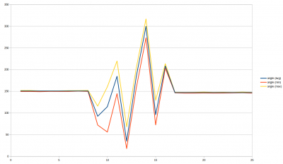

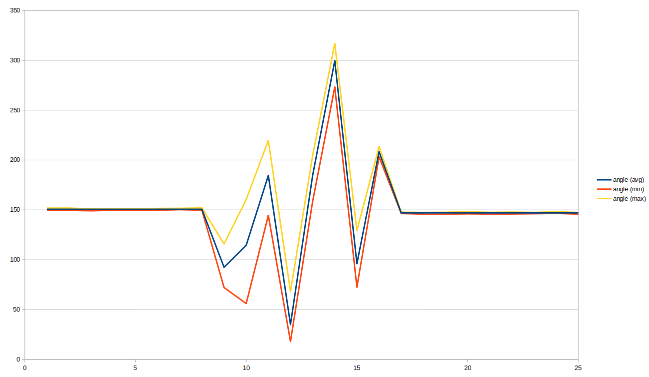

I'm still struggling to see why you might be getting cutouts. The angle measurement is the only thing I can think of, an error in the angle could cause some large currents to build up pretty quickly. I was hoping that moving as slowly as possible, even allowing for the relatively slow plot update, would show a nice progression on the rotor angle (ramping from 0 to 360, step down to 0 and repeat, or vice versa). Instead this is what the plot looks like:
Really not sure what to make of this, either the motor was going too fast, there is something not right with the resolver setup or I am missing something.
Sanity check - I'm guessing that your gearing will be quite high with the fast spinning motor so say 10:1 (complete guess, the outlander revs to 10k with 7:1 and yours goes up to 14k). In order to plot right the motor electrical speed needs to be < say 0.4Hz (update rate is 0.6sec so 4 graph points per rev), allow for 4? poles so 0.1Hz. Say 60cm wheel so 0.6*pi*0.1/10 (m/sec) = 2cm/sec. So as long as you were going slower than that the plot should show the motor angle OK. Hmm, that's pretty slow! What do you reckon, were you going that slow?
I'm guessing not, doesn't look like that test is going to work well enough :(

With the resolver I'm clutching at straws a bit. Your stationary tests show that the inverter can control the currents well and can put high currents into the motor, the current measurements look reasonable, so the resolver is the only thing left. Your comments about the car not moving with some ki/kp values also make me wonder a bit whether there could be some kind of rotor angle dependant effect too?

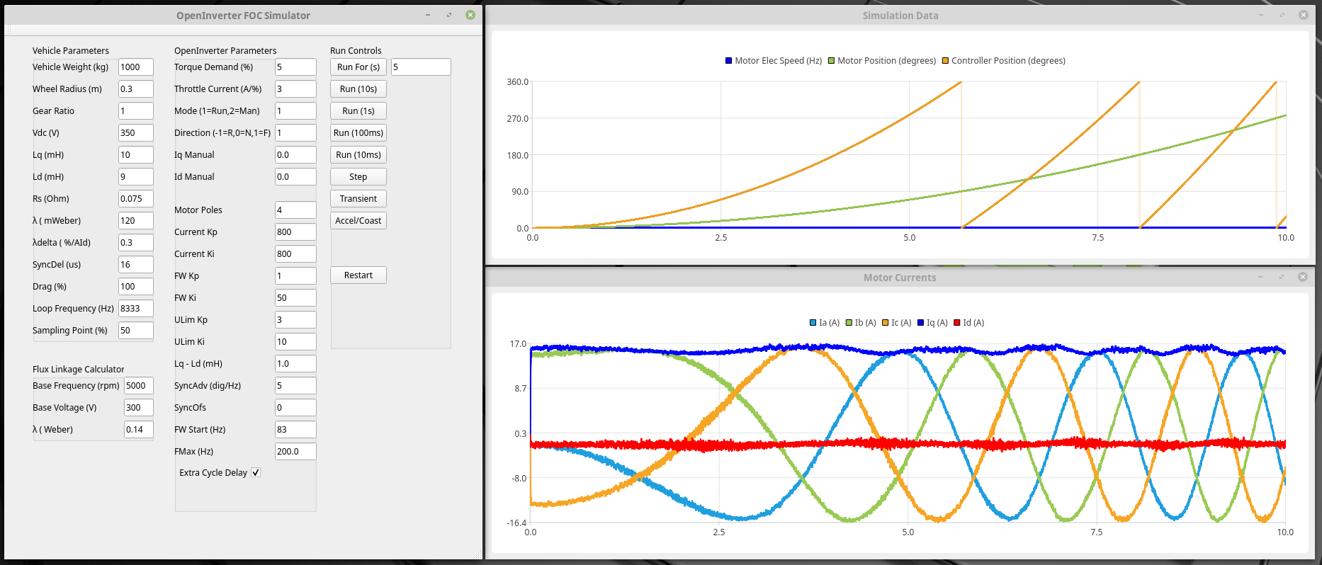

Edit - What would be great to see is a real log showing something similar to this:
This should be possible in the real world shouldn't it?
