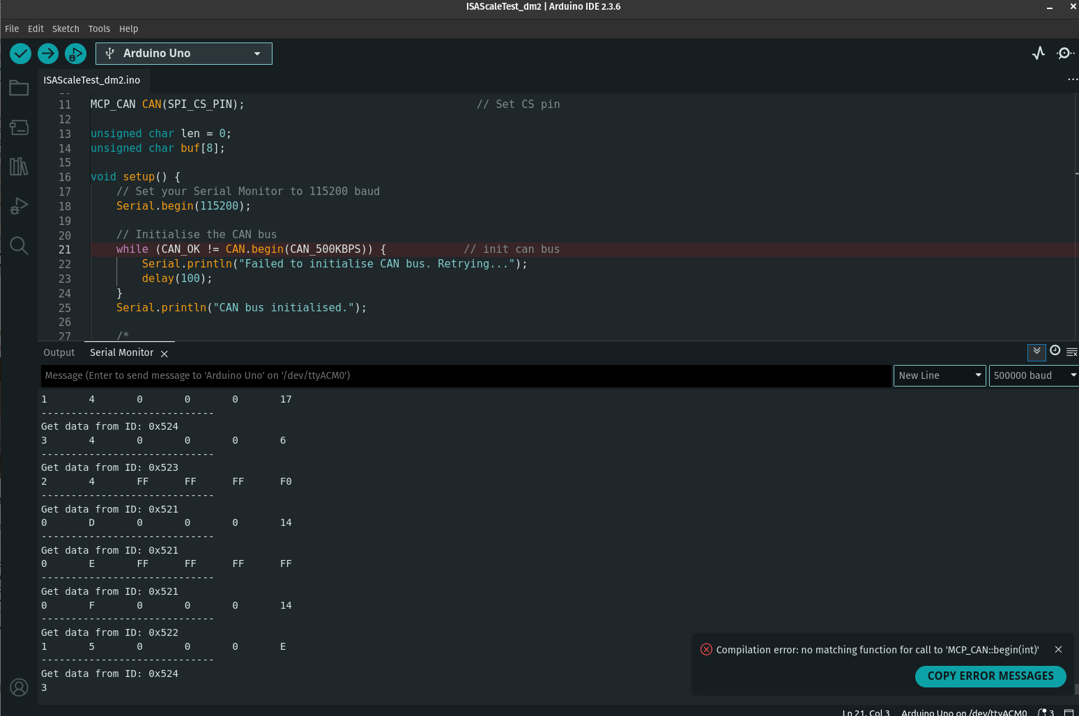

All, I struggled to get a couple of ISA Isabellenhutte shunts initialised and working so am putting my solution below in case it helps anyone. I didn't have an Arduino to use the Jack Rickard-derived code linked in the wiki here https://openinverter.org/wiki/Isabellen ... te_Heusler but I did have a Teensy 4.1.
In addition, the linked code above contains libraries you don't need if all you need is to speak to the ISA shunt over CANbus (it includes duo_wire and wire_EEPROM which I can only assume Jack was using to do other stuff with).
The code below should allow you to communicate with the ISA shunt and change it from the factory defaults to whatever you need. In my case, I got two shunts from Ebay with unknown provenance. They turned out to be set to 500kbs baud rate (the ISA can be set to 250kbs, 500kbs and 1000kbs).
I strongly recommend you read the ISA data sheet, as the code below is the bare minimum you need.
Some gotchas:
The Jack-Rickard-derived code set the rtr flag on the CANmessages to 1, it should be set to 0.
By default, the ISA is big-endian so the shunt may be working fine, you just may be decoding it wrong.
That said, whilst the code below sets all the messages to come back little endian, the current persists in coming back big-endian and I haven't looked into why yet. Fixed, I wasn't sending the correct identifier.
Check your CANbus termination - some of the shunts have in-built termination and some don't.
Check your CANbus transceivers if you are using cheap rubbish like me. I have had two batches of SN65HVD230-based tranceivers from Amazon, some worked, and some didn't, and some turned out to be not terminated when others were, so don't assume the transceivers are good.
I used a Teensy 4.1, with code below, and you need the excellent flexcan_t4 library by Tonton81 from here https://github.com/tonton81/FlexCAN_T4.

I was trying to use the Arduino UNO version with the shield but I get a lot of errors.
The ISA works but i cannot add the 528 message for energy since I cannot make the sketch work.
If anybody has any suggestions.
