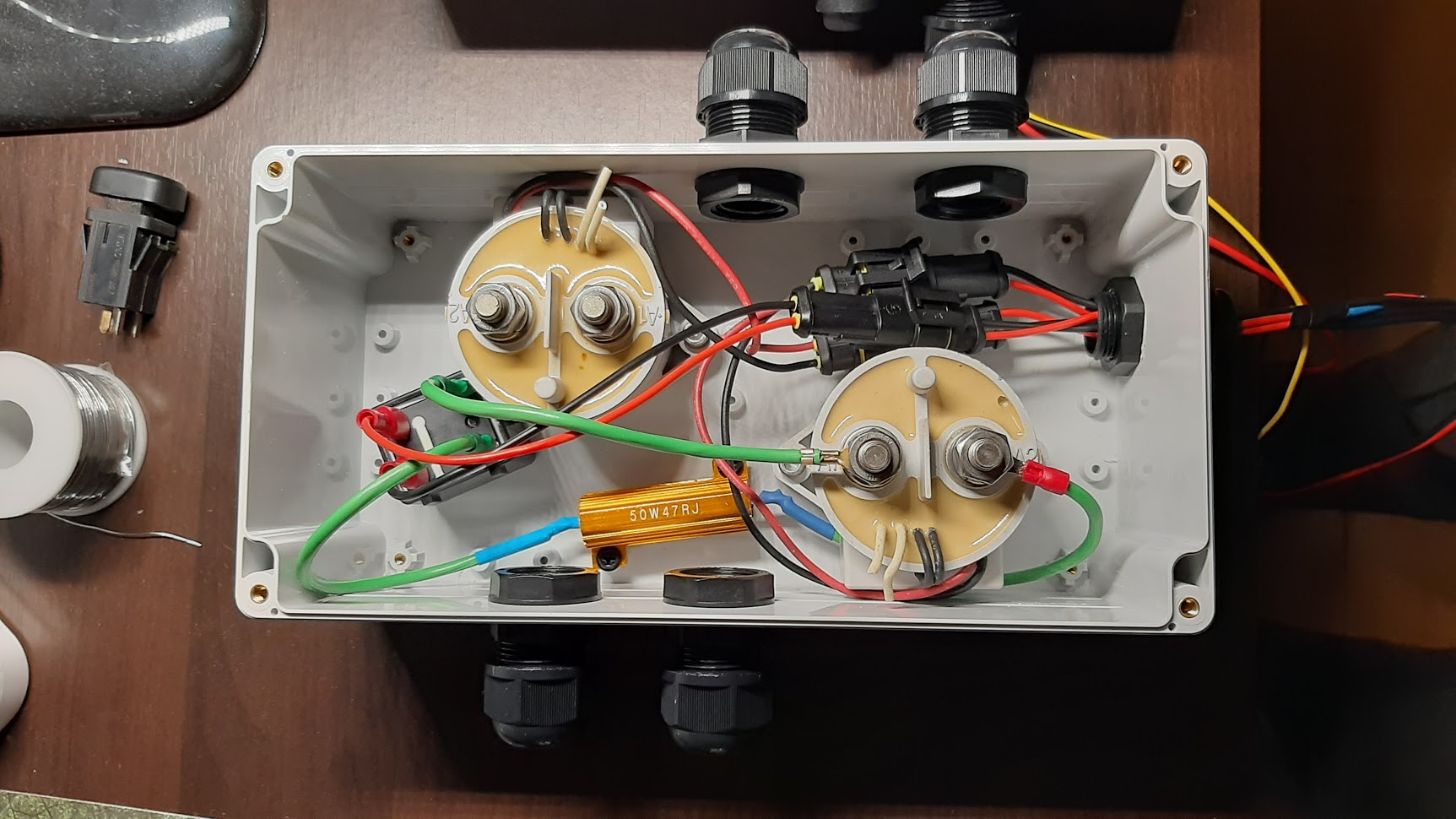

As I'm learning here, Konstantin, can you tell me what is going on in the second white project box? Are these the contactors? Assuming so, what voltages (DC?) are running on the green wires in and out? Is the Damien board controlling that box relay, which I assume is tells the contactors(?) to open/close? Looking at the video, I'm assuming the DC voltage is coming in on the right hand side from a power source or battery next to the motor, through the contactors, and then to the inverter, is that correct?
Whats the difference between a contactor and a relay? Or is it just application nomenclature? Like an automotive starter solenoid is basically a big relay.

I'm currently sitting on two boards. One Damien's, shown in video, and one is Johu's gen3 board, which basically can do the same things as Damien's board. So I can sell you this board from video for the same price as I've purchased it (30 euro), if you really in need of one, and can't built it.TheSilverBuick wrote: ↑Tue Jun 23, 2020 11:36 pm Or maybe I'll put a want ad on the classified board to see if anyone is sitting on one that they aren't planning on using anymore.
In junction box there are two Kilovac EV200 contactors, wich are basically are big heavy duty relays, one high voltage relay from toyota prius junction box and 47kOm 50W resistor. One contactor is separated and it is for positive line, second one is for negative line and in parallel with is there is a line consisting of prius precharge relay and resistor.
In this video there is 30 Volts going thrue green wires. For now I'm under quarantine so I can't go to electronics shop to buy terminals and HV cables to run high current tests, so only low current test for now
Damien's board can run both precharge and main contactors, but as far as I know, main contactor should be equipped with economizer. Precharge relay only work for short period so it doesn't need economizer. And second main contactor for a safety reasons I suggest to control thrue a manual switch, so in any case you can turn it off manually.

Nice! I've got no qualms assembling a through hole bare board, just need to get a hold of one. If I come up empty handed I'll let you know, though if you think yours will start collecting dust I could see buying it, but don't stop testing yet!
Thank you for the explanation, and I like the idea of a manually controlled cut off with the second contactor. I need to read up on the precharge stuff.
