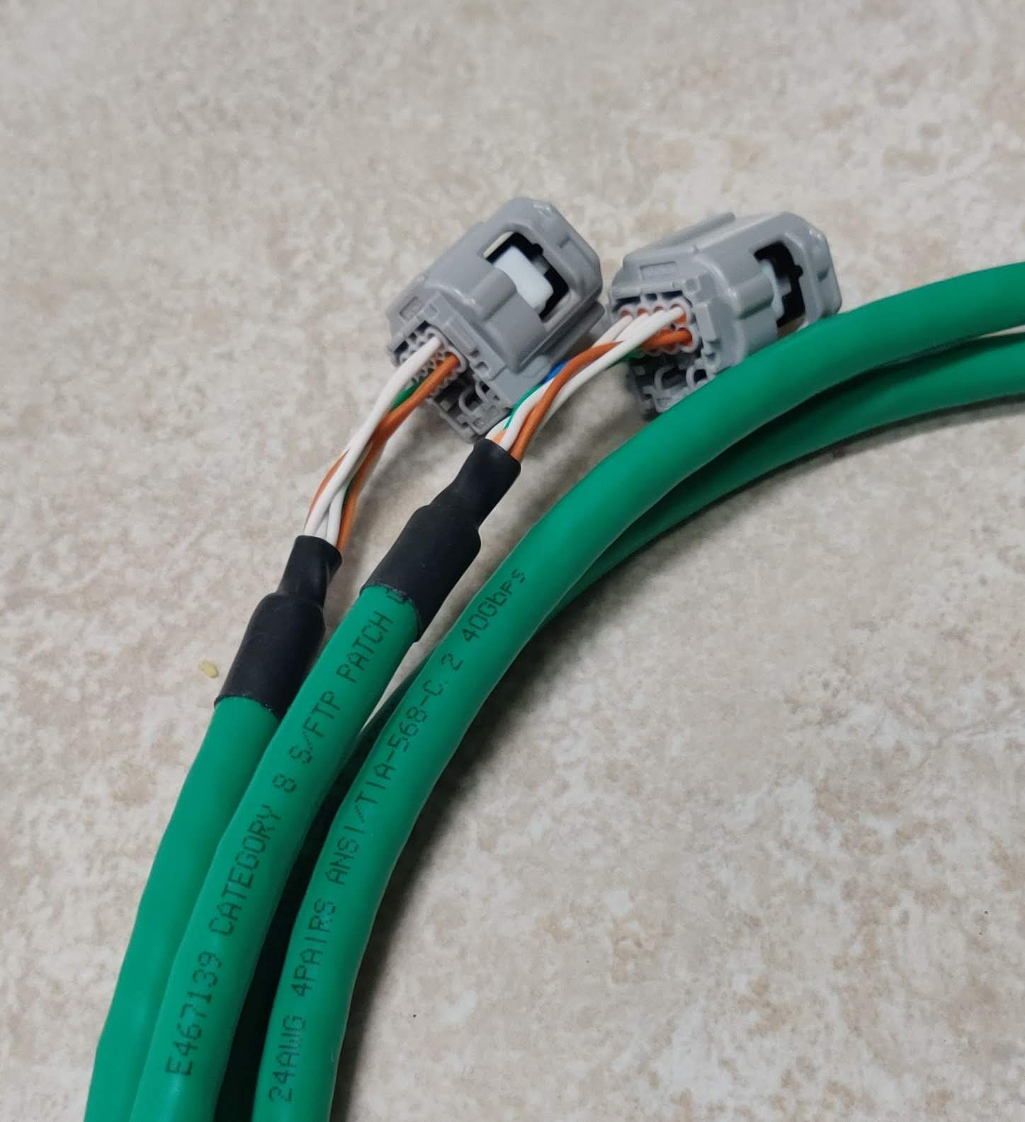

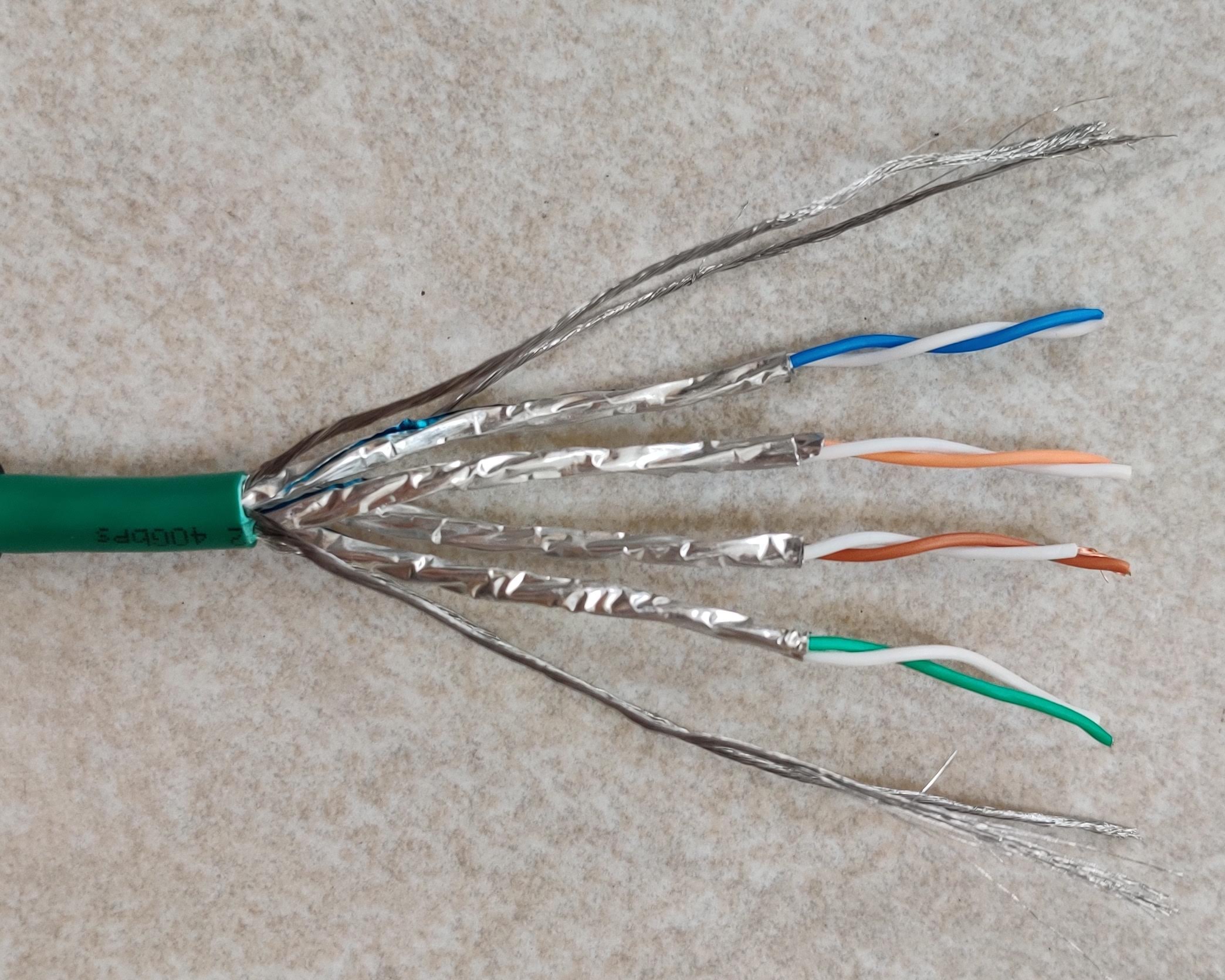

I used 4 runs of one-pair shielded cable. IIRC Toyota did the same.
You could use Cat8 cable as the pairs are individually shielded and it will have a drain wire and outer braid which you can connect to one of the relevant DRN pins on the inverter. Cat7 cable has no drain wire or braid so is not suitable.
In reality, the data rate is very slow, you may find success with just twisting your own pairs and not shielding. Depends on what else is nearby.

One Cat8 cable for all four pairs? Would be convenient...

Yes, you can use single CAT8 S/FTP cable for all 4 pars.
I used it for resolvers as well but it may be overkill.

The last thing I need is questioning quality of these connections because I imagine debugging would stink. Overkill for the win! Thanks.

My approach was the same, no regrets
Like you said, you do not want to worry about this.

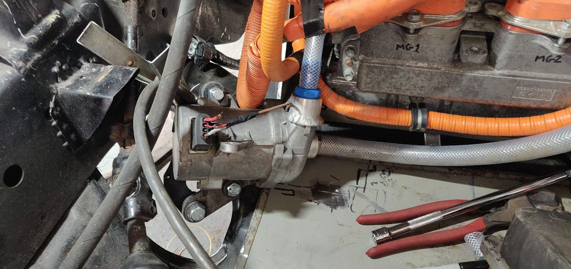

Regarding cooling -- what are you guys' experience with heat generation and the transmission/inverter?
* How are you cooling? One radiator for both? Multi? None? How big?
* What kinds of water pump/pumps?
* Any idea of temperatures that you're dealing with?
Damien said in a comment once that he couldn't get the transmission to get hot in the Bexus.
Your thoughts?

I run one 4x8” radiator with two small fans behind it for both, looping through motor then inverter, no problems with temps at all. 1 D5 pump at medium duty, maybe 50%. I stopped monitoring after a couple weeks as it just never really got too hot.
xp677
- Posts: 442
- Location: UK
- Been thanked: 15 times
Re: GS450H Discussion
Standard car radiator. I think I used one from a 1L Corsa because it was cheap and small.
Pierberg pump from BMW 3 series - cheap and easy to get running
Series loop, rad > inverter > transmission > reservoir > pump
Pump set to come on when anything hits 35C, fans set to come on when anything hits 45C. Can also do speed based fans, slope them off above 20mph etc.
Pierberg pump has a built in inverter (its a 3ph motor), this can be varied as well via PWM, it also has feedback via LIN I believe.
In the Lexus, inverter shutdown temperature was 125C for any IGBT.
I never found which MTH bytes were MG1 IGBT and MG2 IGBT temp, however these were present in the scan tool and the only comms with the inverter is over MTH so it must be in there.

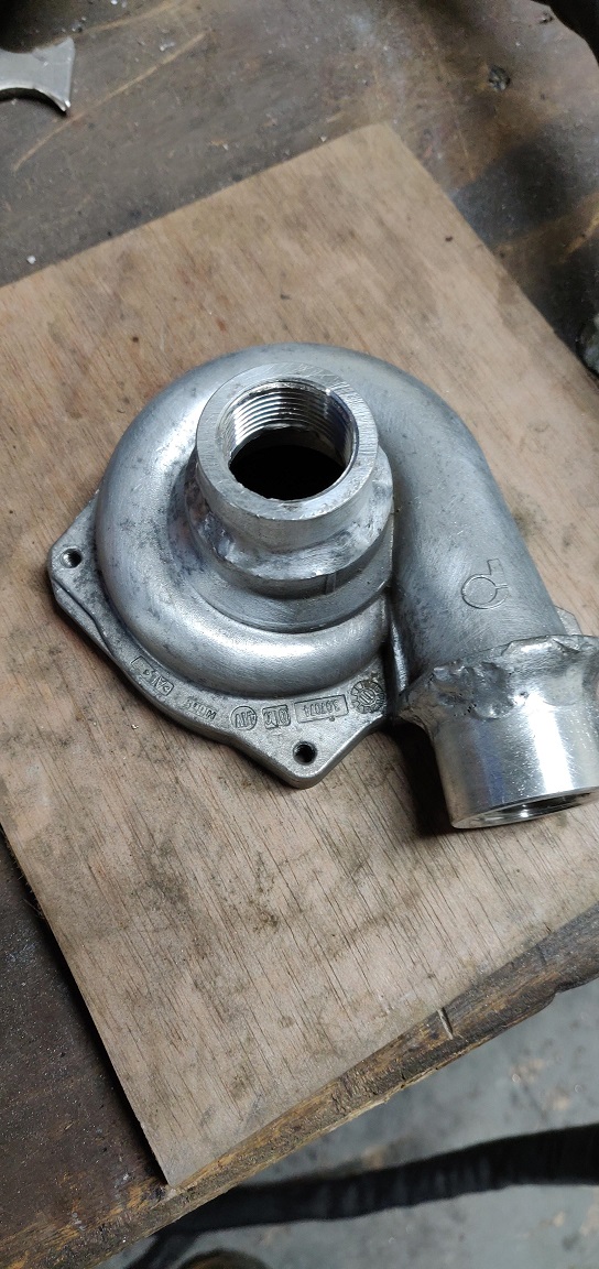

xp677
- Posts: 442
- Location: UK
This pump, I got mine for £22. Best to get one which has a plug includedPatrcioEV-ATX wrote: ↑Wed Nov 17, 2021 2:35 pm
What type of pump? I see all kinds of different ones listed for BMW and a wide range of prices. What about this one:
Also, how are turning the pump and fan on - arduino? I have an arduino receiving CAN from the VCU that does all sorts of things, so I can use the temp_inv_water data to do what you're doing.
https://www.ebay.co.uk/itm/255203484951 ... SwYeBhfZ69
I cut the outlets off and welded on some threaded pieces which will hold some regular hose barbs.
I don't run a VCU, I designed my own controller which has enough IO to handle all cooling functions as well as everything else powertrain related. You could make up a controller and use CAN or something, yes.
I run a separate loop for the cabin heating which uses another pump and a GM heater.
Fans and everything all temperature and speed based and come on automatically.

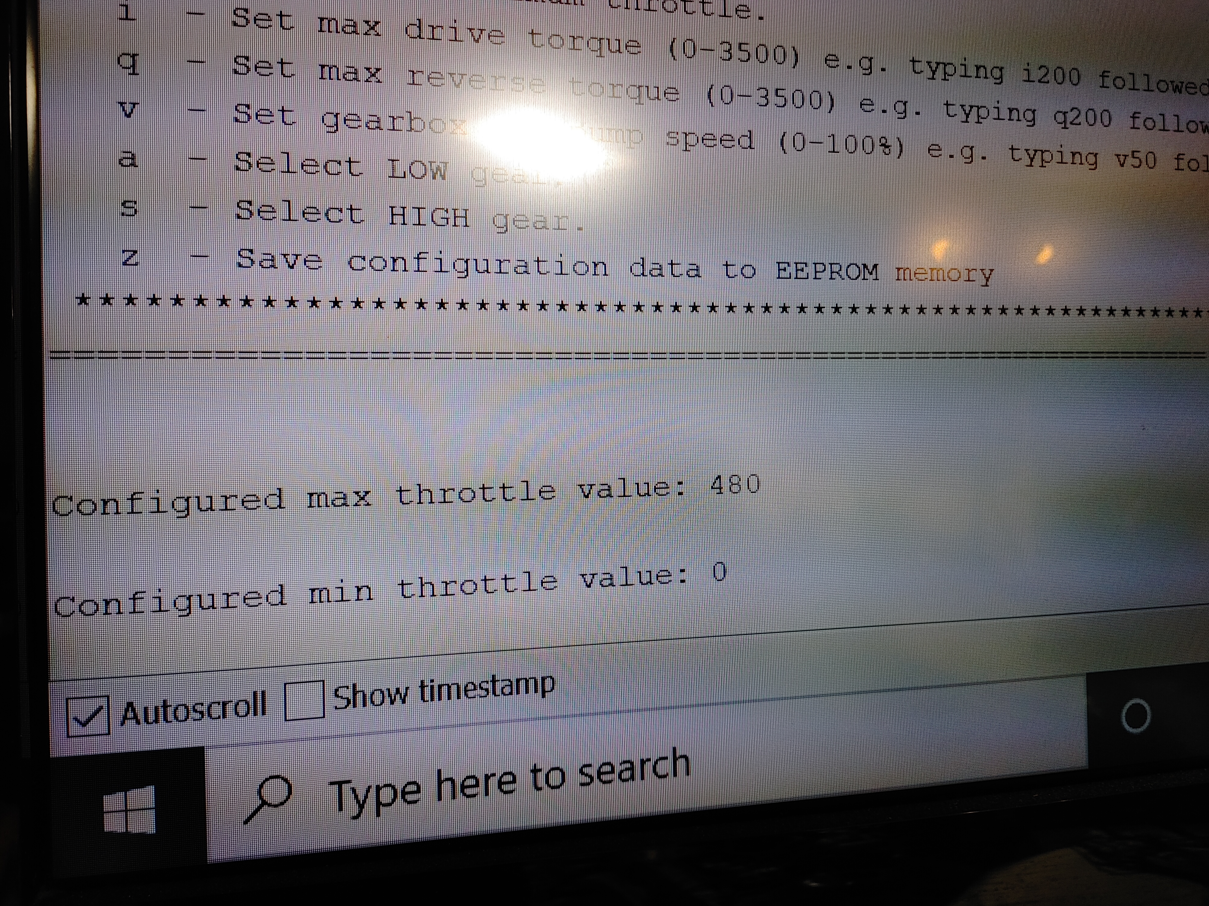

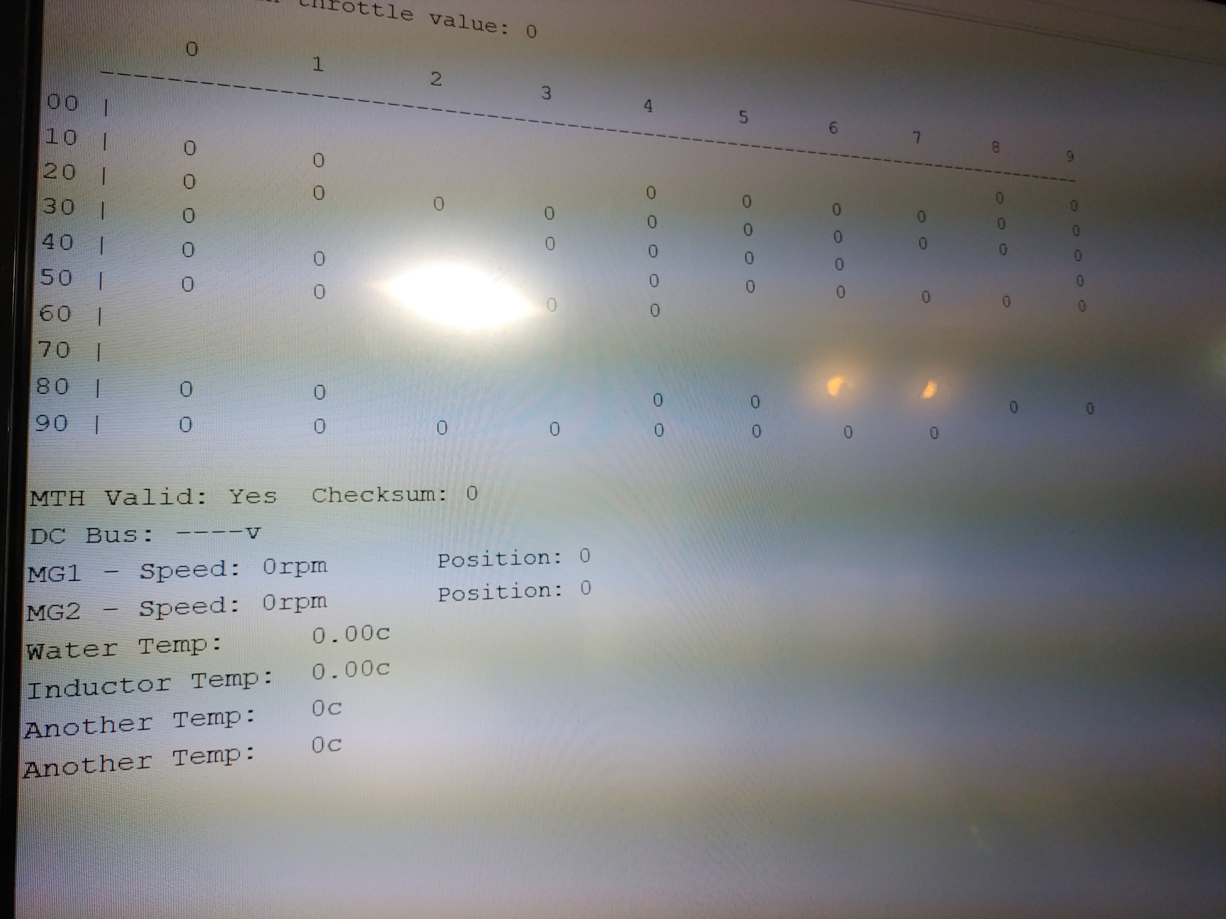

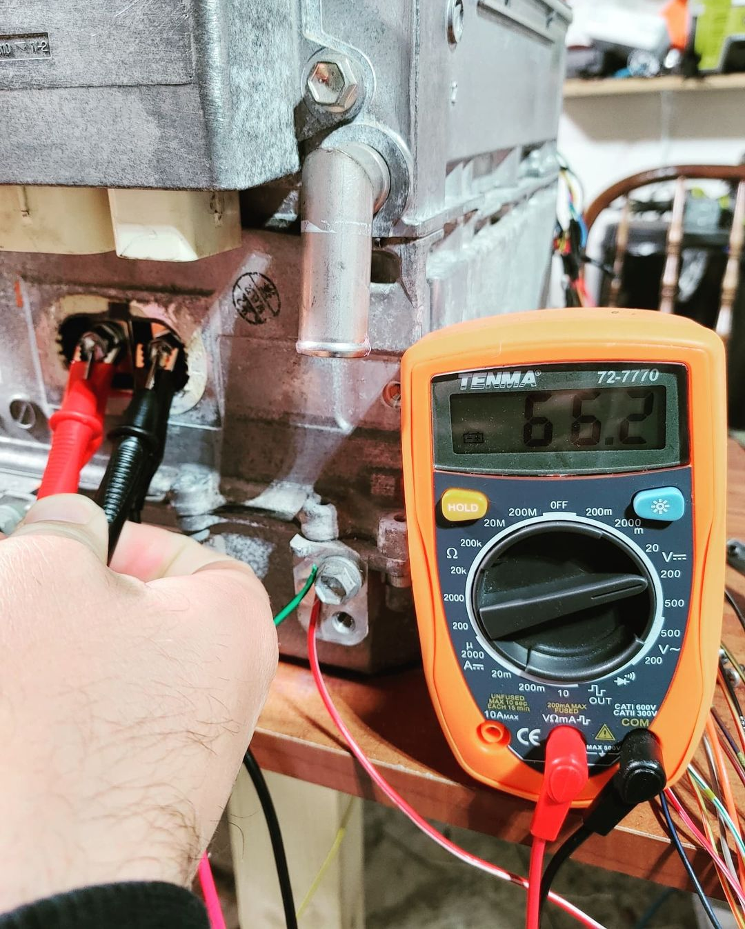

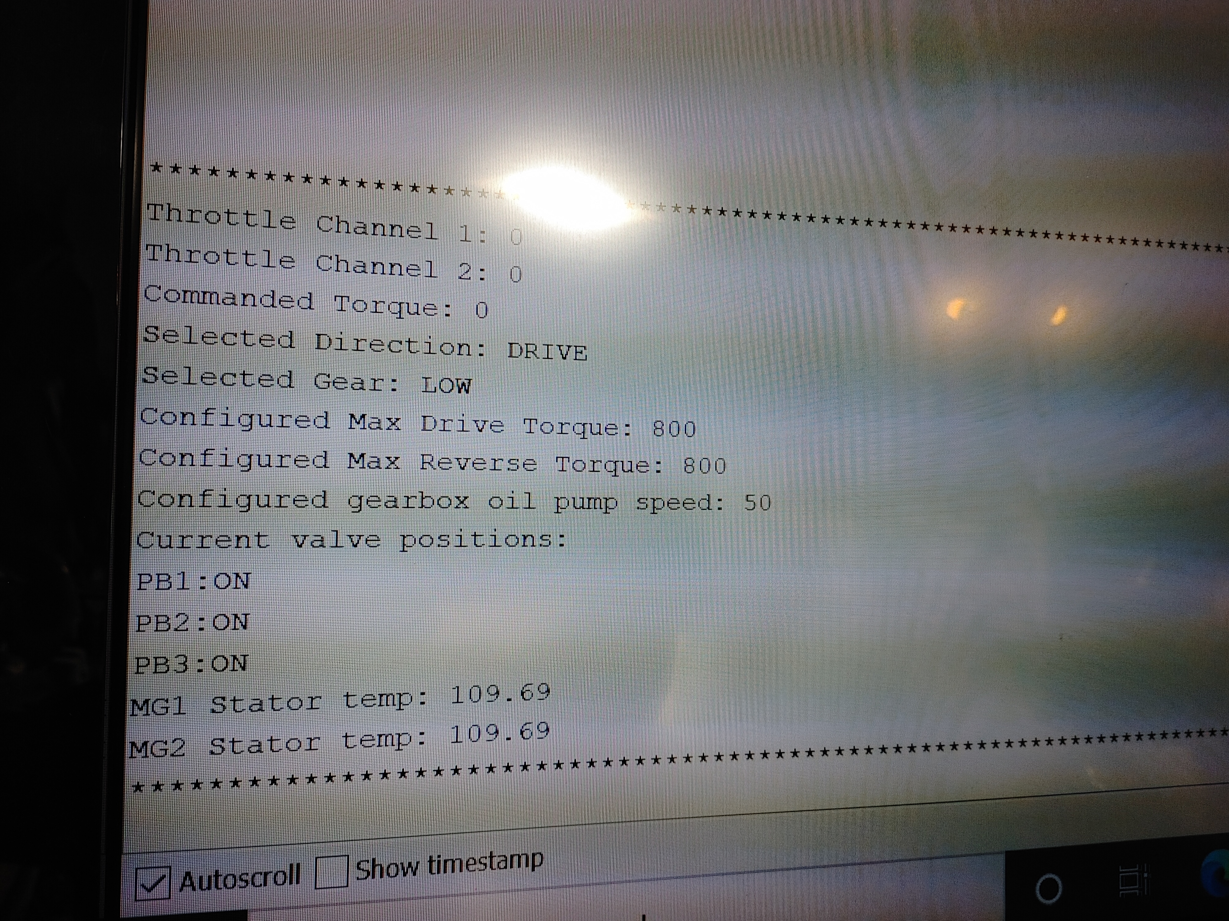

Does anyone know what the next steps should be - I want to verify everything before I get a new inverter. I checked and recheck the wires - and I'm building a new harness from a stock one - just to verify. I just don't seem to be getting anything from the inverter to the VCU
What was I doing?
- PatrcioEV-ATX
- Posts: 192
- Location: Austin, TX, USA
- Has thanked: 42 times
- Been thanked: 67 times
Not sure what else to suggest. You're clearly not getting good communication between the VCU and inverter. If you're sure the connections between the inverter and VCU are correct, you've got a common ground with the inverter, etc... then it should work. I do think it's interesting that in the screenshot it says "MTH Valid: Yes". To me, that implies some communication. But I stress I AM AN AMATUER AT BEST!Gigas wrote: ↑Tue Nov 23, 2021 1:25 pm Does anyone know what the next steps should be - I want to verify everything before I get a new inverter. I checked and recheck the wires - and I'm building a new harness from a stock one - just to verify. I just don't seem to be getting anything from the inverter to the VCU
What version of the software are you using and have you altered it in any way?
2012 Nissan Leaf (sold)
2016 Mercedes B250e (sold)
2023 Volvo C40
2023 Volvo C40

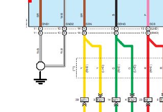

These are the only grounds I see - they are all connected if thats what you mean by a common ground
- ground 2.JPG (10.53 KiB) Viewed 12322 times
- ground 1.JPG (28.55 KiB) Viewed 12322 times
What was I doing?
- PatrcioEV-ATX
- Posts: 192
Yes. Same on my setup. Grounded to the same place as the VCU grounds and 12v supply. Sorry.. I don't have anything else to offer.
This was just from checksum output. It didn't account for zero checksums. I later edited this line to ensure the checksum is greater than zero, otherwise an empty packet would show as valid.PatrcioEV-ATX wrote: ↑Tue Nov 23, 2021 6:59 pm I do think it's interesting that in the screenshot it says "MTH Valid: Yes".
Serial.print("\tMTH Valid: "); if (mth_checksum > 0)Serial.print(mth_good ? "Yes" : "No"); else Serial.print("--");
And yes this inverter is not communicating.
