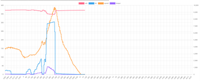

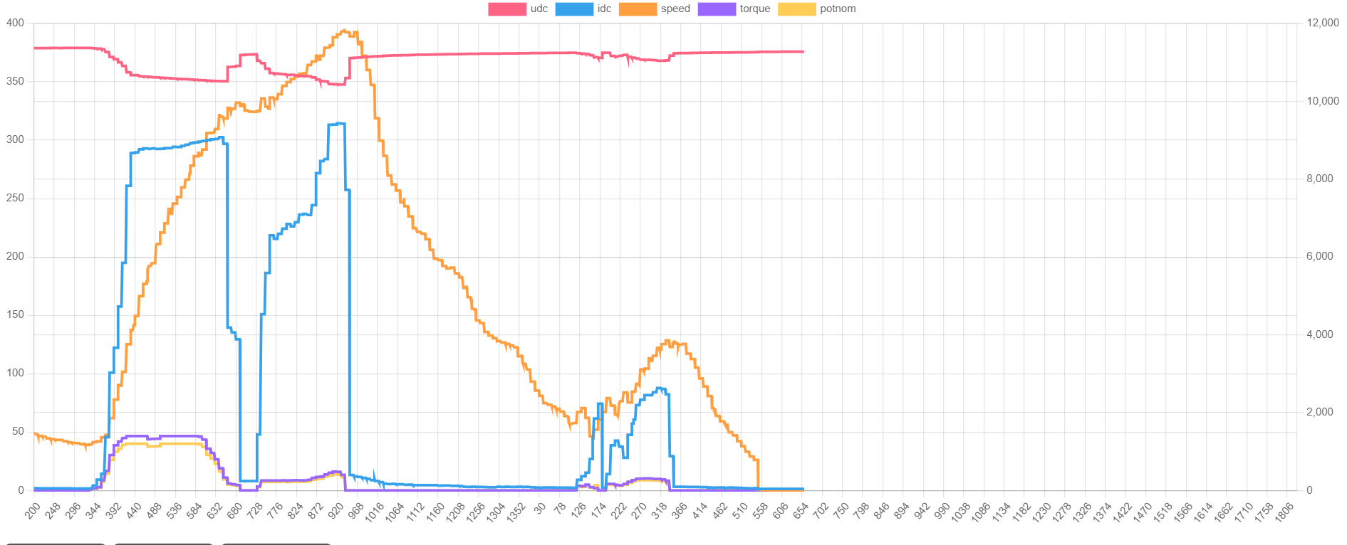

barracuda816 wrote: Sat Apr 06, 2024 8:50 am I am terrible at reading charts. What are the axis values here? When you say speed are you referring to motor rpm or vehicle mph?
the speed is motor rpm on the right hand scale the inverter temp and current on the left

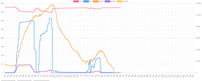

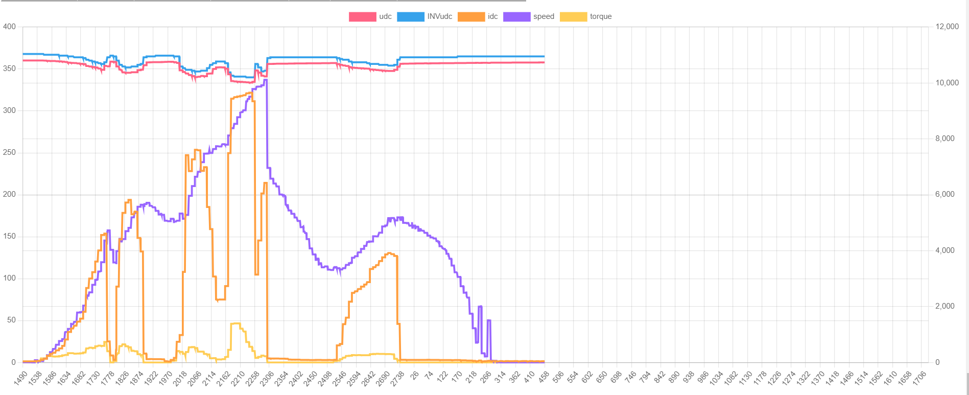

Here's the latest run hit a max speed of 65mph felt strong and smoothe just ran out of road
6.7mph per 1000 rpm so for me a theoretical 94mph if it makes max rpm and it feels like it will

What does that work out at rpm/V?

Did you see his speed level off? So there is no point speculating.

managed to get an extra 5mph had to brake pretty hard at the end of it though
I really need to get to a decent stretch of road so 70 Mph and still pulling strong

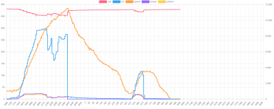

andybpowell wrote: Sun Apr 07, 2024 3:11 pm managed to get an extra 5mph had to brake pretty hard at the end of it though

looks like circa 325A and 350v at the battery? so ~115kw
Is it still limited in software, or is that all it will give?

One question, the time line on the bottom, is that on tenths of a second,
looks exceptional acceleration if that is so. Thanks

Looks like hundreds, so 30 to 60mph in couple of seconds .

Aragorn wrote: Mon Apr 08, 2024 8:44 am looks like circa 325A and 350v at the battery? so ~115kw
It's limited in software currently

Woodfie wrote: Mon Apr 08, 2024 11:06 am Looks like hundreds, so 30 to 60mph in couple of seconds .
Helps put your earlier post in line.. about screaming and wheel spinning down the road.😆
No idea on the bottom scale

I think the numbers across the bottom are sample number. The time varies with "Burst length" but from tests I have done it is about 27-28ms per sample with "Burst length" = 10.

80 ish it might have been 78-79 but near enough
need more road

Amazing, 12000 rpm and no signs of levelling off!

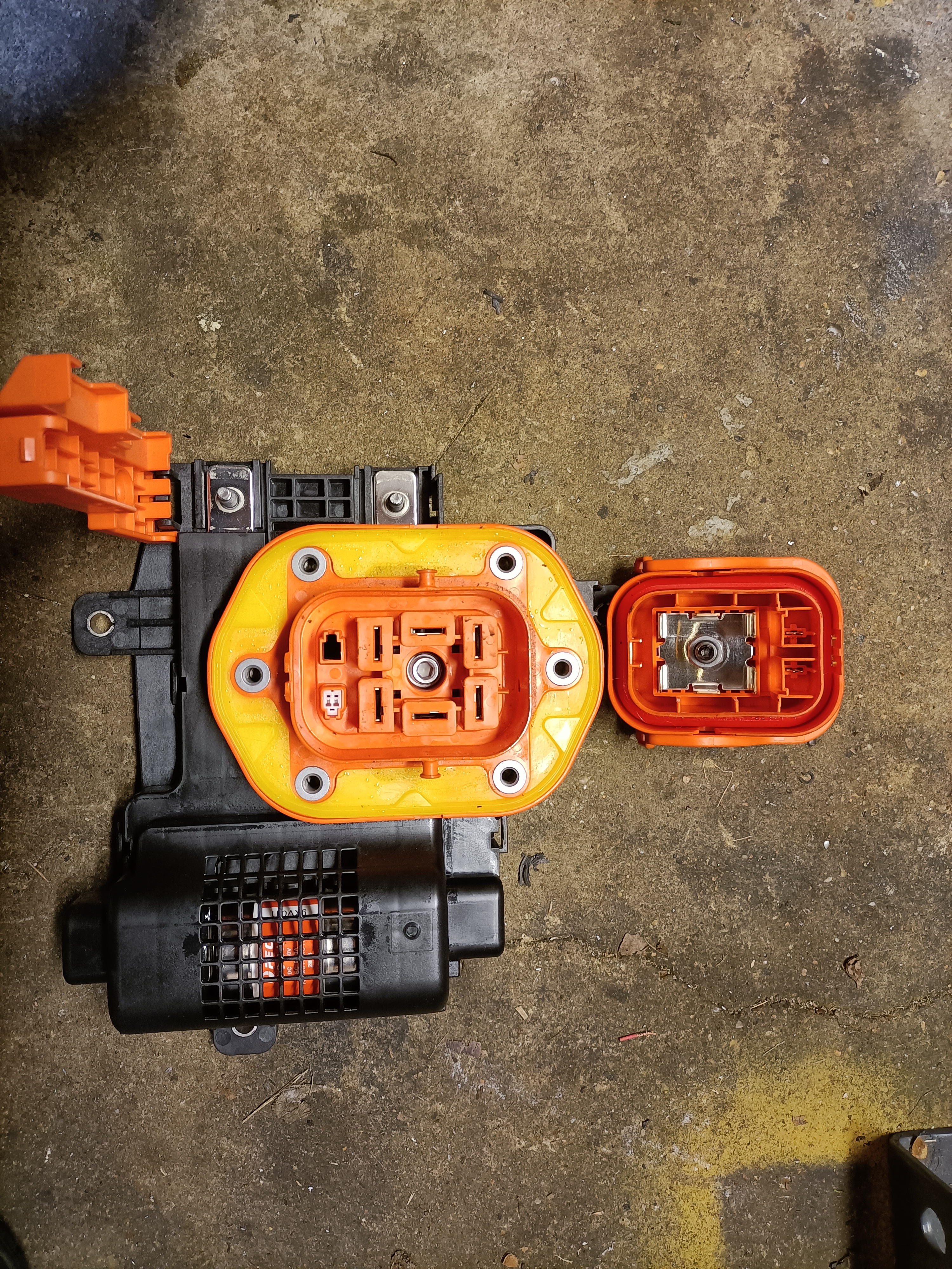

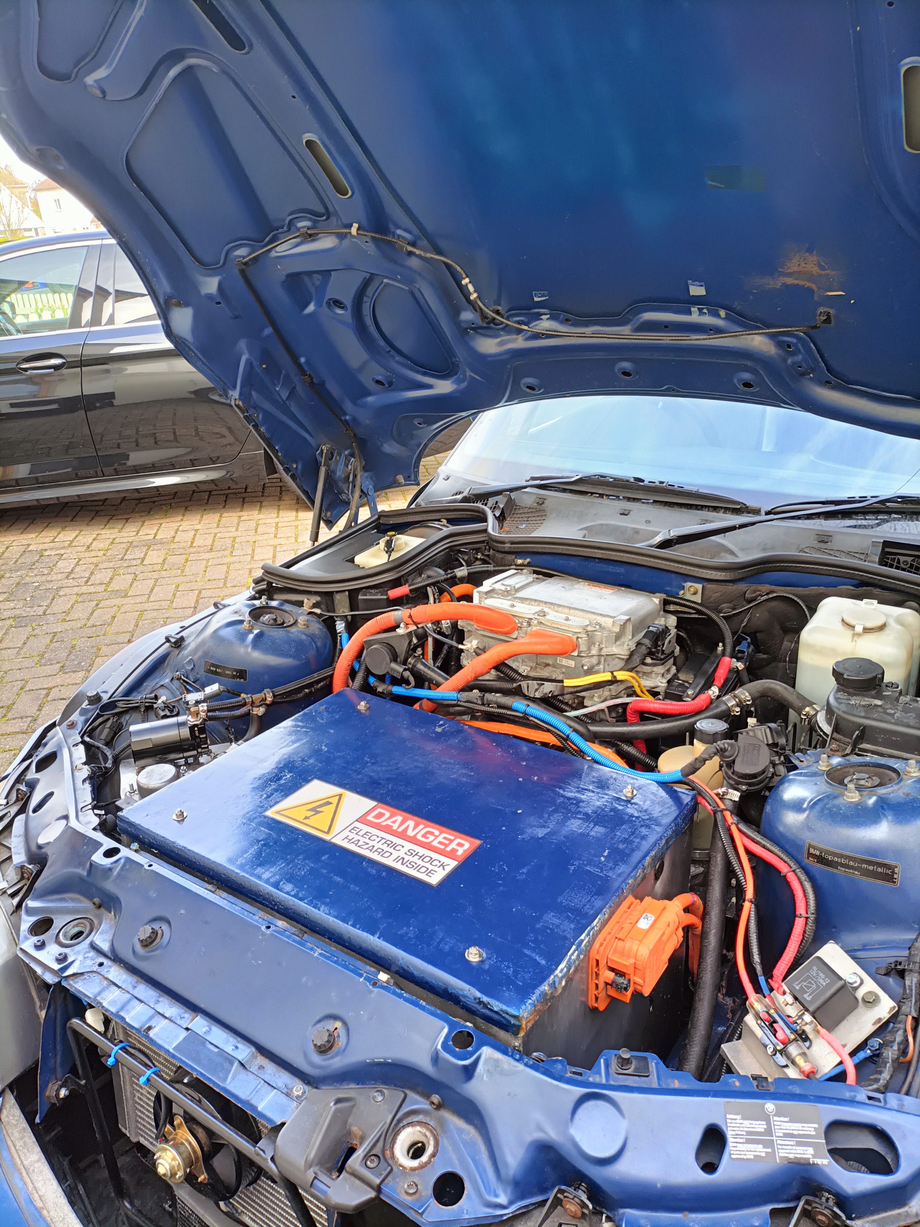

My Z3 is pretty much off the road for now as the extremely harsh power delivery makes it hard to drive safely and will tear out my bushes some of the updates in the Zombie pipeline should relieve or hopefully fix this issue so I'm doing the jobs I put off while evaluating the feasibility of the 300h which I think we can all agree has been decided as a yes it is.

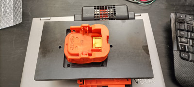

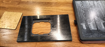

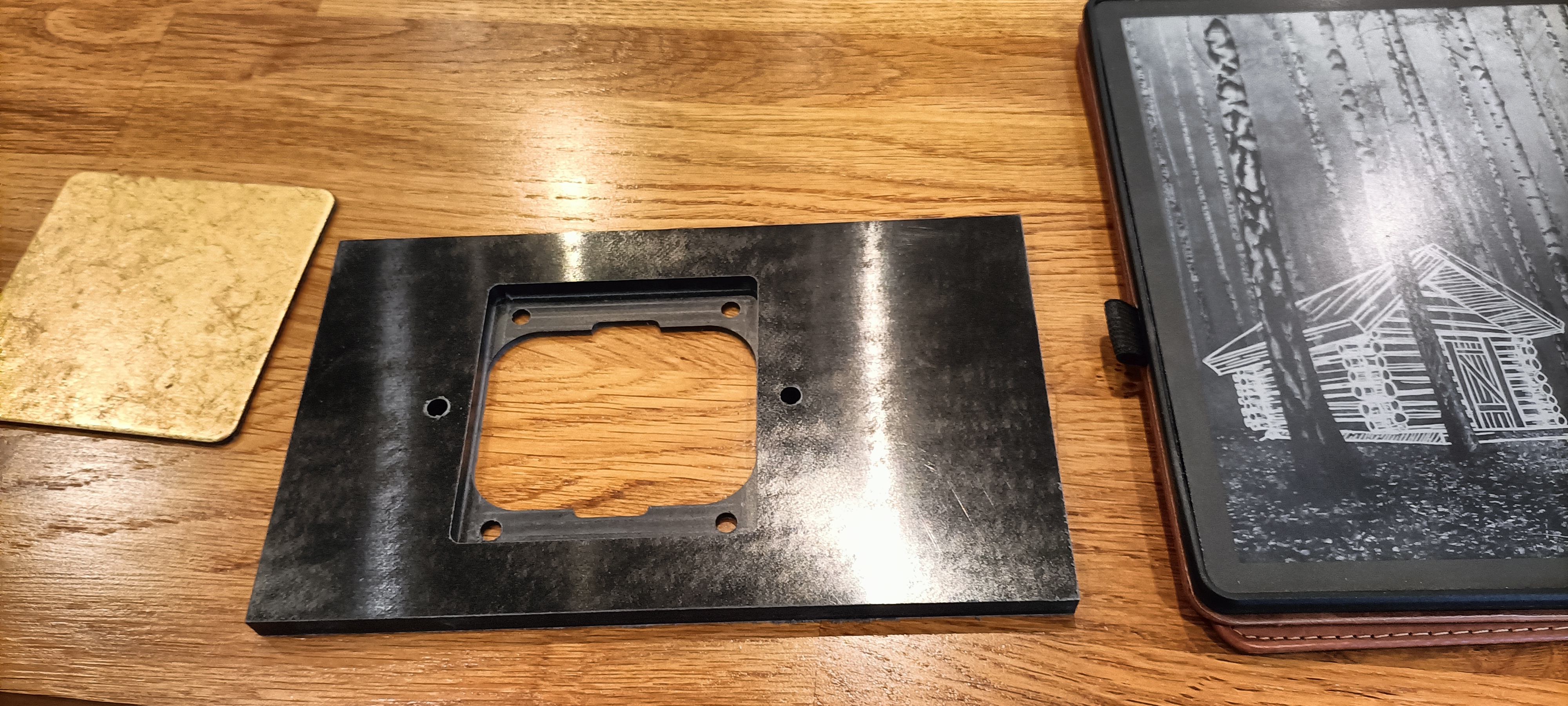

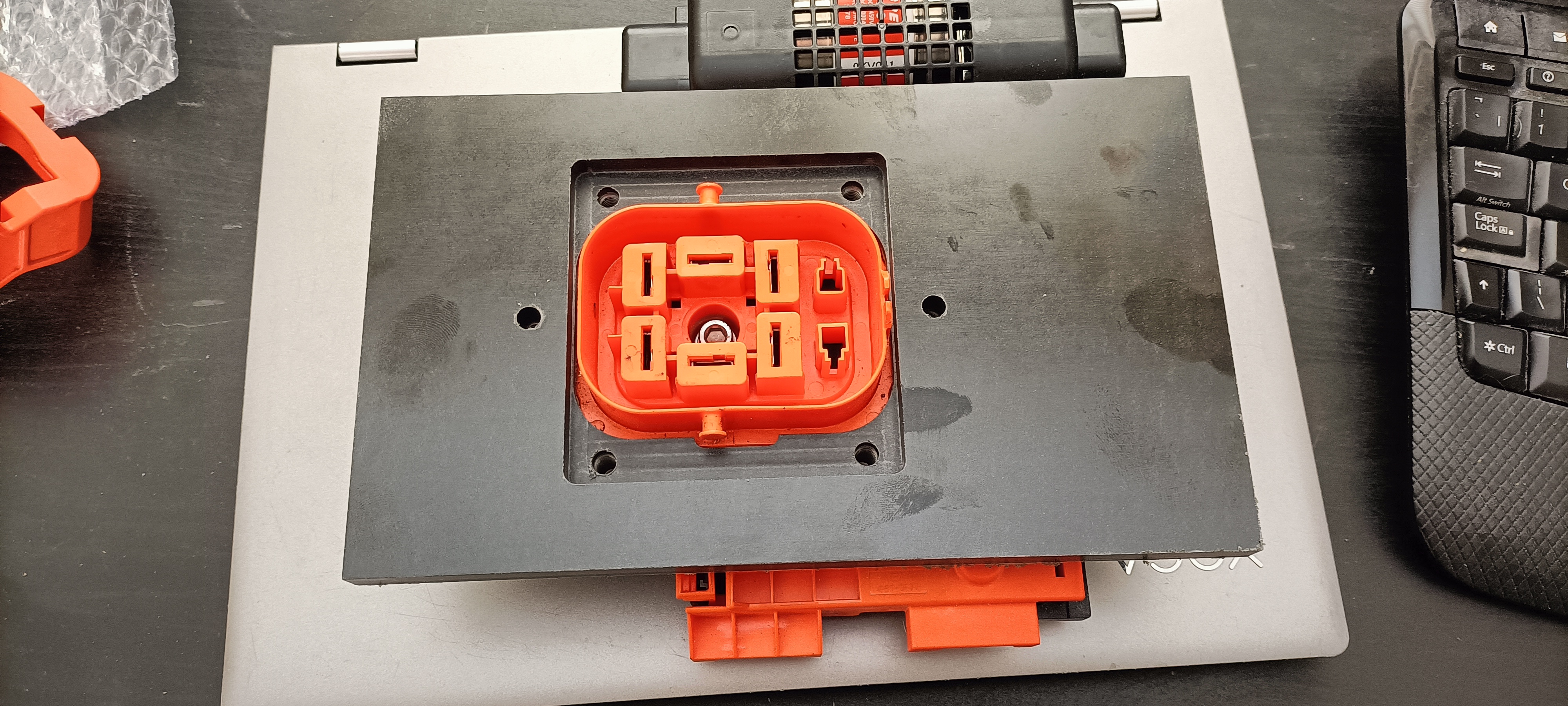

My rear battery box only has a fuse, no contactor and no safety disconnect the contactor I have and is a simple fix and I have purchased a kia niro (I believe) safety disconnect which also contains a fuse, the only issue with it is that the fuse sits about 10mm higher than the mountings for the disconnect
So I made an adapter to allow me to mount it flush with the top of my rear battery box, since I dont have a 3d printer or the cad skills required I made it using my CNC mill which was probably a lot quicker than printing anyway

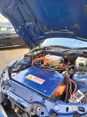

I also need to tidy the wiring and plumbing
