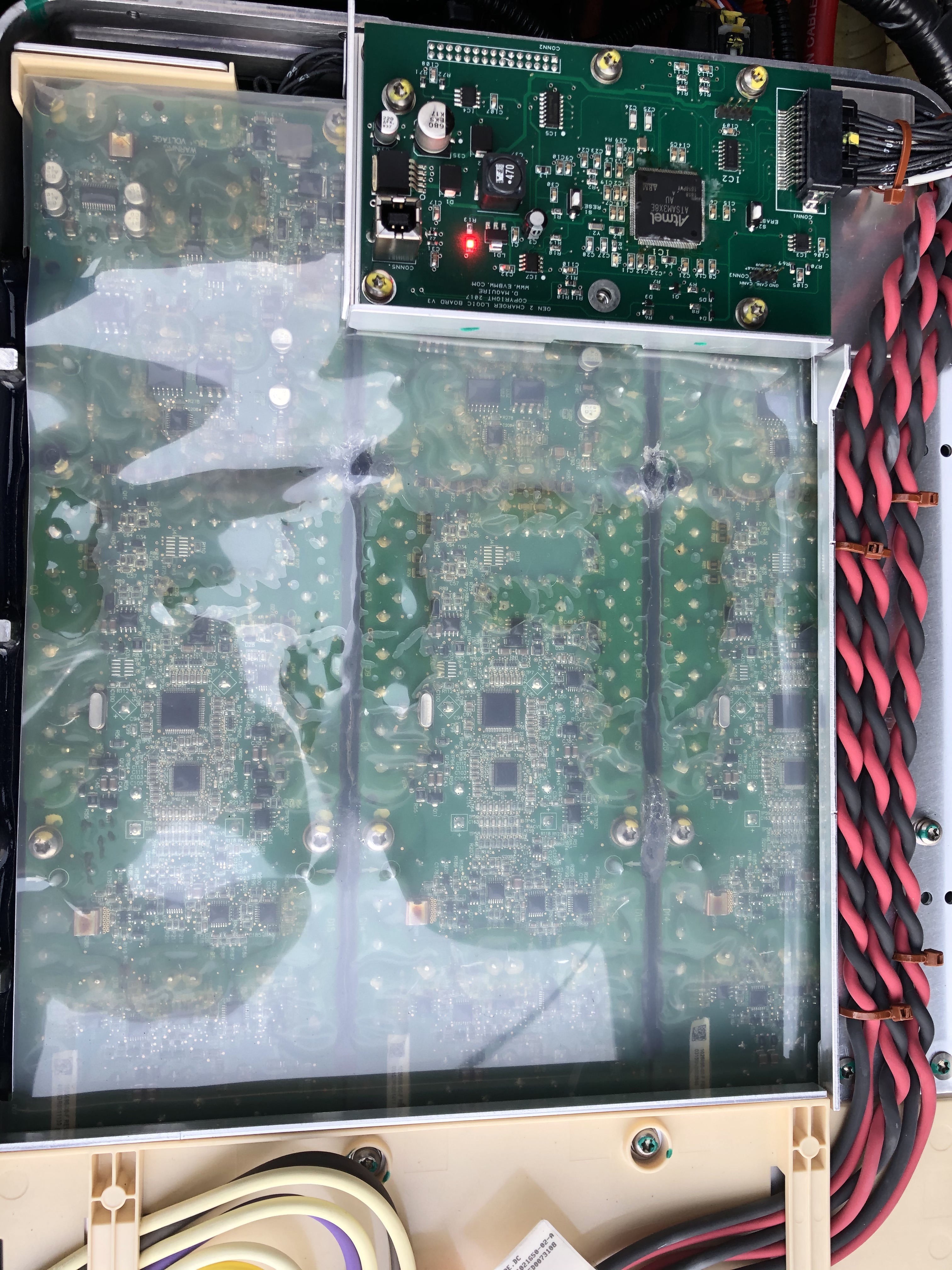

Hi all,
Requesting help for first start please - I have a Gen 2 with V4 PCB. I have loaded the Gen2TeslaChargerV4.ino
I don't have an EVSE handy, so I've wired the AC inputs to a 16A plug temporarily and just want to get some charge into the 320V battery.
I can turn off "auto start" in the menu, and then press "s" to start - a red LED comes on but nothing changes on the debug output (says not active), and no current flowing. No LEDs lighting up on the charger modules. Verified that there is definitely AC and DC present at the connectors, and the 12V supply.
What can I check?

191380 State: 0 Phases : 0 Modules Avtive : 0 OFF D1 L
Modules Turned OFF

So I'm just asking for a bit of guidance, as a newcomer. Should it now be working, based on what I wrote above, and what should I be seeing?
Started to check signals - the module connector gets 12V and 5V_OUTs OK, but ENABLEs are low. So presumably the micro is not setting these. Not sure why not. Is there any special trick to getting it to run without EVSE?
Edit - update: IN1 wasn't properly connected to a +12V feed, that is necessary. "D1 L" in the debug was the clue.

With that corrected, I get more info from the debug...
Two lights are on (module 1 and 3) although I have all 3 enabled in the menu.
After connecting the AC power the module LEDs go out and the debug shows this instead:
Again, any advice on what I should see here would be great. Thanks!

Proximity Status : Unconnected AC limit : 0 /Cable Limit: 0 /Module Cur Request: 333 /DC total Cur:0.01 /DC Setpoint:340 /DC tVolt:355 /DC driven AC Cur Lim: 16248
184366 State: 1 Phases : 0 Modules Avtive : 3 ON D1 H
Phase 1 Feebback // AC present: 0 AC volt: 2 AC cur: 0.00 DC volt: 321 DC cur: 0.01 Inlet Targ: 216 Temp Lim Cur: 15 17 25 EN:0 Flt:1 Stat:100001
Phase 2 Feebback // AC present: 0 AC volt: 0 AC cur: 0.00 DC volt: 0 DC cur: 0.00 Inlet Targ: 0 Temp Lim Cur: 0 0 0 EN:0 Flt:0 Stat:0
Phase 3 Feebback // AC present: 0 AC volt: 2 AC cur: 0.00 DC volt: 323 DC cur: 0.00 Inlet Targ: 216 Temp Lim Cur: 15 17 25 EN:0 Flt:1 Stat:100001
277552 State: 2 Phases : 0 Modules Avtive : 3 OFF D1 H
Modules Turned OFF

you need to turn on the AC as soon as you command 's' for start.
Module 2 is not reporting anything, so it might be broken/not powered up.

Thanks Tom. I was doing that, but the module LEDs would immediately go out, and I'd have to reset the controller and press 's' again to get them back.
However after trying it multiple times, with different modules enabled etc, suddenly it started working (clicks, and then charge current).
Now it charges whenever the IN1 input and AC power is connected, it doesn't seem to need the 's' command.
Something seems a bit random.
Module 2 has never lit up though, I will try to check that it's got the right signals. It could be that I was sold a defective unit.

Do you have a solid 12V ground connection to your charger metalwork?

Yes, have been very careful about that due to reading all the issues people had. AC Earth, car chassis and charger metalwork is bonded together with something like 6mm cable, and the 12V battery is right next to the charger.Kevin Sharpe wrote: ↑Wed Apr 01, 2020 9:50 pmDo you have a solid 12V ground connection to your charger metalwork?

OK, some progress! There is nothing wrong with module 2, it was just a lifted pin on the connector, which happened to be enable #2.
So they all fire up now and I've turned it up to 20A (briefly, without cooling) - no problem.
However, still one issue - as above when turning on the power for the first time, the module lights will go out. I found the only way to get past that is press the reset button!! It then starts right up and charges. And weirdly it then happily accepts the power being cycled as much as you want.
I wondered if the processor is resetting for some reason (a transient, or related to earthing), and turning off the outputs..
Doesn't seem to be related to whether the USB cable is plugged in.
Any ideas? I appreciate the help so far, it's always a lot easier to debug something if you have the first idea of how it's supposed to behave when it's working...

Try gently tapping the controller board, wiring harness, connectors, etc., while it's working. Also review the controller board for any missing components. Maybe a high res photo of the controller board would allow us to do a comparison with a known working board.
What's the history of this board? Purchased from Damien, a third party, or a home build?

Thoroughly wiggle tested it! Yes, this is a home built board - I made this last year when none were available and no reply about whether more would be made. Of course by the time I got around to putting it in the car, there's another batch...Kevin Sharpe wrote: ↑Thu Apr 02, 2020 1:01 pmTry gently tapping the controller board, wiring harness, connectors, etc., while it's working. Also review the controller board for any missing components. Maybe a high res photo of the controller board would allow us to do a comparison with a known working board.
However I've ruled out a reset / crash. It's fully repeatable, now I understand the sequence, but definitely seems wrong. So I'm wondering if it's a software issue with this Gen2TeslaChargerV4.ino file - has anyone else actually used it in the "no evse" manual mode? I will try to trace what happens.
edit: found one bug, line 360:

OK, I couldn't find the exact cause but removing the call to "manualMode()" on line 417 solves the problem. The charger now starts on the 's' command, as it says in all the instructions and as Tom said.
So, take note, I guess! I will be making some code changes anyway so will submit a working version when the time comes..
