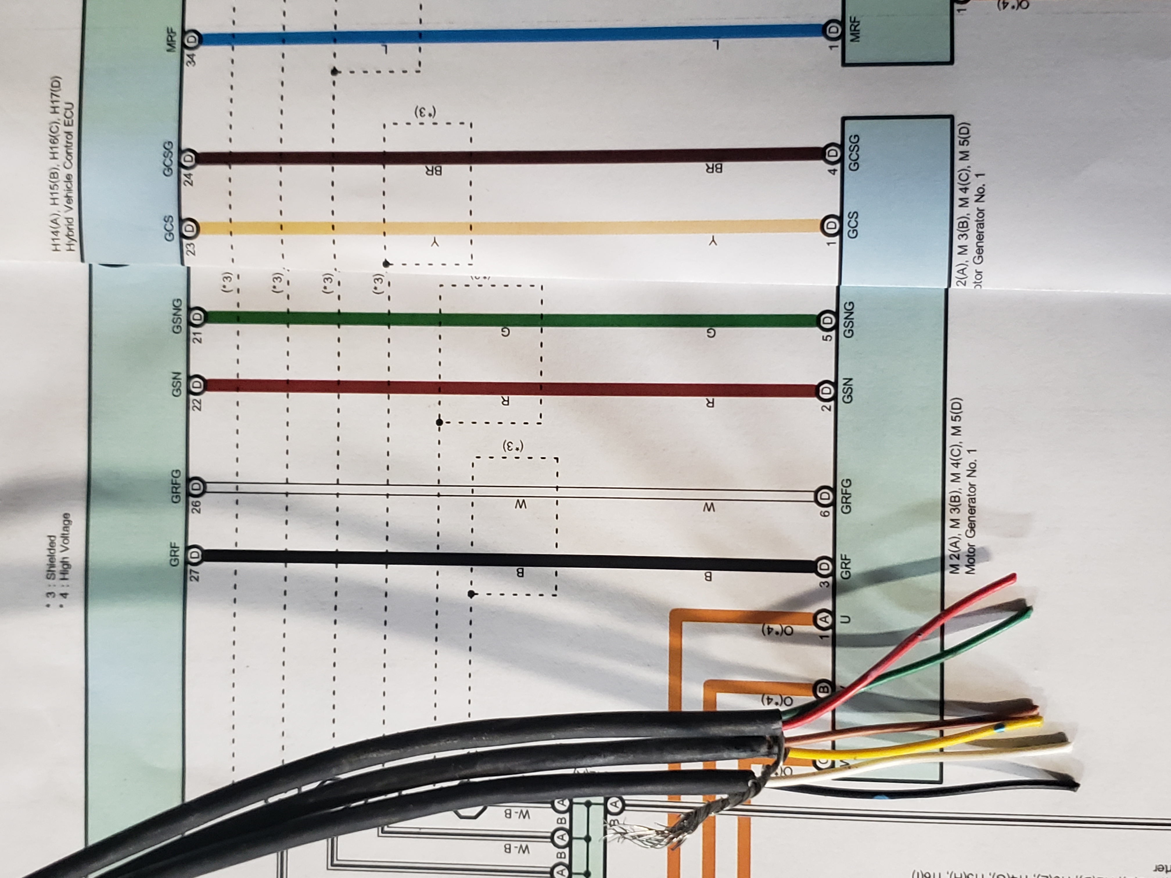

greetings everyone,
Ive a question about resolver connections.
I believe these are the colors and signals for the gen2 prius MG1 resolver( and if anybody has MG2 connections I can easily find the colors by the attached photo)
black GRF = exc a
white grfg=gnd
red GSN=ENC A
green GSNG= SIN a
Yellow GCs= ENC B
Brown Gcsg= cos a
and I believe the pin mapping JOHU provided shows
pin1 is ENC_B would be yellow
Pin2 is S1S4 would be ??
pin3 is ENC_A would be red
Pin4 is R1 ( exit a?) would be black
Pin 5 is Resolver 2 would be ??
so 6 wires and 5 connection points
my question is this , where does cos A belong and where does Sin A belong?

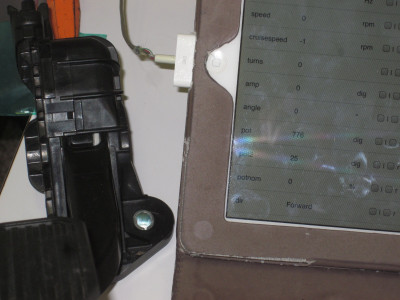

Throttle pedal from gen 2 prius:
Pin 1 - VCP2 = PIN 6 - 5V
PIN 2 - EP2 = PIN19 - GRND
PIN 3 - VPA2 = PIN 8 THROTTLE 2
PIN 4 - VCPA = PIN 6 - 5V
PIN 5 - EPA = PIN PIN 19 - GRND
PIN 6 - VPA = PIN 7 - THROTTLE 1
Again, good if someone with experience with this could validate.

GRF -> R1 (Pin 4)imwoody36 wrote: ↑Thu Jul 16, 2020 10:13 pm black GRF = exc a
white grfg=gnd
red GSN=ENC A
green GSNG= SIN a
Yellow GCs= ENC B
Brown Gcsg= cos a
GRFG -> R2 (Pin 5)
GSNG and GCSG -> S1S4 (Pin 2)
GSN -> S2 (Pin 3)
GCS -> S3 (Pin 1)
Maybe I'm mistaken about the last two but thats what the pinswap parameter is for (if not moving, set to 2)

See here the pin positions: viewtopic.php?f=9&t=335#p3772RetroZero wrote: ↑Fri Jul 17, 2020 5:47 am Throttle pedal from gen 2 prius:
You probably have the 2gen pedal with wider pins. I used one in mazda https://mazdamx3ev.wordpress.com/2016/02/12/pedal/
Pin 1 is the lowest pin on connector when pedal is installed.
Update...
I was having troubles maintaining a WiFi connection to the HICU, found three things: 1) Low supply voltage (<11.5vdc) seems to cause lost signal, 2) with multiple WiFi signals, the computer kept switching between them (I "forgot" all the others, which helped) and 3) Having a dedicated device WiFi (iPad in my case) made life much simpler.
Also used the 5v ref for the Gen2 Prius pedal, but to keep POTMAX <5000, I had to use a 200 ohm resistor on the 5v supply. Obviously that is not the best option because additional 5V loads will change the circuit voltage. When I get the MGR spinning smoothly and am ready to really validate every circuit, I will move the resistor to the signal side.
I used the "AUTO" + Refresh option to watch "POT" in the Spot_Values area and found idle = 777 & WOT = 4011 with very good consistency. So I set POTMIN = 780 and POTMAX = 3975. This should ensure the dead pedal = idle and fully depressed is 100% throttle.

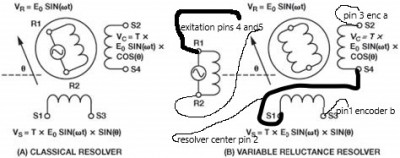

okay thanks for the support, but I dont think pin6 is to be used for the resolver as it is labled 5v output.
instead I think
pin 1 = yellow ( enc b)
pin 2= green and brown ( sin a and cos a)
pin 3= red ( enc a)
pin 4 = black r1
pin 5 = white r2
does anybody disagree?

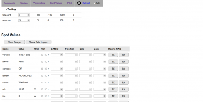

I have hooked up my old 3 phase lathe motor but can't seem to get it running. Using the same settings as I was for the delta light test.
When running fslipspnt at 8Hz or higher there is nothing noticeable happening and the motor will spin freely by hand. However at very low settings like 0.3 and 1 there is a noticeable resistance to turning the motor by hand in time with the pulses and the pulses will stop the motor from turning.
I've tried switch phases wires around and the outcome is always the same.

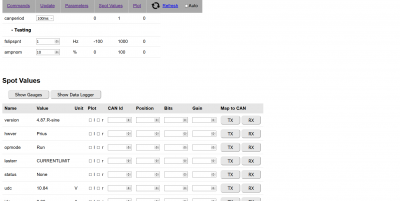

I ran into another issue after working to install the DC and precherge relays.... The pre-charge would drop out after a few seconds, turned out that the small "197" bulb I was using to confirm bus voltage was pulling more amps than the PC resistor could supply. Remove indicator = fixed, both PC and DC relays behave as expected.
Now with FOC and having followed the "Using FOC Software" instructions, I get zero output on any of the three phases and I don't hear any PWM being applied (although I have mild tinnitus...). Any ideas?
The GREAT news is that now the Resolver works perfectly w/FOC 4.87.R and I can even count revolutions and seems to match published gearing almost exactly

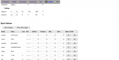

Run mode or Manual mode? Is dir=forward? Either by setting dirmode=AlwaysForward or applying 12V to forward pin. All derating parameters set up in a way so they don't derate? (Shouldn't matter in manual mode however)
Yes, same as I had with Sine, but no movement.
I did notice something odd after loading the current SIN.bin file for testing, every time I try and enter 8 for fslipspnt & 75% for ampnom, it reverts to 1 and 10%, almost like it is dividing by 10 and rounding??? Every time I refresh, they do the same. I found 4.85.R is normal for these params.
Wondering if the inverter is ok after the minor short yesterday. Although I cannot see how that would be possible to damage it A 40V with 20ga wires and a power supply limited to <100A.
