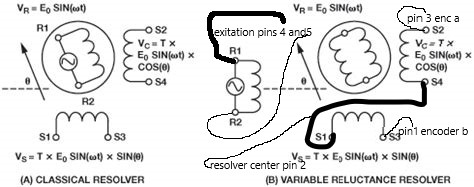

greetings everyone,
Ive a question about resolver connections.
I believe these are the colors and signals for the gen2 prius MG1 resolver( and if anybody has MG2 connections I can easily find the colors by the attached photo)
black GRF = exc a
white grfg=gnd
red GSN=ENC A
green GSNG= SIN a
Yellow GCs= ENC B
Brown Gcsg= cos a
and I believe the pin mapping JOHU provided shows
pin1 is ENC_B would be yellow
Pin2 is S1S4 would be ??
pin3 is ENC_A would be red
Pin4 is R1 ( exit a?) would be black
Pin 5 is Resolver 2 would be ??
so 6 wires and 5 connection points
my question is this , where does cos A belong and where does Sin A belong?

I found some info whilst trolling threads. Will start documenting this stuff soon.
AFIK, looking at the back of the connector to both MG1 and Mg2,
PIN 1 - MRF = PIN 6 - EXITATION (adapter board)
PIN 2 - MSN = PIN 3 - ENC A
PIN 3 - MCS = PIN 1 - ENC B
PIN 4 - MRFG = PIN 2 - S1/S4 GROUND
PIN 5 - MSNG = PIN 4 - R1
PIN 6 - MCSG = PIN 5 - R2
Hope that helps, and hope I got it right.

GRF -> R1 (Pin 4)imwoody36 wrote: ↑Thu Jul 16, 2020 10:13 pm black GRF = exc a
white grfg=gnd
red GSN=ENC A
green GSNG= SIN a
Yellow GCs= ENC B
Brown Gcsg= cos a
GRFG -> R2 (Pin 5)
GSNG and GCSG -> S1S4 (Pin 2)
GSN -> S2 (Pin 3)
GCS -> S3 (Pin 1)
Maybe I'm mistaken about the last two but thats what the pinswap parameter is for (if not moving, set to 2)

okay thanks for the support, but I dont think pin6 is to be used for the resolver as it is labled 5v output.
instead I think
pin 1 = yellow ( enc b)
pin 2= green and brown ( sin a and cos a)
pin 3= red ( enc a)
pin 4 = black r1
pin 5 = white r2
does anybody disagree?
