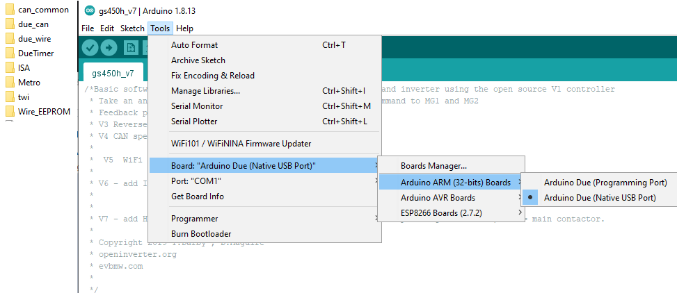

I'm in need of a bit of clarification being new to arduino, I'm installing the latest gs450h software _v7 from Damien though Arduino. I have installed the libraries listed and Arduino Due board drivers (image attached) but when I compile its missing /twi.h am I missing this? (Atmel CMSIS driver) https://github.com/arduino/ArduinoModule-CMSIS-Atmel
EDIT
I think I'm there now, added the esp8266 board with board manager https://arduino.esp8266.com/stable/pack ... index.json
set the board arduino due native USB and port to COM1

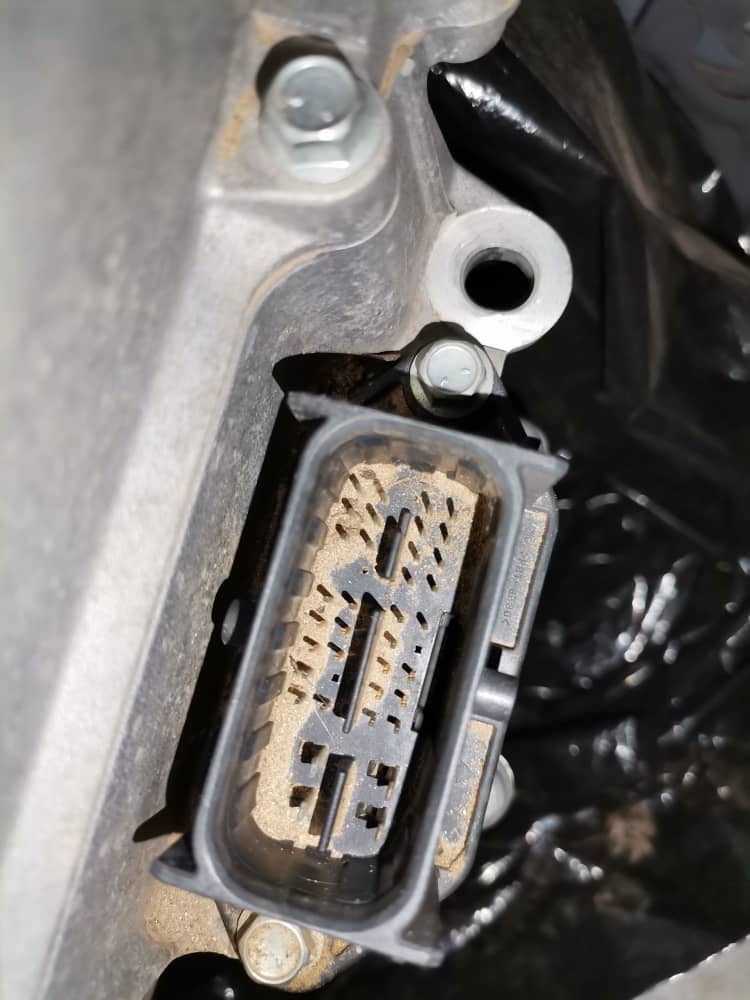

Dan--T wrote: Sat Jun 13, 2020 10:54 pm Hello, I'm Looking to build a GS450H based EV using your VCU board.
I've found a 4th Generation 2012-2018 GS450H (Second Generation 450H) quite cheap, does the VCU board work with the later generation GS450H?
Has anybody tried to use the later generation as a base for EV conversion yet?
Dan
Hi, did anyone manage with this? I have the same complete drivetrain and I already bought the control board and soldered it. I now see that the pin layout on plug on the inverter is slightly different. it does look the same as the one on the IS300h. So I would love to see if I can get this unit running before trying the to an inverter from pre 2012. Am in southern africa so those cars are extremely rare.
2013 gs450h inverter plug
Posts: 4000
Been thanked: 1115 times
The pinout might be different but the signals are probably the same. Just a question of matching them up.

Kit all soldered, USB connected, Arduino software downloaded and installed, and, board talking to 'Mac' OK.
When I go to upload, or even verify Wifi or Software ino get the Error Message:
Arduino: 1.8.13 (Mac OS X), Board: "Arduino Due (Native USB Port)"
gs450h_v2:12:19: fatal error: Metro.h: No such file or directory
#include <Metro.h>
compilation terminated.
exit status 1
This report would have more information with
"Show verbose output during compilation"
option enabled in File -> Preferences.

arturk
Posts: 148
Location: United States, MD
Has thanked: 7 times
Post by arturk »
Looks like you need "Metro" library installed under "/libraries" folder of your Arduino environment.
Here is where you can download it from:
https://github.com/thomasfredericks/Met ... ino-Wiring
You may be missing other libraries too (CAN, ISA, ...), please check.
There are links to most of them in the code:
#include <due_can.h>  //https://github.com/collin80/due_can
#include <due_wire.h> //https://github.com/collin80/due_wire
#include <DueTimer.h>  //https://github.com/collin80/DueTimer
#include <Wire_EEPROM.h> //https://github.com/collin80/Wire_EEPROM
For ISA search dedicated thread for more info.

Thank you, finally found time to give this a go... still no joy 'scratches head'
Wondering if part of the problem is the connection as well, as in, selecting the correct Arduino board... or ARM chipset.
Any help/advice very much appreciated :)
TFirenza
Posts: 35
Joined: Sun Mar 08, 2020 8:18 pm
Location: Herefordshire
Post by TFirenza »
as arturk mentioned, check libraries are all installed, board is installed and set to usb.
Not sure if needed but but also installed the esp8266 board with the board manager,
add the following under preferences 'additional board manager urls'. It should then appear in the board manager list
