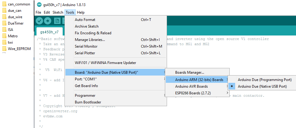

I'm in need of a bit of clarification being new to arduino, I'm installing the latest gs450h software _v7 from Damien though Arduino. I have installed the libraries listed and Arduino Due board drivers (image attached) but when I compile its missing /twi.h am I missing this? (Atmel CMSIS driver) https://github.com/arduino/ArduinoModule-CMSIS-Atmel
EDIT
I think I'm there now, added the esp8266 board with board manager https://arduino.esp8266.com/stable/pack ... index.json
set the board arduino due native USB and port to COM1

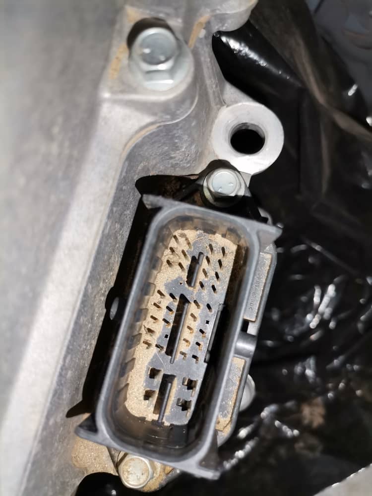

Dan--T wrote: Sat Jun 13, 2020 10:54 pm Hello, I'm Looking to build a GS450H based EV using your VCU board.
I've found a 4th Generation 2012-2018 GS450H (Second Generation 450H) quite cheap, does the VCU board work with the later generation GS450H?
Has anybody tried to use the later generation as a base for EV conversion yet?
Dan
Hi, did anyone manage with this? I have the same complete drivetrain and I already bought the control board and soldered it. I now see that the pin layout on plug on the inverter is slightly different. it does look the same as the one on the IS300h. So I would love to see if I can get this unit running before trying the to an inverter from pre 2012. Am in southern africa so those cars are extremely rare.
2013 gs450h inverter plug
Posts: 3563
Been thanked: 88 times
The pinout might be different but the signals are probably the same. Just a question of matching them up.
