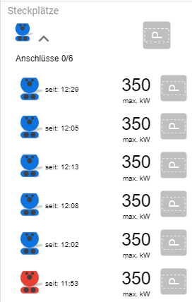

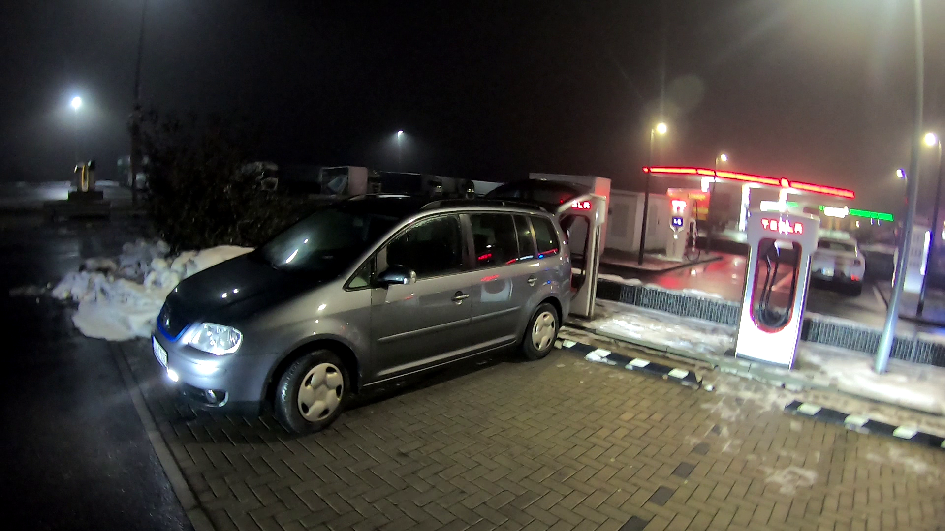

With those bugs you mentioned fixed I could finally charge at the Tesla SC
EDIT: One bug: when I stopped the charger via the app Clara stayed in CurrentDemand. I loosened the connector until CP was interrupted, then it turned off.
Was going to test Ionity also but all stalls were taken (Lutterberg)
EDIT: thought this looked kinda cool

Really great. And the third operator in Lutterberg (https://www.goingelectric.de/stromtanks ... -11/80537/) still is not alive? Would be a great site for testing, three different manufacturers within 200 meters

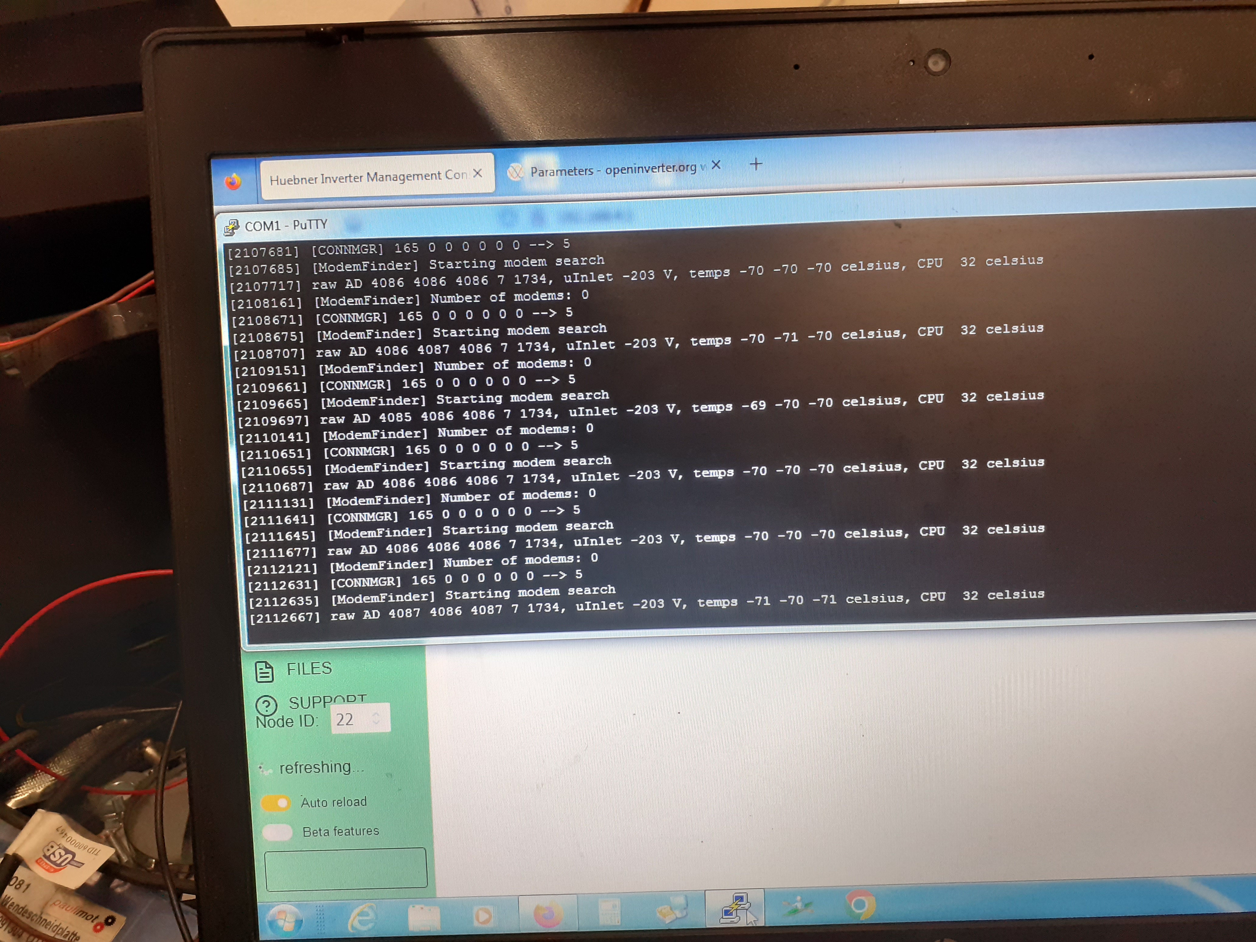

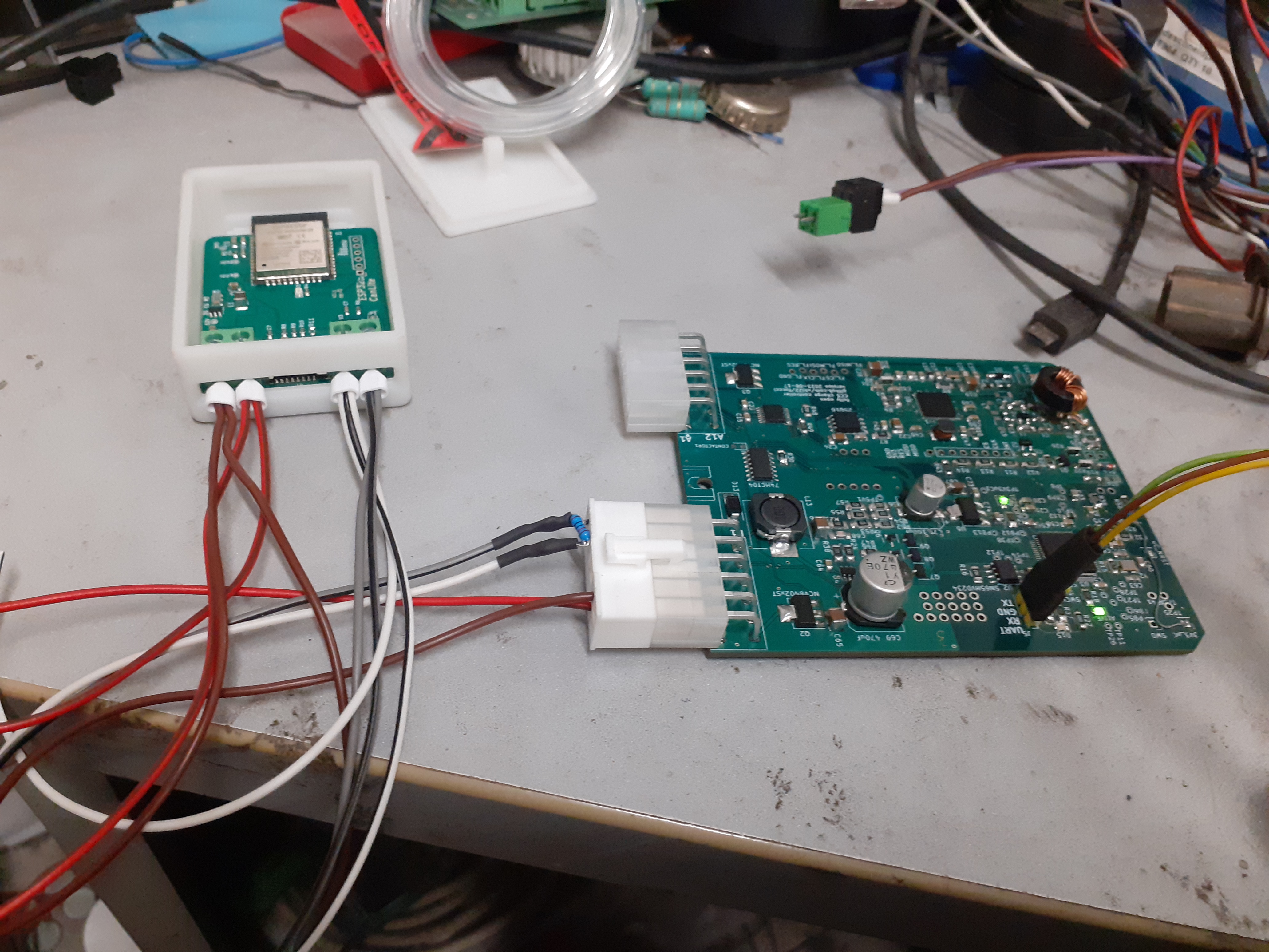

Quick return to hardware. I have populated the second board now but no joy.
Processor runs fine but I see no comms between QCA and STM. STM sends 4 bytes, I think 0xC3 0 0 0 and reply is all zeros. Also on bootup I don't see any activity between SPI flash and QCA.
3V3 and 1V2 measure ok, so at least the voltage reg in the QCA is running.
Powerline RX/TX have the correct resistance between them but don't sit at 1V6
I've reflowed the chip a couple of times and the joints look fine.
Any idea what to check?
SOLVED! L2 was missing, conducting 3V3_D to 3V3_A

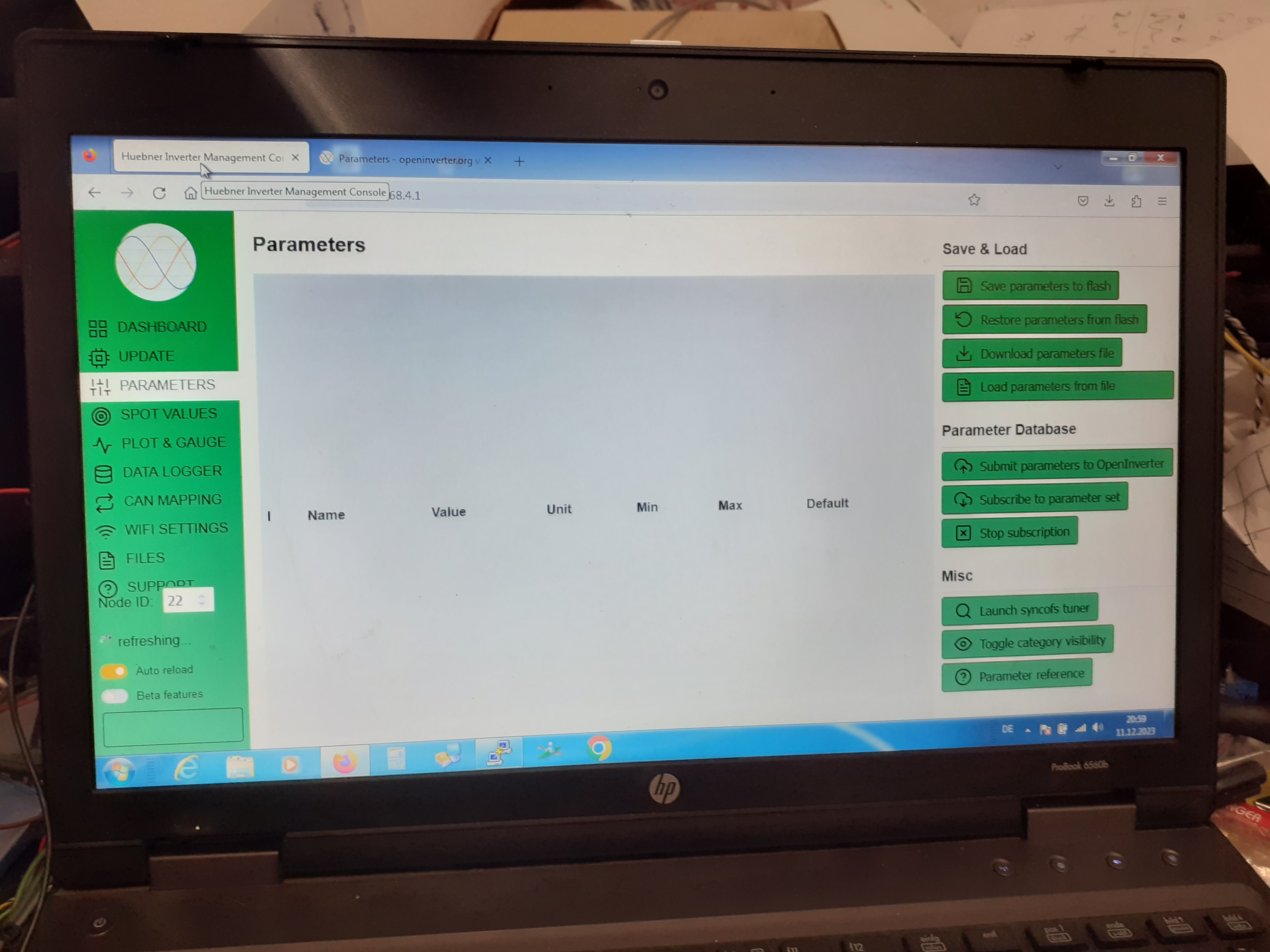

Some progress with the web interface. The setup was not easy, I collected my notes here: https://github.com/jsphuebner/esp32-web ... ace/pull/3 Finally it works, I can flash software updates to foccci in the browser, see spot values, can record a graph and change parameters and CAN mapping. All very well prepared, thanks to the openinverter library and tools. Nice
Finding3: The temperature values show zero and do not react on changed voltages on the pins.
Finding4: The make does not see if the param_prj.h is changed. Just calling make (or in my case mingw32-make) should see the changed file compile all dependent files. Unfortunately I'm not the make-file expert, but my impression is, that the .h files somehow should mentioned in the dependencies in the makefile.

I added a logging parameter that lets you select which modules messages you want to see. Also multi selection is possible by adding the flags.
Not all messages are tagged yet, so even with everything turned off you get some messages. I added dumping raw TCP (RX) traffic as one option.
EDIT: I see you worked on the state machine. Will retry Tesla soon.
EDIT2: Finding4 fixed
EDIT3: Finding 3 because temperatures_calculateTemperatures wasn't called. But when called we lack the log() function. There is an ln() function in my_fp.c
EDIT4: it links with "-lm" added to the END of the linker command line. Lets see if it also runs

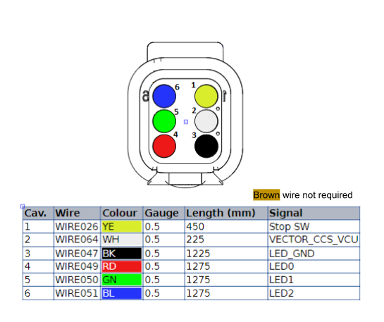

Really cool. Maybe you could add a fancy RGB button to your box, to see the status as light show and to be able to stop the charging with the button.
And the text size in the web interface could be a little bit bigger for the outdoor-video-usecase

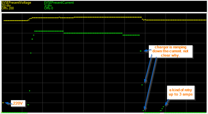

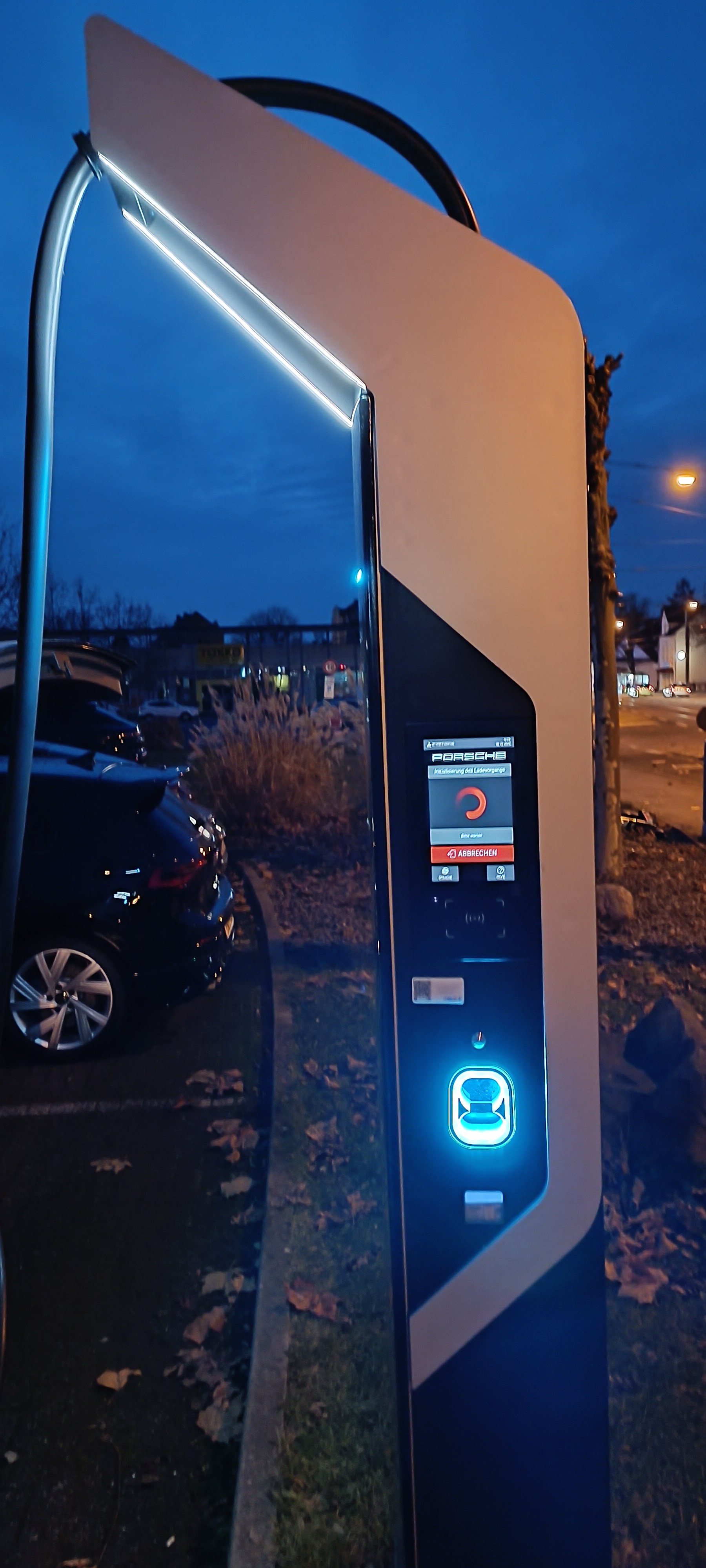

Went for another charger round
1. Ionity (Tritium) - delivers current for a few seconds then stops. Same behaviour as Audi with pyPLC. Log attached
2. Tesla SC - now stops when stopping in the app (more below)
3. ABB 50 kW at VW dealer - works
4. ABB 175 kW at VW dealer - works
5. Posh looking charger at Porsche - does not work at all. No SLAC, modem goes to sleep (picture attached). One of them had a note "Defekt" maybe the other one is also defekt
The shutdown happens a bit too quickly now for my taste. Like the moment I hit stop in the Tesla App the port relays open. Would like to see a little grace time and verification that current flow has stopped.
Addition: what I like about Ionity is they run in an endless loop. If charging fails they start over without interaction so you won't be zipping your cup of coffee while your car fails to charge.
Addition2: I'm also surprised about evsemaxcur and evsemaxvtg. Voltage always seems a bit low, like 437V on that last HPC wouldn't even cut it for the 108S packs. And also it only reports 200A max current. that way we certainly don't arrive at 175 kW. Interestingly Compleo reports 530V here which seems more plausible.
So overall increased success rate
Sorry about the odd log format, I hope someone can puzzle it together. It's the data after TCP I suppose? so without TCP/IP and Ethernet header

Ouch, hope your contactors are still fine. There is a significant mismatch of the precharge voltage and the actual accu voltage. We are closing the contactors when EVSEPresentVoltage is at 201V (or 220V). And then the voltage jumps to 385V, which is the real battery voltage. This leads to a short but heavy current to charge the capacitor in the charger from 220V to 385V.
But the more interesting part is the ramp-down of the current, followed by a period with zero current, and a short retry up to 3 amps, and zero afterwards. Would be helpful to see also our requests, otherwise it is not clear whether the charger turned the current down (e.g. due to temperature or something), or whether clara requested less current.
Toolchain for decoding and visualization here:
https://github.com/uhi22/pyPLC/blob/mas ... nverter.py
https://github.com/uhi22/pyPLC/blob/master/scope.py

Oh wow, you've written a decoder already. Hmm precharge is pretty quick, maybe there just isn't enough samples? Anyway, I use Gigavac contactors, they are pretty tough. Will measure the charge port nonetheless if there is any voltage on it in off state.
One thing I noticed, I am exporting EVSEPresentVoltage also in CableCheck and there is displays implausible values on all or most chargers. Like 100x to large. Not sure what's up with that.
I can collect the TX data also but would be surprised if we are commanding lower current. Then it should act the same way on all chargers. I charged at Tesla just 2 minutes later and that was ok. What puzzles me is that pyPLC has the same problem on Ionity - what do they have in common? The chargers are super busy like said, so I doubt that they are faulty.

EDIT2: Indeed, the cableCheck and the PreCharge are both extremely short. We see:
- In the first CableCheckResponse, the charger says ResponseCode=OK and EVSEProcessing=Finished. This is from my PoV the message "The cable check is finished and fine, just continue with the next step." So Clara immediately goes to the PreCharge.
- In the first PreChargeResponse, the charger reports EVSEPresentVoltage=202V. This seems to fulfil the "difference to the target voltage is small (seems Clara uses the wrong accu voltage 220V). And so for Clara it is fine to go to the next step, powerdelivery, and close the contactors.
So we have two interesting points: 1. The charger seems to decide that it does not need time for cable check. 2: The clara does not have the correct accu voltage during the precharging.

EDIT3:
Indeed, really crazy. Just had a look to https://moovility.me/ and when one is free, than it is occupied two minutes later:

Re: Develop a QCA7000 board?
The LIM design goes well with the Fellten button, which I also use.
https://shop.fellten.com/shop/ledrgbcb- ... ge=7#attr=

Now I wonder where does the voltage of 220V come from? CAN overwrites Param::batvtg with the actual value (I verified it) and hardwareInterface_getAccuVoltage() returns just that value.
EDIT: I'm now explicitly setting evsevtg=0 in CableCheck so we don't use an invalid value in PreCharge
How would you go about opening the relays less suddenly?

I'd like to see the accu voltage in the logging. One potential root cause is, that from CAN comes bullshit. Not very likely, but who knows.
EDIT: Maybe it comes from here:
I have no idea yet, what is the plan for this scenario. Maybe I find something in the specification, and I have the log from my Ioniq, which could help to understand in which order and with which timing the termination of the session should be done. Or maybe @CCSknowitall can shed some light on it. [Edit] Formulated the question in detailed here: viewtopic.php?p=64715#p64715

The information I have leads to an other solution. Had a look to the Ioniq trace and to the specification. Added the analysis here: https://github.com/uhi22/pyPLC#detaille ... ng-session
The summary:
- PowerDeliveryReq(Stop) is fired under full current.
- The charger needs 1.5s until it confirms with PowerDeliveryRes. Maybe already here, it turns-off the current.
- The car sets stateB, and this is the "fast trigger" to the charger to turn-off the current (I have read somewhere this should be in 20ms, but cannot find this information anymore).
- Here we can simply wait for half a second (conditionless), to give the current some time to fall.
- Open the contactors.
- Wait again 0.5s to give the contactors time to move.
- Send a WeldingDetection. Depending on the charger it will wait (in example 1s, according spec below 1.5s), measure the voltage and report it back in the WeldingDetectionResponse.
- We need to repeat the WeldingDetection loop, until the voltage is not dangerous anymore.
- Then unlocking the connector and send the SessionStop.

Hello Johu. I have your ESP32 CAN tool and a focci board from UHI. Wifi connection works and the focci board sends via RS232. I connected the CAN lines. How do I get the parameters to the console?
- Posts: 6709
- Has thanked: 368 times
- Been thanked: 1536 times
Your foccci doesn't run the OI style firmware.
You need to flash the bootloader: https://github.com/jsphuebner/stm32-CAN ... s/tag/v1.0
And firmware discussed here lately (Attached)
UPDATE: file deleted. Check releases: https://github.com/uhi22/ccs32clara/releases/

Very good, was looking for something like this today.uhi22 wrote: ↑Mon Dec 11, 2023 7:54 pm As preparation for testing, added the feature "User presses STOP on the charger" to pyPLC and openV2Gx. In pyPLC in EvseMode, by pressing the space button it sends in the currentDemandResponse the EVSEStatusCode = Shutdown, as the Compleo (and most likely other chargers) do.
I hope CCSKnowitAll can analyse that Ionity log. Will go there again maybe tonight to also record TX frames
EDIT: looked at the EXI-ed logfile myself and found DC_EVSEStatus.EVSEStatusCode sits at 1 and ReponseCode="OK" while we still get around 40A and then changes to 6 (EVSE_MalFunction) and "Failed". Current than drops over a couple of 10 messages and reaches 0.
Also the ChargeParameterDiscovery totally doesn't match what I expect. It should be 500A, 1000V and 350 kW but we get 100A, 398V and 98 kW. Is that some sort of fallback? Are we communicating an outdated protocol version or so?
