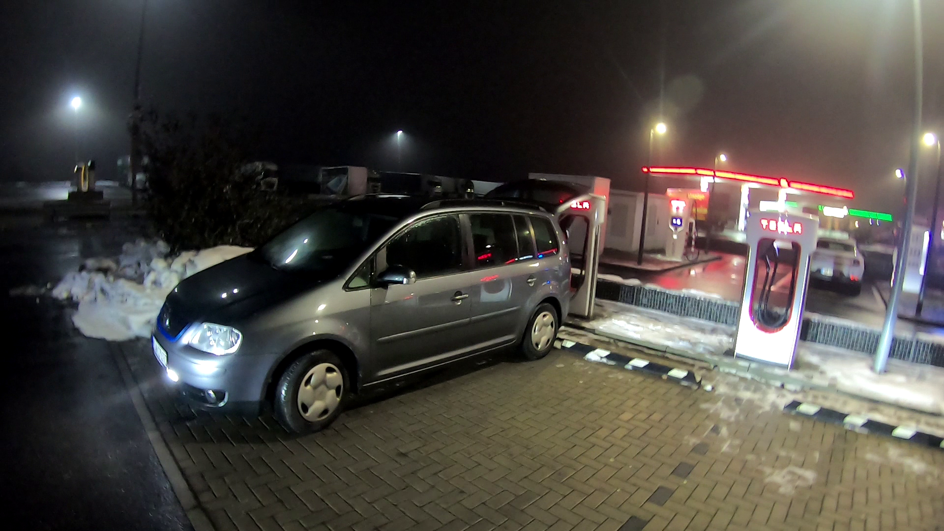

With those bugs you mentioned fixed I could finally charge at the Tesla SC
EDIT: One bug: when I stopped the charger via the app Clara stayed in CurrentDemand. I loosened the connector until CP was interrupted, then it turned off.
Was going to test Ionity also but all stalls were taken (Lutterberg)
EDIT: thought this looked kinda cool

Really great. And the third operator in Lutterberg (https://www.goingelectric.de/stromtanks ... -11/80537/) still is not alive? Would be a great site for testing, three different manufacturers within 200 meters
Would like to see a trace in case the supercharger stops, it should announce somehow that it wishes to...

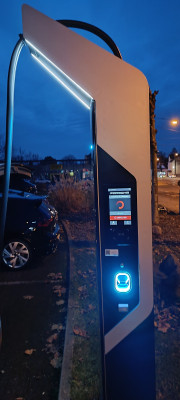

1. Ionity (Tritium) - delivers current for a few seconds then stops. Same behaviour as Audi with pyPLC. Log attached
2. Tesla SC - now stops when stopping in the app (more below)
3. ABB 50 kW at VW dealer - works
4. ABB 175 kW at VW dealer - works
5. Posh looking charger at Porsche - does not work at all. No SLAC, modem goes to sleep (picture attached). One of them had a note "Defekt" maybe the other one is also defekt
The shutdown happens a bit too quickly now for my taste. Like the moment I hit stop in the Tesla App the port relays open. Would like to see a little grace time and verification that current flow has stopped.
Addition: what I like about Ionity is they run in an endless loop. If charging fails they start over without interaction so you won't be zipping your cup of coffee while your car fails to charge.
Addition2: I'm also surprised about evsemaxcur and evsemaxvtg. Voltage always seems a bit low, like 437V on that last HPC wouldn't even cut it for the 108S packs. And also it only reports 200A max current. that way we certainly don't arrive at 175 kW. Interestingly Compleo reports 530V here which seems more plausible.
So overall increased success rate
Sorry about the odd log format, I hope someone can puzzle it together. It's the data after TCP I suppose? so without TCP/IP and Ethernet header

Ouch, hope your contactors are still fine. There is a significant mismatch of the precharge voltage and the actual accu voltage. We are closing the contactors when EVSEPresentVoltage is at 201V (or 220V). And then the voltage jumps to 385V, which is the real battery voltage. This leads to a short but heavy current to charge the capacitor in the charger from 220V to 385V.
But the more interesting part is the ramp-down of the current, followed by a period with zero current, and a short retry up to 3 amps, and zero afterwards. Would be helpful to see also our requests, otherwise it is not clear whether the charger turned the current down (e.g. due to temperature or something), or whether clara requested less current.
Toolchain for decoding and visualization here:
https://github.com/uhi22/pyPLC/blob/mas ... nverter.py
https://github.com/uhi22/pyPLC/blob/master/scope.py
