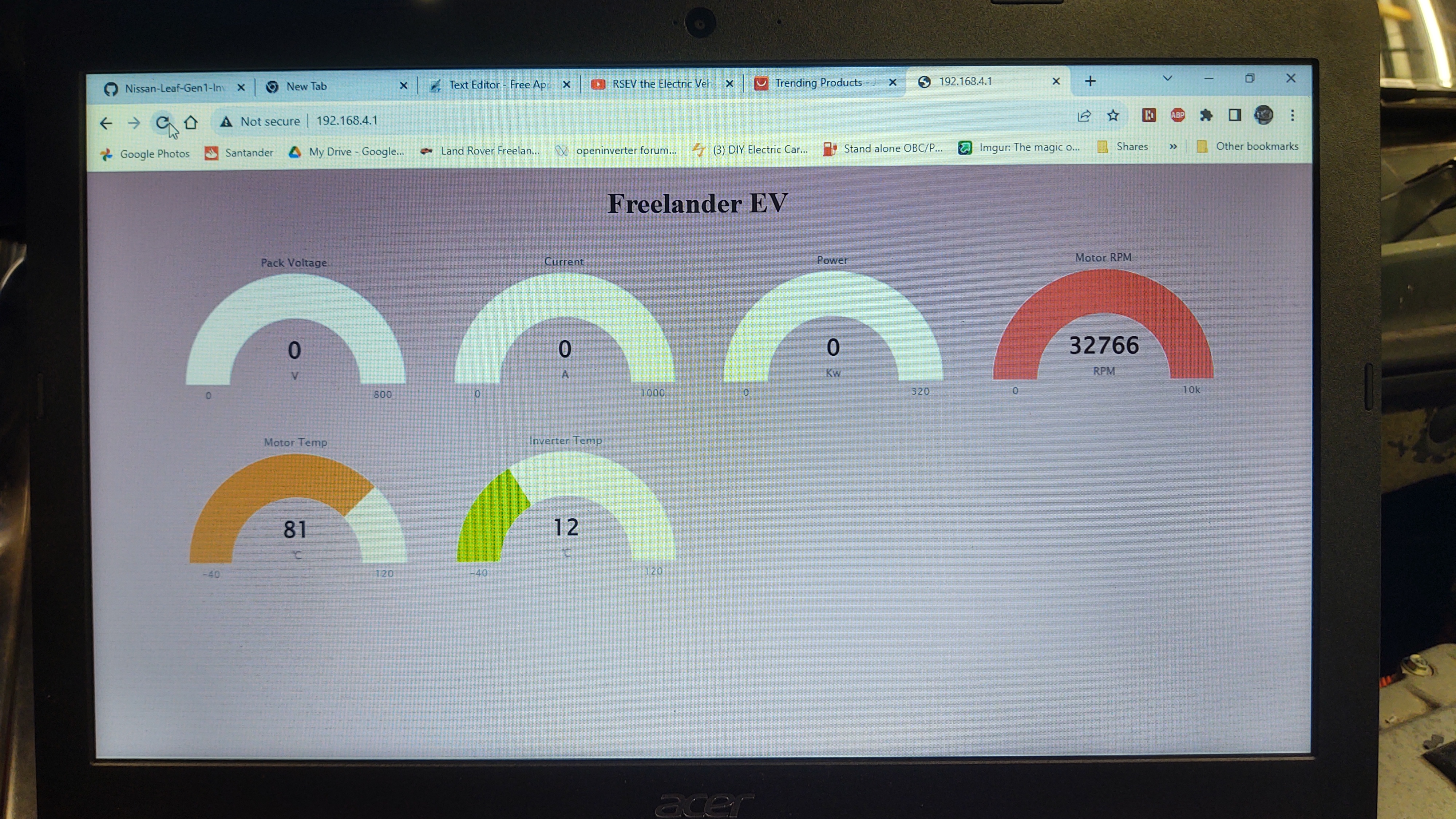

Just another update as the issues above seem to be getting worse and even with the shunt low voltage disconnected I'm getting the motor rpm and temp off the scale.
I've checked the motor to inverter wiring plus I've moved the VCU into the passenger foot well so I can rule out interference but still getting the issues mentioned above. Sometimes it shows the correct readings but mostly I get rpm and/or motor temp off the scale.
As far as I can tell going by the Nissan Leaf service manual the readings from the motor at the inverter connector are OK as both temp and rpm connections are measuring within the resistance range listed.
If anyone has seen similar or has any suggestions please share.

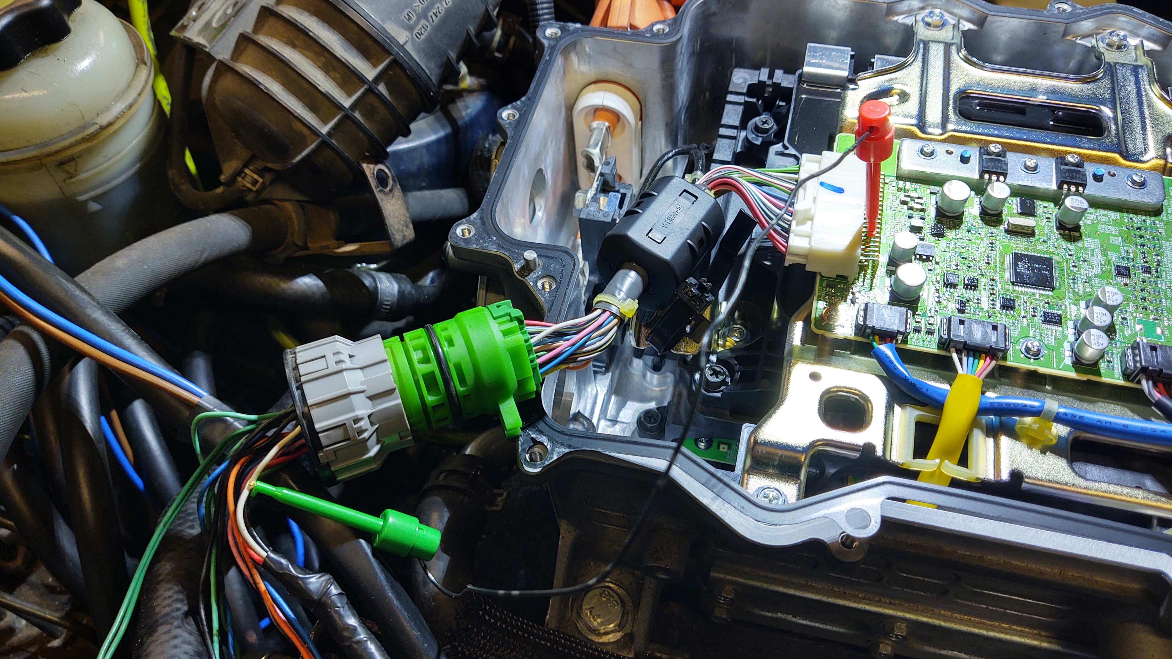

So it's starting to look like I've killed the inverter. :cry:
I found a short between one of the resolver connections and ground and with it cleared I now have normal temps from the motor but still getting full scale on the rpm. I've double and triple checked the other connections but no joy.

I found another fault!
There was a bad connection between the Nissan Leaf cable and the inverter so I guess they don't like being plugged in and out too often.
As soon as I jumpered the dodgy joint the rpm dropped and we had motor spin. :D
It means that I can't trust the connector anymore and will have to bypass it which is a pain but if it works then so be it.

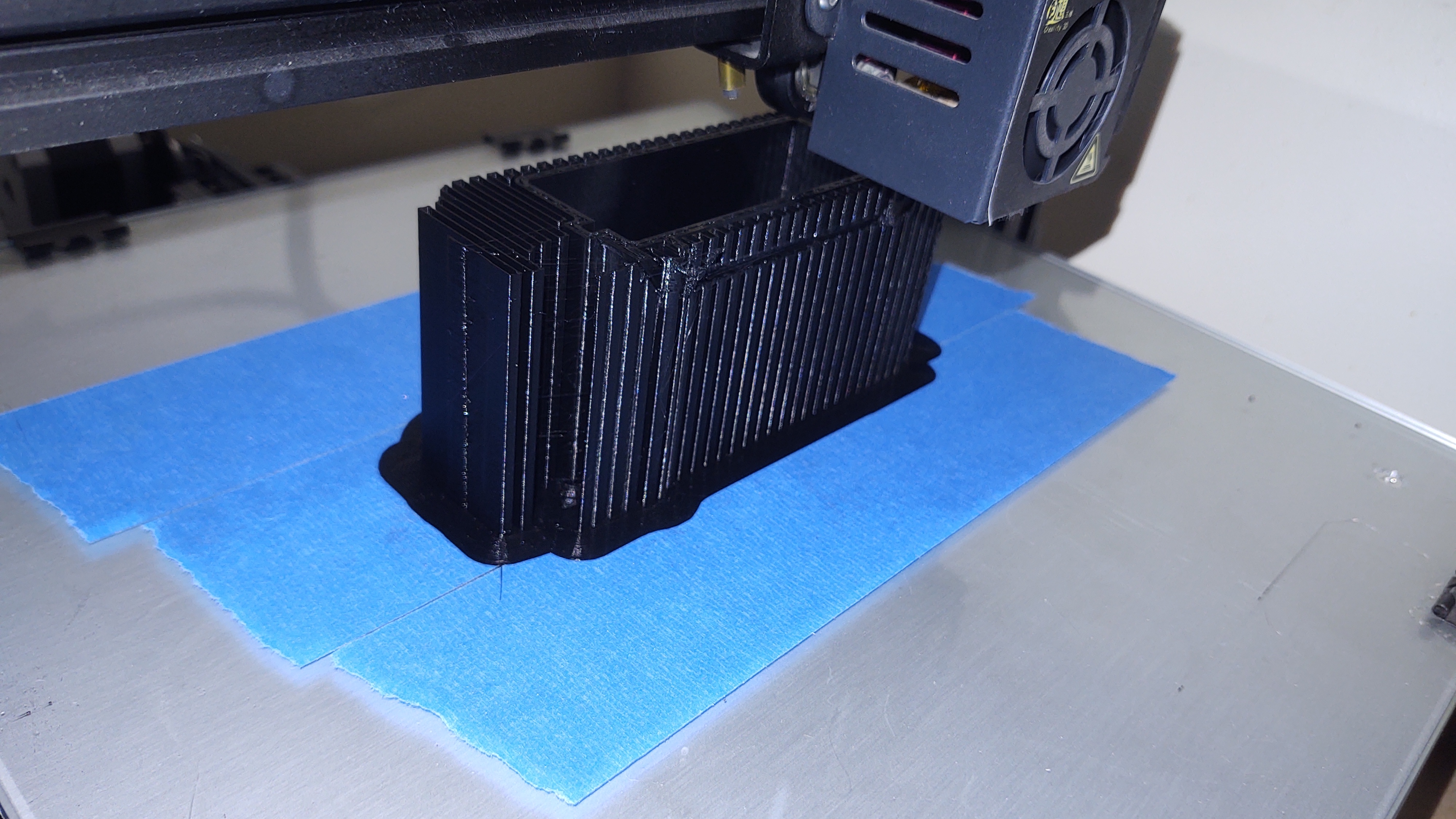

So I sorted the fault mentioned above and the car is driving again but I have another question for you guys
Has anyone any spare Cinch 5810130065 enclosures for the Gen1 VCU you would be happy to sell?
I can buy them from Mouser, Farnell and Digikey but don't feel like forking out £28 for a plastic box. This is the price for one including handling, VAT and shipping.
If not did anyone ever design an enclosure that can be 3D Printed for it? I can easily bodge something together but it would be nice to have something properly designed for the job.

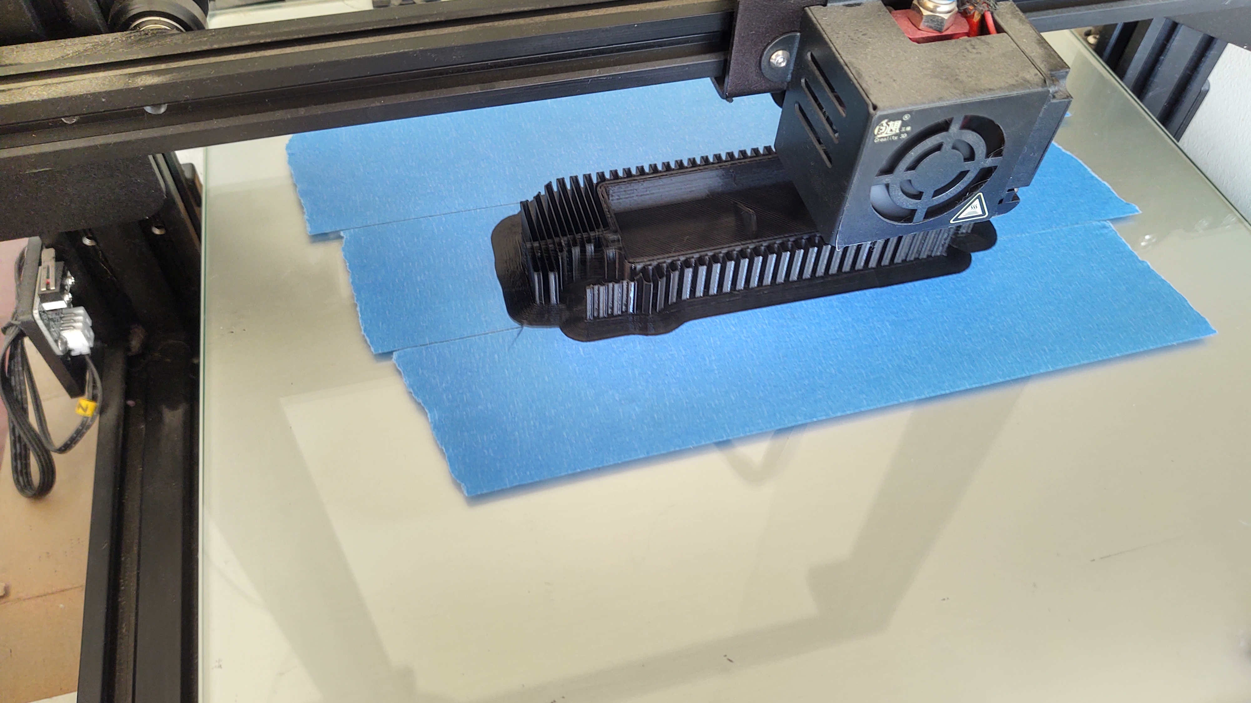

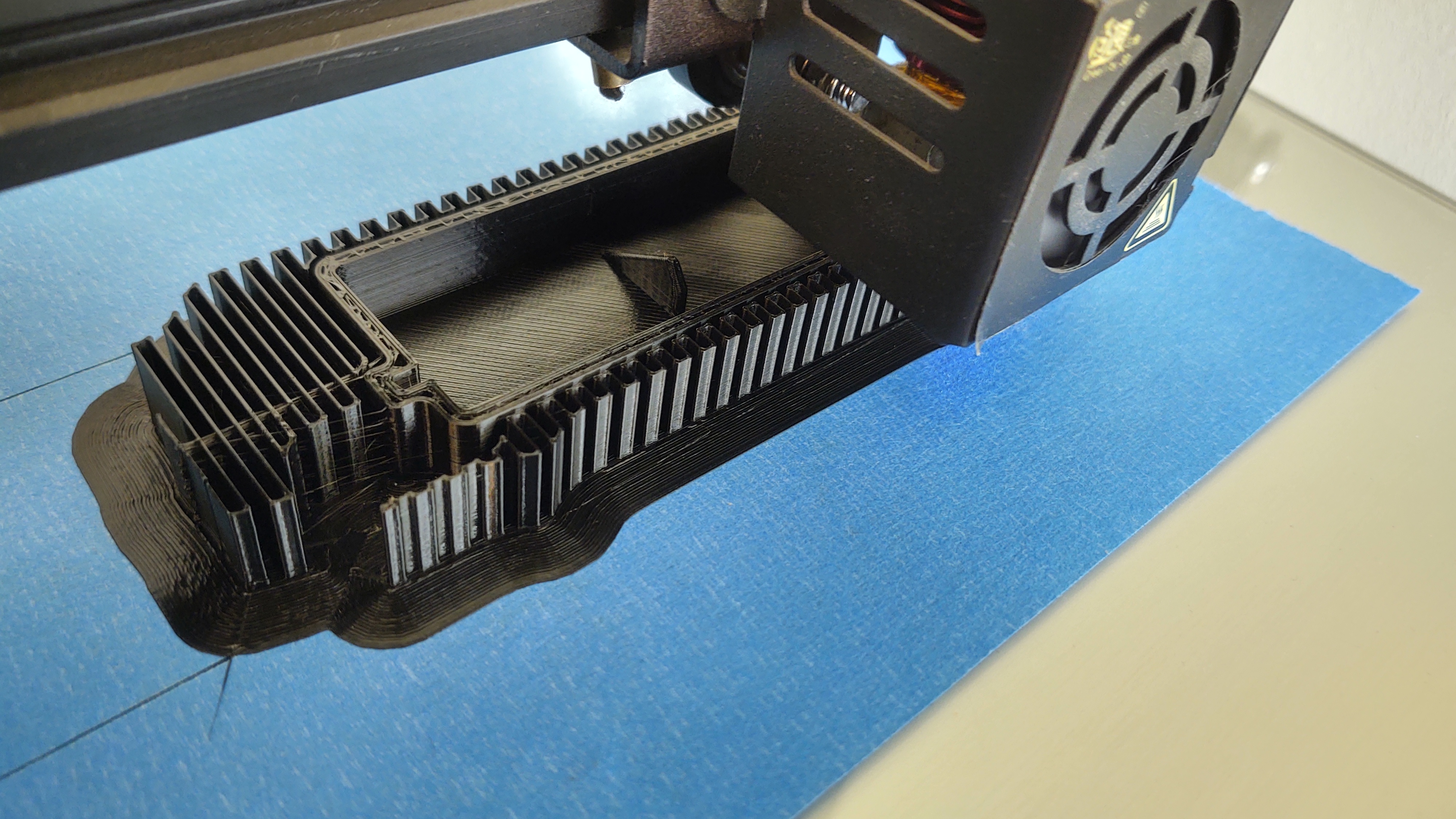

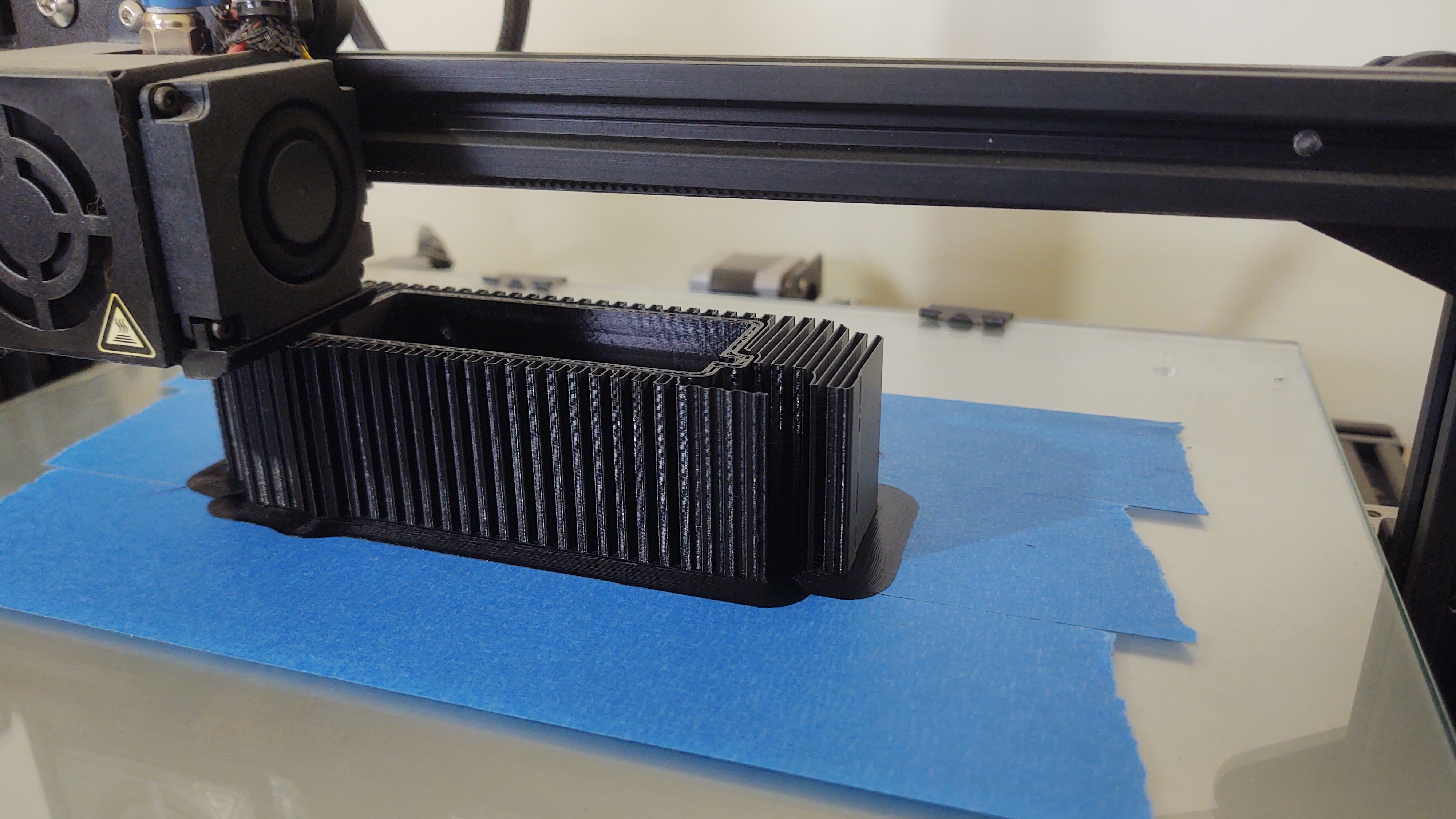

This STL file works a treat, no glitches or unwanted infill so it'll take around 26 hours to print but still way better than forking out nearly £30.
Thanks again. :)

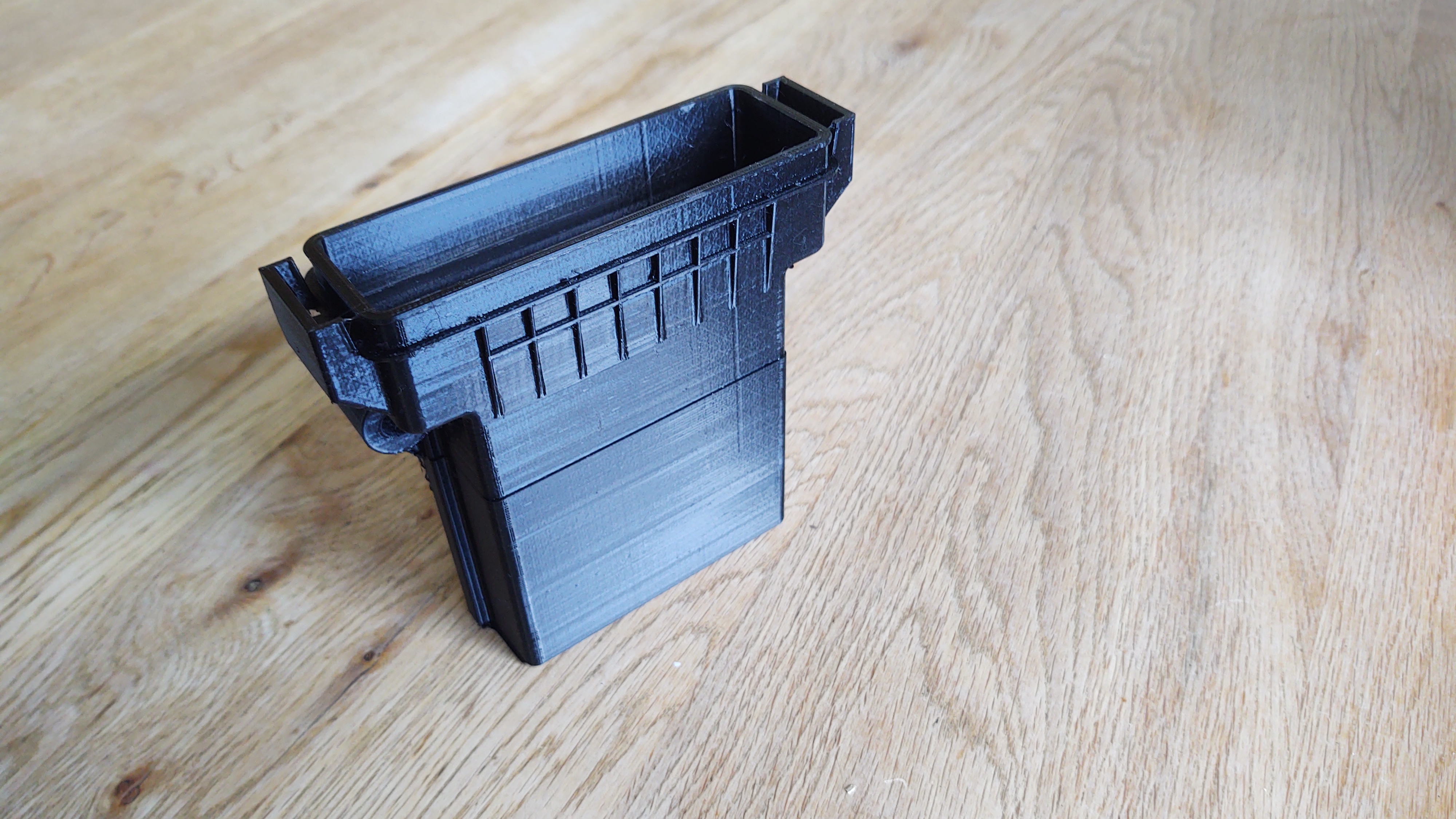

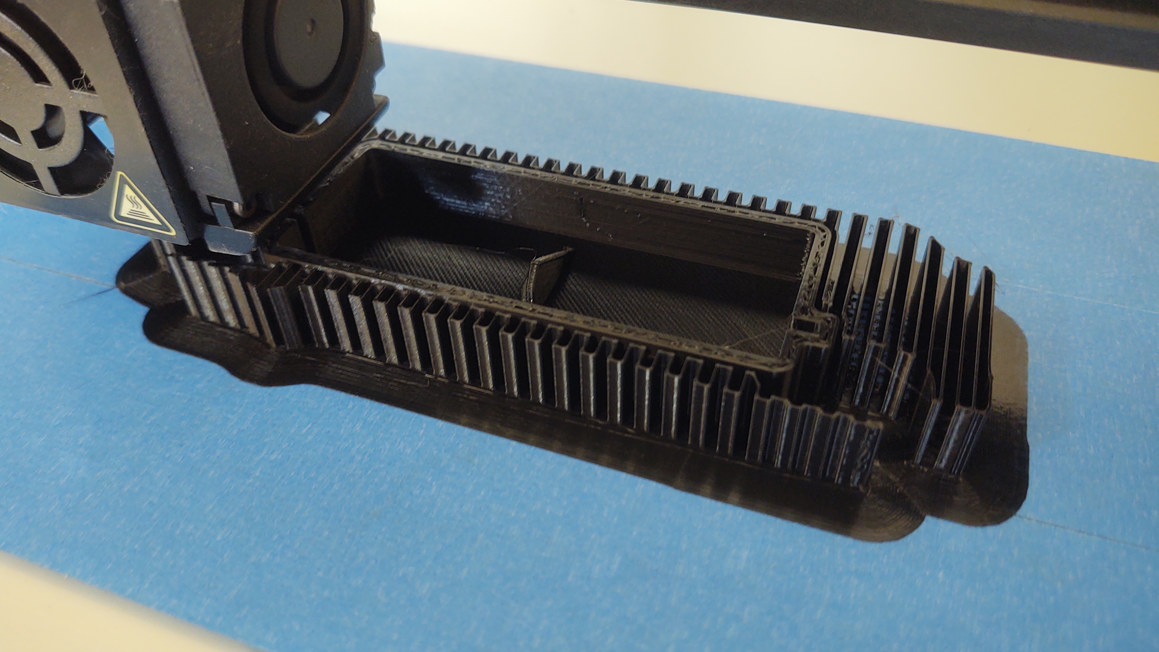

So a massive thanks to Bratitude for posting the STL file for this case. I printed it out over a couple of days and this is the result.
The last photo shows it after I removed all the supports but if you look carefully you can see a line half way up where I had to turn off the printer over night. I have a Creality CR10S which can restart a print after power off but it is not perfect and so restarted slightly off line but it's not a big problem as the VCU still fits fine.
I could have tried printing without support which would have been much quicker but didn't fancy waiting 10 hours or more to see if it would be OK.

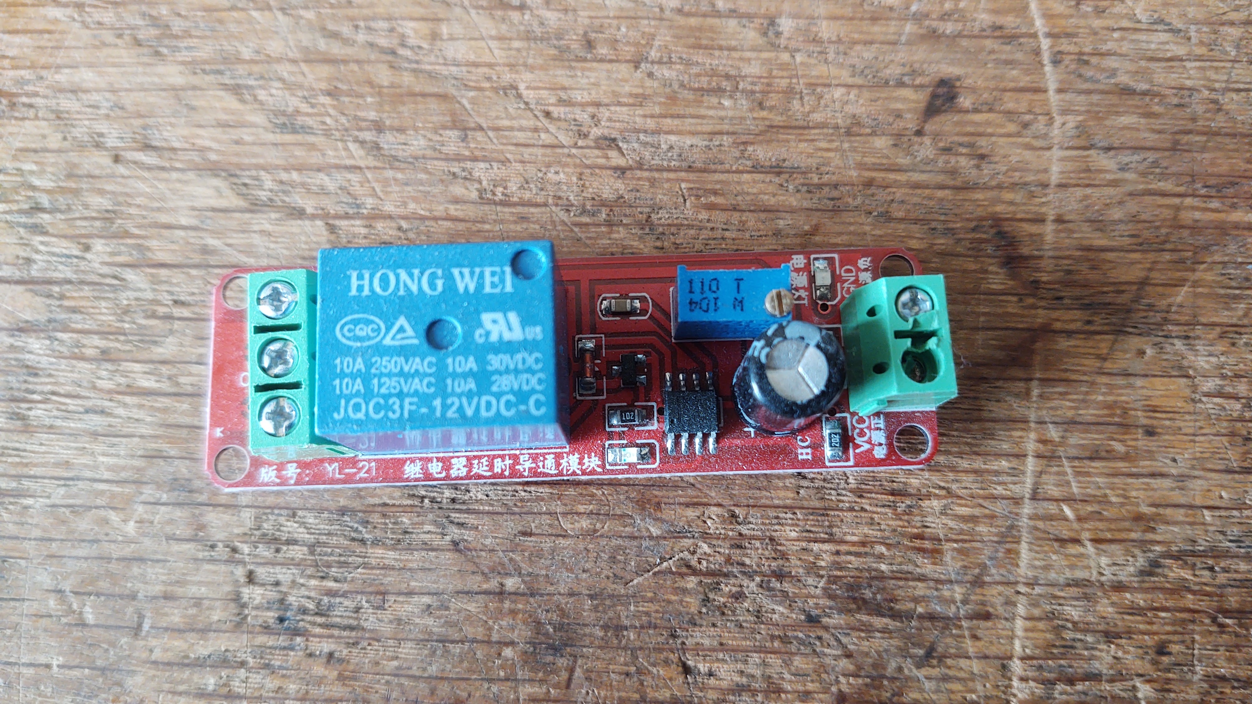

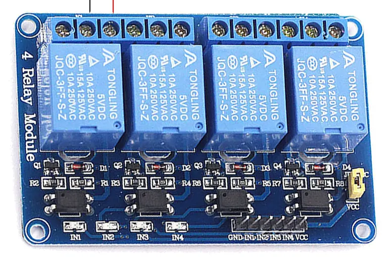

Once I got the cable issues sorted I concentrated on getting the timing right for turning on the inverter. For a while I struggled to get it to work reliably if turned off and on again but I think I've resolved this by using Output3 from the VCU to power the Inverter.
When I get it documented I'll post the sequence but I wanted to ask how others are using the VCU outputs to control startup.
I found the VCU threw a wobbly if I tried driving any kind of relay direct so instead used these little timer modules and this seems to work fine.
The VCU switches the negative on Outputs 1, 2 and 3 so I guess it didn't appreciate me shoving 12V Pos into it through the relay coil
I'm not using the timing function as they are all turned right back rather just as a way to use the negative output from the VCU. I guess one of the Arduino relay boards like the one below would do the same job and might be a bit neater.
Is this the kind of thing others are using?

I tried a relay module similar to the one above but for 12V rather than the arduino controlled one in the photo.
It works OK but for some reason the timer modules work more reliably.
What I mean by that is with the timer modules the inverter turns on correctly every time I turn the ignition on without fail. With the relay module sometimes it goes through the sequence OK but the inverter doesn't enable drive. Maybe there is a small delay even with the timers turned all the way back but whatever the reason I'm going back to them.

Alibro wrote: Tue Oct 03, 2023 10:38 am Once I got the cable issues sorted I concentrated on getting the timing right for turning on the inverter. For a while I struggled to get it to work reliably if turned off and on again but I think I've resolved this by using Output3 from the VCU to power the Inverter.
https://s.click.aliexpress.com/e/_De3IGUP
I think I have the car running reliably now and starting up correctly.
Output one of the VCU triggers the precharge.
Output 2 triggers the timer module (soon to be changed) which powers the positive contactor. At the same time it also sends power to the Mitsubishi Outlander charger 12V power, ignition lead and voltage sense lead. This means the dc to dc converter cannot go live through the precharge resistor before the positive contactor has closed.
The inverter 12V supply and ignition are powered by the ignition switch.
I had an issue with the timer module glitching when things like the lights were turned on and causing the pos contactor to open. I've since been told the outputs should be able to drive the contactors directly. Is anyone else out there using this VCU and if so how are you connecting the contactors as I'm still using a timer module to drive mine? I'll be changing this soon as the timer modules are a bit flaky and relying on them to keep the car driving is not a good idea.
I also had issues with the VCU hanging if I had a USB cable plugged into it while it was getting 12V from the car. This is not an issue any more as I now have the voltage showing through the WiFi, previously I was using the laptop to keep an eye on the pack voltage while charging. Has anyone else seen similar behaviour?
Has anyone upgraded their software to allow regen? I know it is not essential but it would be nice to get back some power when slowing down.
