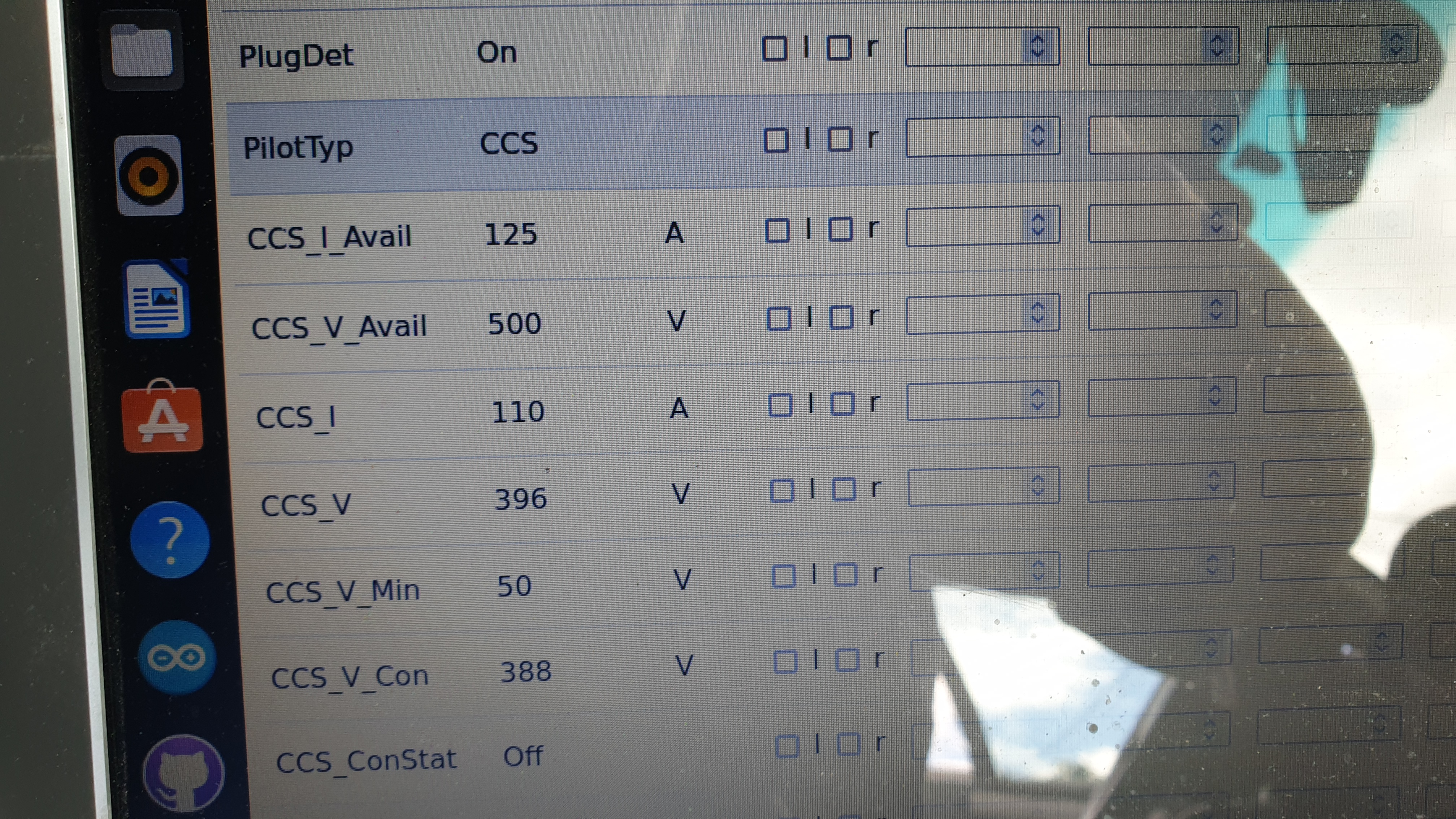

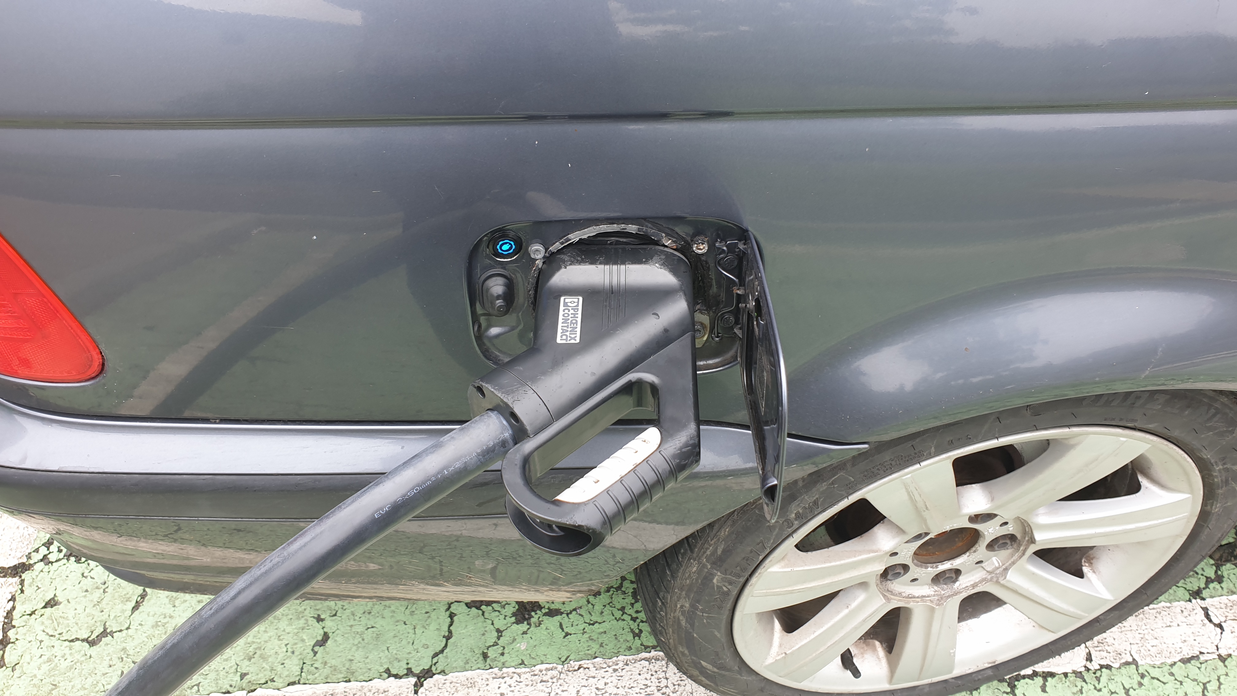

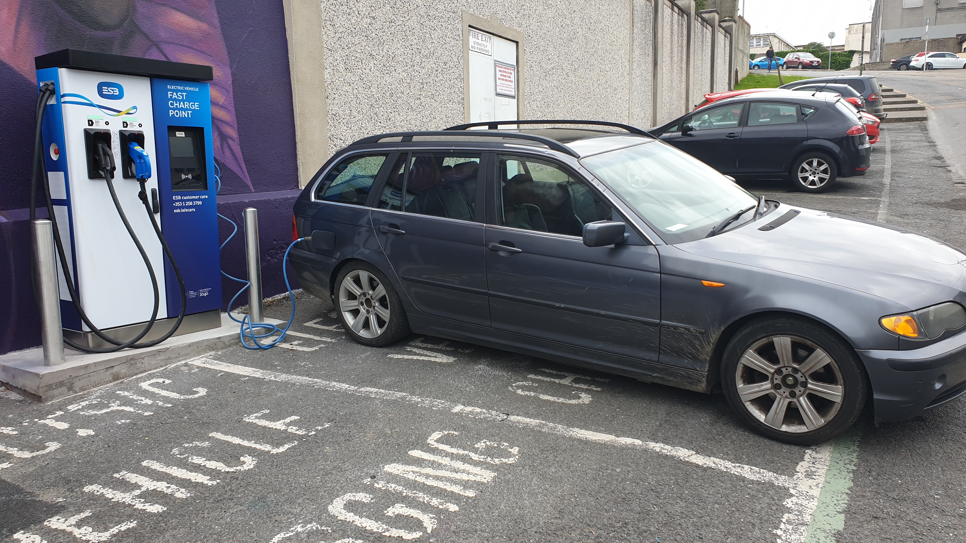

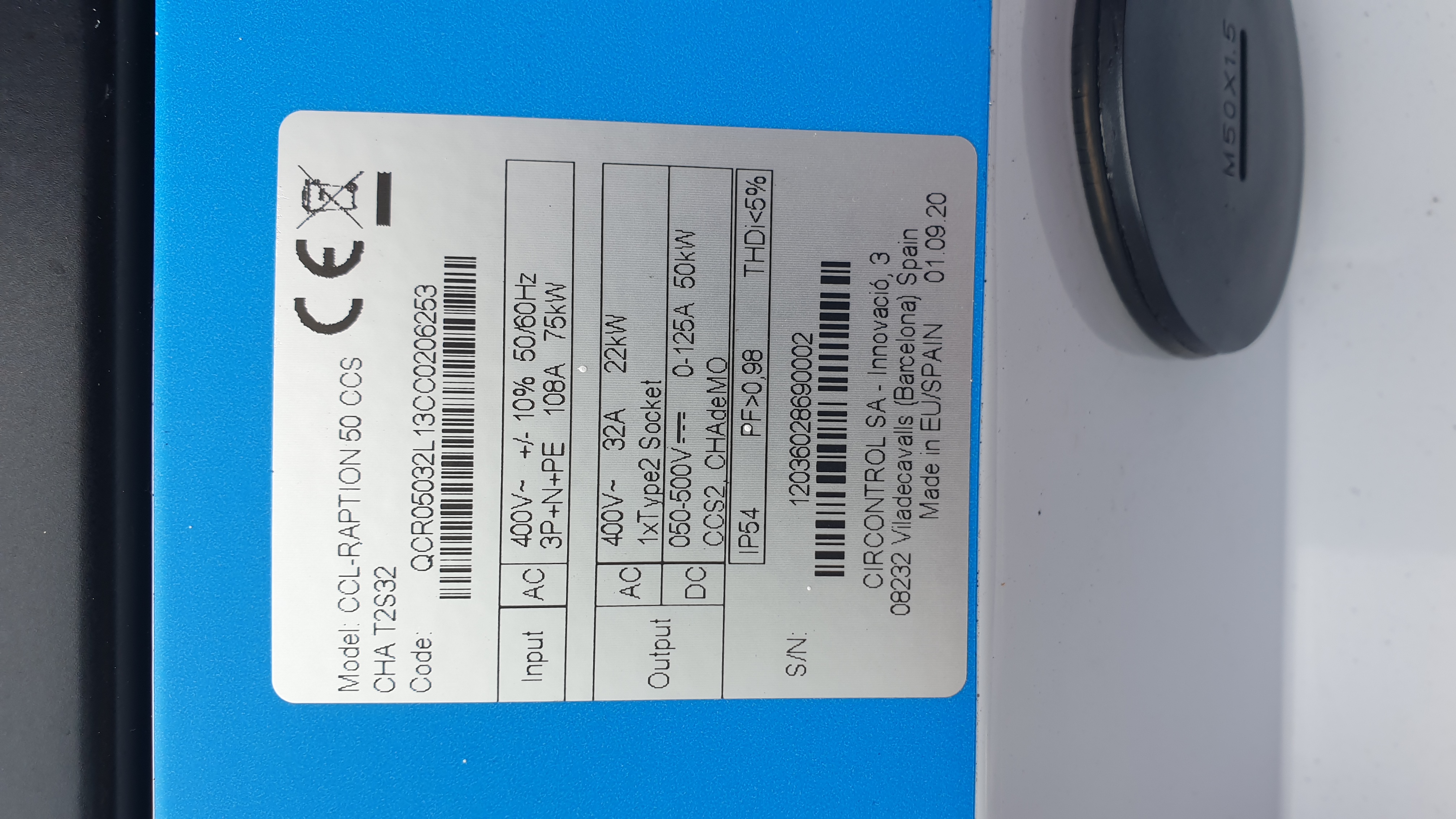

Well folks, what to do with your newly discovered CCS freedom...ROAD TRIP! That exactly what I did yesterday taking the goose on a 220km jaunt requiring 2 stops for some CCS action. Or so I thought! Day before I went to my local Ionity (works perfectly) and then to a local Efacec QC45 "50kw" charge point. Decided to go for the money shot and asked it for the full works : 125A please...nope shutdown. Tried again, nope shutdown. Ok let's sneak up on it...40kw,41kw,42kw,43kw,44kw all go so far, 45kw Shutdown! Seems its the worst kept secret that the 50kw rapid chargers in Ireland are actually 44kw despite what they say over comms and on the rating plate. But it's all good. We're used to this interesting interpretation of standards from the Chademo era.
On to the road trip. Phase 1 : I arrive at my first stop. A shiny new Circontrol Rapition 50. Damn that's a sexy name. I plug in. The state machine rolls onward hapily and I am rewarded by the now familiar thunk of closing contactors from the rear as we hit state 6. I'm about to crack a smile of hapiness when another thunk followed by the deaded Pilot : static. No amount of coaxing or messing about with the timings in the state machine make any difference. I'm stuck on 6.6kw ac.

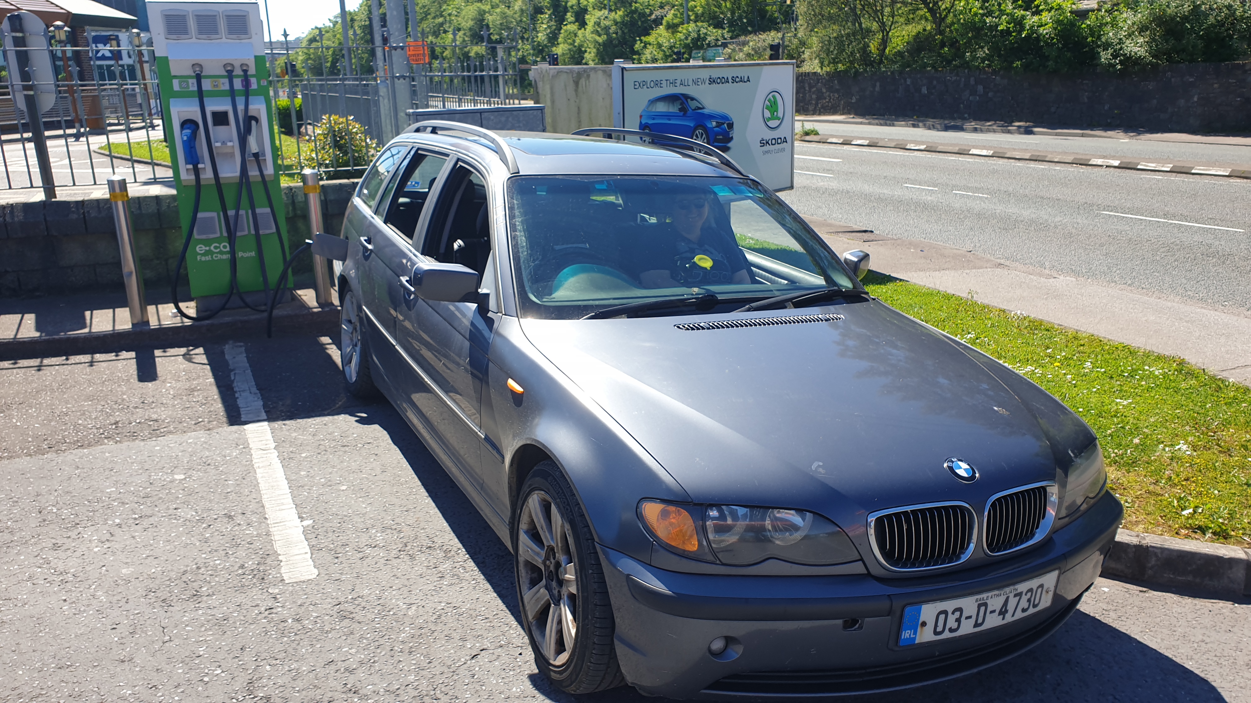

Phase 2 : Another Circontrol, another fail. More 6.6kw ac. A 3 hour trip takes 7 hours. This time I capture the webui of a fail event. It is a VERY different affair to either Ionity or Efcaec. This I can observe :
Circontrol does not ramp cable test. Just boom! 500v then boom 0v. Likewise precharge.
Circontrol does not mirror cable test voltage or precharge voltage over comms. We only know it via contactor voltage measurement.
If you look carefully at the video (we close contactors in state 5 and begin current ramp in 6) I see 1 amp very breifly.
Now given our "50kw" Efcaec units shut down with a "charge error" warning if we ask them for the current they claim to have available it gives me an idea : Suppose its the other end of the spectrum with Circontrol : They can't give 0 (or close to 0) amps....
This is the most fun I've had since the model 3 bms:)

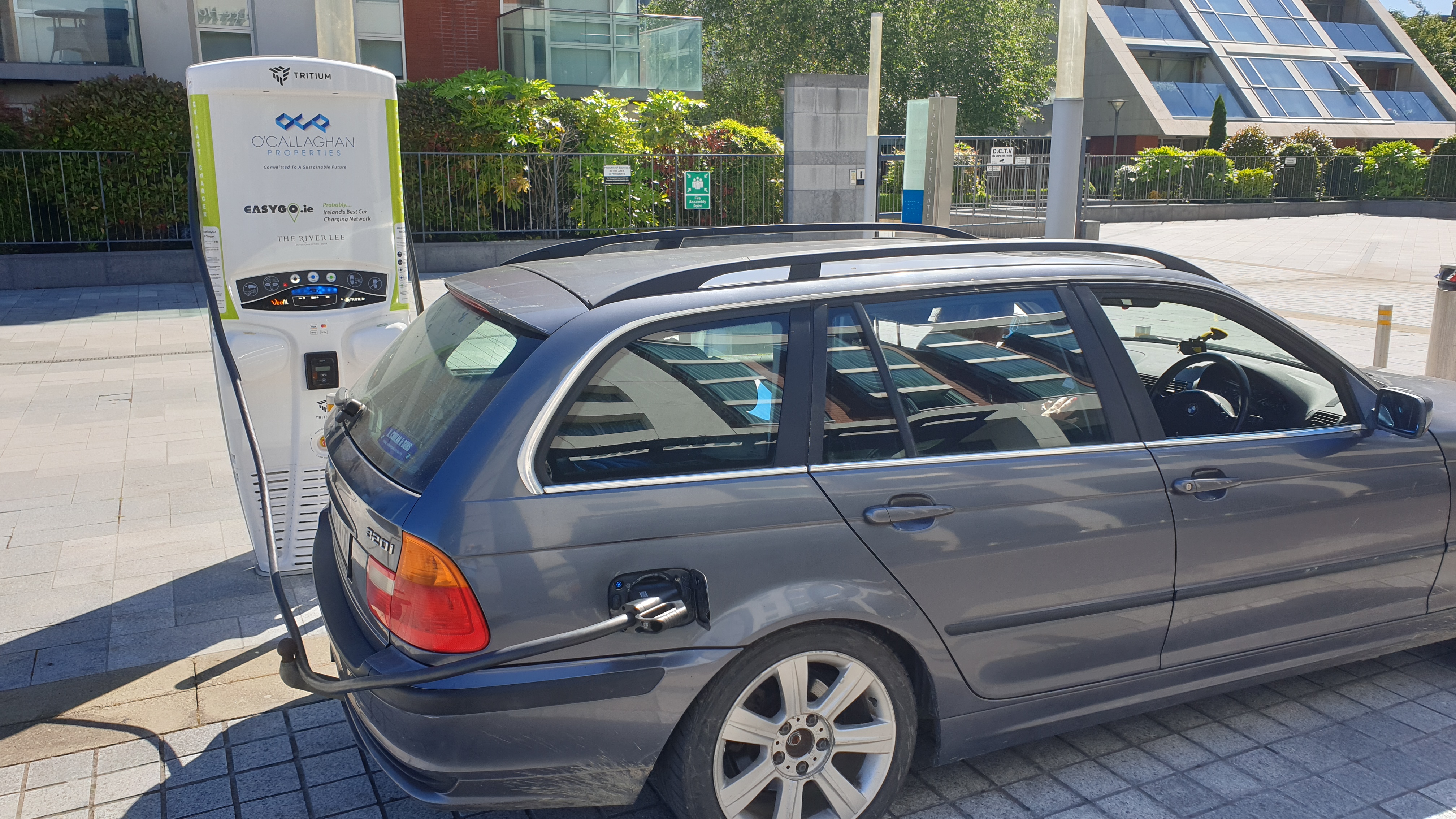

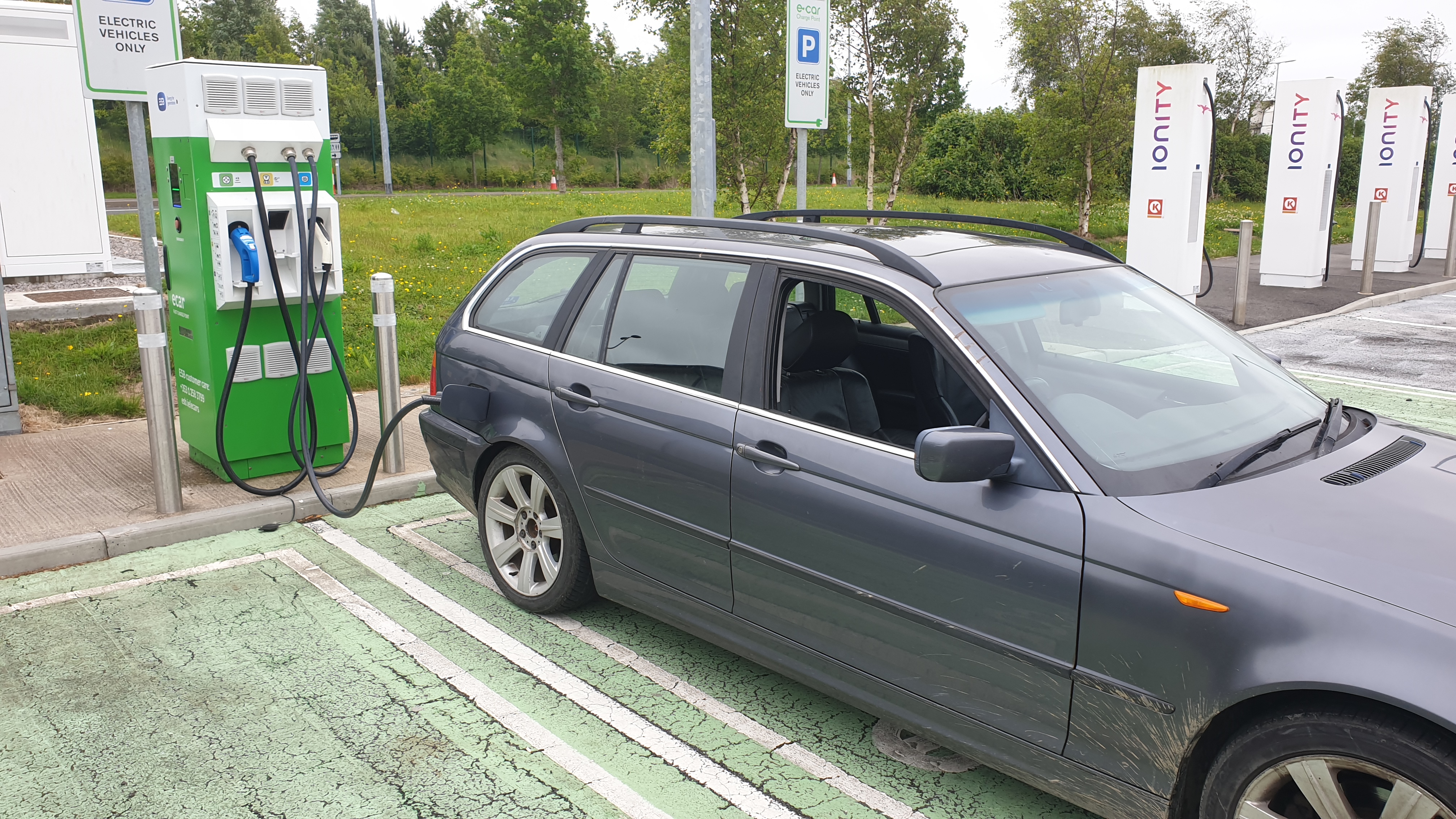

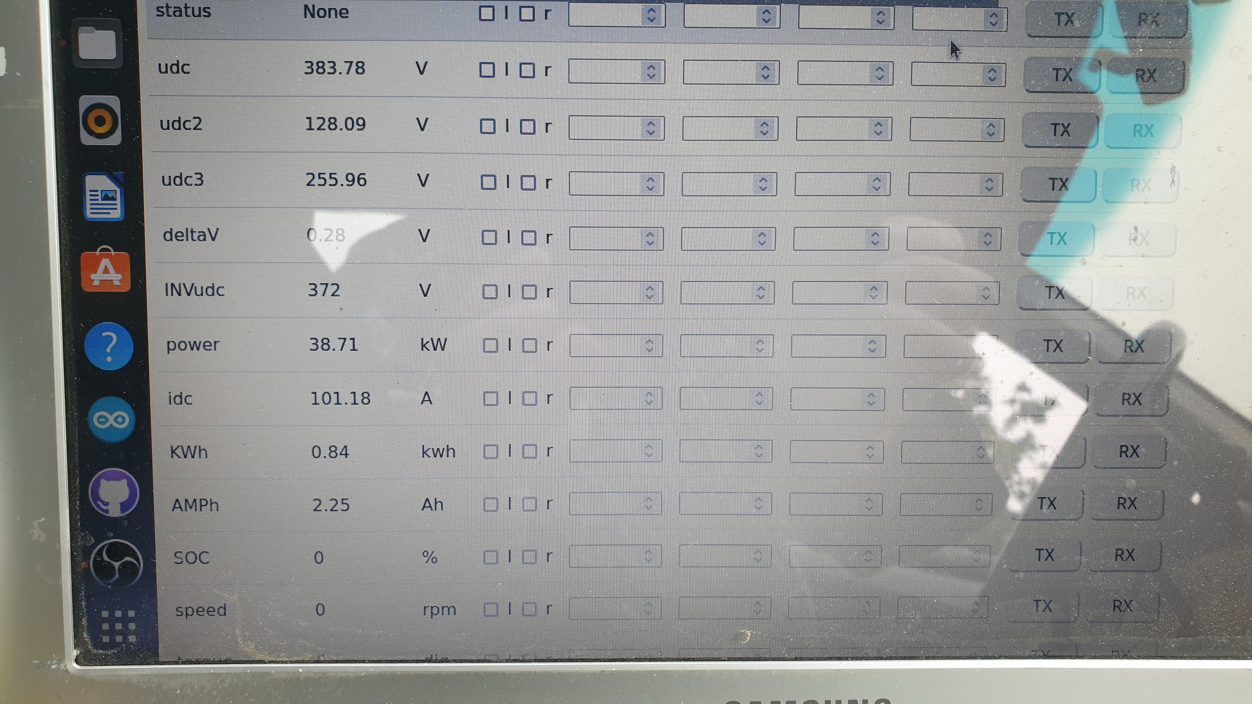

Set out for some more testing. Ah the excitement. First stop another Efcaec QC45. Works fine. Well up to 44kw anyway:) Then onto another network who use Tritium Veefil units. Connects perfectly but will only give me 8 amps no matter how much I request. So that's weird. Sure is great we have a standard for fast charging. I'd hate to see things otherwise

There are limits that are sent at the beginning of charge, and limits are sent every current request confirmation from the station.
And yes, the standard is a bit… imprecise. Best I can tell is this: there’s flags for various limits like charger max current, power, voltage, etc. and there’s also numerical values for these things. Sometimes cars only care about the values, others use the flags, others… who knows. Same with the station caring about car values.
That cable check is probably fine. Different manufacturers produce the required voltage differently and at different voltages, anywhere from 400-500v.
For the chargers shutting down at 44kW, you’ll probably need to look at the flags for “maximum current achieved”, having the other two would be good too. I do know of one manufacturer that uses “maximum power achieved” flag even if you only hit the current limit. But, I don’t think you have them in Ireland so I will refrain from saying who they are.
Not sure what’s going on with Tritum. You likely have a parameter set on your side that nobody else has cared about yet. Or that site was under some sort of demand response event or something silly?
Audi e-tron has a pack voltage around 420-450v, and can max out a lot of lower amperage chargers. Also the Porsche Taycan has a dc/dc converter (so their high voltage pack can use older low voltage fast chargers) which can adjust its input voltage to extract nearly the maximum from a 50 kW machine.
