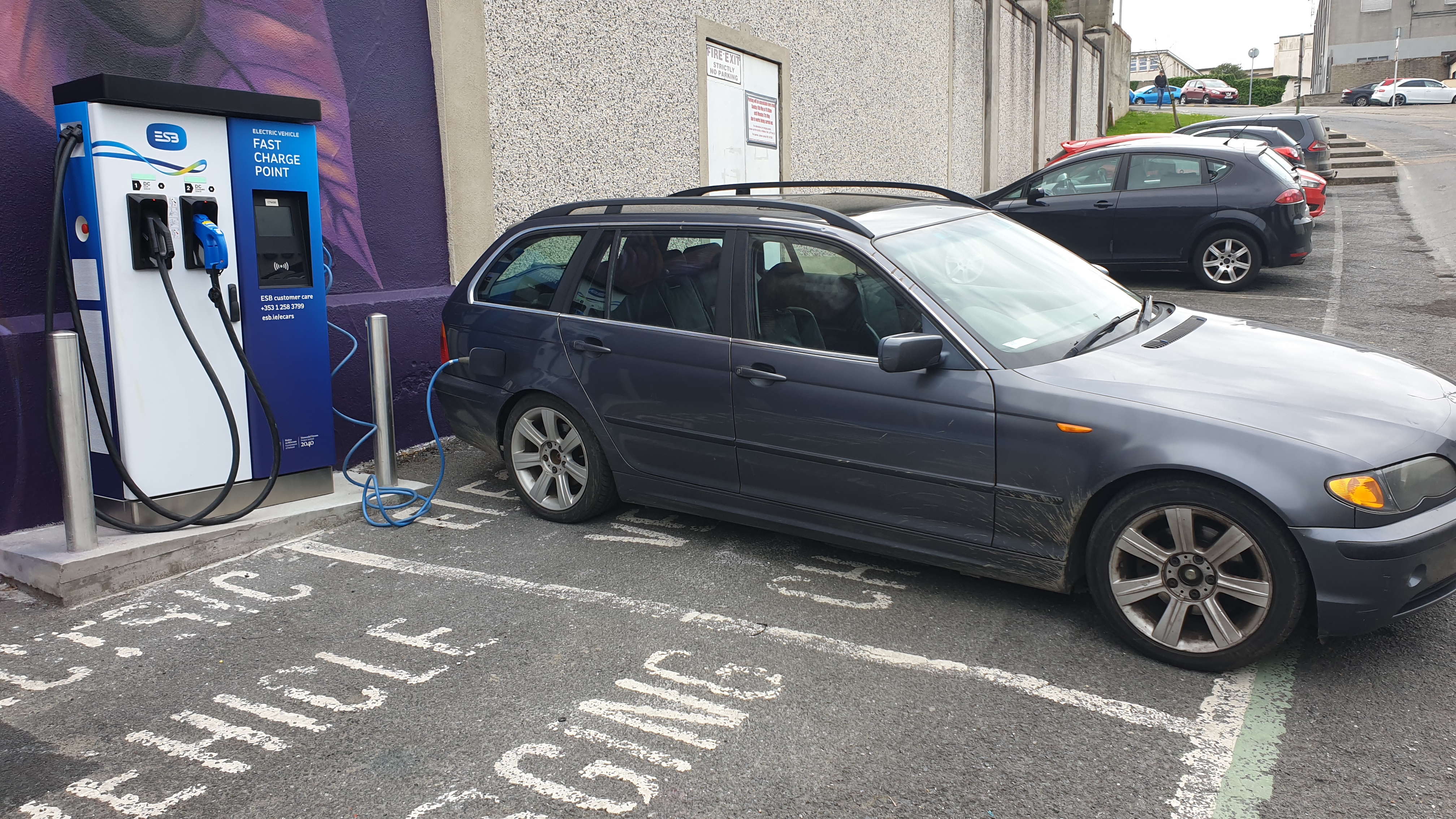

Well folks, what to do with your newly discovered CCS freedom...ROAD TRIP! That exactly what I did yesterday taking the goose on a 220km jaunt requiring 2 stops for some CCS action. Or so I thought! Day before I went to my local Ionity (works perfectly) and then to a local Efacec QC45 "50kw" charge point. Decided to go for the money shot and asked it for the full works : 125A please...nope shutdown. Tried again, nope shutdown. Ok let's sneak up on it...40kw,41kw,42kw,43kw,44kw all go so far, 45kw Shutdown! Seems its the worst kept secret that the 50kw rapid chargers in Ireland are actually 44kw despite what they say over comms and on the rating plate. But it's all good. We're used to this interesting interpretation of standards from the Chademo era.
On to the road trip. Phase 1 : I arrive at my first stop. A shiny new Circontrol Rapition 50. Damn that's a sexy name. I plug in. The state machine rolls onward hapily and I am rewarded by the now familiar thunk of closing contactors from the rear as we hit state 6. I'm about to crack a smile of hapiness when another thunk followed by the deaded Pilot : static. No amount of coaxing or messing about with the timings in the state machine make any difference. I'm stuck on 6.6kw ac.
Phase 2 : Another Circontrol, another fail. More 6.6kw ac. A 3 hour trip takes 7 hours. This time I capture the webui of a fail event. It is a VERY different affair to either Ionity or Efcaec. This I can observe :
Circontrol does not ramp cable test. Just boom! 500v then boom 0v. Likewise precharge.
Circontrol does not mirror cable test voltage or precharge voltage over comms. We only know it via contactor voltage measurement.
If you look carefully at the video (we close contactors in state 5 and begin current ramp in 6) I see 1 amp very breifly.
Now given our "50kw" Efcaec units shut down with a "charge error" warning if we ask them for the current they claim to have available it gives me an idea : Suppose its the other end of the spectrum with Circontrol : They can't give 0 (or close to 0) amps....

Set out for some more testing. Ah the excitement. First stop another Efcaec QC45. Works fine. Well up to 44kw anyway:) Then onto another network who use Tritium Veefil units. Connects perfectly but will only give me 8 amps no matter how much I request. So that's weird. Sure is great we have a standard for fast charging. I'd hate to see things otherwise

@CCSknowitall any thoughts on my new best friends at Circontrol?

CCSI_Spnt in the i3lim.cpp library. Maps directly to current request can msg to the lim. Starts at 0 and increments by one amp every 200ms if :
1)CCSI_spnt<CCSI_limit (from web ui)
2)Vbat<Vbat_limit (from webui)
