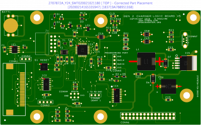

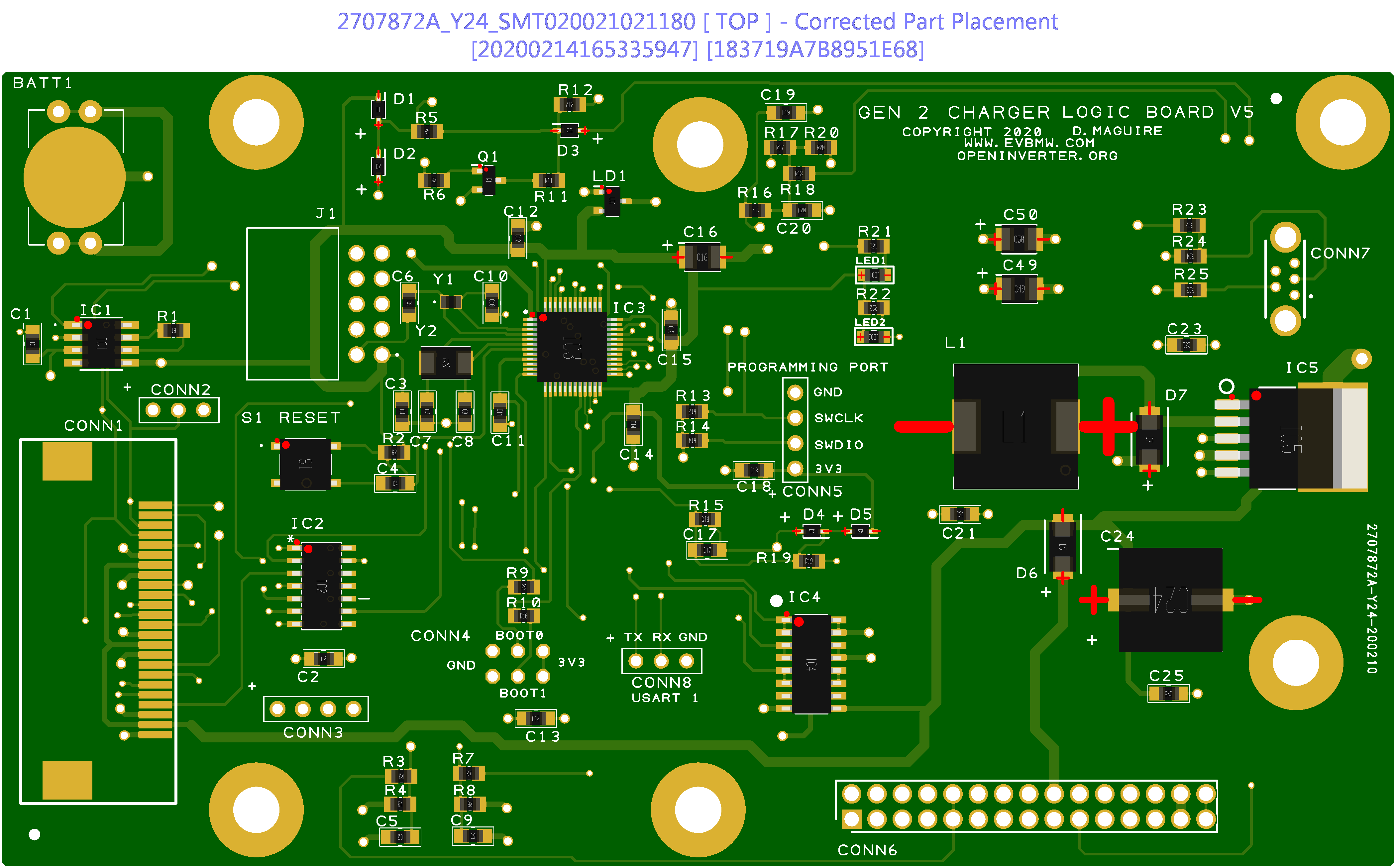

Just to update. V5 boards being built by JLC, software in progress. Boards will be ready for sale once tested.
Posts: 4000
Been thanked: 1114 times
JLC making a start on the new v5 board builds.

Posts: 4000
New V5 boards for the Gen 2 charger on their way from JLC:) Once tested and integrated with the new firmware I'll make a video showing how to install and use and then will be available in the webshop.

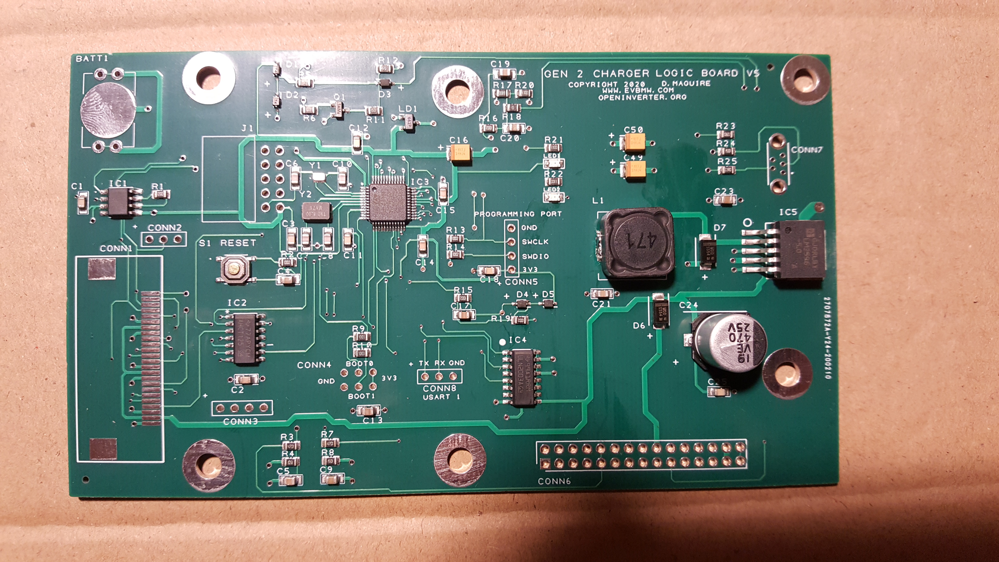

Posts: 4000
New batch of V5 charger control boards has arrived from JLC:)

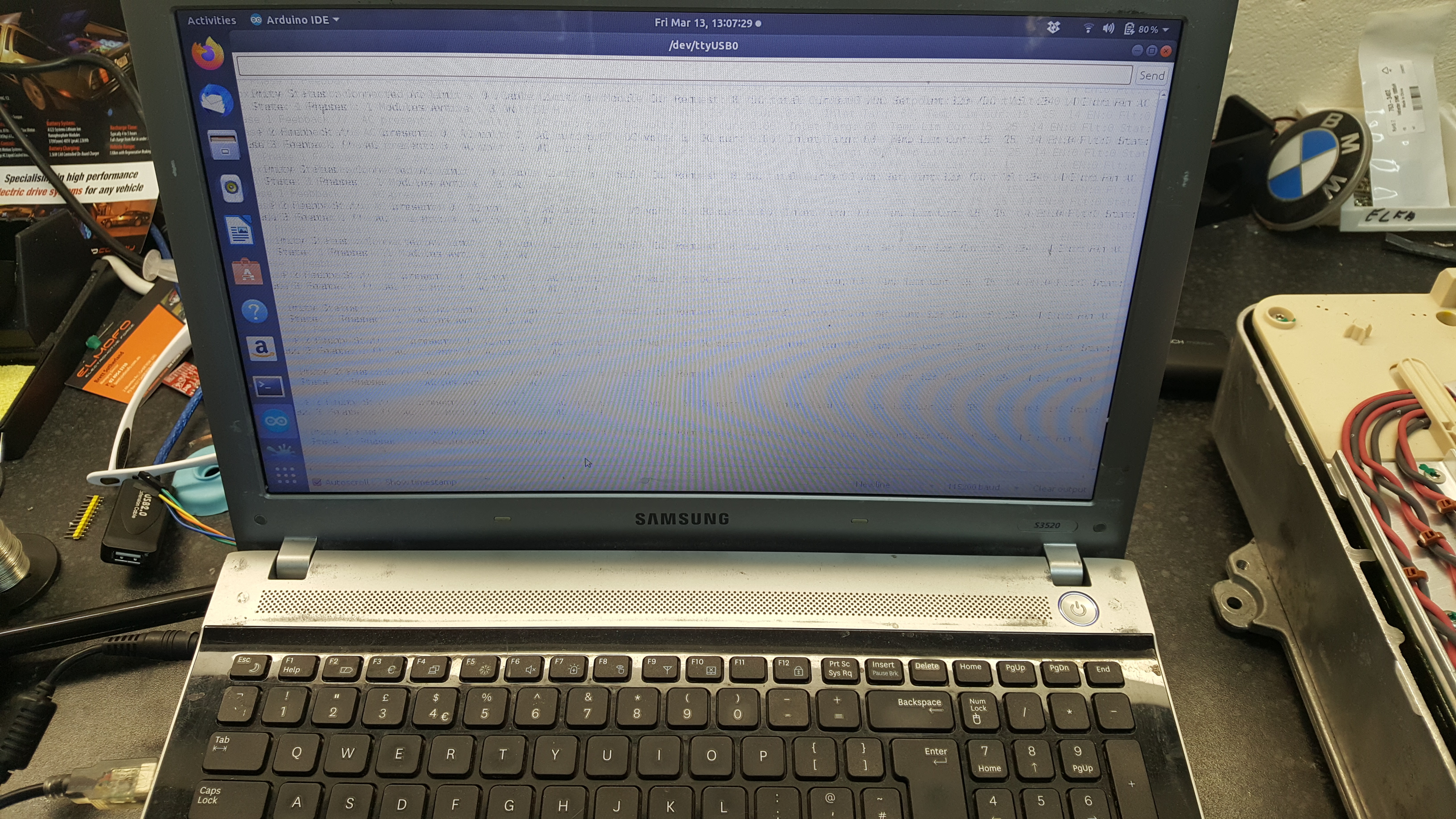

Tesla gen2 charger with Damien control board.
In set up menu it take only two command 1 for auto enable on- off and q for quit.
If try to change can mode after feeding 31 etc ,do not change can mode but taking as 1 and change auto enable.
Charger is not connected to HV battery and also not connected to EVSE.
Please Guide
nesto1972
Posts: 48
Joined: Sat Jan 11, 2020 7:14 pm
Location: Austria
Post by nesto1972 »
Wich program you use? I had same problem with Putty!
Try Arduino serial monitor!
Johaljaswant
Posts: 56
Joined: Wed Jul 03, 2019 1:35 pm
Location: USA
Post by Johaljaswant »
I use Putty, now I switch to Arduino serial monitor and make changes, Thanks
But now when I connect AC first it show AC connected and 234 V ,Control board still has on red led.and no light on charger modules.
After few moment no data coming on serial port and computer beep after few second and led1 light blink on control board.
I try disconnected and reconnected the USB cable but same thing.

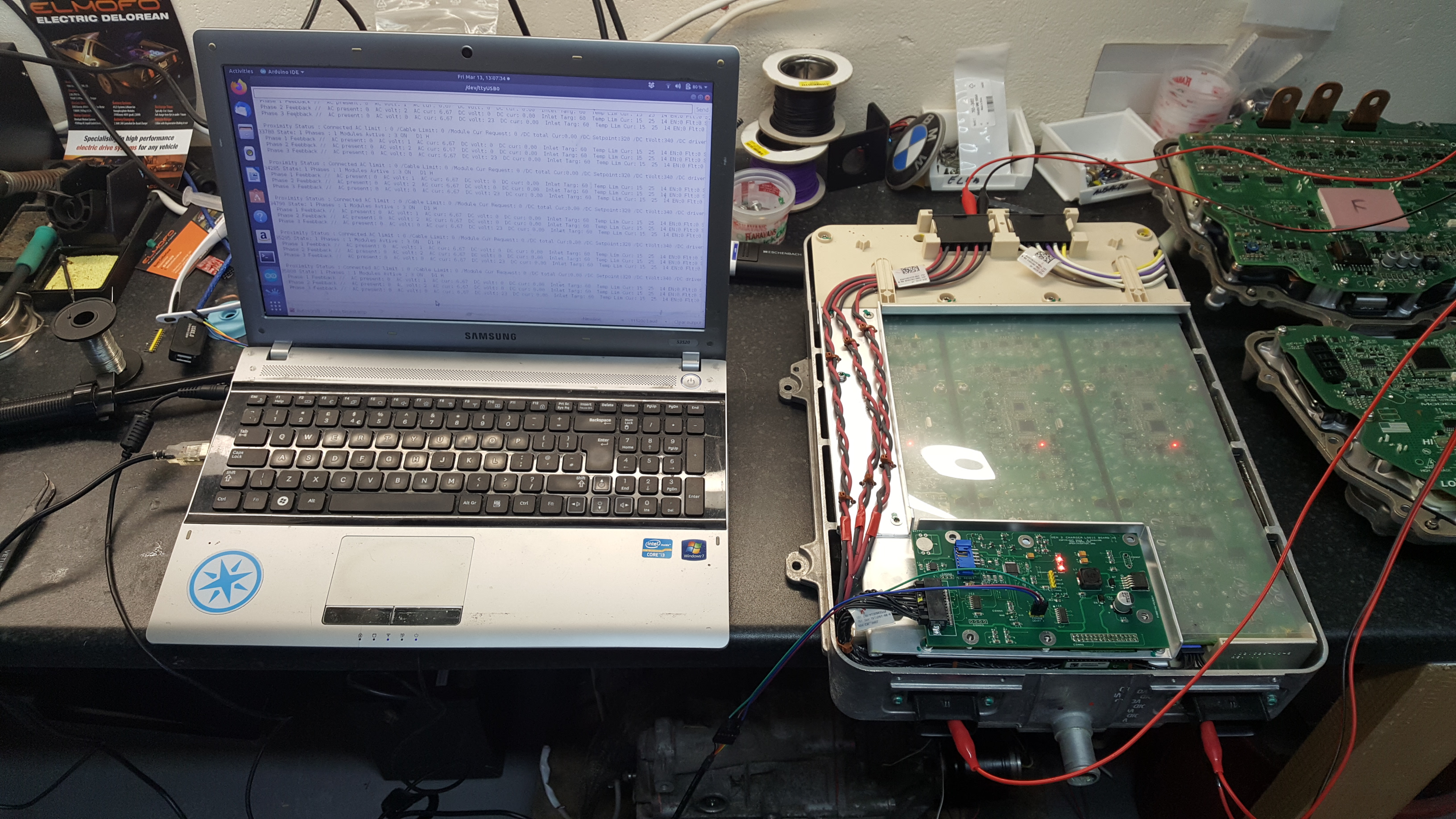

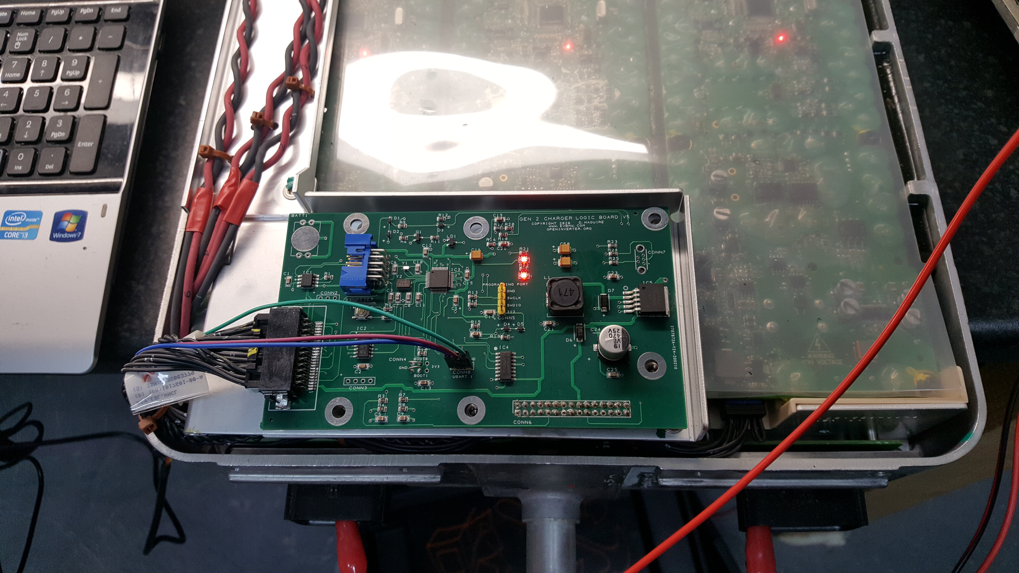

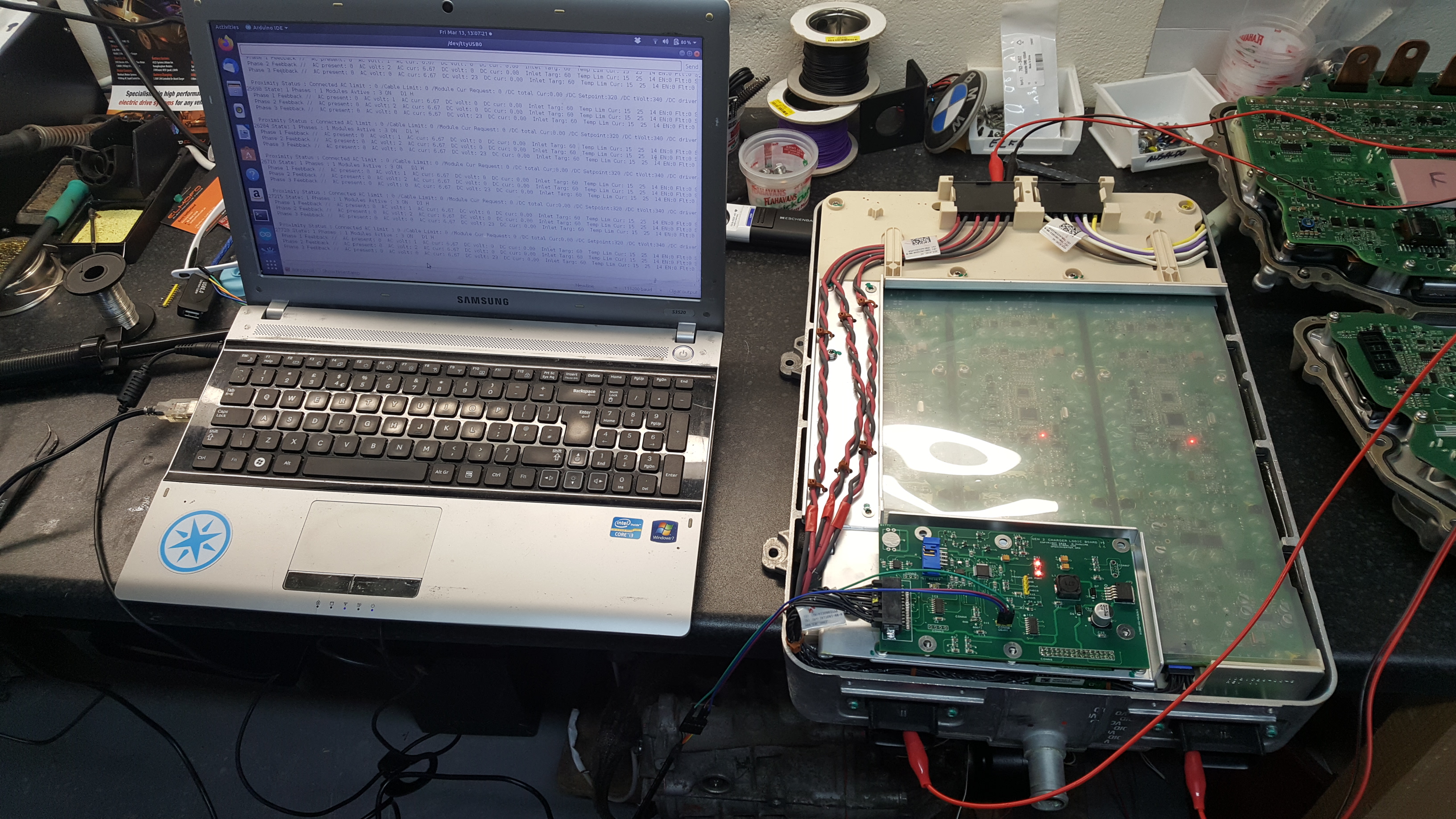

Posts: 4000
Pleased to announce the new charger boards are working well on the bench. Next up testing under actual charge conditions in the Panzer. I'll make boards available in the shop soon for beta testers.
