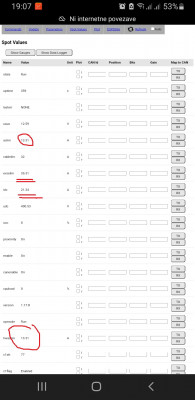

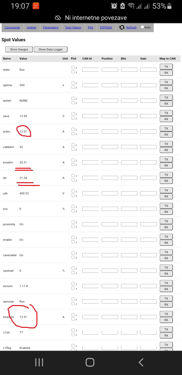

Managed to install this firmware and eneble wifi. Charger started and works, yay! But hang on... i see that darn 13.3A limit per module again. The same as with open firmware. Anyone knows if this limit is caused by the cable or is it set inside charger? Is it possible to reset this to 16A per module?
EDIT: I checked with another cable, both of them have PP-PE resistance 220R = 32A limit! That shouldnt be the case then...
also i tested various charging stations and i see the same result. 13.3A AC limited modules. I want 16A!!!
What is hwaclim? It is currently sitting at 13.3A. Can it be changed anyhow?

hwaclim is received from the charger and supposedly is the upper limit of AC current. I would have to change the scaling factor to change its value but I'm not sure if that actually ups the power or if 13.3A just IS the limit
- Posts: 3796
- Has thanked: 166 times
- Been thanked: 413 times
Re: Tesla Charger alternative firmware
Only one way to find out
My car is open at the back and i have as good access to the charger as i will ever going to have.
- Posts: 3796
I managed to reflash charger board and enter your key. Charger works and i get CAN reports as well.
But hwaclimit remains at 13.31 as well aas normal aclimit at 13.31. It doesnt matter that i have aclimit set to 16A or at 25A.
Cable and EVSE setting is at 32A.
@Johu, is it possible to set a parameter in code so we can tweak that hwaclimit as a parameter in wifi interface?
I would volonteer to test this and report back.
Later on you could also put a conditional loop in code to keep calculated hwaclimit from over 16A ever

I uploaded and set ac limit to 32A. Again i got hwaclimit reported at 13.31! Dc current was at 20A, voltage at 400Vdc.
Would that mean Elon set my charger to lower value?
How is hwaclimit taken anyways? Is it possible to reset it?
hwaclim is received via CAN from each module. It cannot be changed.
So yes you'll still see 13A but it is ignored and will no show up in aclim
If this didn't do the trick then the modules simply ignore any value above hwaclim

Dang! Elon fooled me good!
OK... what would happen if i connect each module to its own phase and set the charger to single phase mode? Would charger be ok?
it is still 3x one phase they are just shifted by 120deg...
You said hwaclimit is read from a single module, whichever is on first? Could i try various modules and phases?

I have a task for you. Can all of you make your charger run on full power and inspect what you get returned in spot values in hwaclim value?
My charger is vidently limited to 13.3A per phase and i can only get 8.8kW on the whole out of it.
I would like to see others write their limits here with their P/Ns.
tnx
