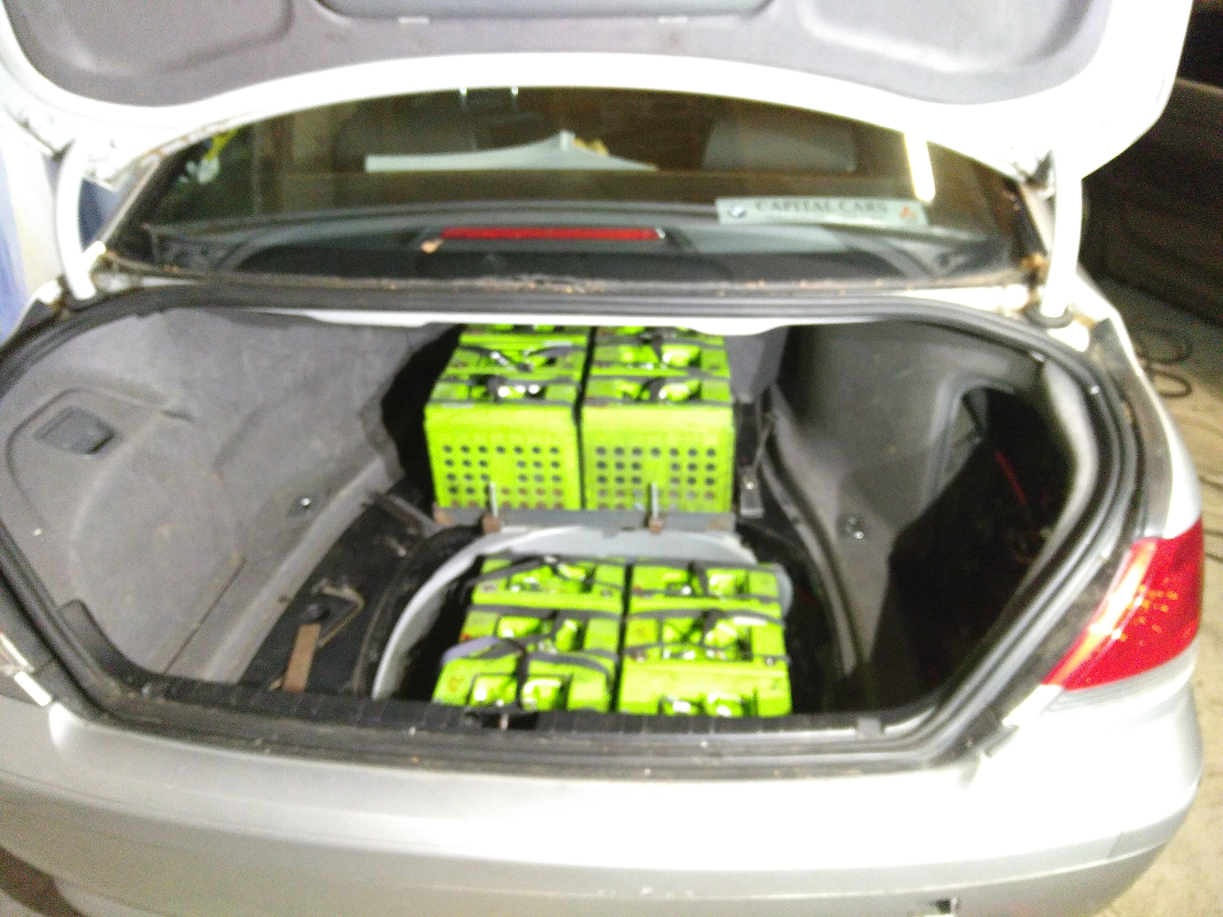

Damien has been busy in the workshop and has installed the rear test pack... almost ready to start road testing at 480V 8-)

Kevin Sharpe wrote: Wed Dec 18, 2019 6:22 pm Damien has been busy in the workshop and has installed the rear test pack... almost ready to start road testing at 480V 8-)
What batteries are you using and would you recommend them?
Kevin Sharpe
Posts: 1339
Location: Ireland and US
Been thanked: 10 times
Re: The SuperYacht BMW E65 7 Series
Post by Kevin Sharpe »
sfk wrote: Wed Dec 18, 2019 11:19 pm What batteries are you using
Valence.
sfk wrote: Wed Dec 18, 2019 11:19 pm would you recommend them?
They are a great form factor and can take a lot of abuse (just how much we'll find out next year). I wouldn't buy them new but given these cost 1 Euro each they're ideal for test systems :)
Note: in our experience approximately 20% valence batteries on the second hand market have been destroyed by their BMS. If you're buying look for the ~20V part with the green case because it has a removable BMS board.

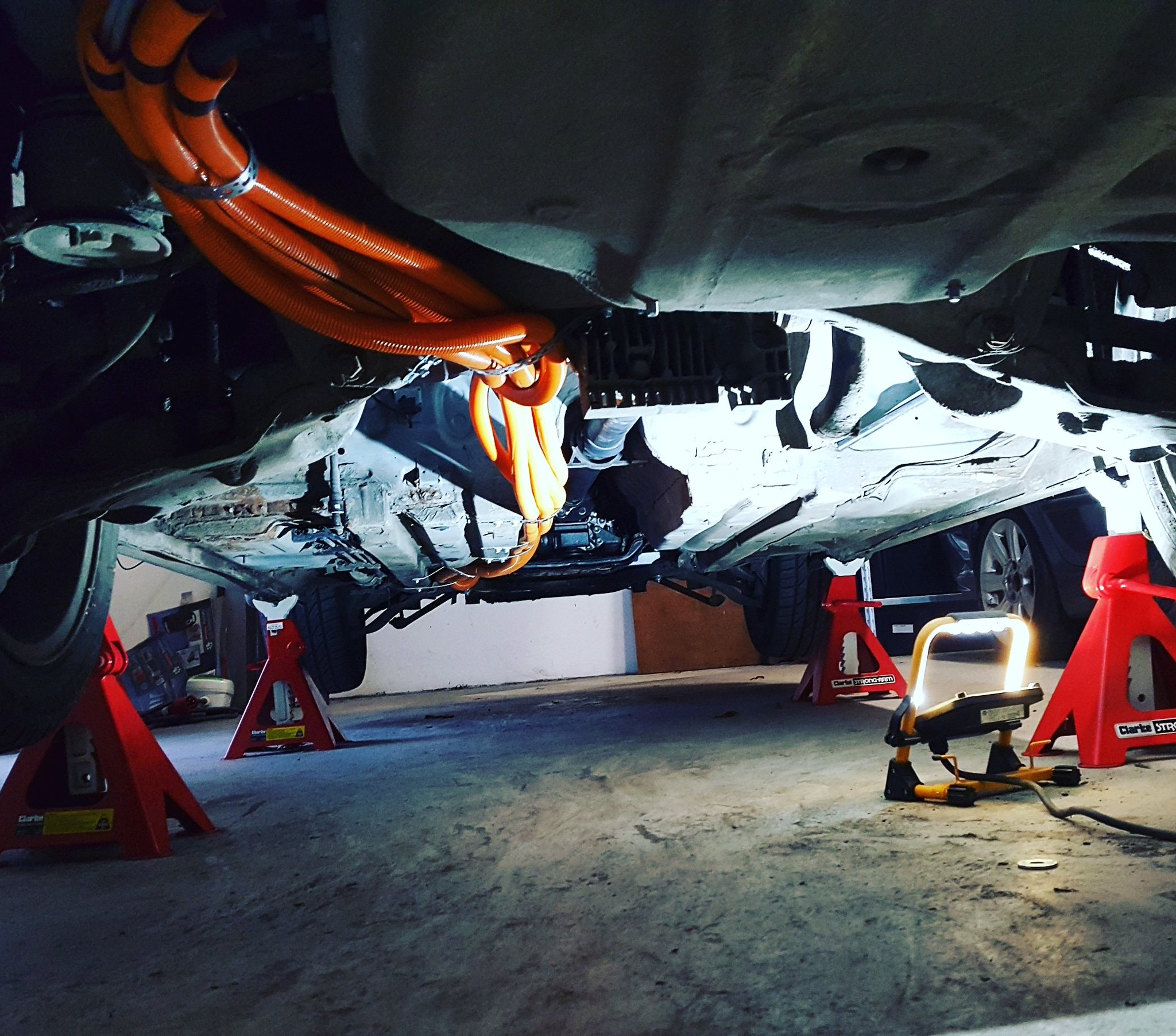

"New fuel lines fitted to the Bexus."
https://twitter.com/EvBmw/status/1207693709158035456
Been thanked: 1913 times
Is that orange watering hose?
If so, I love re-purposing :) Otherwise it's cool, too

johu wrote: Thu Dec 19, 2019 7:04 pm Is that orange watering hose?
No, it's split sleeving... Damien purchased a job lot from some failed conversion company :)
johu wrote: Thu Dec 19, 2019 7:04 pm If so, I love re-purposing :)
Yeah, that would be very cool
