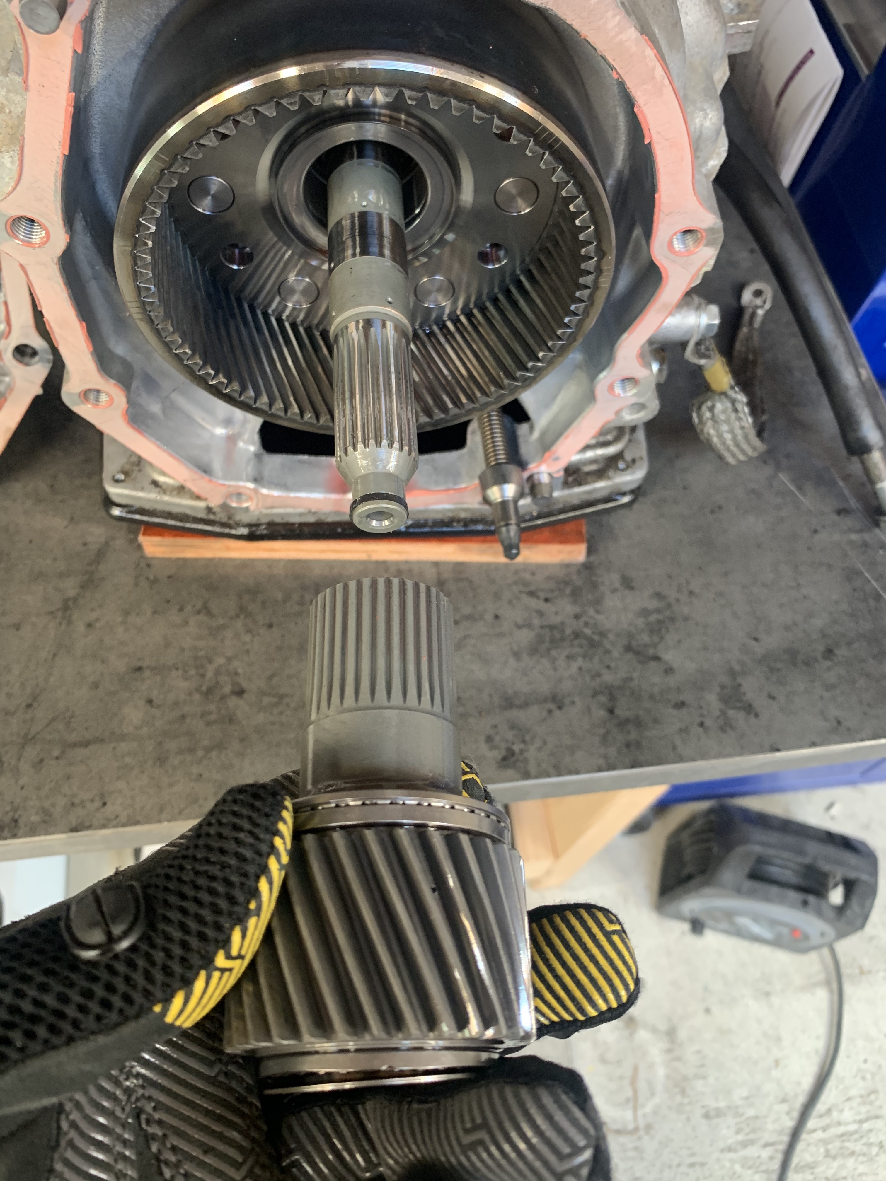

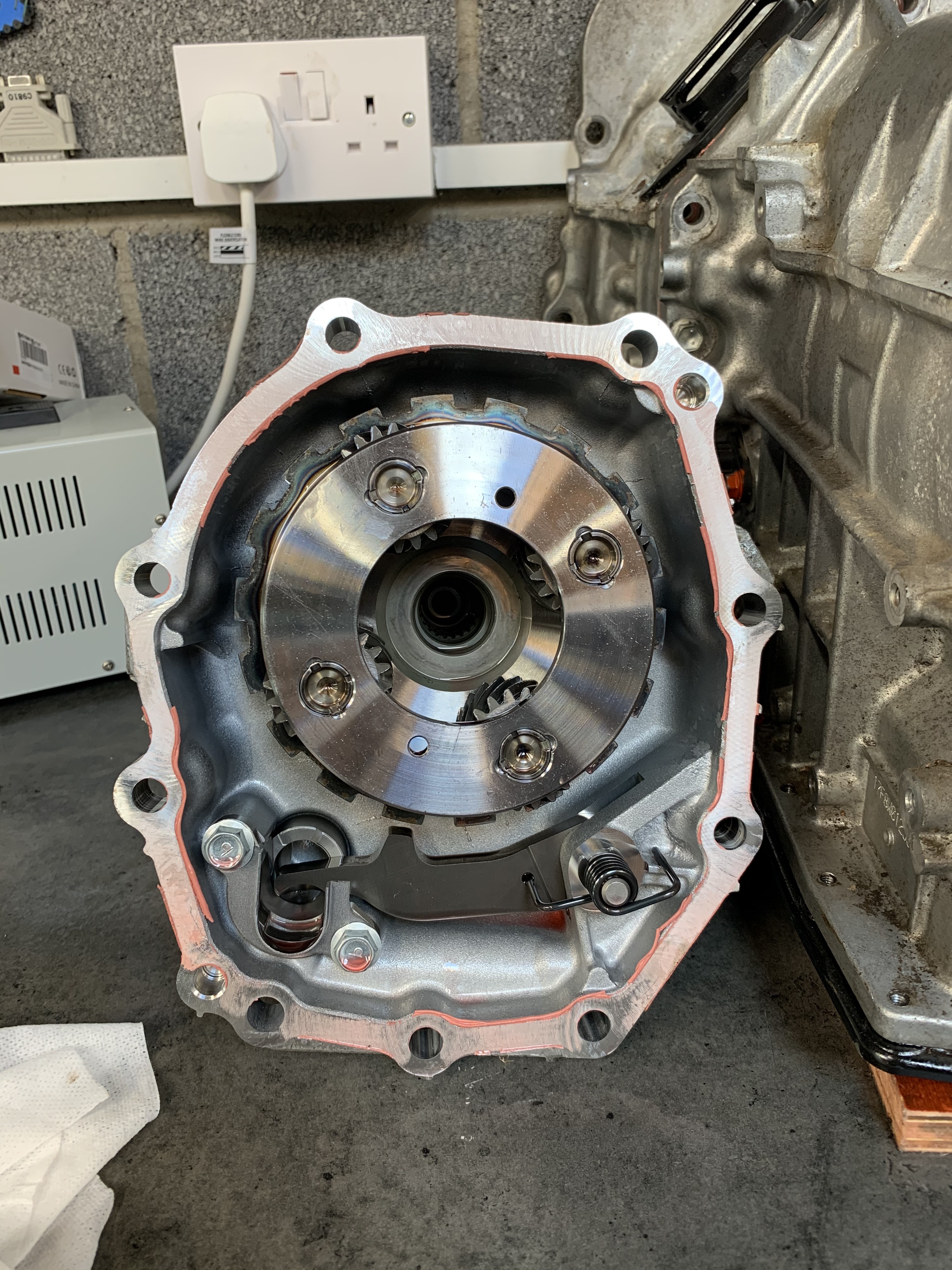

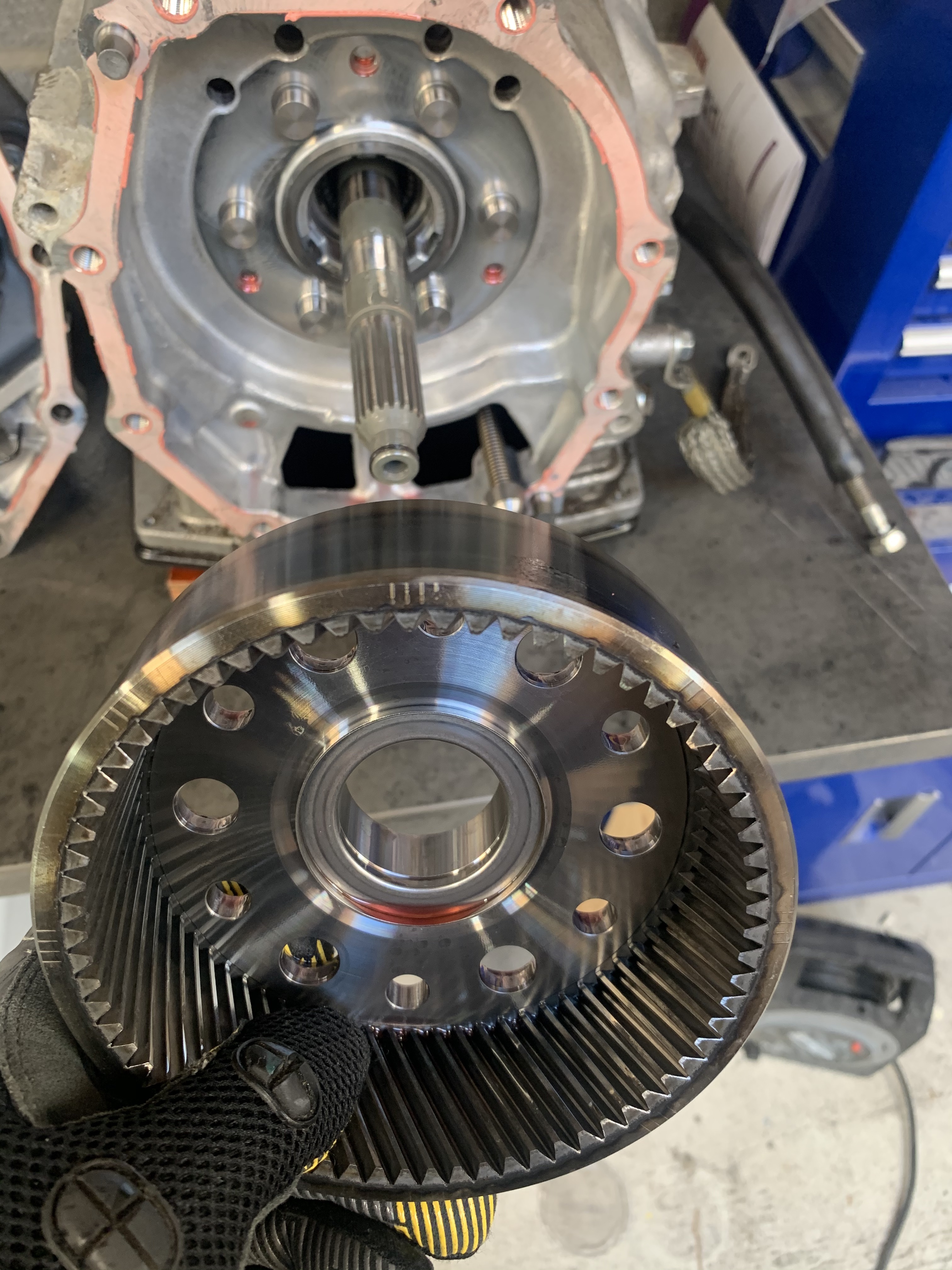

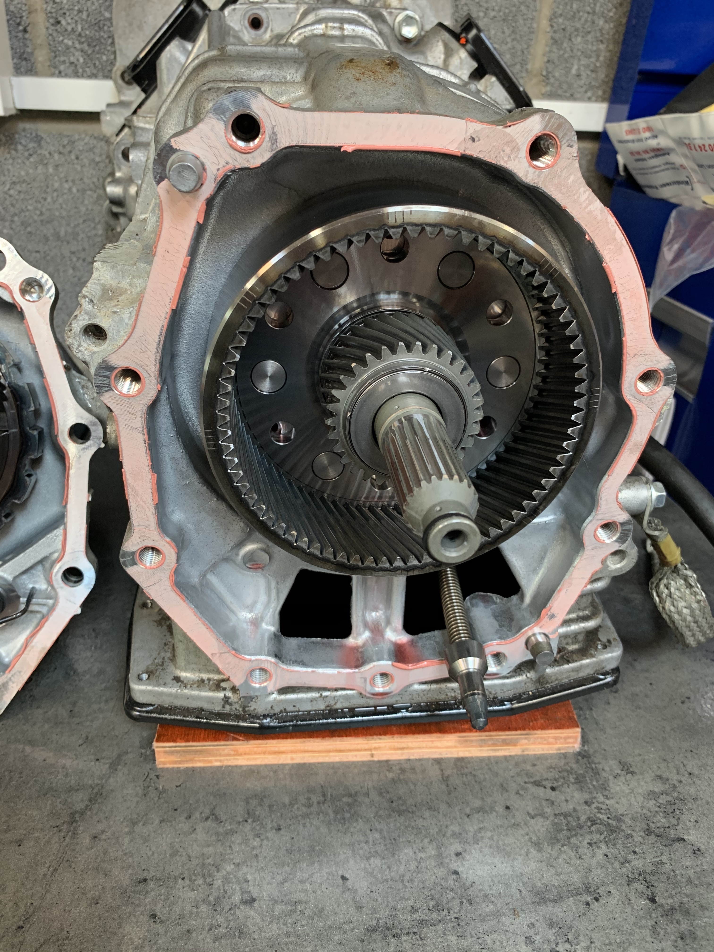

Re: L210 gearbox
Had a few minutes at lunch there and popped open the output end to see what's going on.
Here is the output end. The planet carrier is directly connected to the output flange. If you look closely, you can also see splines on the inside there. These mate with the output shaft from the ICE/MG1 stuff up front. Also, there's the mechanical parking lock down the bottom.
On the other end we have the output shaft from the ICE/MG1 as I say, driving the output flange directly. Then you have the MG2 gear sitting around that. The ring gear is locked stationary with 6 stud things.
It takes roughly 3-and-a-bit turns of MG2 for one turn of the output shaft. So, that lines up with the 3.333 ratio suggested.
If someone wants to double-check:
- Ring gear has 70 teeth
- Planets have 20 teeth
- MG2 gear has 30 teeth
So, at a max rpm of 14000 on MG2, the output shaft would be spinning at 4242 rpm, right? And at that speed MG1 would be spinning around 11000 rpm. Is that right?

Re: L210 gearbox
the math is:
ratio = 1/(S / (R+S))
R = Ring gear teeth
S = Sun gear teeth
FYI this is for a simple planetary gearset. The older L110 used a compound ravigneaux gearset.

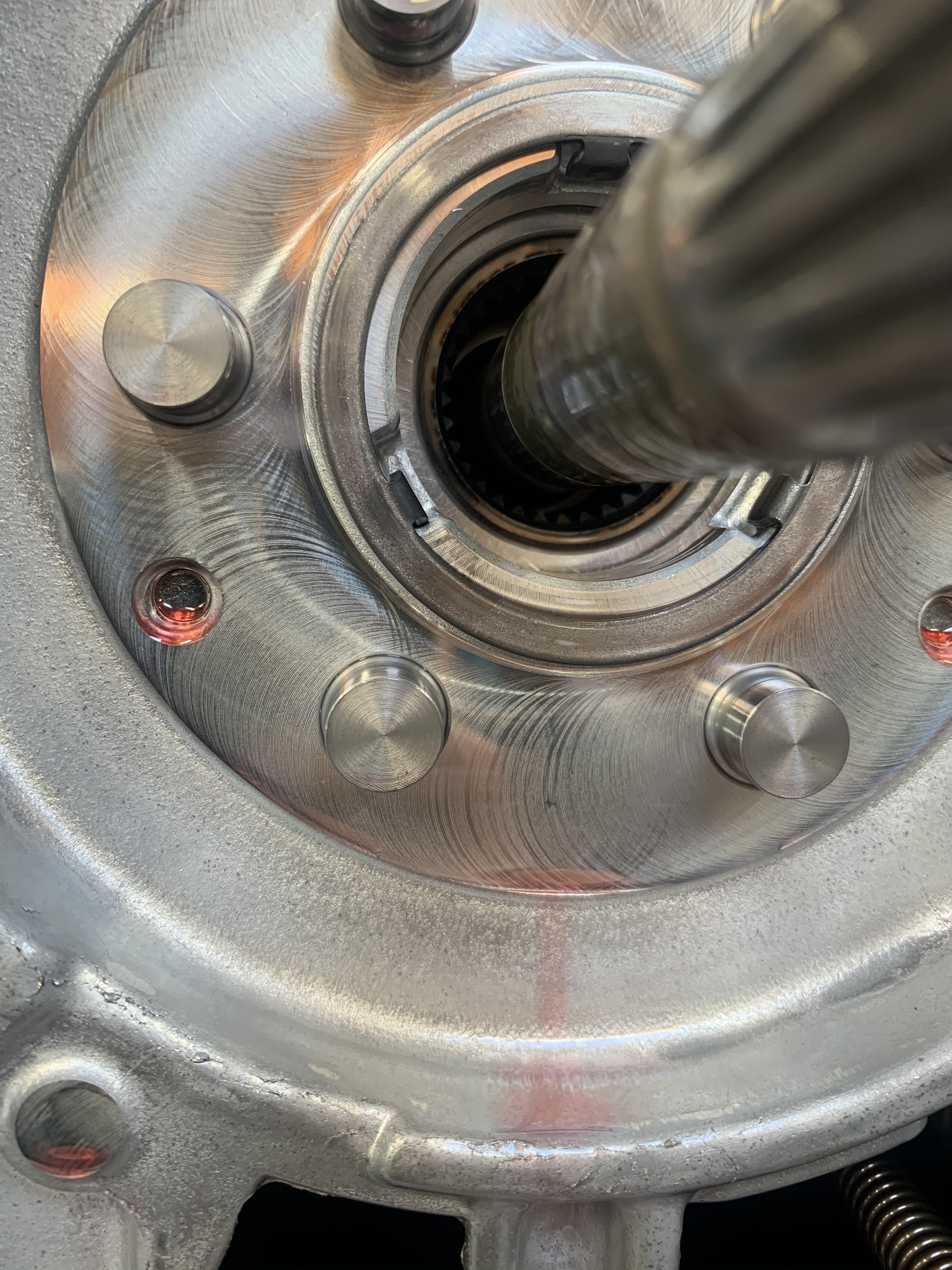

johnspark
- Posts: 264
- Has thanked: 59 times
- Been thanked: 48 times
Re: L210 gearbox
i think the one way bearing is called a Sprag bearing.
https://en.wikipedia.org/wiki/Sprag_clutch
