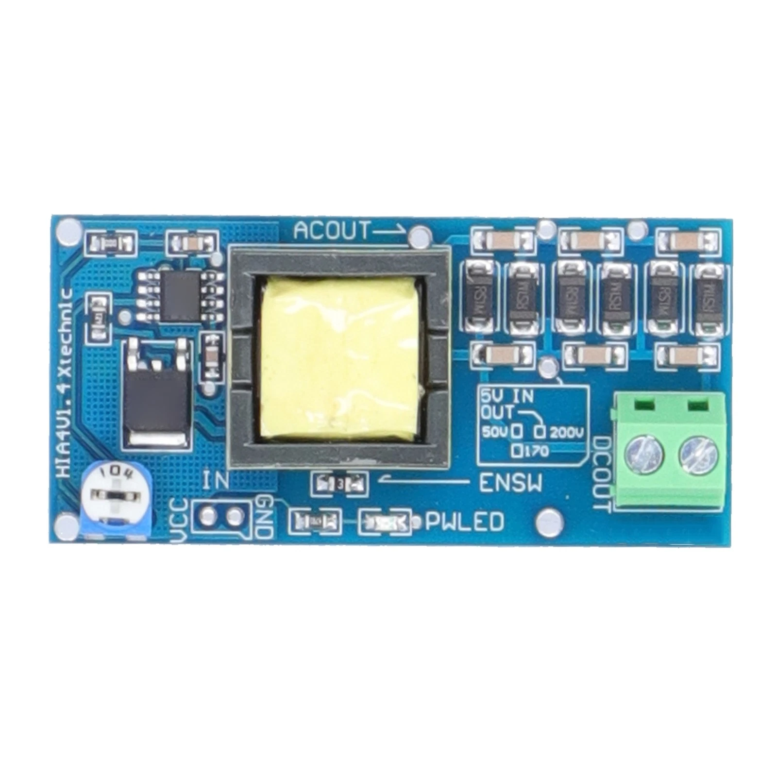

Look on ebay for "5V400V"
Should look like this:

I don't
I connected 10uF to its output so the ramp from 0-400 takes 6s. I simulate this cap curve in pyplc and rely on the fact that 30ms<<6s so the precharge will complete when voltage suits.
Alternatively you can supply PWM directly to the converters FET and control output voltage with pwm frequency

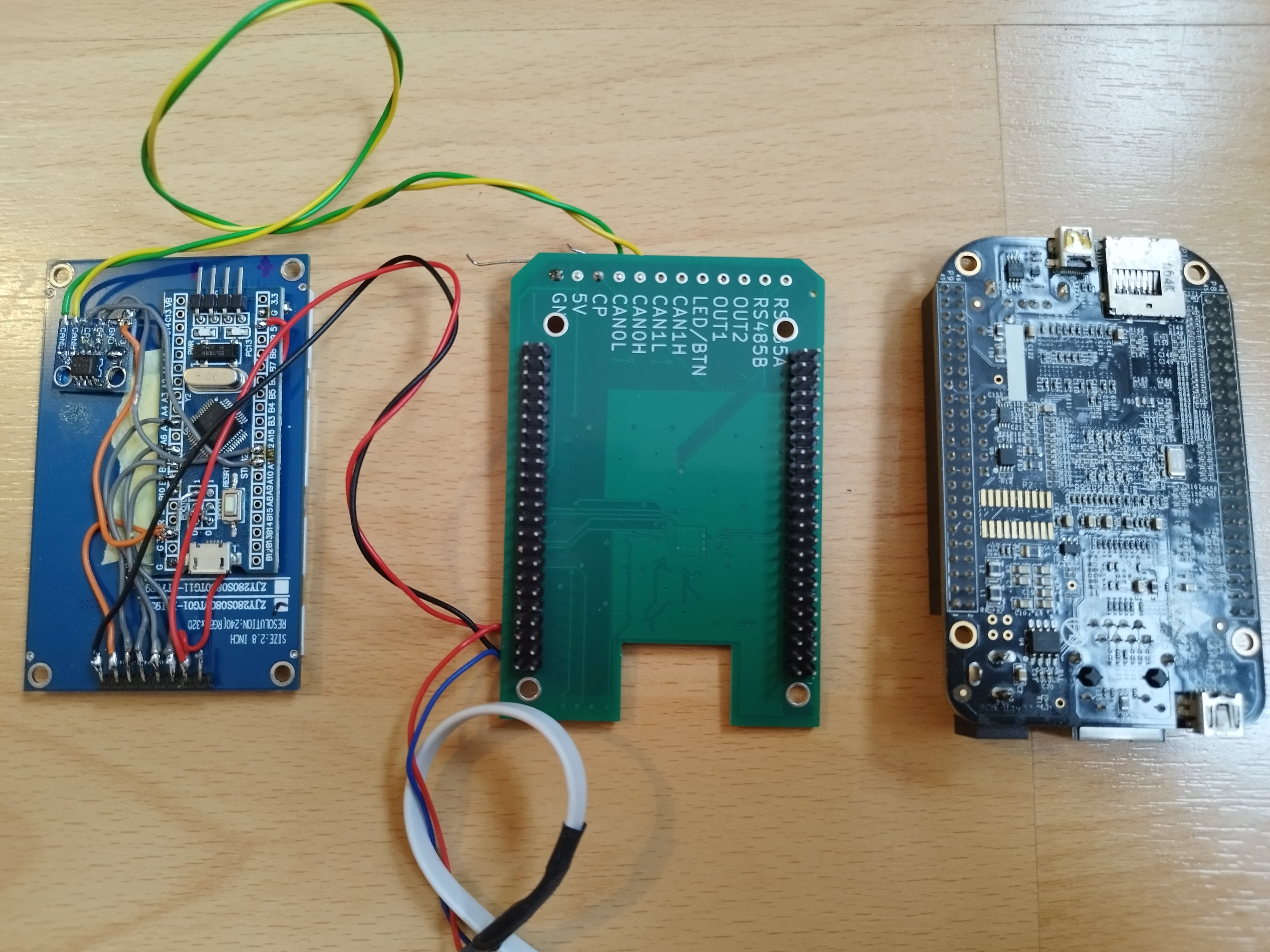

I'm doing the first steps now, I've never used beaglebone before, so a lot to learn. Just some beginners-experiences:
- I'm using the BeagleBone Black (BBB) because I thought that desktop mode with HDMI helps me. But it does not, see below.
- microSD card is not required for normal operation. The BBB has internal eMMC. Booting from microSD requires holding a button during power-on, this is impractical in daily life.
- Booting the image am335x-debian-11.8-xfce-armhf-2023-10-07-4gb.img.xz from microSD to graphical desktop took ~3 minutes, this is disappointing.
- microSD card IS required to update the OS on the eMMC.
- My BBB was delivered with a quite old version, cat /etc/debian_version says 7.9. This has still python 2.7, and got lot's of errors when trying to install python packages.
- trying to install a recent image incl graphical desktop on the eMMC (https://files.beagle.cc/file/beagleboar ... 4gb.img.xz) leads to "disk 99% full". So this is no option.
- Trying to go with a small image now: https://www.beagleboard.org/distros/am3 ... ot-flasher. This reports the same version as johu showed above:

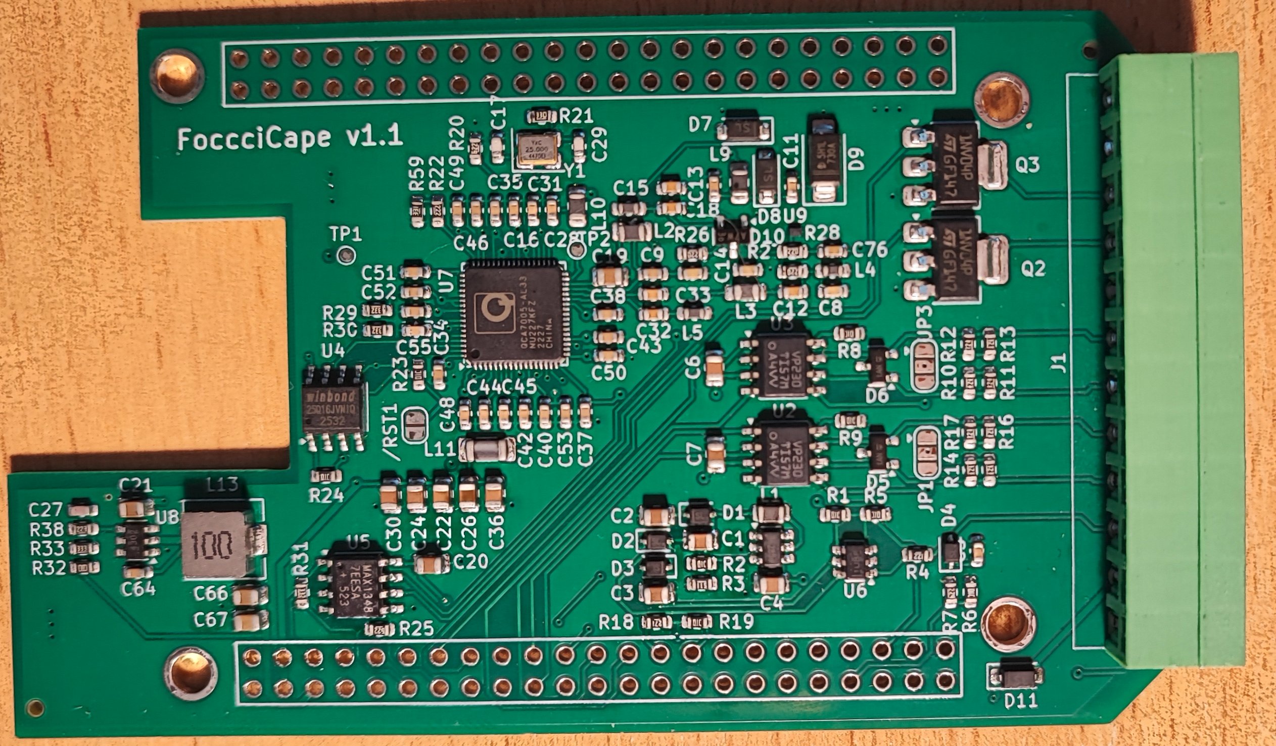

Got the new boards in yesterday
And immediately spotted a problem, dead short from 3v3 to GND. Turns out down to my ego:
DRC warned me about it and I ignored it. As celeron says, DRC always wins.
Nothing a Dremel can't fix.

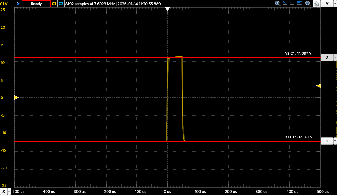

I tried the new PWM generator and it isn't really much better: When loaded with 2k7 it drops very close to 8V instead of 9V.
All else remained unchanged so should just work.

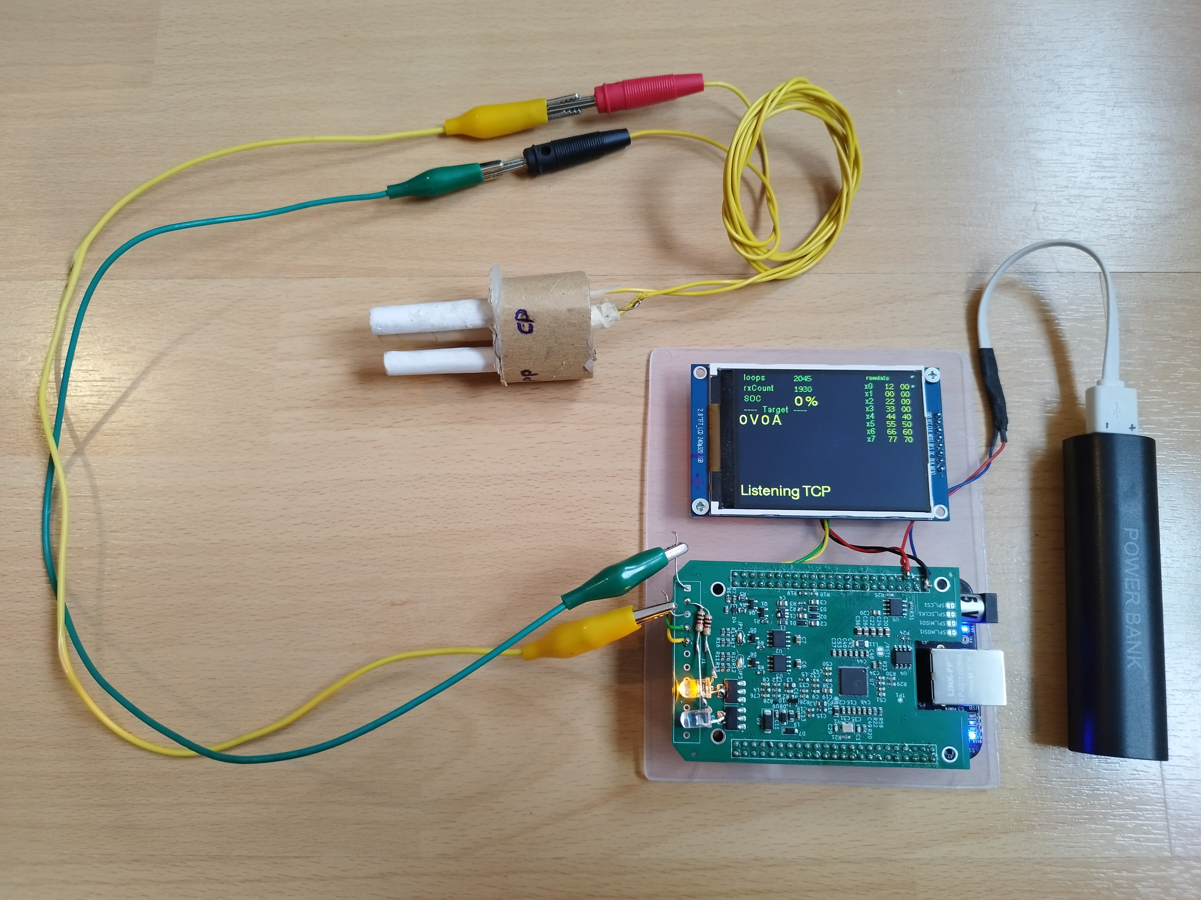

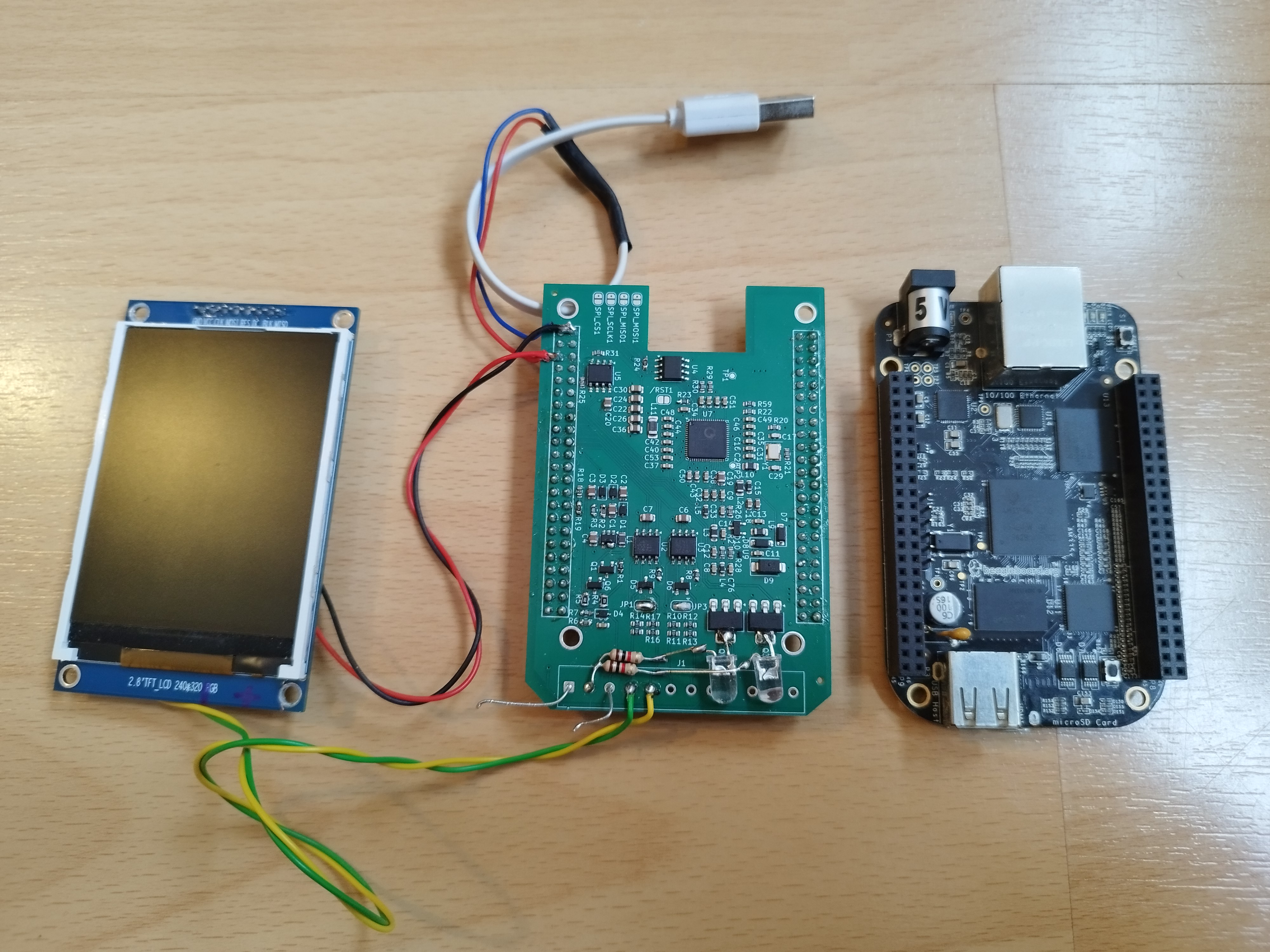

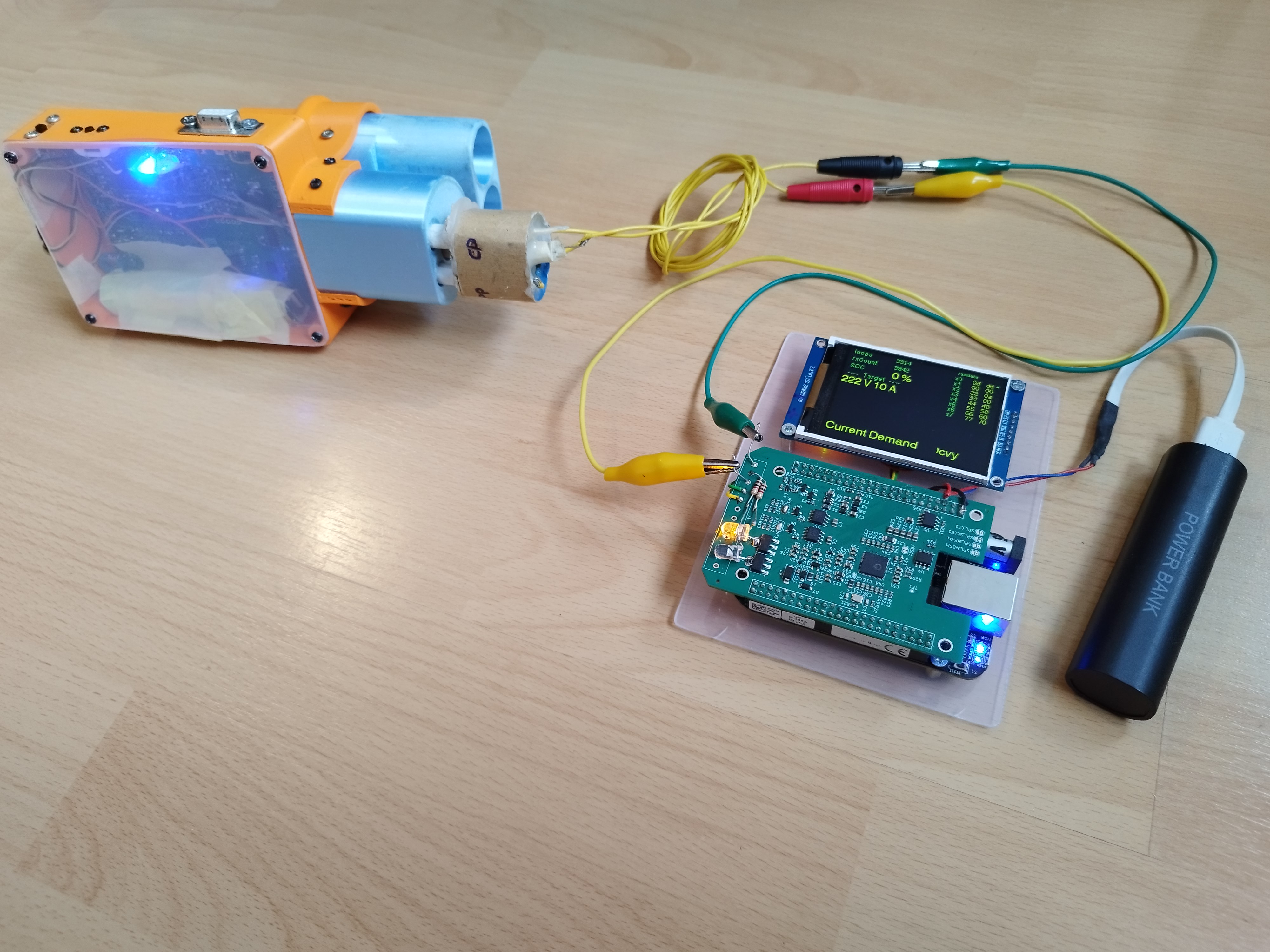

Thanks to Johannes I got a FoccciCape on my desk. Added a display via CAN. Dry-run with using Foccci as car works fine. Very excited to connect it to my Ioniq... Coming soon...

Ioniq is happy, but only for two seconds. (Cannot add pictures, is the forum disk full?)
Edit: Now the pictures work, see below
