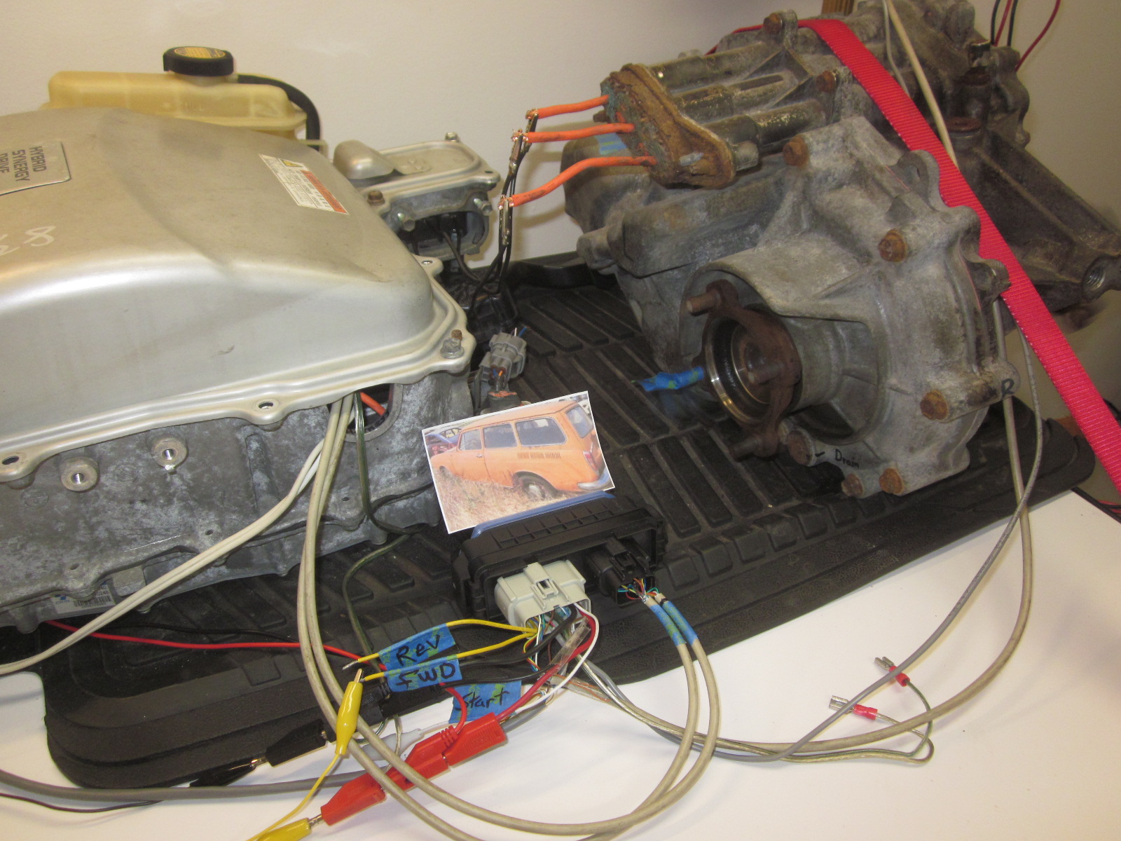

I was having GREAT difficulties getting the current sensors to read accurately, lots of signal "noise" and jumping about +/-2A or more. With all the on-off-on I did troubleshooting my errors (open circuit to one inverter input and failing to set "FWD" when calibrating), I suspected that better wires with shielding might help. I re-wired all the VCU to Inverter wiring, separated the MG2 enable from those wires off to the logic power circuit and all is well!
For about 10A of input, I have il1 = 9.7A and il2 = 10.1 and significantly less apparent signal noise

LOOK OUT MGR! I almost have your (syncoffset) number!
Fianally, bi-directional control and no rotation OR current draw at 0% throttle, either direction
Re: VW Squareback DIY EV
What did I learn yesterday?
- The MGR REALLY LIKES volts!!!!
- If the Sin & Cos are incorrectly wired (as in electrically backwards), there is no "correct" syncoff setting as you cannot get rotation at modest voltages, but it will pull amps!
- Syncoff (FOC) set-up is more effective @ higher voltages, but I am not sure if the final results differ.

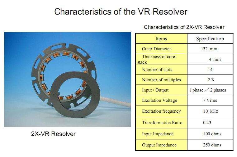

Good to know, want to place it in wiki? https://openinverter.org/wiki/Configuration_Files
I'm surprised about respolepairs=2 and polepairs=4. How did you arrive at that?
Good question, I found the data somewhere, I will find and post it.
<<MAJOR EDIT, I found it, it was Paul M Holmes who found it, linked video below. Other links removed as they conflicted each other.>>
<EDIT: I set the resolver to r=1/p=2 as a test and the indicated motor RPM was 2x faster than measured output shaft x gear ratio>
