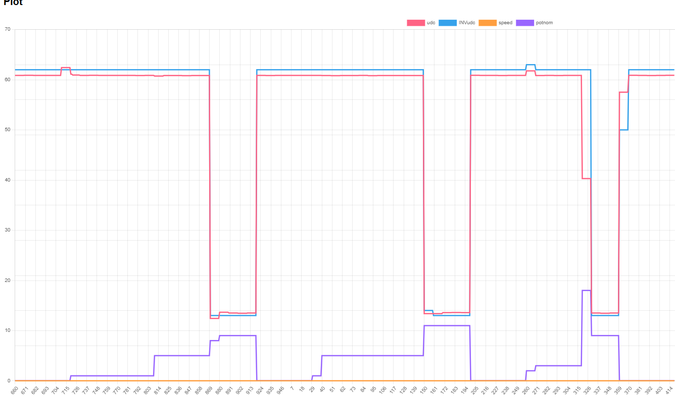

Re: Minimum configuration to get L210 running on the bench / how to initialise ISA shunt?
somehow I`m not getting further.
I have several issues:
The WIFI connection to the interface seems to be quite unreliable, sometimes parameters are not displayed, I have to reload the page often. Quite annoying, can I connect the Zombie via cable to my laptop to avoid having to use WIFI?
Sometimes the inverter does not come alive: when I switch on the Zombie and carry out the starting sequence, sometimes the inverter does not come up. I have to power cycle the Zombie then several times until it finally works...
And finally I still do not get this thing to spin. When I press the throttle very gently and release it again, the motor spins for one or two revolutions, but often in different directions (forwards / backwards). So I assume the electric power supply is sufficient to get it to spin, yet there is another issue.
I tried to shield the resolver cables by wrapping them in aluminium foil,... no difference.
@ Jacobsmess: regarding checking the reported speed of the inverter, I still did not find a corresponding spot value. Are you reffering to "speed" as a spot value?

Please post your params so I can go through and tell you what to change.
Does the output shaft spin freely by hand? Are you trying to spin 2 motors at once of have you set it to spin just MG2?

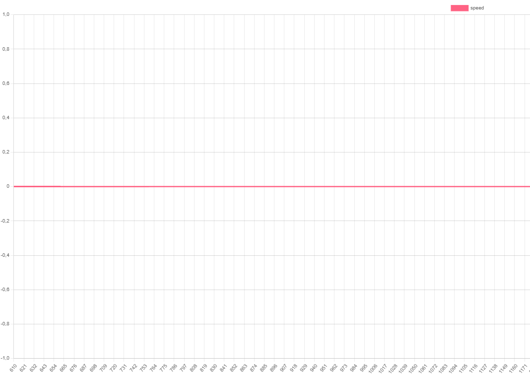

How when and what. Did you plot it while spinning the output flange?
Yes, spinned the flange by hand as fast as I could, probably 60 rev / min... Plot showed Zero.
Inverter was in run mode.

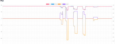

MotActive set to MG2
regenmax set to 0
Spot values with the above new parameters: same behaviour:
spun the shaft by hand while plotted "speed" (inverter in run & direction foward):
I'll try to get some batteries now that I can draw more amps.

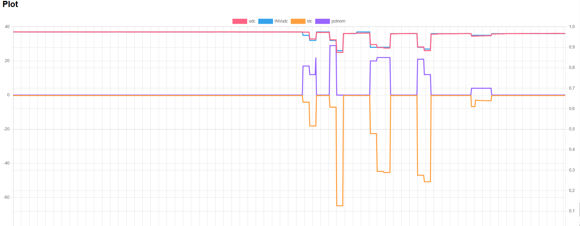

took three 12 V lead-acid batteries and connected them in series (36 V) as HV power source.
Basically same behaviour, the output shaft just rattles / shudders but does not spin.
I just realized that "idc" shows a negative value, is this correct or did I switch polarities?
here is a plot with idc:
Solved the problem. Pinning from the resolver to the inverter was not correct (I made a mistake when I transferred the wiring information to an excel sheet, and then only checked the pinning against this wrong sheet...).
30V and approx. 1,5 Amp was enough to get MG2 to spin. Cables from the resolvers to the inverter were not shielded, so for a basic bench test apparently any type of cables are ok (as long as the pinning is correct...
thanks to all who contributed to help.
