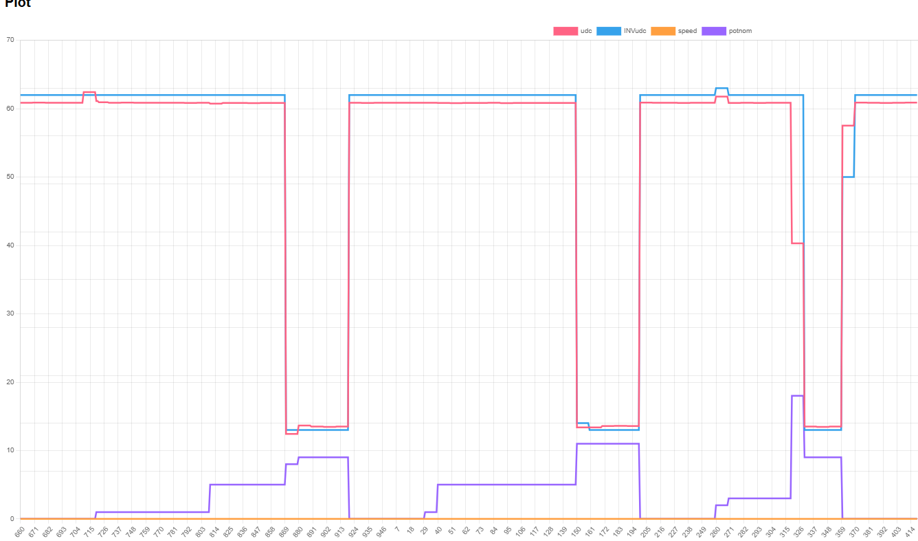

tom91 wrote: Fri May 16, 2025 1:51 pm How when and what. Did you plot it while spinning the output flange?
Yes, spinned the flange by hand as fast as I could, probably 60 rev / min... Plot showed Zero.
Inverter was in run mode.

same behaviour:
spun the shaft by hand while plotted "speed" (inverter in run & direction foward):
I'll try to get some batteries now that I can draw more amps.

took three 12 V lead-acid batteries and connected them in series (36 V) as HV power source.
Basically same behaviour, the output shaft just rattles / shudders but does not spin.
I just realized that "idc" shows a negative value, is this correct or did I switch polarities?
here is a plot with idc:
