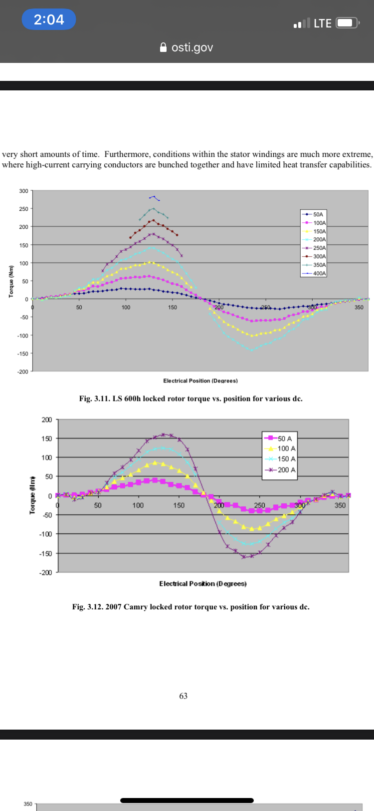

kiwifiat wrote: Sun Mar 22, 2020 6:29 pm Given that IPM's produce torque from Id it seems to me that the recommended procedure for finding syncofs will yield an incorrect result. If the motor was an SPM then it would be correct since Id produces no torque. I would keep adjusting syncofs until the motor runs correctly in either direction. Maybe johu can chime in?
I think this is a valid point. Also the best angle for torque moves around with current. Here is the one for the Lexus trans.

slow67 wrote: Sun Mar 22, 2020 7:07 pm I think this is a valid point. Also the best angle for torque moves around with current. Here is the one for the Lexus trans.
Hm... what kind of motor is Remy HVH 250? Is it IPM? Certainly some people online think so. But there is no torque on shaft if i rotate it by hand.
It is 10 pole motor with 10 pole resolver. I can see 5 lobes in resolver core.
EDIT:
Remy cites testing showing that an HVH internal permanent magnet motor provides 27% higher torque and 34% higher power compared with the same size round wire winding IPM motor. At the same performance level, the HVH motor offers a 22% reduction in space requirements and 13% reduction in mass. In addition to documented fuel efficiency improvements, freight hauling capacity can be increased since more weight can be carried in the vehicle rather than in the hybrid drivetrain.
Been thanked: 1913 times
Re: Syncofs searching
No there is neither reluctance nor magnetic torque if the field is perfectly aligned with the magnets. At least with the Leaf motor the procedure was proven to work.
What you mean is that you get additional torque by adding negative direct current to an existing quadrature current. This will create reluctance torque in addition to magnetic torque.
I'm not a full IPM expert though, just self taught.

Agreed there is no rotor rotation when there is zero torque generated. My point is that in the case of an IPM that is not necessarily when the stator field is perfectly aligned with the magnets. A number of reports from Oak Ridge Labs in the US clearly show that the optimum angle for torque production in IPM motors changes with current magnitude and this is due to reluctance torque not the the torque due to the permanent magnets. The implication of this is that the actual stator angle in which no torque is produced must also move with stator current magnitude. Whether or not this important is a moot point but in Arber's case it would seem that the motor runs ok in one direction and badly in the other which implies that the value for syncofs is incorrect. Can you explain any other reason for the observed behavior in arber's case e.g. are there any settings other the syncofs that would cause this? And the same here, not claiming to be an expert. Funny thing is else where when I quote Doctoral qualified experts in the field of motor design I get told they are all idiots :lol:
