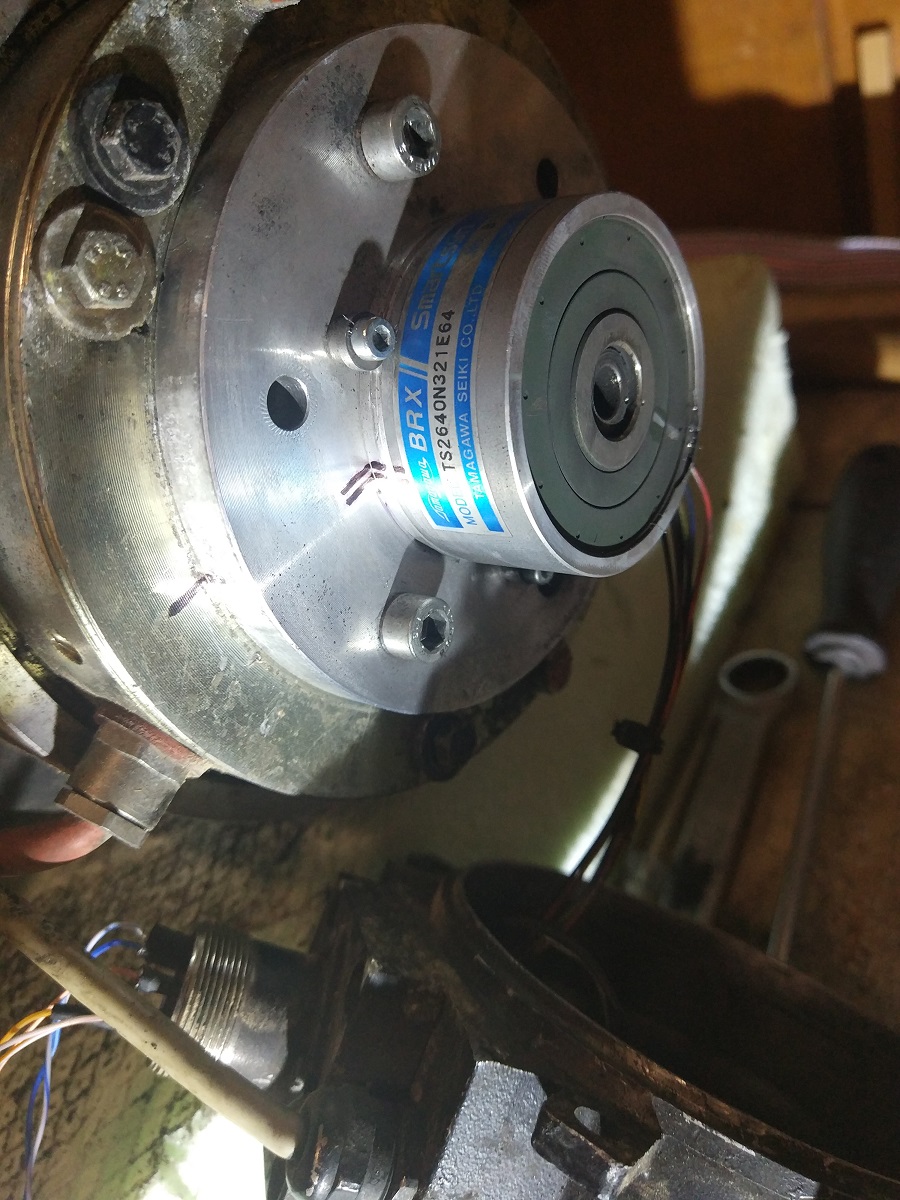

Hi forgive me for hijacking this thread. But it seems a good place to start...
So i made Ampera inverter brain with Rev 2 chip and resolver interface and now it behaves as rev 3 board.
I got a servo motor, 6 pole Stromag FOP32-0200-40-S2
Resolver is Tamagawa TS2640N321E64 and i see it is 6 pole resolver on a first glance.
I thought it might make a good experimental motor. It comes with a brake that you release by applying 24V to its contacts.
I use 350Vdc VW Golf hybrid battery as a test bed.
Long story short i think i got resolver correct according to Stromag schematic. I get a good view on potato Sin and smaller potato Cos.
I also connected phase cables as they state in schematic U,V,W.
Now i went on and started inverter and tried to give it some juice. It tripped OClimit of course...
Well then i went and followed instructions for FOC offset. I connected in manual and rotated shaft untill i could see about 2°on a dial. Is that as 0 as it gets? If i would turm just a bit more angle would jump to the other side.
Then i entered a 1A value to manualid and got a bang and instant OClimit.

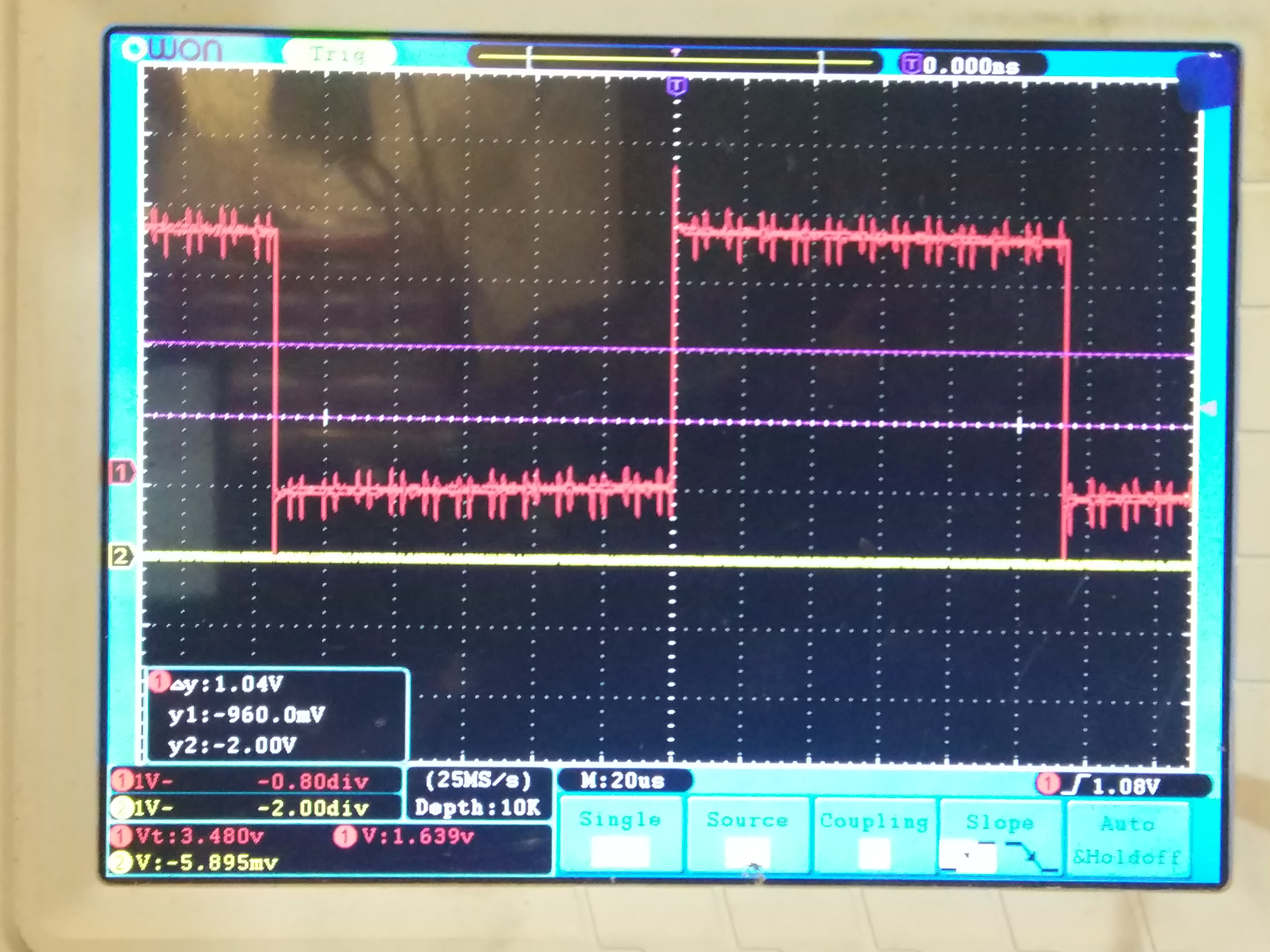

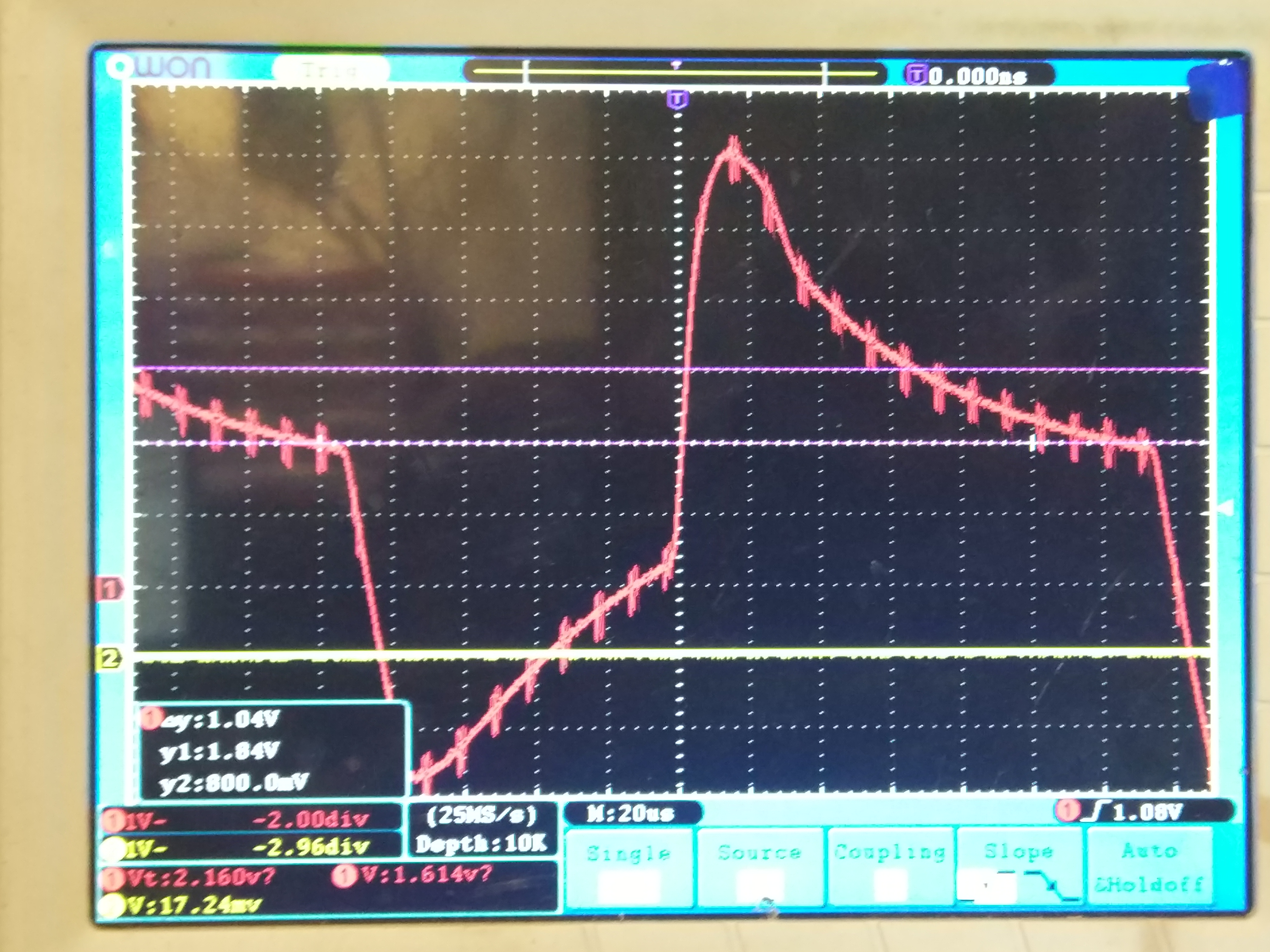

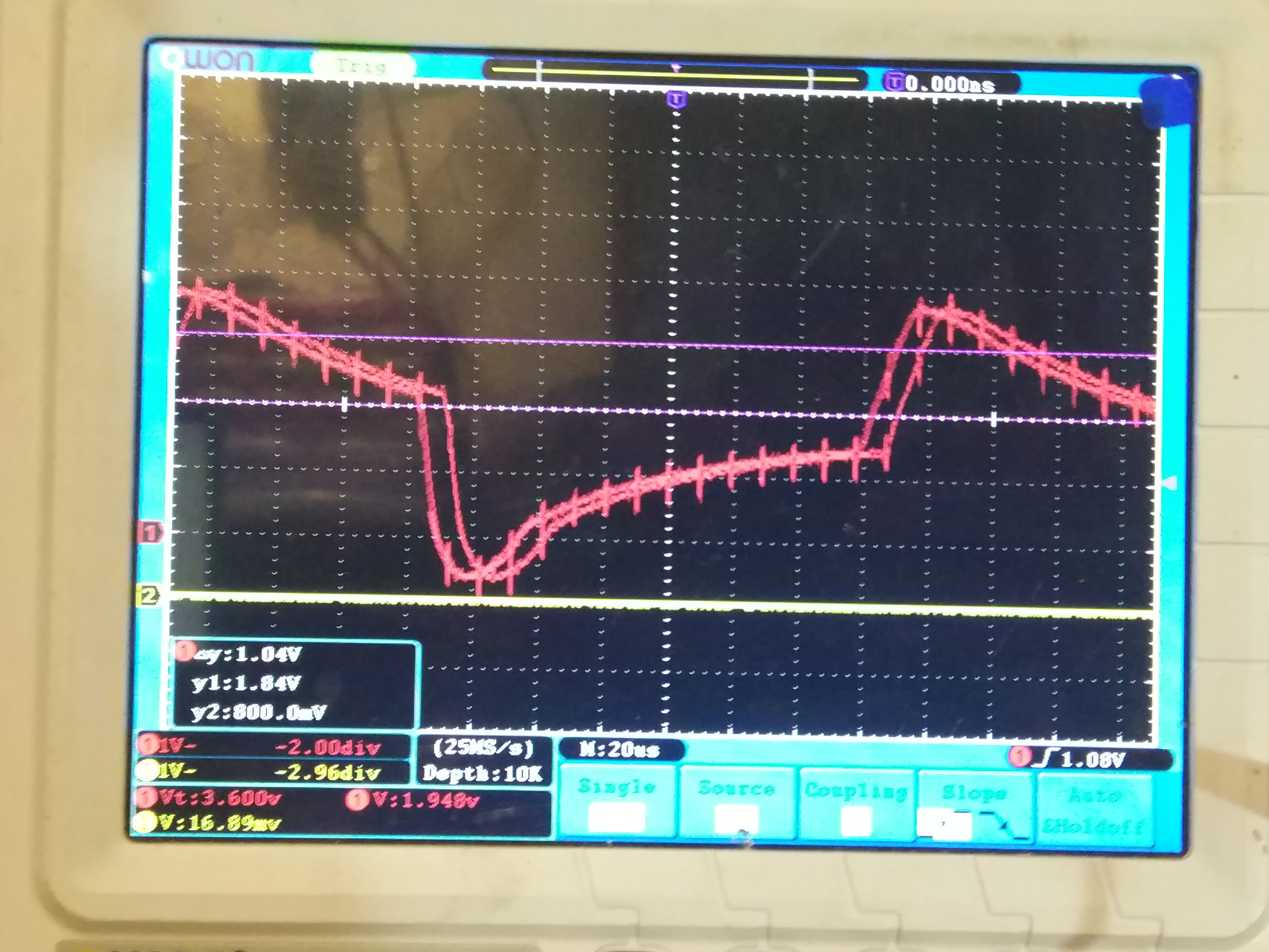

Re: Syncofs searching
Well... i inspected my resolver signal.
I get good square signal at 4.4kHz from PD2.
Then i measured Sin and cos signals. I get good 1.5V supply signal at S1 and S4. But i get much more on S2 and S3. As i rotate axis i get increasing signal from 0V to 5V!!! Is that good for uC? I am powering amplifier with 12V directly behind the input diode. Should i rather power it from 5V?
Did i mess up resolver circuit? I just used the schematic from this thread viewtopic.php?f=2&t=15#p65.

Hi Damian, can you make a snapshot of your resolver signals with scope on pins R1, S2 and S3? I need to see the shape of signal. I think something is wrong with my resolver circuit.
I know! But i have schematic for the motor and it states exact wiring of the resolver plug. I have prepared it according to the schematic.kiwifiat wrote: ↑Thu Mar 19, 2020 9:46 pm That is seriously wrong, the maximum magnitude of the voltage signal you get from the COS/SIN feedback windings should be around the same. I wonder if you are accidently driving the wrong pair as the exciter. JB kindly measured the resistance of the coils for us: Exciter 17 Ohms, Sin and Cos 37 Ohms. Don't power it from 5V, find the problem so both Sin/Cos outputs have the same peak to peak voltage range.
Next i found Tamagawa resolver manual and found wiring schematic for it. Wire colours are a match to connector wiring.
Also i measured exciter and sin/cos pins and i get good values out of them.
EDIT: I measured again and i get:
R1-R2 = 54R
S1-S3 = 45R
S2-S4 = 45R
It does seem that exciter winding has more turns than Sin/Cos.
There is actually something in resolver manual. It declared normal signal from resolver is 1x signal. Then it talks about signal multiplication. I thought his was pole numbers or similar. Now it seems they actually wire resolver to output higher voltage...
I need to get a proper automotive motor here and test its resolver....

I have good resolver reporting from 0 to 360. Tested with wifi dial.
I noticed resolver position jumps by a +/-2°when standstill.
My resolver S2 and S3 signal has more than 5V peak to peak, but i can stil get good reporting from the dial.
I have noticed a lot of hash on resolver line when power stage is active though.
I think resolver has some signal boost, since R1 carries only 3V3 signal. It is Tamagawa TS264ON321E64
Hey! I took apart resolver cover and i saw some markings on it. First two from the center were resolver 0°position and they were connected. The other remaining mark must show stator 0°offset position.
Johannes how do you calculate offset in angular position? Is it ok to calculate 65535 / 360 = 182 for one degree of offset? If i just measure angle then i can input that or its 180deg shifted angle.

If you are getting 1.5Vp-p on one set of windings and 5Vp-p on the the other as you indicate above then the ADC in the STM32 will be saturated on the 5Vp-p signal and it is not possible to calculate an accurate angle from the data. The fact that your resolver has more windings on the exciter than the feed back coils in not important. All that matters is that the Vp-p of both sin and cos signals are close and the magnitude is such that the ADC does not max out. That is to say that after the ~1.6V offset that is added to the feedback signals by the circuitry on the controller board the voltage seen by the STM32 does not exceed 3.3V. Unless you isolate and resolve the issue that is causing such a huge disparity between the Vp-p Sin/Cos signals there is no chance of getting that motor running with inaccurate angle data.arber333 wrote: ↑Fri Mar 20, 2020 9:50 am
R1-R2 = 54R
S1-S3 = 45R
S2-S4 = 45R
