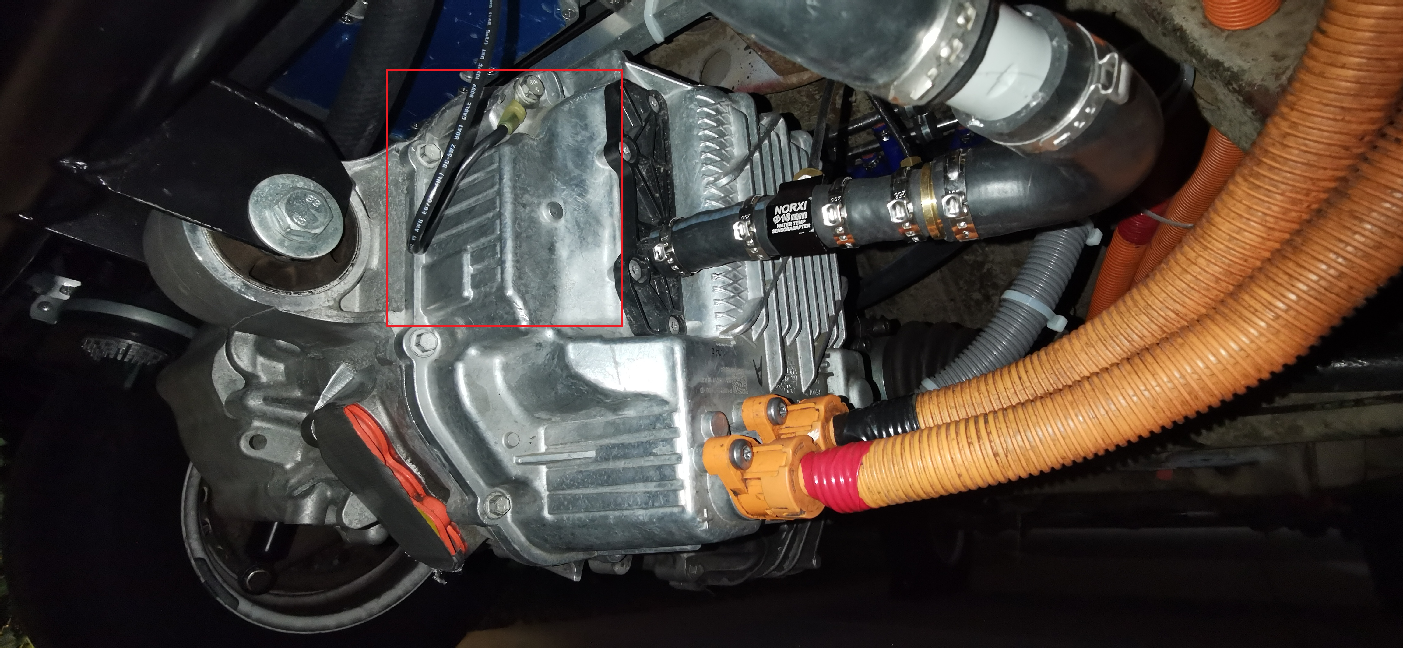

This thread should probably be called SDU issues, issues, issues, or similar. I appreciate your patience with me folks.
I drove around today more and at up to 60mph. There's only slight improvement in cooling at higher speeds, but have reached tmpm=80C.
What I noticed is that the radiator gets warm to touch at those temps, while the ambient was ~16C. Radiator doesn't get enough airflow!?
Running the fan helps, I can feel the cool air gets pulled through the radiator, but my fan failed today, so not sure how it will improve. I set the motor pump to 70% permanently, but without luck. The hose from the pump to the inverter becomes hard as it's trying to squeeze that much pressure when converting from 3/4" hose on the pump to 5/8" on the inlet of the inverter.
Also I notice the case of the inverter becomes very warm to touch in this area (within red rectangle, lower is cool too), but the area where the igbts are is cool to touch. Is that how it suppose to be?
I will do more plots tomorrow to be exact, but I see my voltage sags quite a bit - ex. BMS reports 46% when stationary, ~36% when accelerating, ~43% at speed, back to 46% when stopped. Perhaps cooling and parameters are related!?

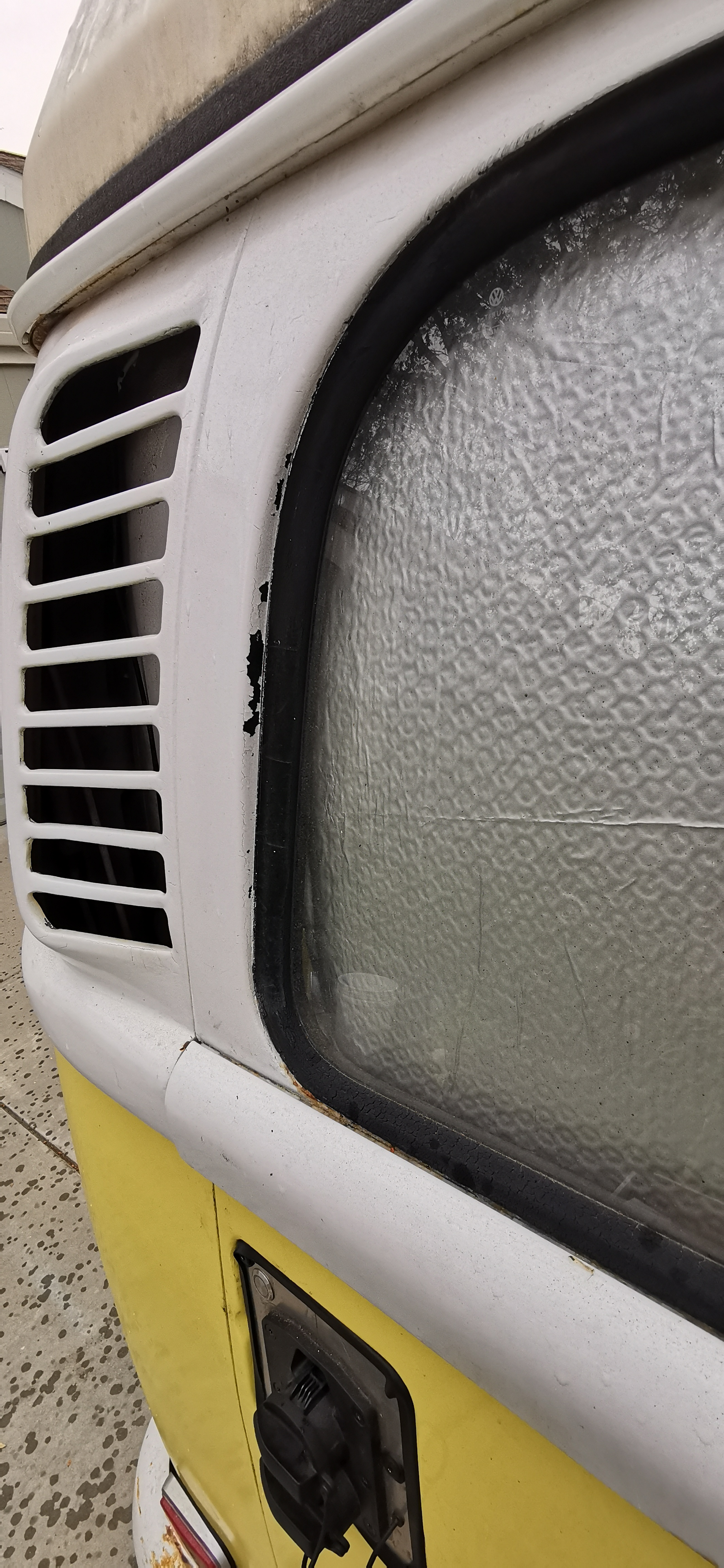

alexbeatle wrote: Wed Oct 16, 2024 6:16 am Radiator doesn't get enough airflow!?
Your radiator is mounted where? You realise any radiator needs air moving to remove heat. This is basic thermodynamics, mass to mass movement of heat energy based on delta temps.
What is the temperature delta across the radiator?

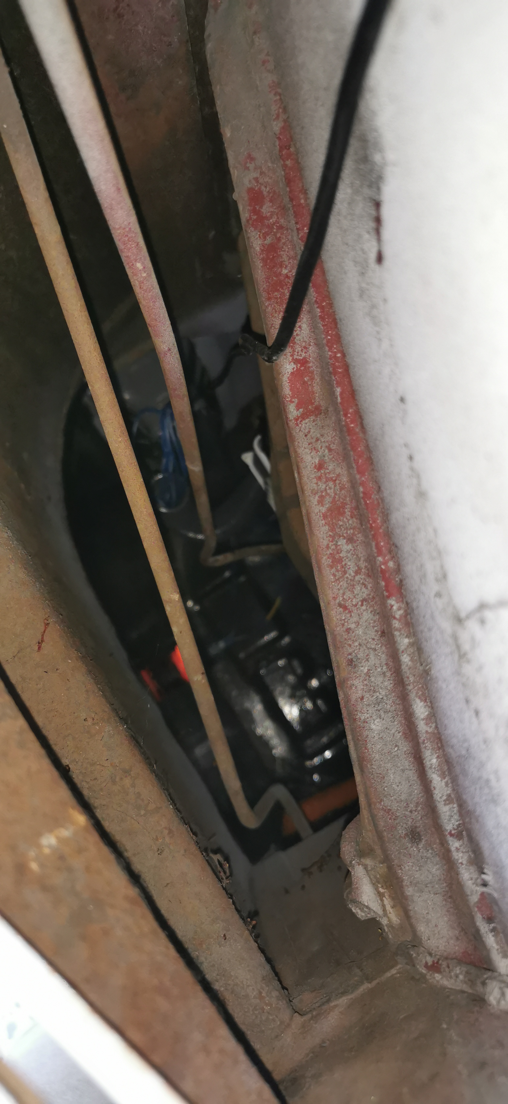

So originally vw t2 had no radiator at the front of the vehicle. It has these side ears that guide airflow into the engine compartment. I used that as the guide for mounting the radiator. The fan is meant to pull that air to assists air entering through those side ears. My thinking was that there would be enough airflow when driving at speeds >20mps, so do not need to run the fan.
I will add temp probes on the radiator to measure the temp.
Side ears and the air channel where the air is meant to travel down the engine bay..
Radiator and the bottom of the air chambers coming from the ears at the top...
This is how the radiator is positioned looking from under the car...

Really buddy, you every look at an "aircooled" engine. They are forced cooling. http://www.volksbolts.com/faq/cooling.htm

tom91 wrote: Wed Oct 16, 2024 5:31 pm Really buddy, you every look at an "aircooled" engine. They are forced cooling. http://www.volksbolts.com/faq/cooling.htm
Well this is embracing.. :oops: I must run the fan.

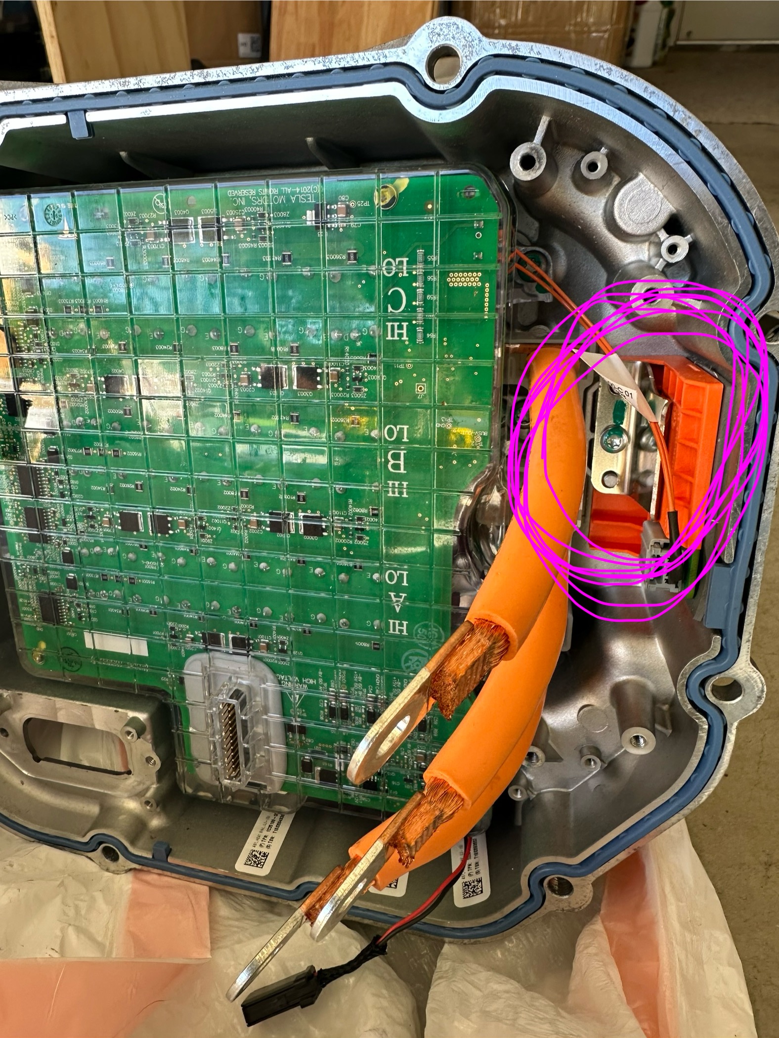

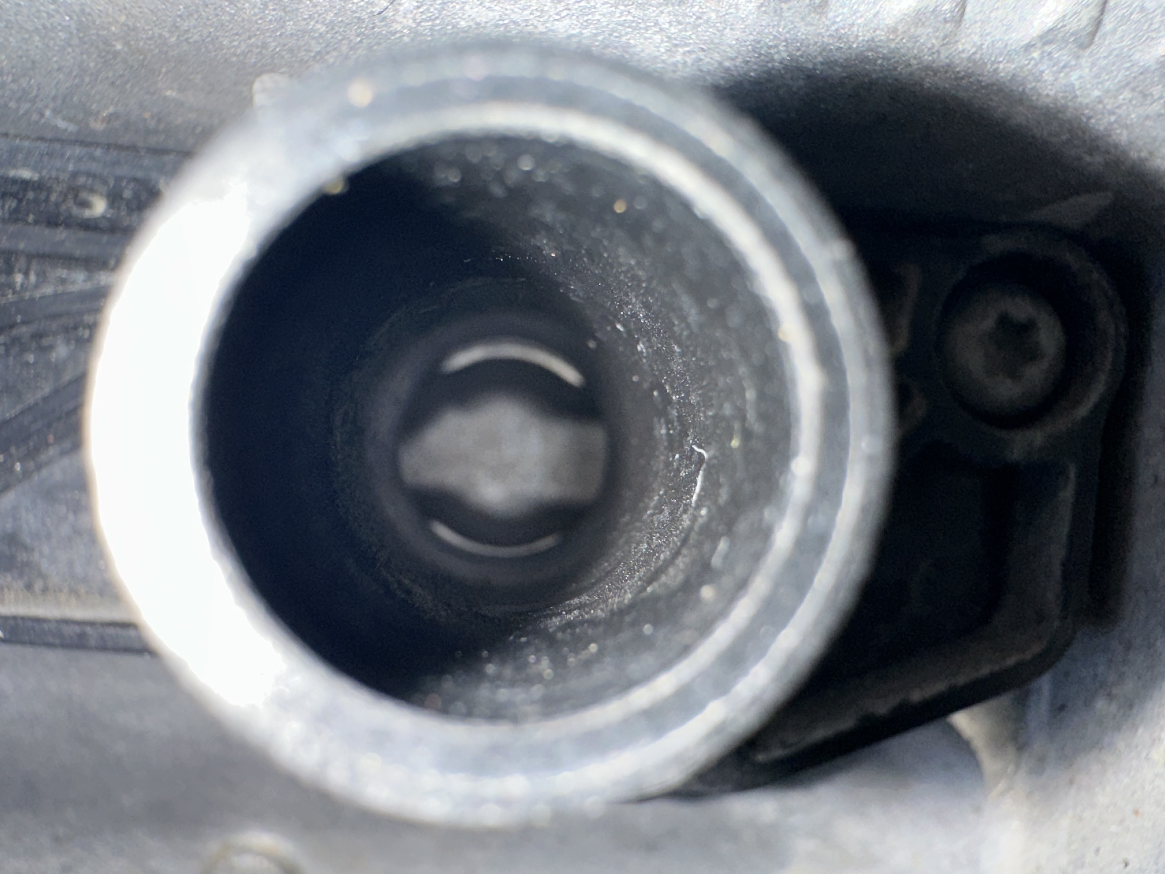

alexbeatle wrote: Wed Oct 16, 2024 6:16 am image.png

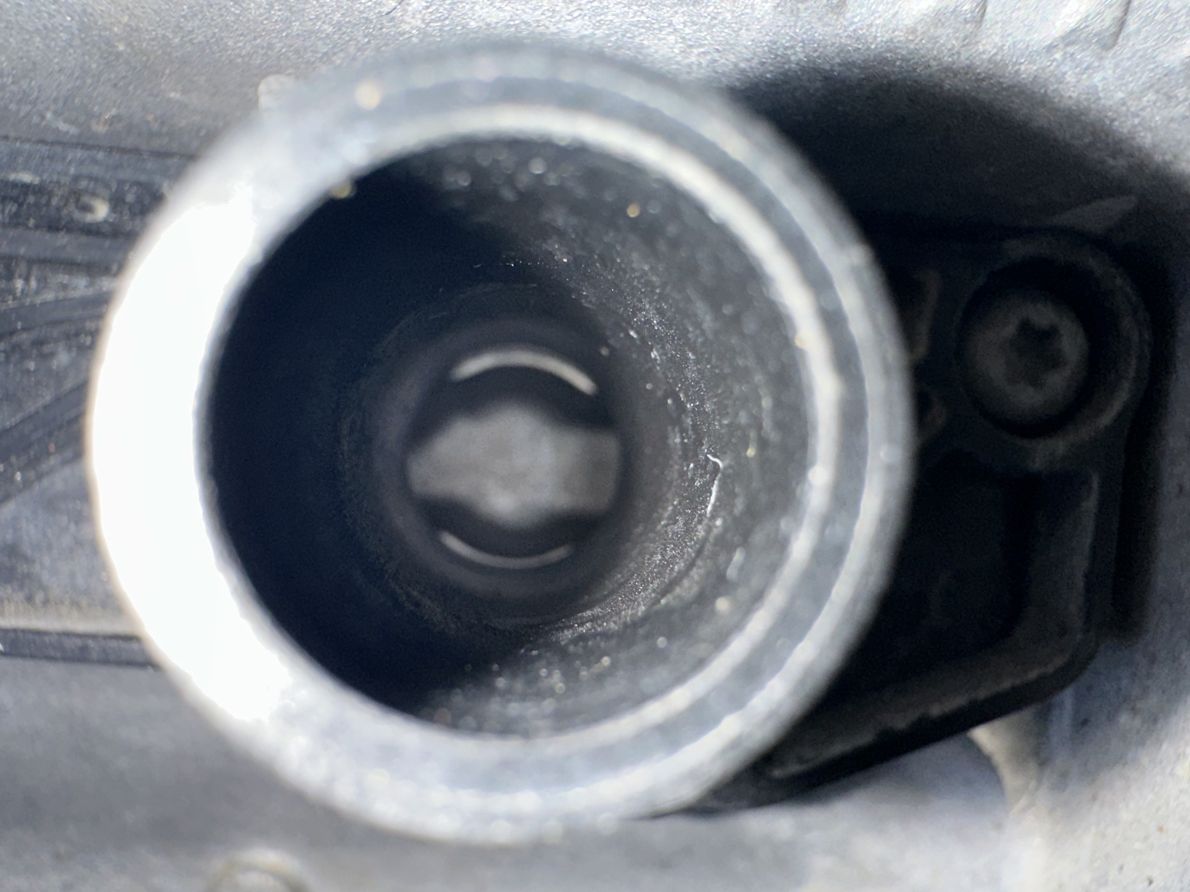

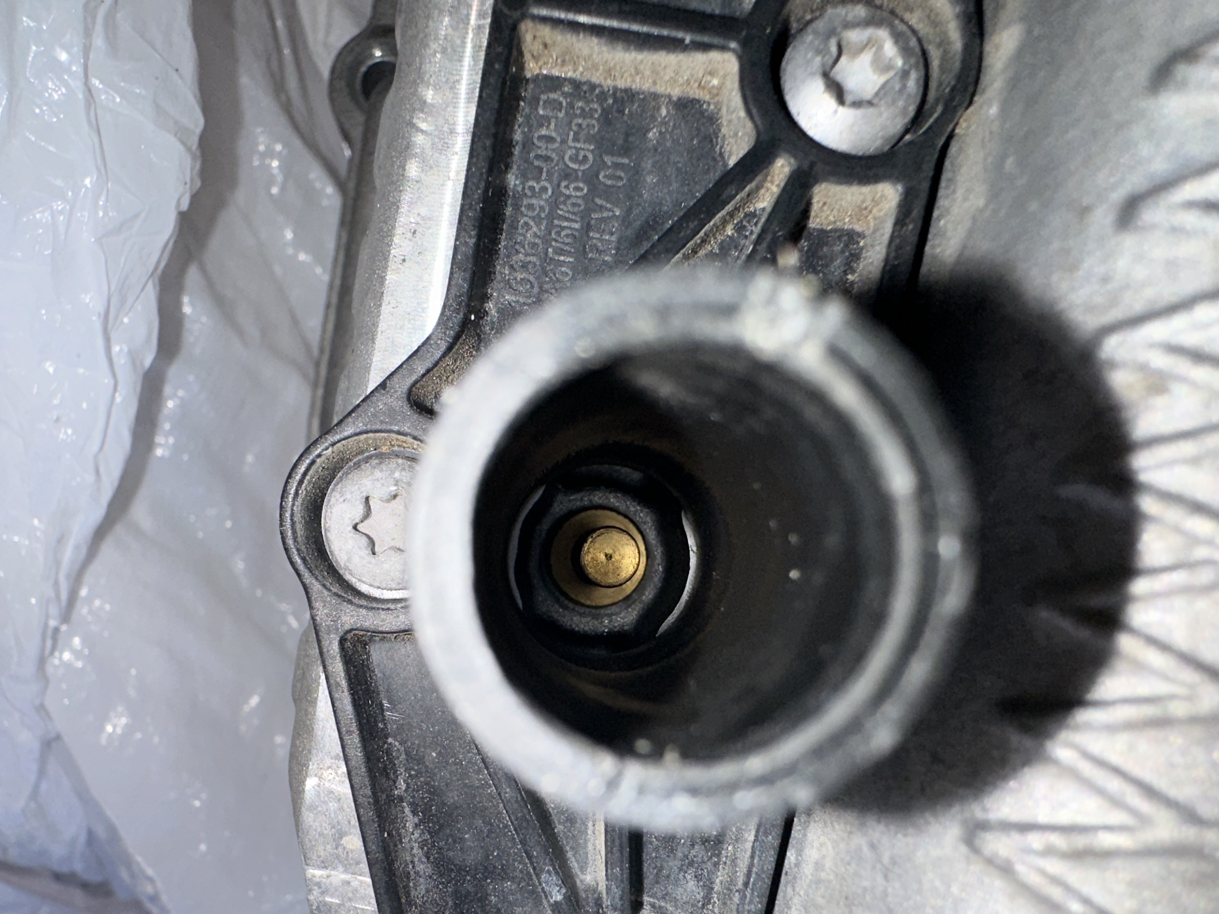

I believe this is the area that I refer to here that gets warm. Looking from the inside is that some kind of isolation monitor? Suppose to be warm?
I can see now why the inverter needs to be vacuum filled, there’s a section for the coolant that’s above the outlet port.
I can also see why the inverter would limit the coolant flow. Those are some hard turns inside past the inlet/outlet ports.
I’d be curious to know if anybody actually had luck with SDU coolant flow inverter -> gearbox exchanger, as opposed to to the way Tesla did it by splitting the flow.
The outlet holds the coolant sensor? I thought tmpm was reading the igbt temp, but actually this temp probe.
Been thanked: 1913 times
Re: SDU high current consumptions?
alexbeatle wrote: Thu Oct 24, 2024 6:19 pm The outlet holds the coolant sensor? I thought tmpm was reading the igbt temp, but actually this temp probe.
There are 3 IGBT sensors which we display the maximum of (tmphs). Then there is a fluid and a stator temperature on the SDU and we only display stator temperature (tmpm). So the fluid sensor is ignored.
