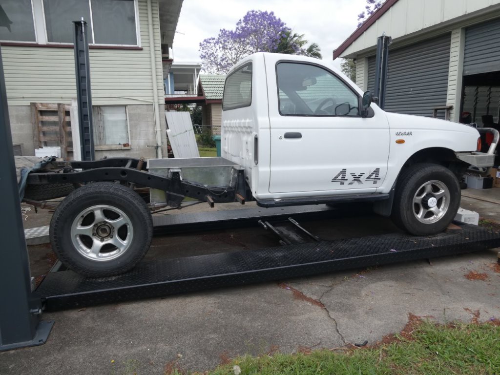

The solar Ute project is ticking along .... However I haven't installed the batteries yet.

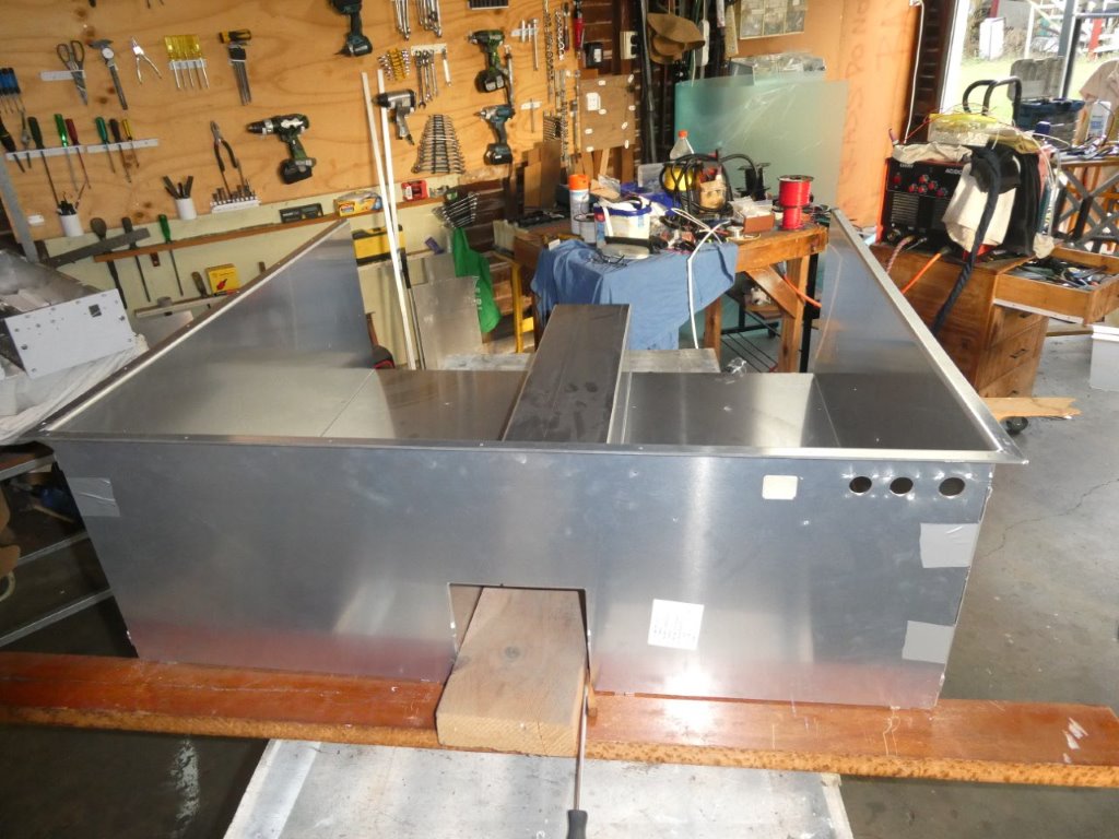

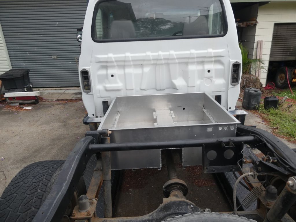

1/3rd - ish of the cells are going to be fitted in between the radiator and the motor. Construction of the 3 tier aluminium box has taken some time. The rest is going under the rear tray. The parts for the rear box are being laser cut and folded - ordered, should have it soon.
