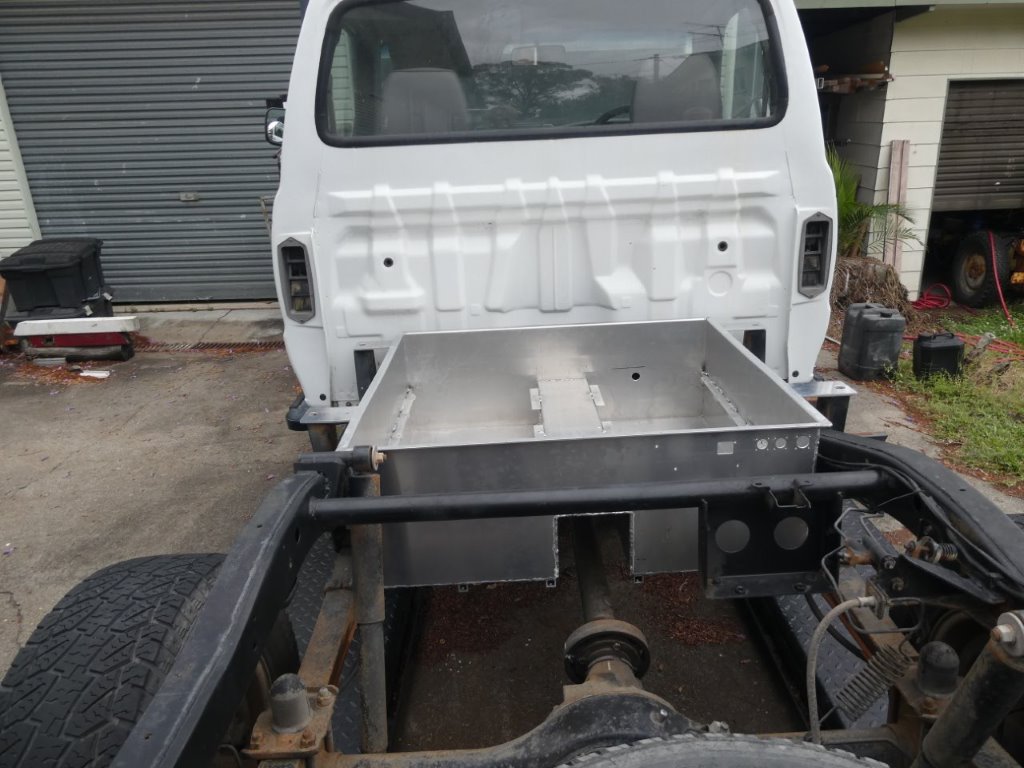

Getting closer. Fitted the rear battery box. Sits neatly under the tray. A few more gusset plates and we can start loading batteries. The Rear Battery will carry a little over 2/3rd of the total cells.
The cells will sit in 2 levels. The second level floor will also make this battery "Tank" more rigid
The tank was fabricated by Laser cut - folded mid piece with welded ends.
