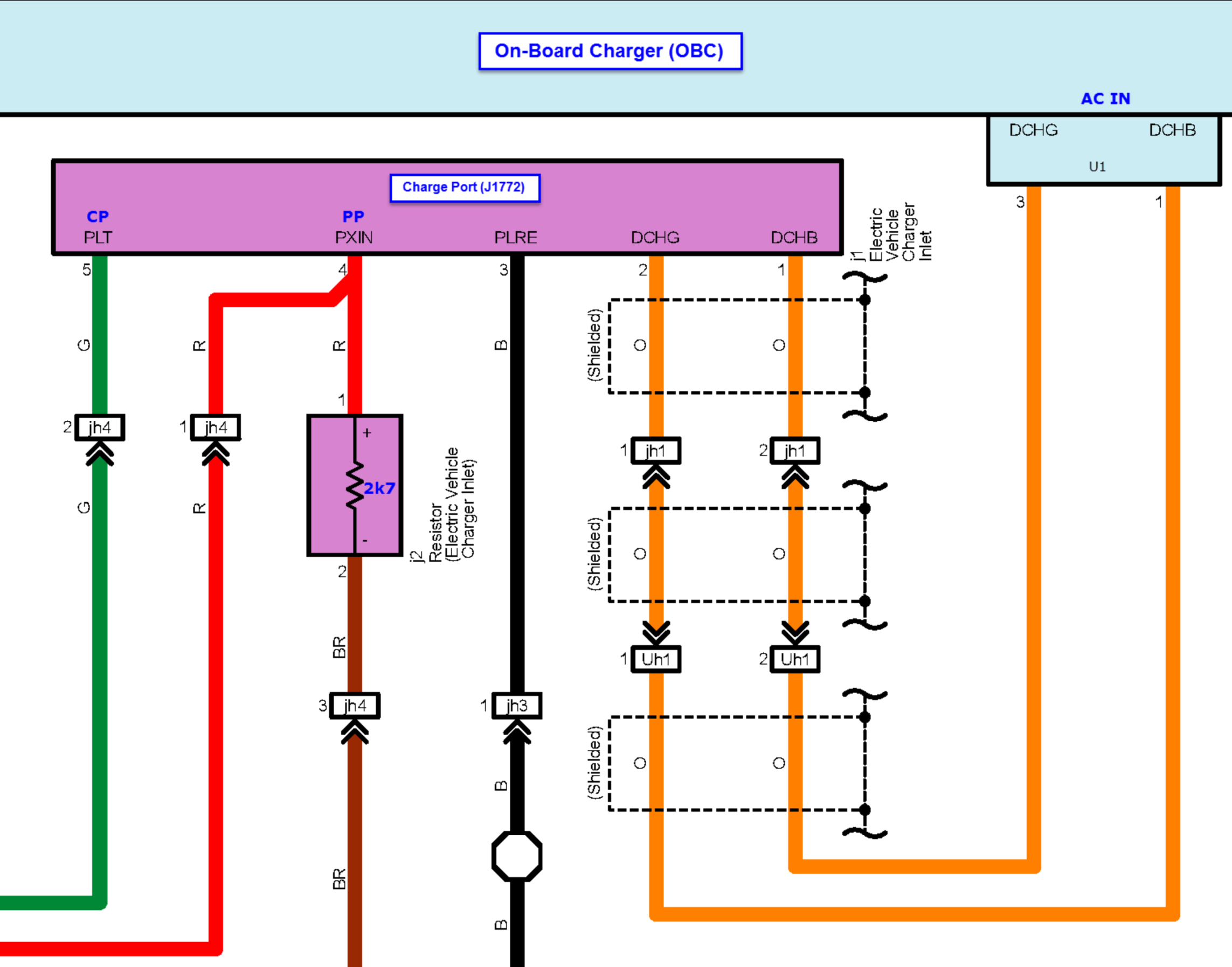

uhi22 wrote: Tue Feb 20, 2024 7:44 pm I made an interesting observation in my Ioniq: They use a shielded CP line from the engine compartment (where the OBC sits), to the cabin (where the PLC modem sits under the driver seat) to the charge port above the rear left wheel.
On my 2014 RAV4 EV, I'm reasonably certain that my CP line is unshielded; only the AC power inputs have shielding.
Rav4 EV Charge Port: unshielded CP & PP

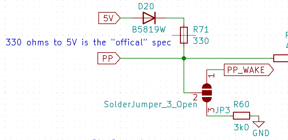

I think it's easy to allow both PP and CP wakeup. I really like Touran setup where PP inherently disables drive with no other communication needed.
I'll try to get rid of the 12V/5V PP solder jumper and just deploy a little always-on 5V LDO for PP pull-up and consistent resistance readings.

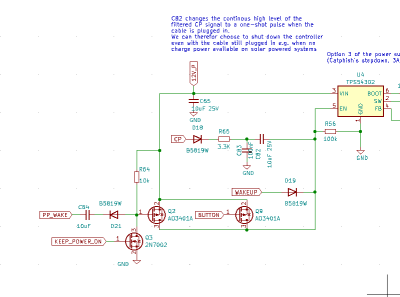

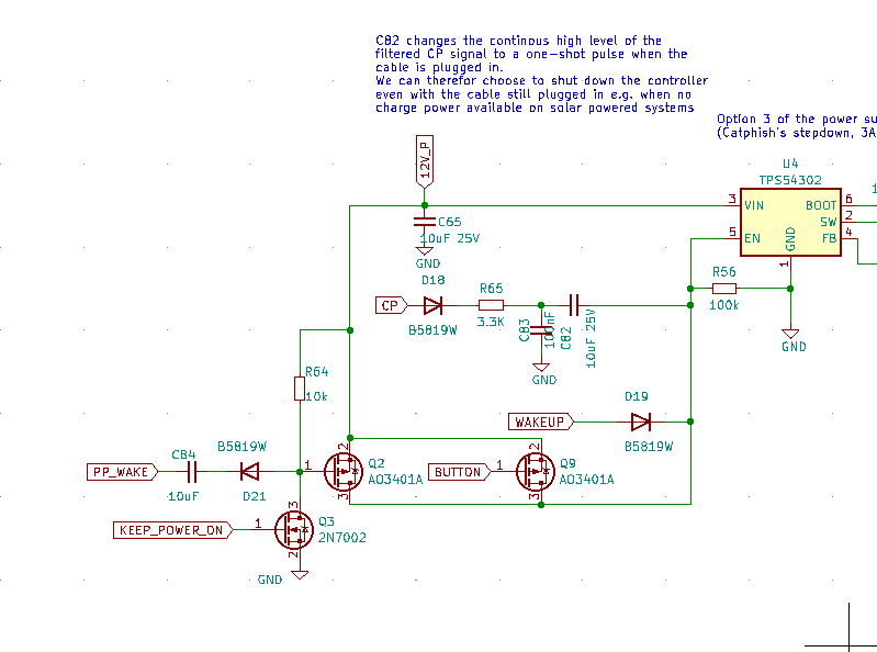

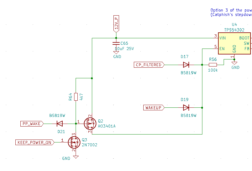

Ok, more woke design: (pun intended?)
We have 3 wake up sources
- 12V Wakeup
- CP
- PP
and actually 2 keep-awake sources
- Again Wakeup because it backfeeds
- KEEP_POWER_ON MCU signal
So quite simply an RC filtered CP will turn on the enable signal of the power converter. Likewise the 12V wakeup signal. PP on the other hand needs inversion, when PP goes low we turn power on. To not disturb resistance measurement with our 12V pull-up the latter is disabled once the MCU sets KEEP_POWER_ON.
The PP wakeup will only work if there are no permanent pull-down resistors anywhere in the loop. So you can either have PP wakeup or the mystery 3k pull-down:
Like said, I've haven't had issues without mystery pull-down so far
If we want the button as a wakeup source it needs to pull up to 12V instead of pulling 3v3 down to ground. What was the reason for the analog button again?

Just two questions:
1. Is the 100k pulldown on the EN of TPS inside spec?
2. Is the CP filtering designed in a way that it (a) does not disturb the CP levels too much and (b) deliver sufficient current to the D17?
3. Could ESD on the wakeup line kill the TPS? Same for PP and Q2.
Been thanked: 1913 times
Re: Foccci wakeup/sleep discussions
uhi22 wrote: Wed Mar 06, 2024 8:09 am 1. Is the 100k pulldown on the EN of TPS inside spec?
The internal pull-up current is about 1 uA if I interpret the data sheet correctly. The threshold voltage for disabling is about 1.2V. so 100k*1uA=0.1V -> good
uhi22 wrote: Wed Mar 06, 2024 8:09 am 2. Is the CP filtering designed in a way that it (a) does not disturb the CP levels too much and (b) deliver sufficient current to the D17?
Good question, made me realize I' forgotten D2. It does indeed skew the voltage a little, from 9V down to 8V at 5% duty cycle. At higher duty cycles or plain 12V the skew is less than 0.2V. Could be compensated for by making R26 slightly larger, like 3k3 to safely stay above 8V even at 5%. It shouldn't disturb HF because of the 3k3 resistor, so even if C1 is considered a short for HF there is still the resistor.
(100k parallel resistance configured for C1 represents R56)
uhi22 wrote: Wed Mar 06, 2024 8:09 am 3. Could ESD on the wakeup line kill the TPS? Same for PP and Q2.
Wakeup has a TVS. PP indeed doesn't have protection. Could add one of those double diodes to 12V and GND or just a 1uF cap to absorb ESD

We could retain that. Either pull up to permanent 12V (I quite like that the button pulls to gnd as that is found everywhere in the car). Or 12V input

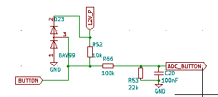

Finalized the design today. CP and PP wakeup ar momentary now and the button has been added as a wakeup signal.
Button is now pulled up to permanent 12V and has a voltage divider:

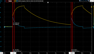

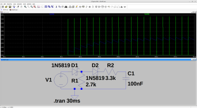

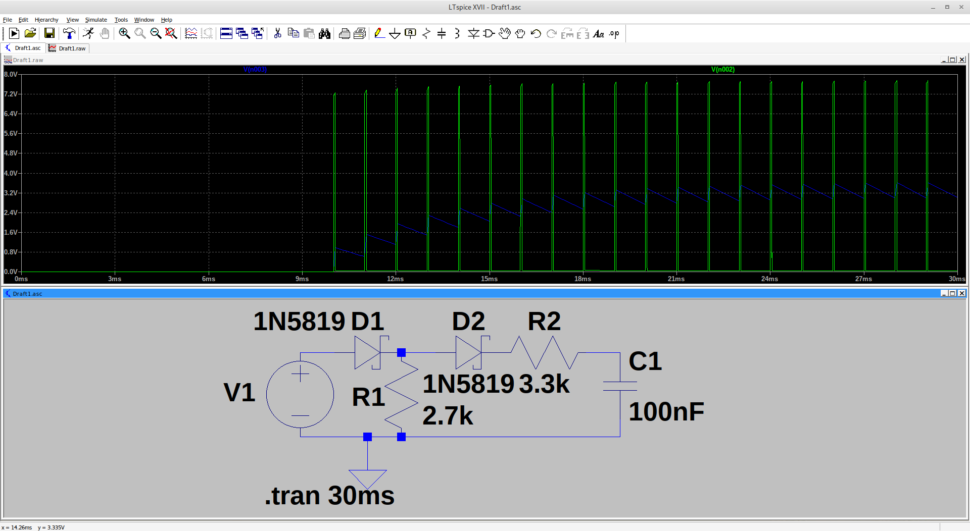

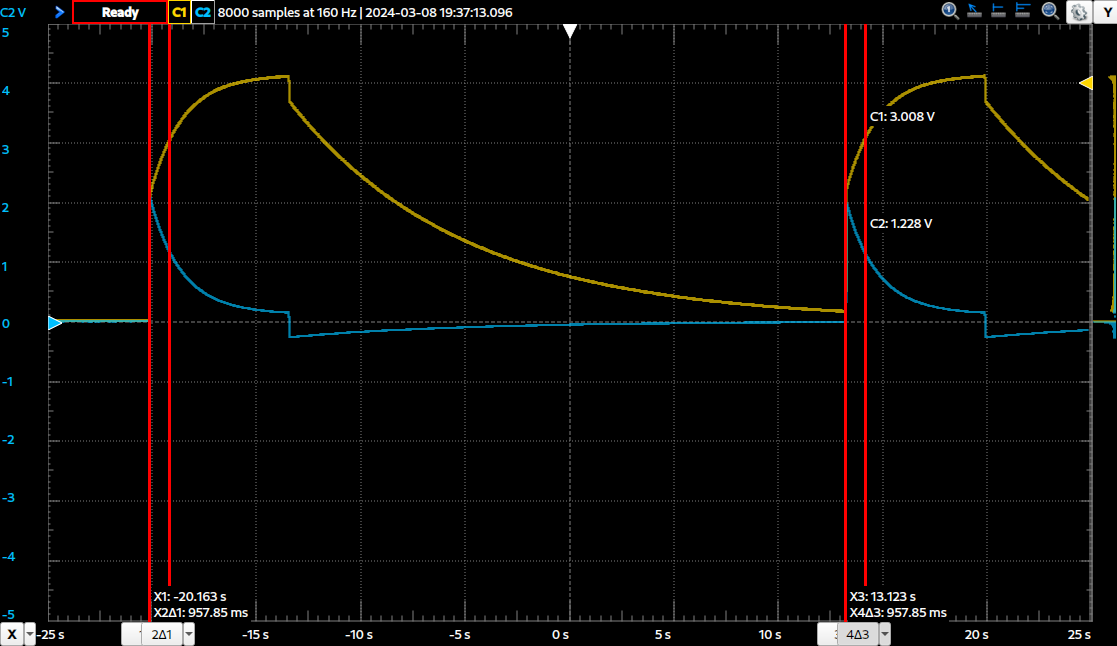

C83 needs a parallel 1M(or Higher), otherwise the CP wakeup will work just once.

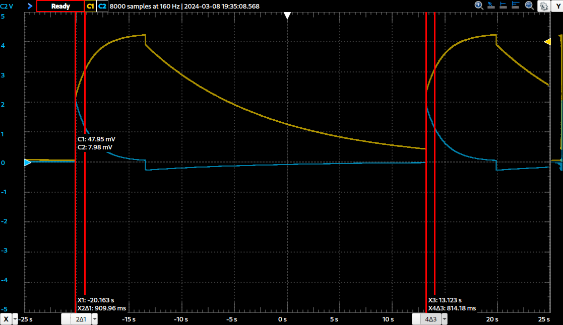

First I thought so too, but in ltspice it didn't simulate that way. Upon your comment I built the whole thing up on a bread board
Input is a 5% 1kHz +/-5V square wave that runs for 6.6s and then turns off for 27s
Yellow is the low pass filtered CP signal and blue is the 5V converter enable signal.
Without discharge resistor the enable pulse length (i.e. time the enable signal is > 1.2V) of the second enable cycle is 0.8s
Now I added a 2M7 discharge resistor across "C83"
This increases the enable pulse length to 0.95s on the second cycle.
Of course if you unplug and plug faster than that, say within 10s the second wakeup wouldn't go through. But that is easily solved by letting Foccci self-enable for 30s after each wakeup. Or rather after loosing CP or PP.
I think the explanation is that C82, C83 and R56 are all in series and each end is connected to GND. So once CP is gone, the series capacitor formed by C82 and C83 discharges via R56.
EDIT: now that I have the whole thing built up I also connected it to one of your Foccci boards and indeed duty cycle and PLC communication are not disturbed by it

The red point can only discharge, if there is a resistance to ground. E.g. the 10M of the scope input. Then it works. If no resistor is present, there is no path to turn the voltage down. Only leakage current, which is unpredictable. You could disconnect the scope while CP is at 12V, then disconnect CP, wait two minutes and re-connect the scope to the red point. The voltage starts at 12V and ramps down due the 10M of the scope.
oh that's why - Schrödingers cat ;)
Well I guess a 1M resistor won't have unwanted effects.
EDIT: just realized that PP_WAKE will never work because it is being slowly pulled down by the voltage divider to the µC
I have added the resistor and changed the PP wakeup back to permanent wakeup. So if you have a scenario where you expect the charge cable to be plugged in for many days you'd disable PP wakeup with the solder jumper and use CP wakeup instead.
