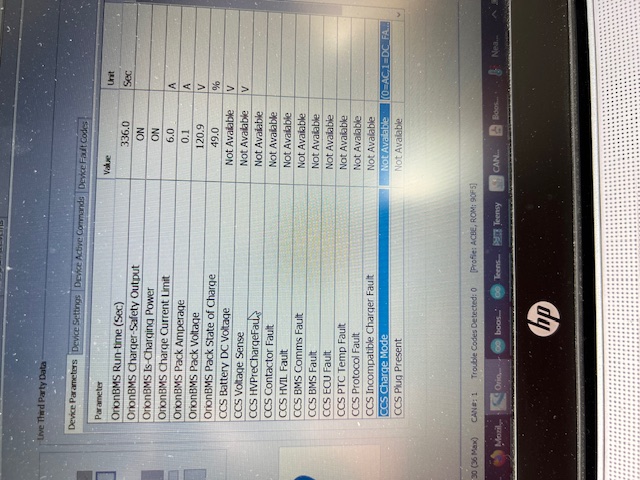

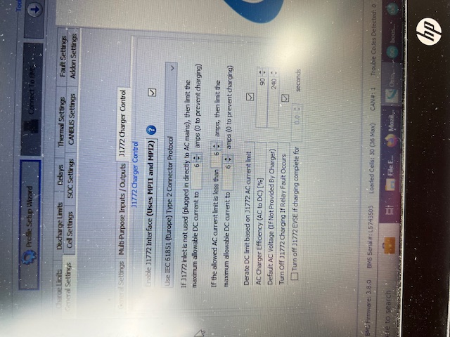

I cannot get this to work with my Orion. I have upgraded the firmware to v3.8.0 since 3.7.0 appears to have this functionality, and I've upgraded to the latest beta release of the software to try to find some options or details in the help files, but no joy.
According to the dbc file when the Fellten CCS profile is enabled, the AC Current Limit is bytes 1 and 2 in message 0x357 (set to be little endian) in the Can editor screen so I send xFF 00. I can see the message in the live traffic screen, and I can see the message count incrementing, and the message is getting cleared from the transmit mailbox in the software I am using (Flexcan_T4) so I think it's being ACK'd correctly and received correctly.
However it doesn't seem to affect anything - I was hoping it would set the Orion into 'Charge Mode = DC' as per pic below.
Secondly, my Orion is configured to use J1772 for type 2 charging. I want to keep this, and have a second charge port for CCS, hence the above. However as soon as I put the Orion into Charge mode by supplying 12V, it immediately reduces the CCL to 6A and reports 'CCL reduced due to J1772' (or similar) regardless of the x357 message. (The 6A is just the value set in the next screenshot - I could set it higher (say 100A), but I have a max DC current when charging of 60A for 6.6kW charging, and the Orion then takes that as absolute max value).
So it looks like supplying 12V to charge mode simply puts the Orion into either J1772 if CP/PP is correct, or, a CCL limited state. Clearly the 0x357 message isn't being accepted to put the Orion into Charge Mode = DC (nor AC - it says 'not available' in the screen shot).
Any ideas gratefully received, I've tried everything I can think of.

This cannot be done with the using of the Fellten CCS setup. Most likely changes things in the background to allow this to work.

I don't suppose anyone knows if the Orion can have the J1772 protocol and the Chademo protocol enabled at the same time?

I have Orion with a J1772 and CHAdeMO plug that both work... but I'm not much of an expert so if you need any more info you'll probably need to spell out exactly what you want.
Re: Orion BMS and CCS
Thanks for the confirmation that both can co-exist. I was fairly sure they could, but I'm struggling to find out how the Orion should be configured to have them both enabled.
Do you know what the Max Amperage When Charging is set to (in the Charge Limits tab)?
Do you know what the Max allowable DC current when not using the J1772 inlet is set to (in the J1772 Charge Control tab)?

125AMoonUnit wrote: ↑Sun Aug 11, 2024 1:06 pm Thanks for the confirmation that both can co-exist. I was fairly sure they could, but I'm struggling to find out how the Orion should be configured to have them both enabled.
If not, no worries, thanks anyhow.
127A
125A was chosen as it matches the output current of the 50kW public chargers CHAdeMO output that I use this car with. BTW this is with a 110V nominal setup (Hyper9 and 5 x Tesla modules). The CHAdeMO only works on certain make/model of DC chargers that go down to 50V, the most common being the Tritium RT50.
