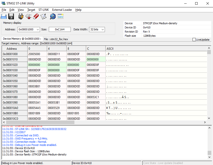

Yes, the ST-Link reports Flash size is 128KBytes (see attached pic), and I am indeed disconnecting the ST-Link and restarting the board before accessing the web interface. The red LED is flashing, which I thought indicated the STM32 is running properly, but maybe that isn't always the case. Yet when I connect to the web interface it is void of any parameters, I cannot seem to load any, nor start the inverter.
I'm flashing the v5.24.R release of the stm32_foc.hex asset found here: https://github.com/jsphuebner/stm32-sine/releases. I noticed the name of the asset doesn't seem correct since as you said, it's not FOC but Sine. Is this just a simple typo, or am I flashing the wrong firmware?
FWIW - I encountered a similar behavior a few times before while installing a V7 board. I was working on the wiring harness, and "all of a sudden" the interface stopped auto-updating. When I hit refresh all the parameters were gone and I could not load them or start the inverter. The inverter was basically non-responsive until restarting it, which fixed it and all the parameters were back. I chalked it up to me working on the harness since once I had everything wired up and running properly I haven't seen it again.

Doesn't look like the flash size is you problem so the other thread isn't relevant.
