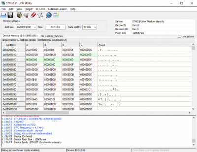

Yes, the ST-Link reports Flash size is 128KBytes (see attached pic), and I am indeed disconnecting the ST-Link and restarting the board before accessing the web interface. The red LED is flashing, which I thought indicated the STM32 is running properly, but maybe that isn't always the case. Yet when I connect to the web interface it is void of any parameters, I cannot seem to load any, nor start the inverter.
I'm flashing the v5.24.R release of the stm32_foc.hex asset found here: https://github.com/jsphuebner/stm32-sine/releases. I noticed the name of the asset doesn't seem correct since as you said, it's not FOC but Sine. Is this just a simple typo, or am I flashing the wrong firmware?

Doesn't look like the flash size is you problem so the other thread isn't relevant.
You probably need to go back to an earlier version (5.00??) to find a pre-built version of the sin code (the only recent changes have been to the foc version). Also worth checking catphish's current control code if you don't need regen (viewtopic.php?t=3086).
