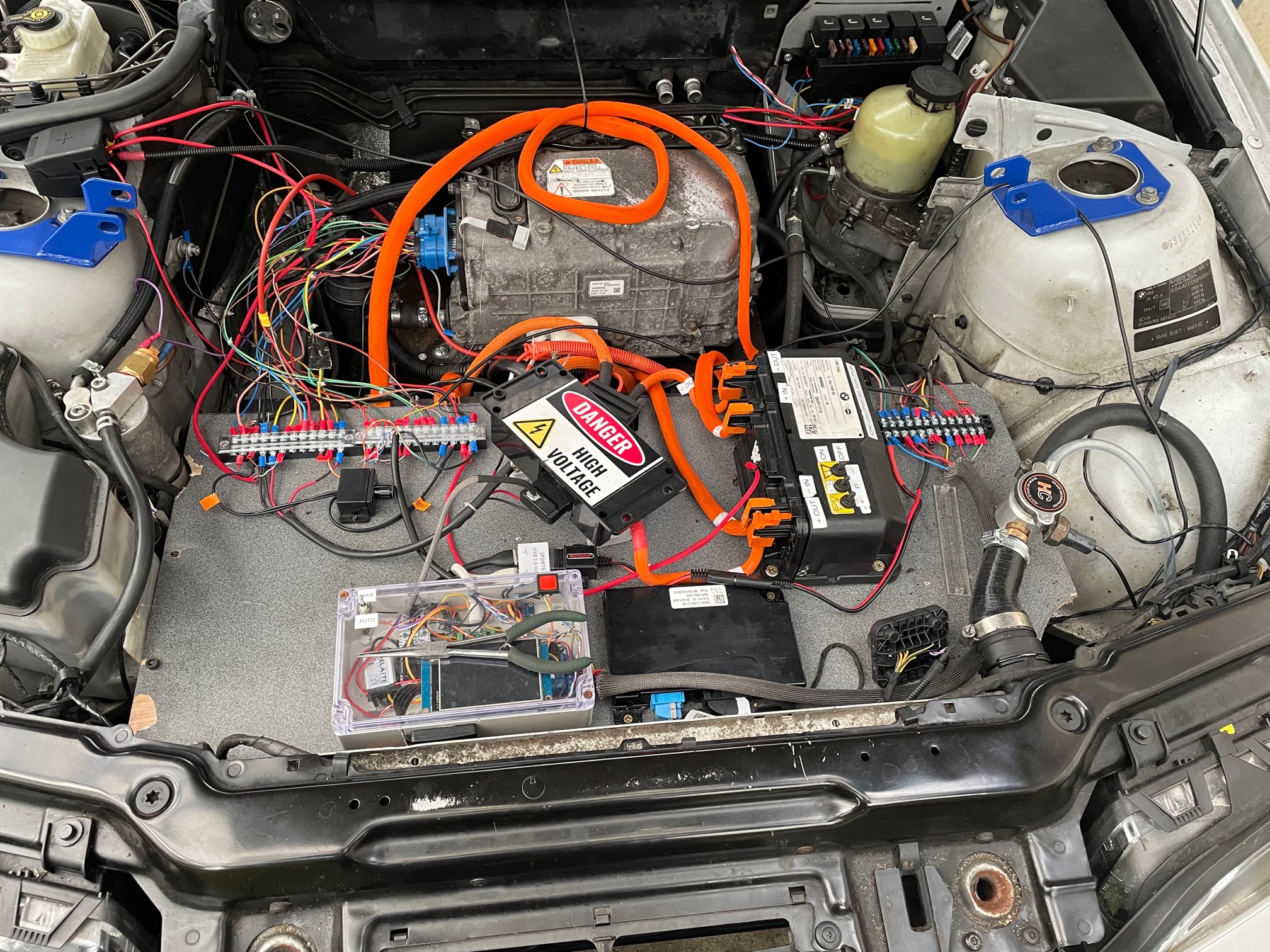

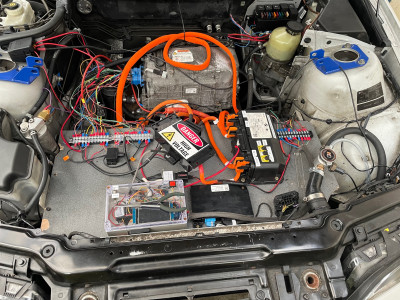

Under-bonnet as it stands. still awaiting some some bits to go back in and wire tidying once it's all completed. That HV cable needs to be the right length also.
It's 3 levels, lower level is 2 x 60v packs plus the charger, second level is 4 x 60v packs, top level as shown.
The black box to the right is the original BMW contactors repurposed with manual switches at the moment for peace of mind isolation. The contactors under the High Voltage warning are controlled by position 1 and 2 (ign) on the key.
BMW BMS is installed but not hooked up in any way as yet, plus SOC needs calibrating etc. Small pot in black box currently used to set regen level.
