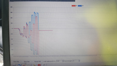

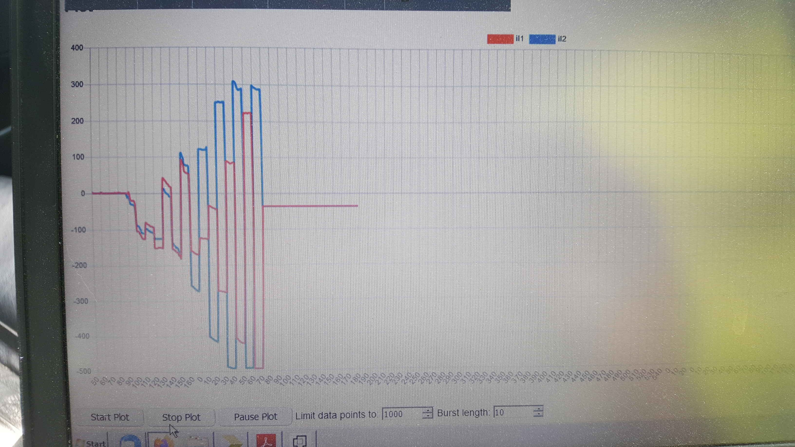

Re: The LandYacht BMW E39 Saloon
Siemens motor now spinning in the E39 using the Prius Gen 3 MG2 power stage.
So of course I selected 5th gear, pulled on the brakes and wound on the power. MG2 shuts down at 500amps peak. That's around 350amps rms. Even in 5th with a 530d drivetrain, brakes on and the wheels chocked she was creeping forward.
Nice!
How do you end up figuring out the max safe Amps to set for the long term? Watching temperatures? 500 Amps is fun, but only if you can do it more than once.

- Posts: 656
140kw of pure torque... Nice!
I'm almost ready to run my Siemens motor, could you share your parameters when it's convenient for you? I have no experience with tuning induction motors and I'd like to have a baseline
Thanks!
-Isaac
Params attached. Very early stage of tuning.

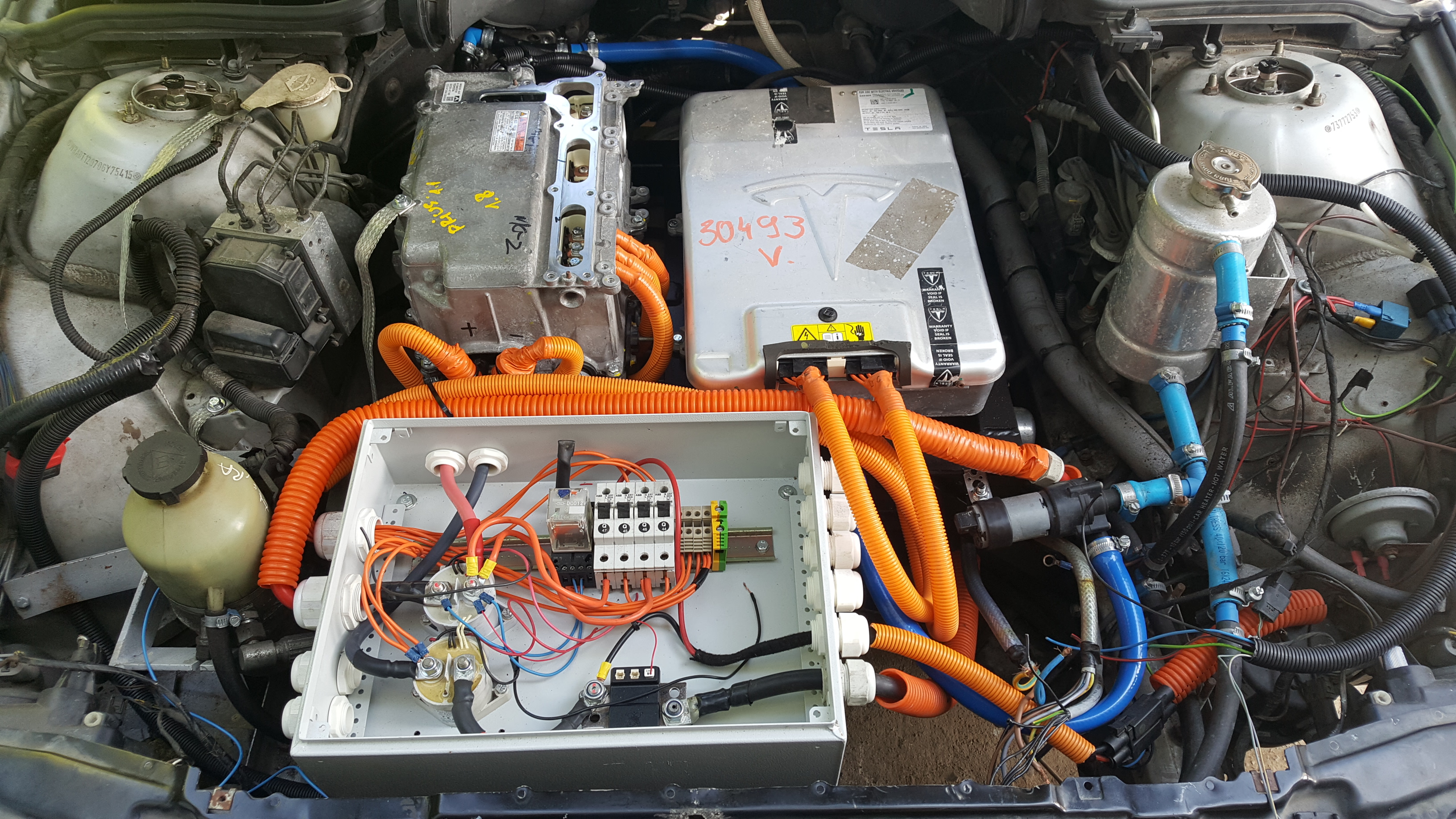

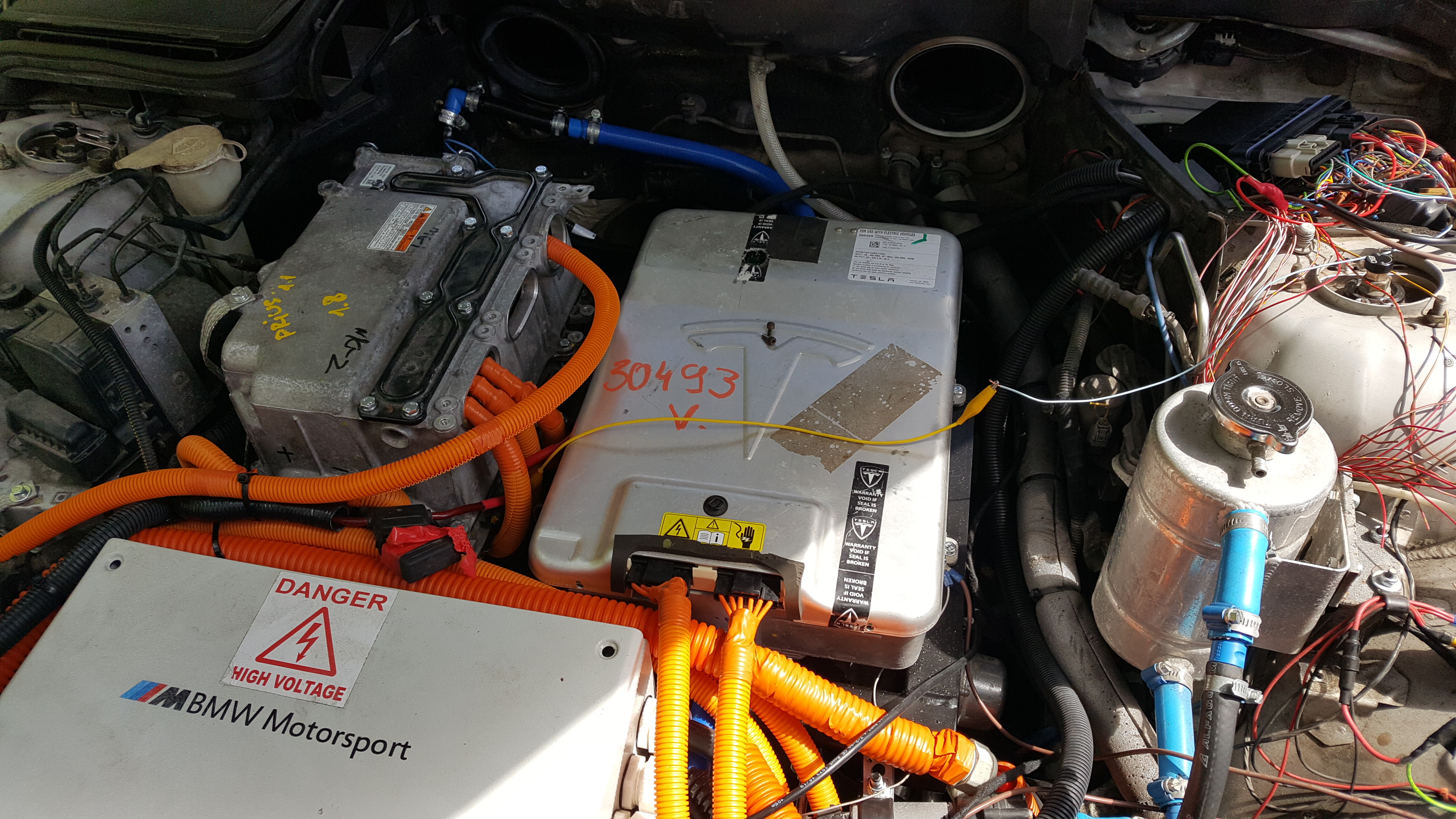

In other news got the Tesla charger and V5 logic board running today. Seems to be a few bugs in the code still but with an actual charger running in a car will make it easier to hunt down.

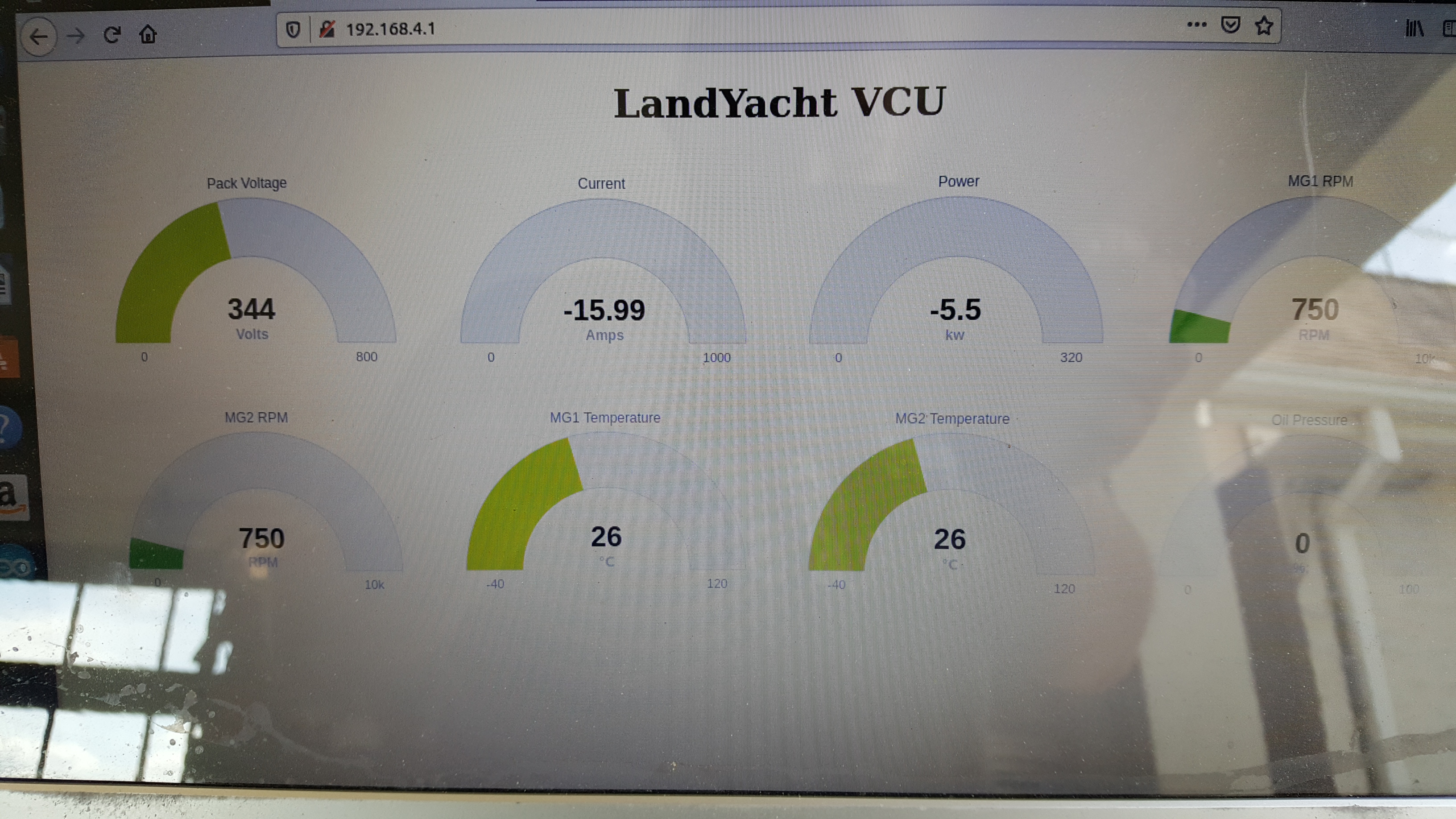

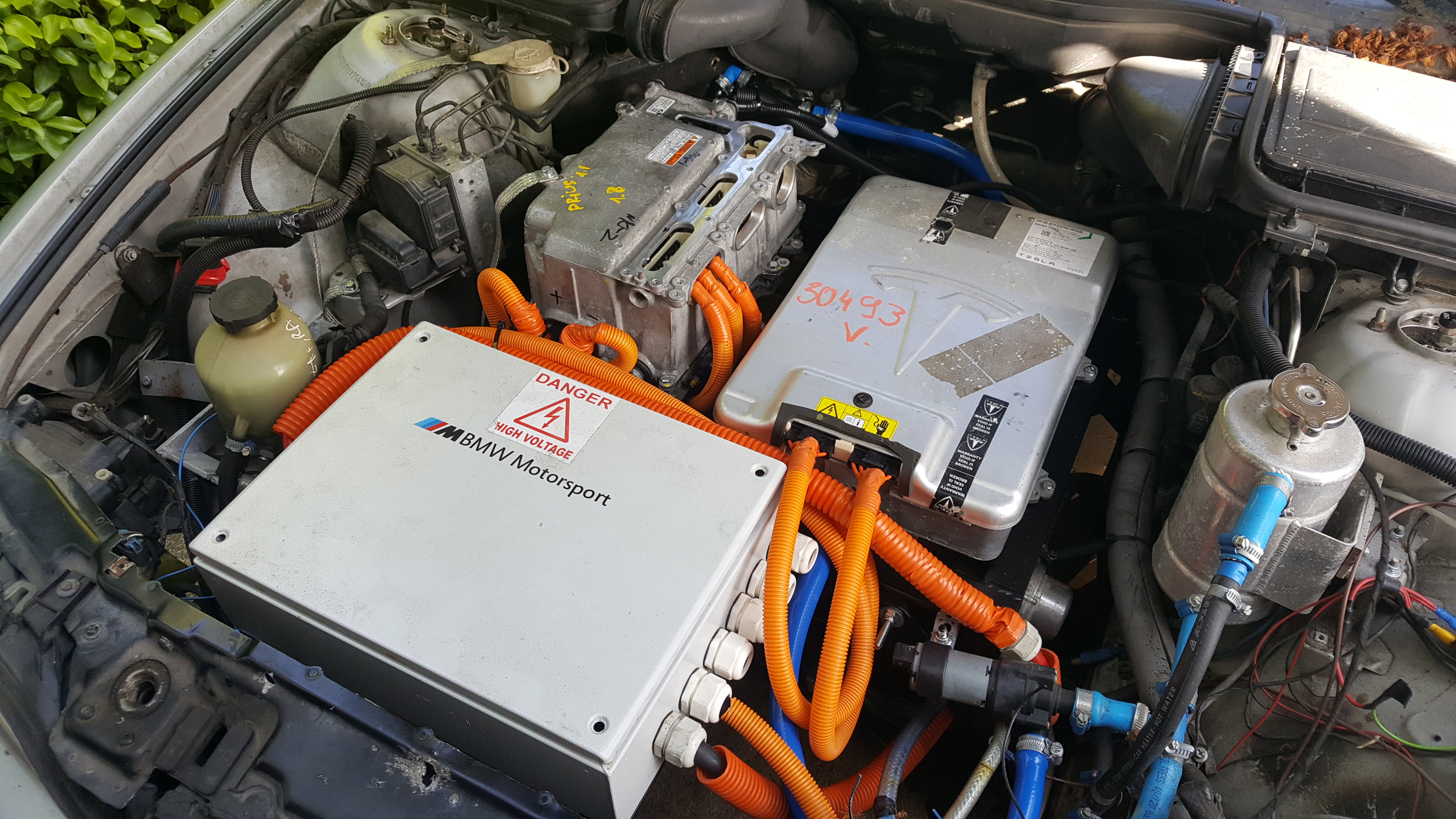

Drove 18 miles today mostly around town but some 60mph sections. Absolutely no problems and inverter stone cold after the drive. I have the temp gauge driven by the mg2 temp sensor over can with around 50c as the top of the "red" zone. It gets up there when using very low throttle say pullling out of a junction but as soon as you give it some pedal the temp drops right back. It also drops back very fast on release of throttle. When cruising at 60mph and using around 10kw it stays in the blue. Next up will be a motorway drive.

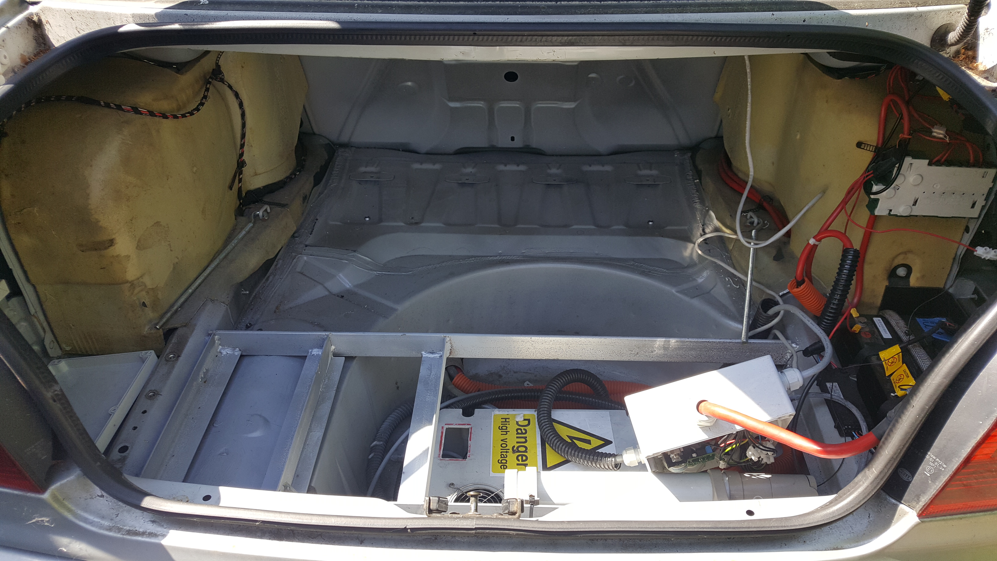

How is the single string of modules holding up under load and what sort of range are you estimating from the 9Kwh pack?
- Posts: 4000
- Been thanked: 1114 times
Battery is having no problems so far. 11mv max difference in the cell voltages after the drive. No idea on range as yet but I've just done a day of errands including hauling 2 huge wheels from the deranged rover to get tyres so I really don't care

Bit more driving around this morning in the E39. Did a few acceleratoins with measured 70kw on the battery side. No problems. Got one desat event when I tried to be a hero and pull away in 4th. Restarted and drove away in 3rd. Looking very promising so far.

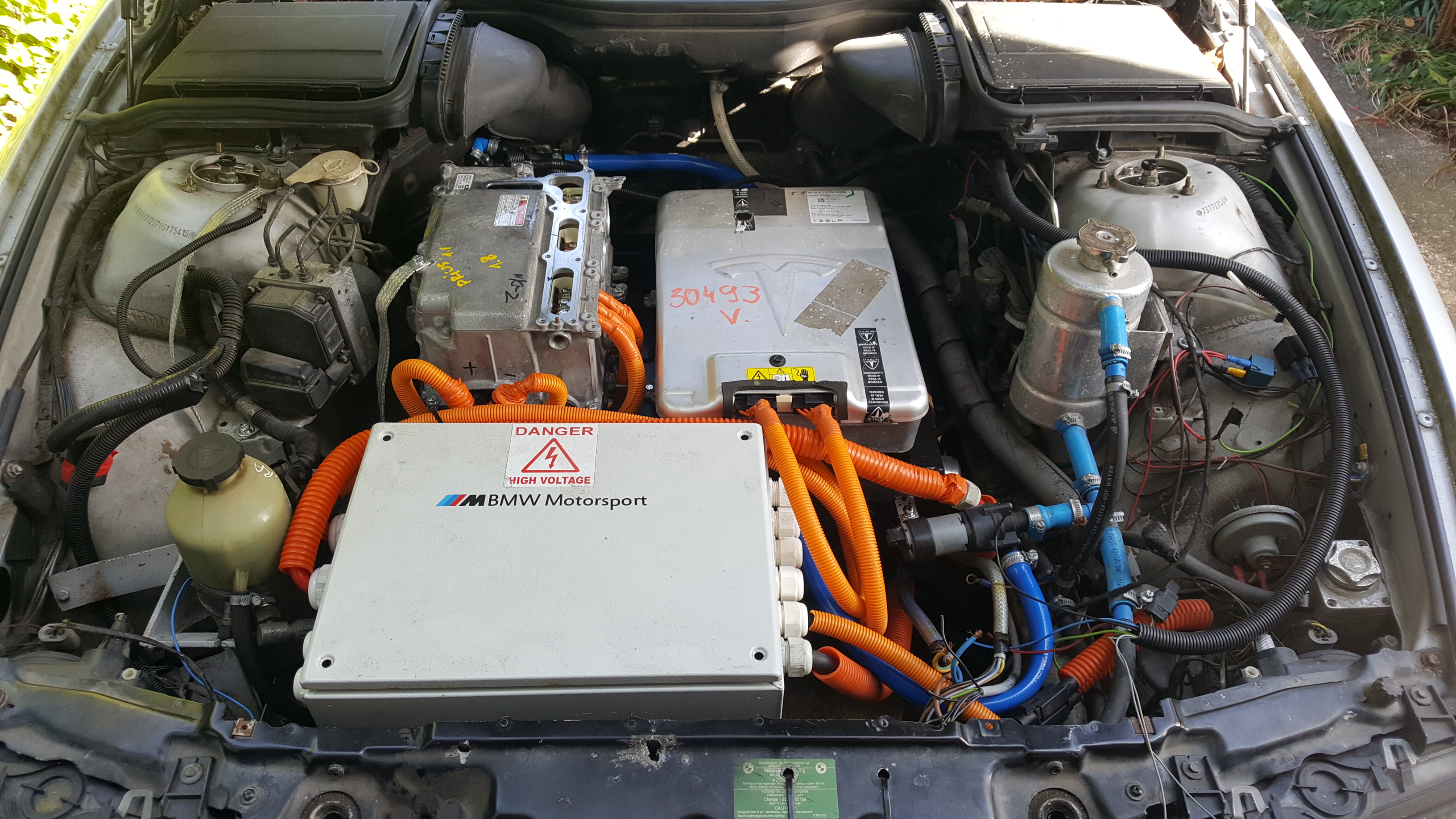

Took the E39 out on the motorway today for a little over 10 miles. Cruised at 70-75mph , 4th gear, 4500rpm. 12kw for level road raising to 33kw for a steep hill for little under a minute. while holding speed on the hill the mg2 die temp raised to 45c. Level cruise 30c approx. Peaked at 76kw accelerating out on the slip road. No desat events. I'll shoot some video when I get a chance.
So, its looking increasing like the Gen 3 Prius MG2 power stage is indeed capable of propelling a road vehicle. Once I get the firmware for the V5 tesla charger board working properly I'll pull the tesla charger and set up mg1 and some contactors for battery charging.
