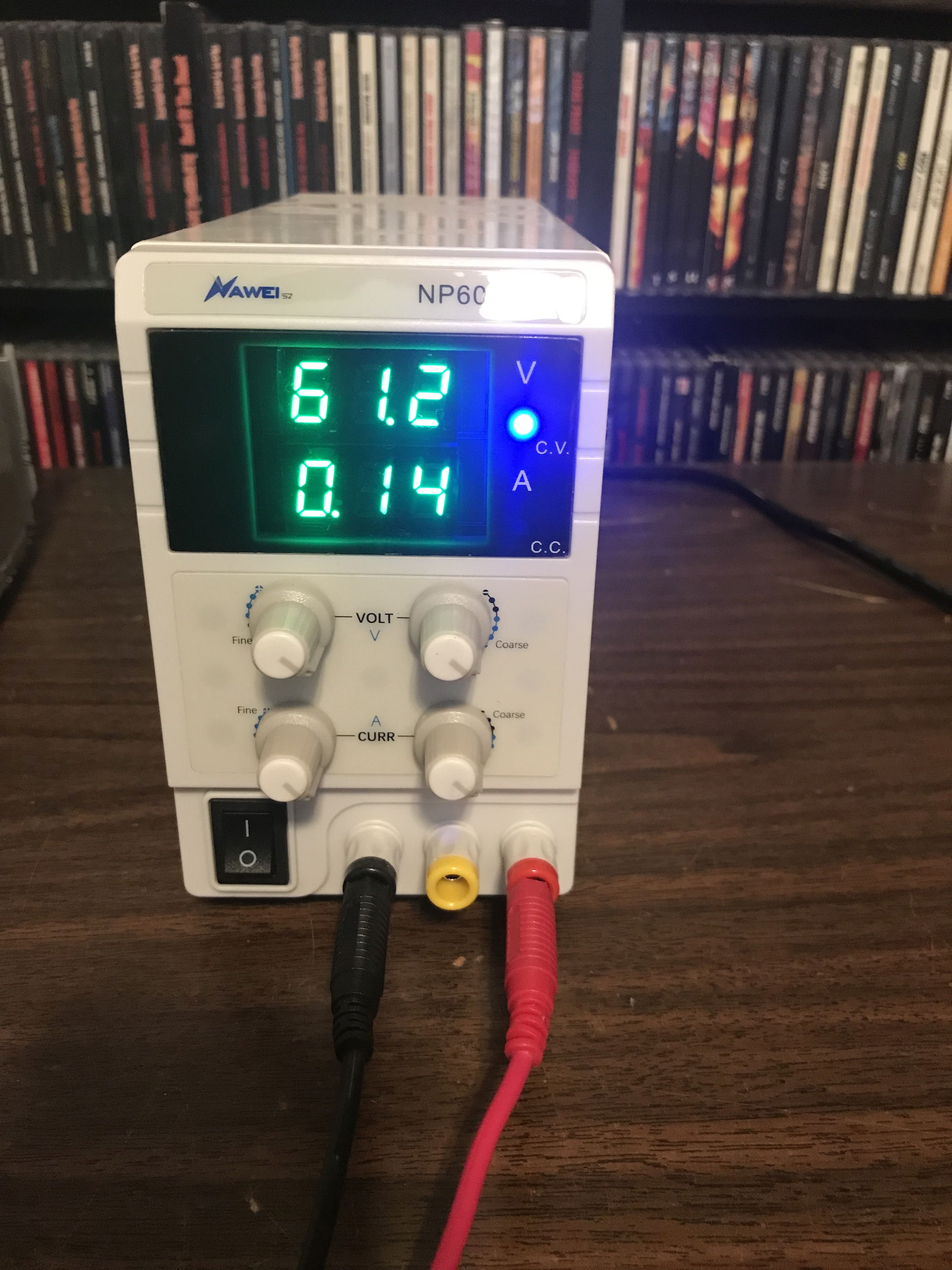

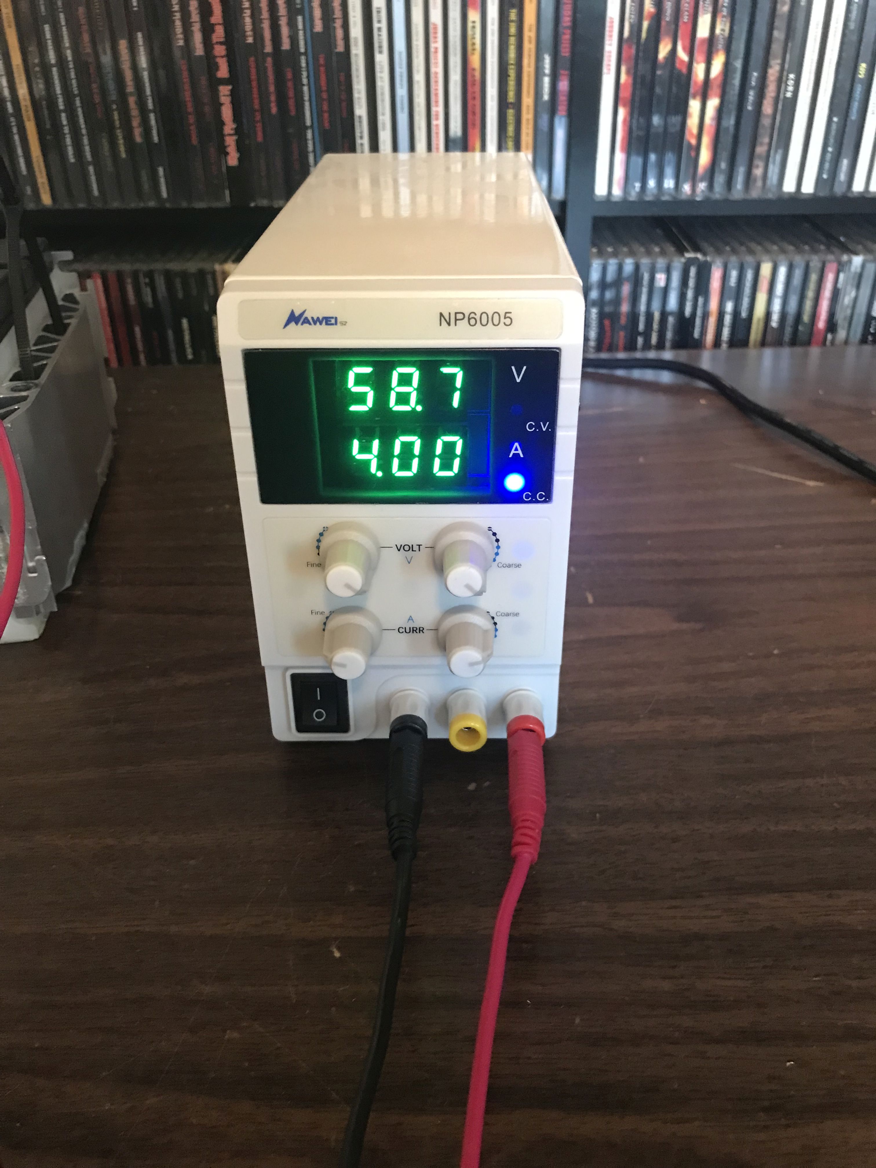

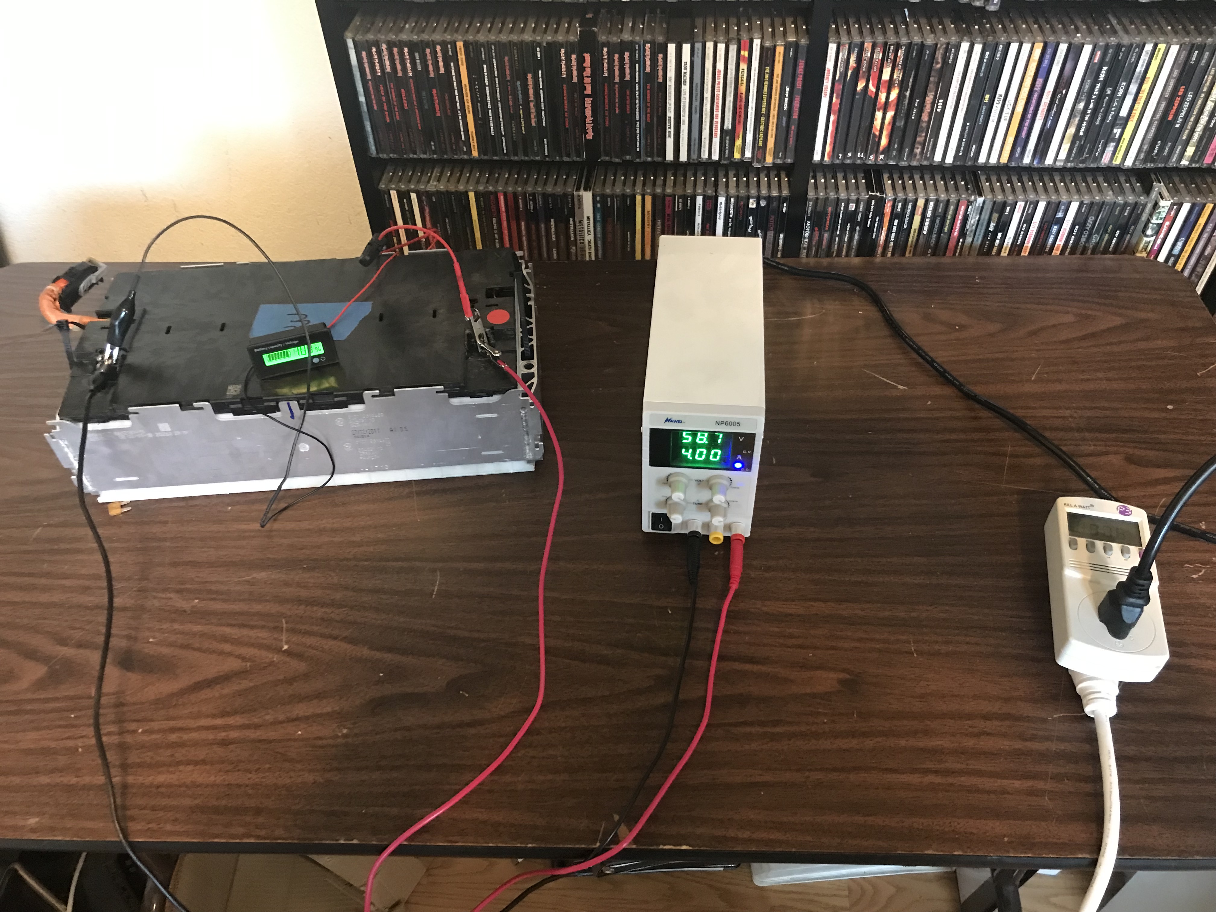

and just for completeness here is what it looked like set to a hard 4 amp DC limit

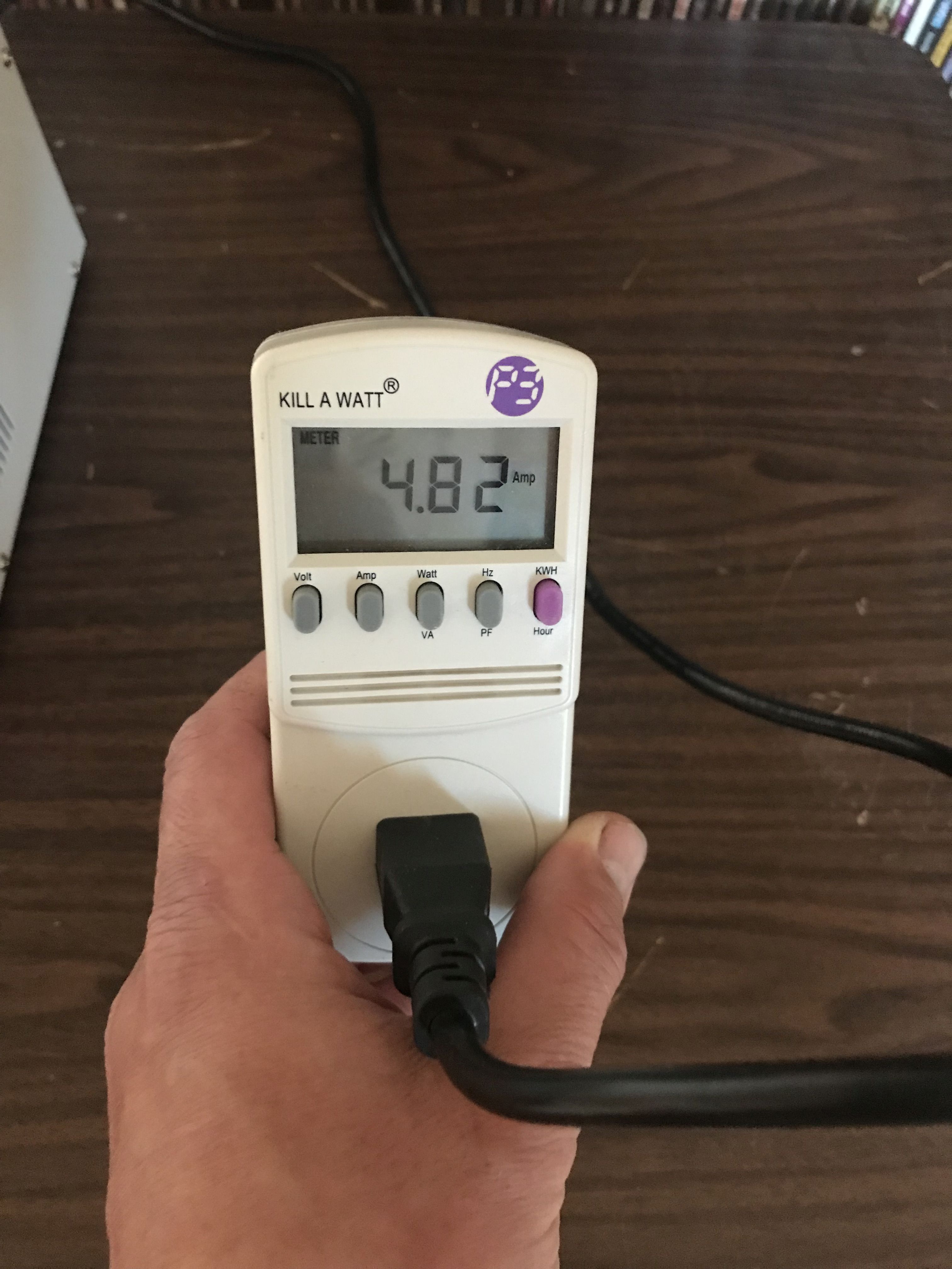

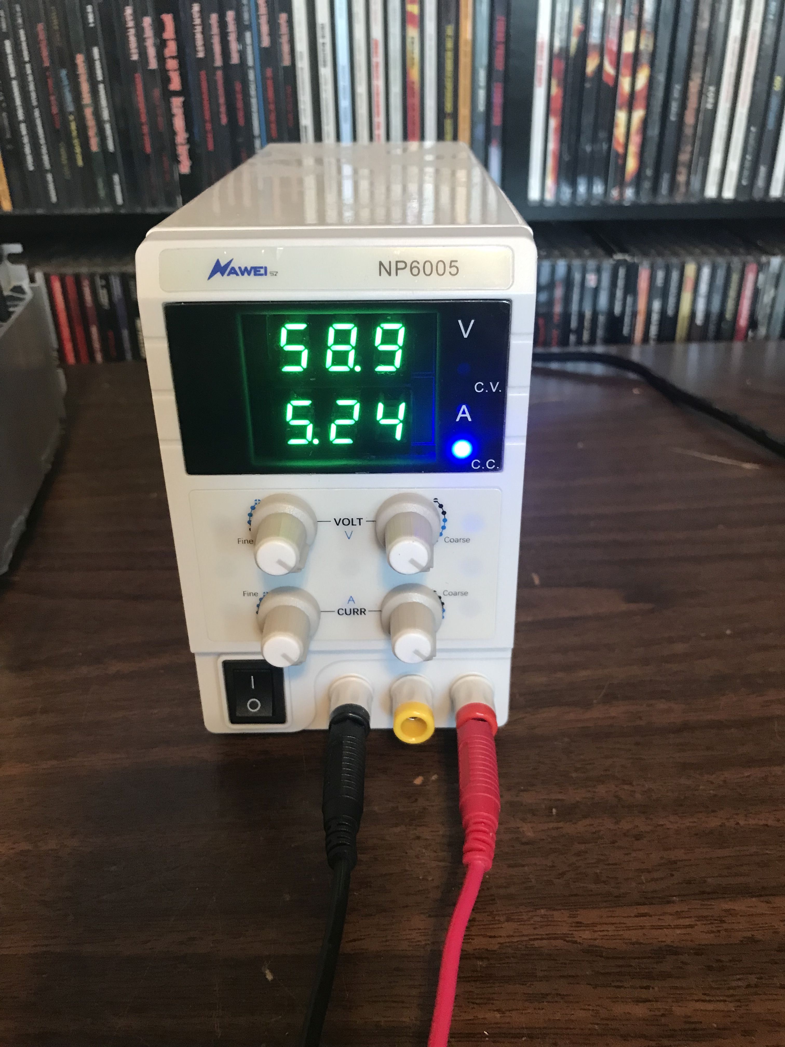

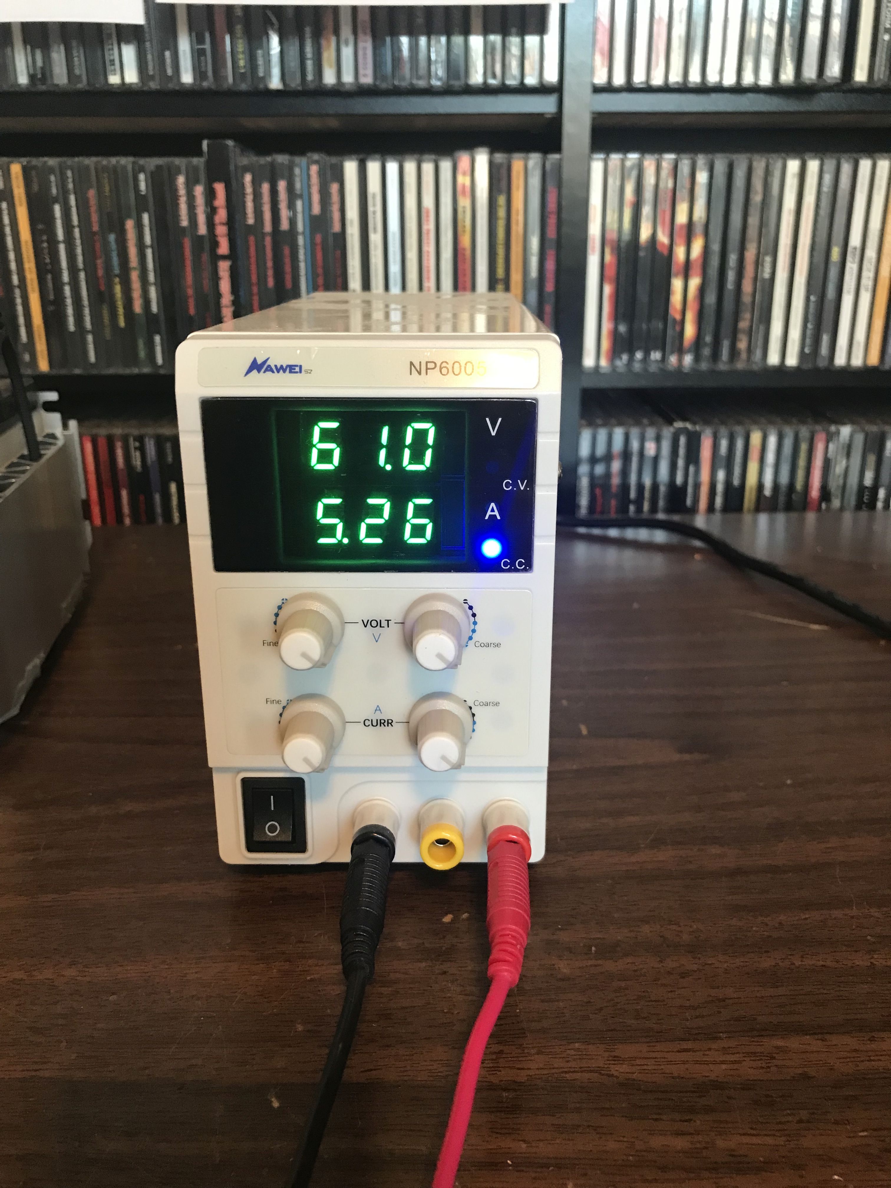

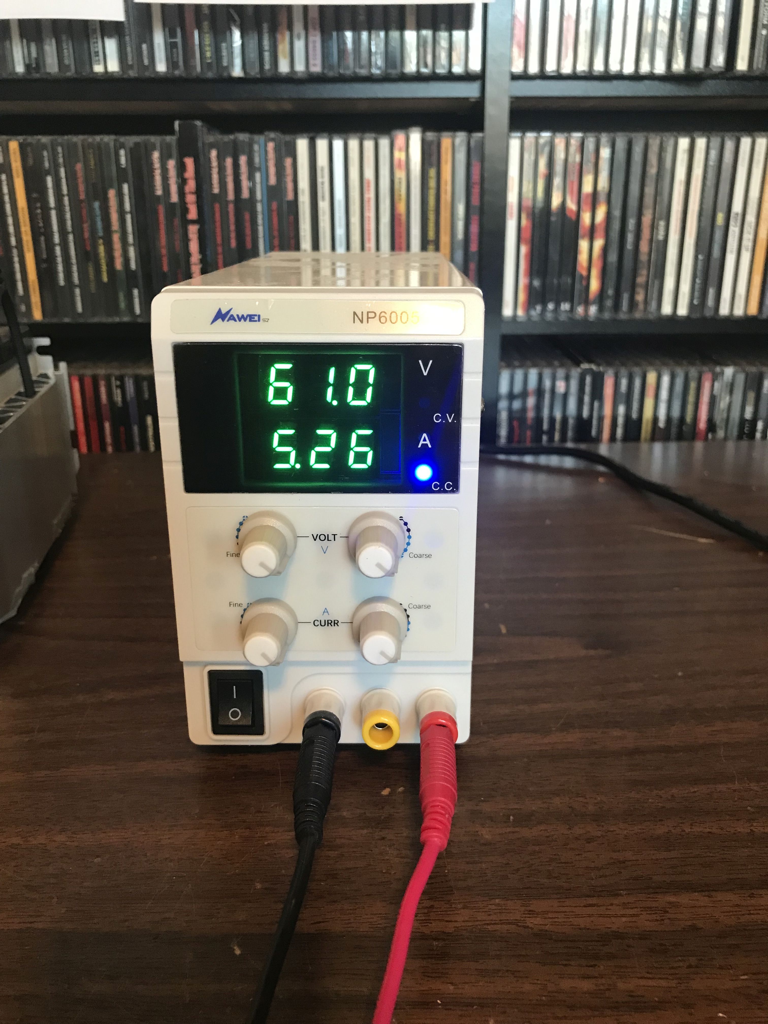

and finally at the max of what this PSU can put out, 5 amps DC
so one thing we notice is that when we crank this unit to the max on the amp dials (coarse and fine) it actually goes a bit above 5 amps

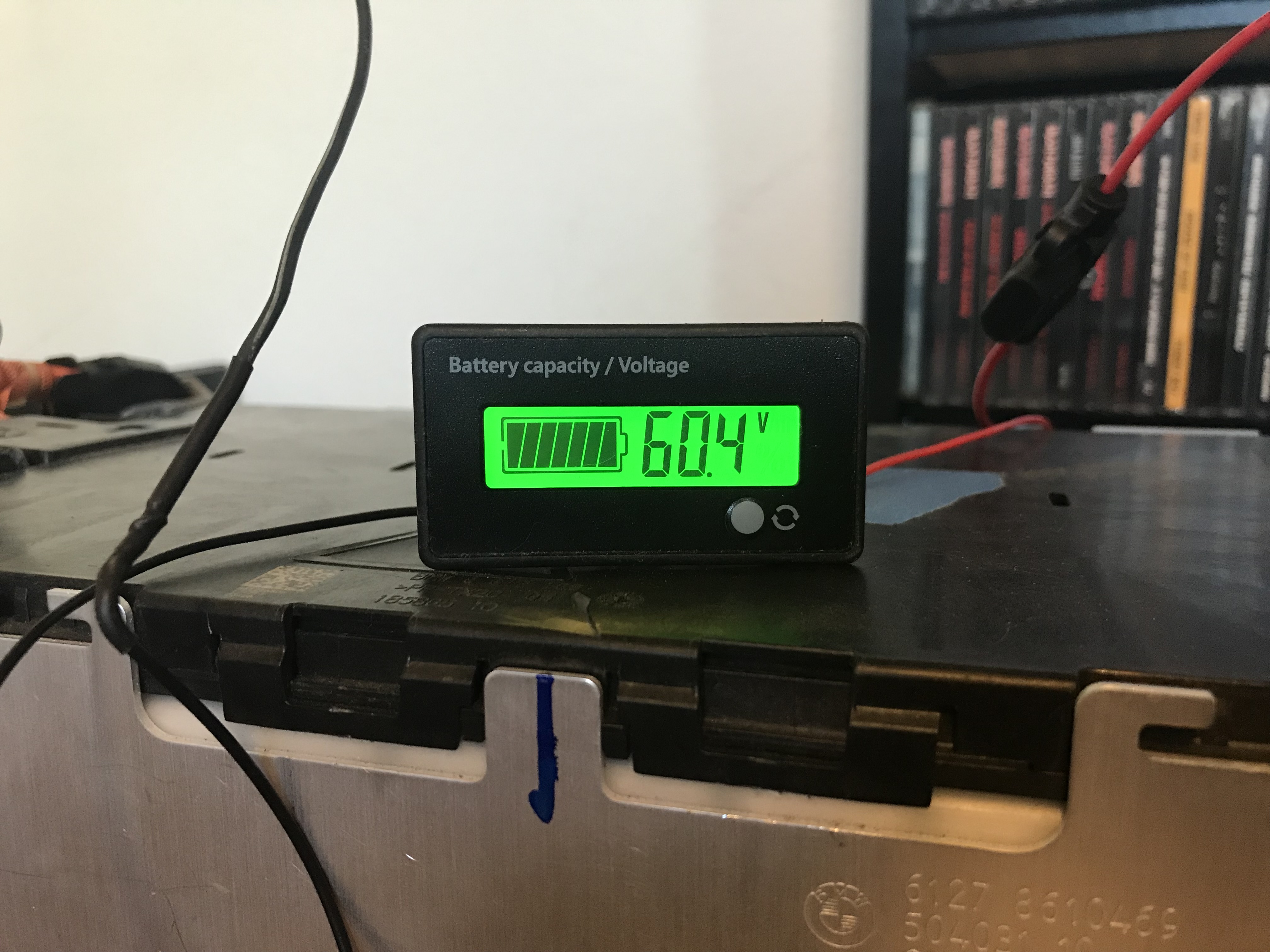

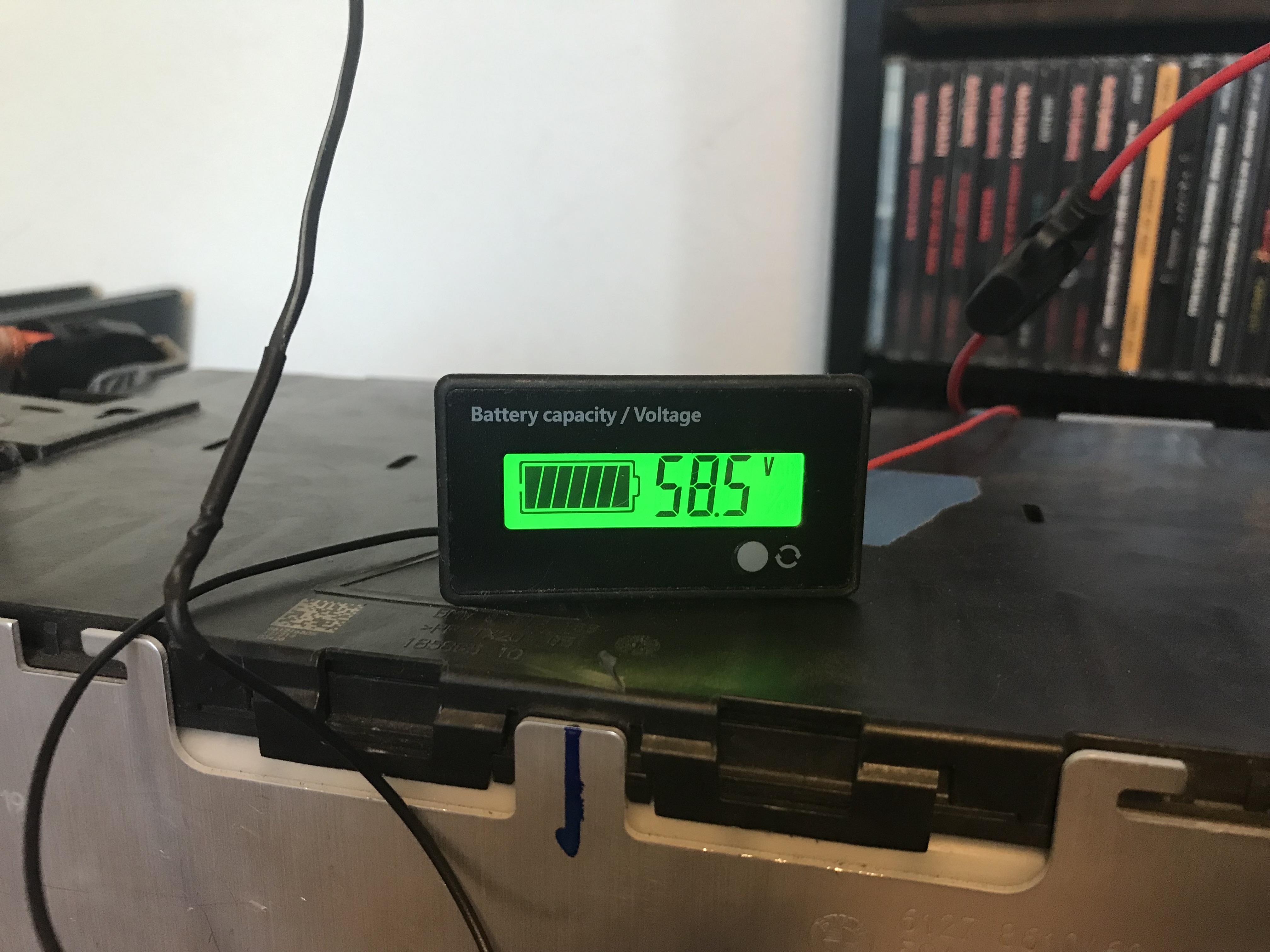

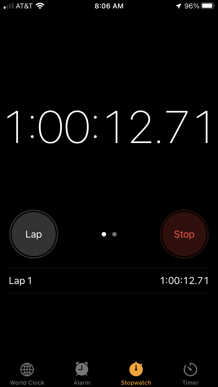

and here we are after charging for 1 hour

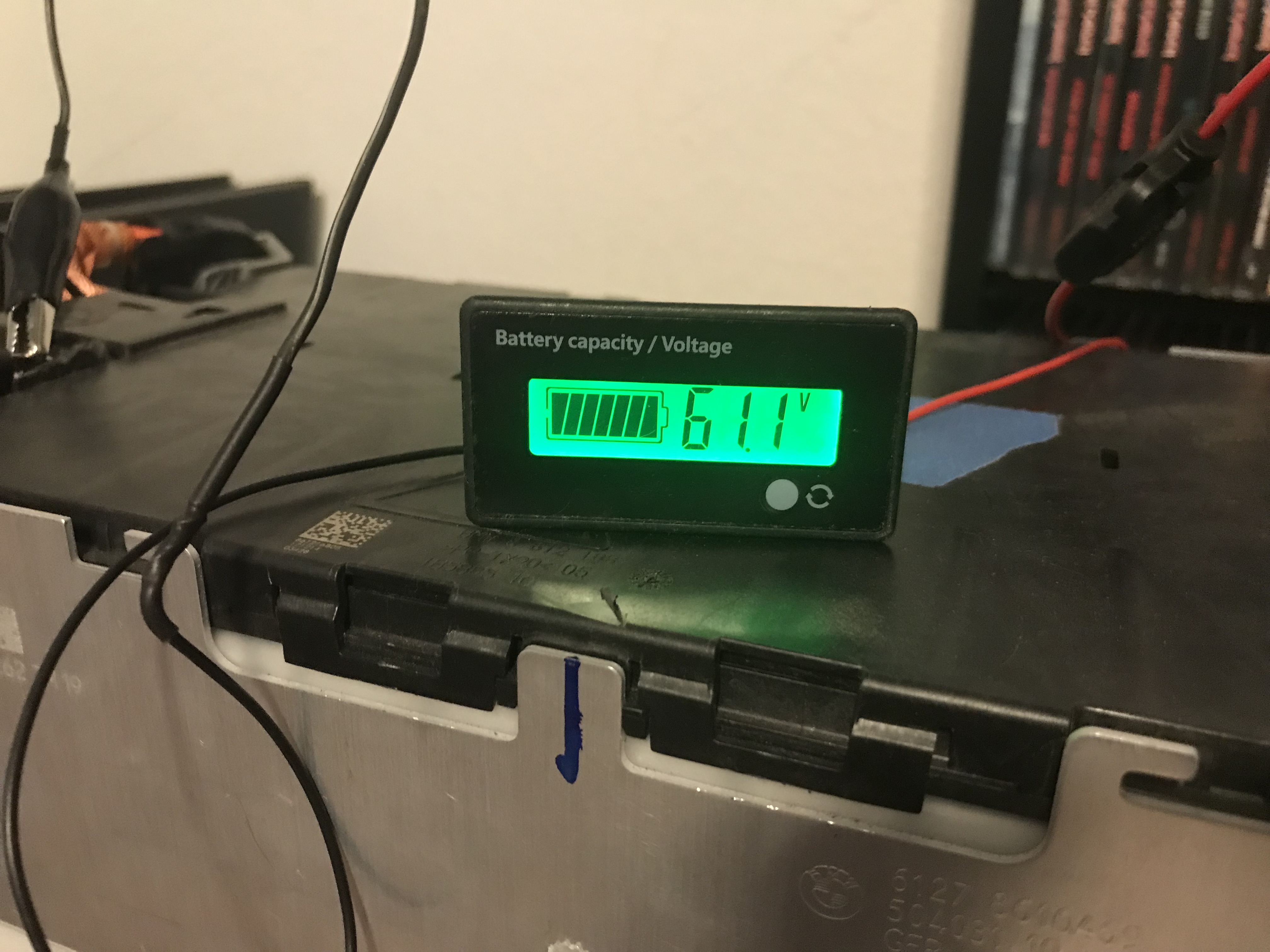

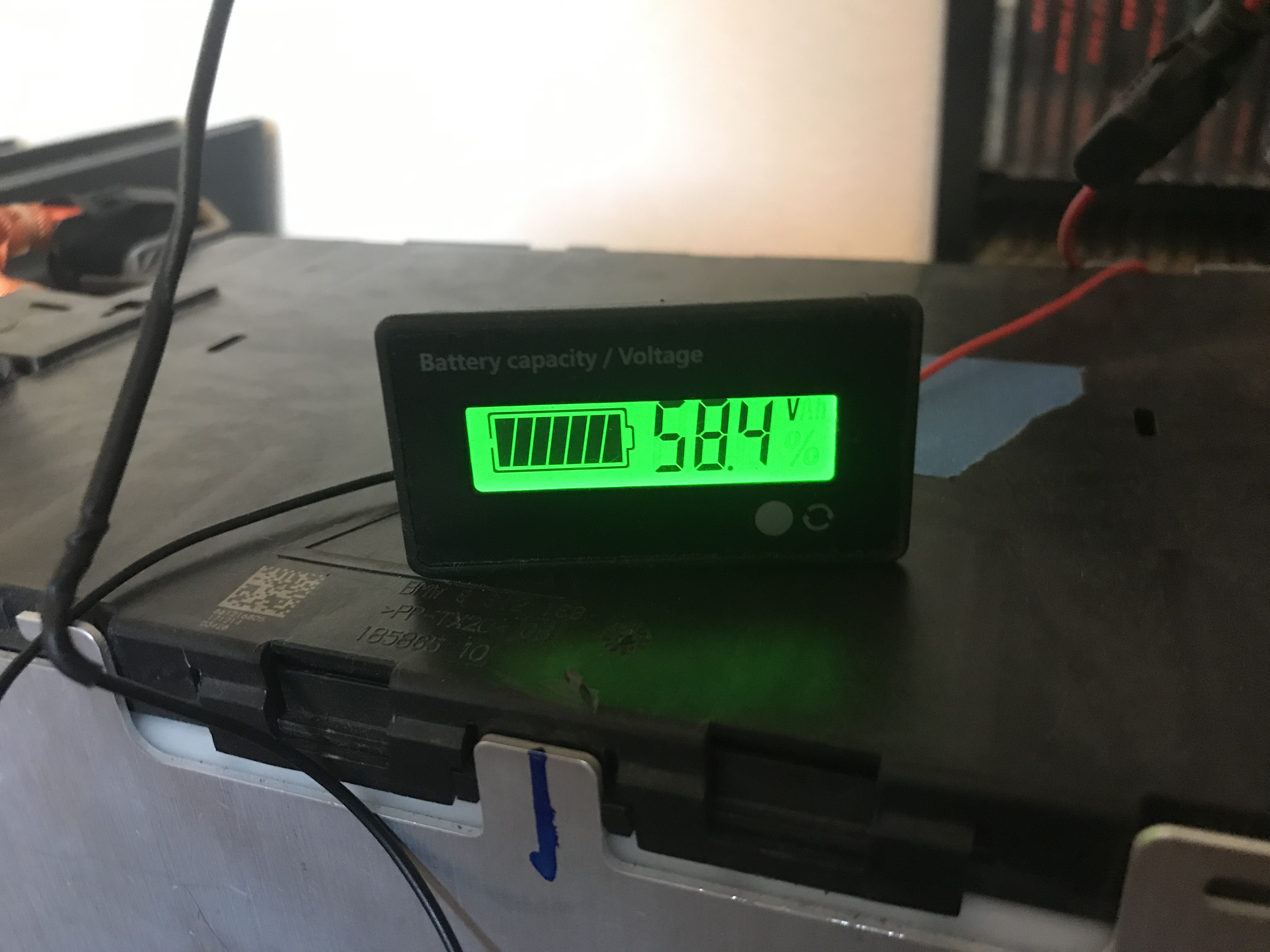

captured the current dropping gradually as the battery got closer to the max voltage this PSU could spit out

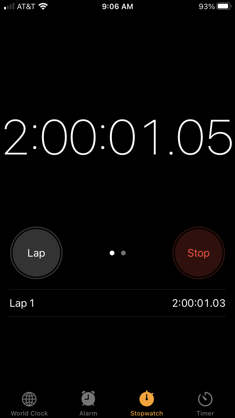

so this is where we were at the two hours mark

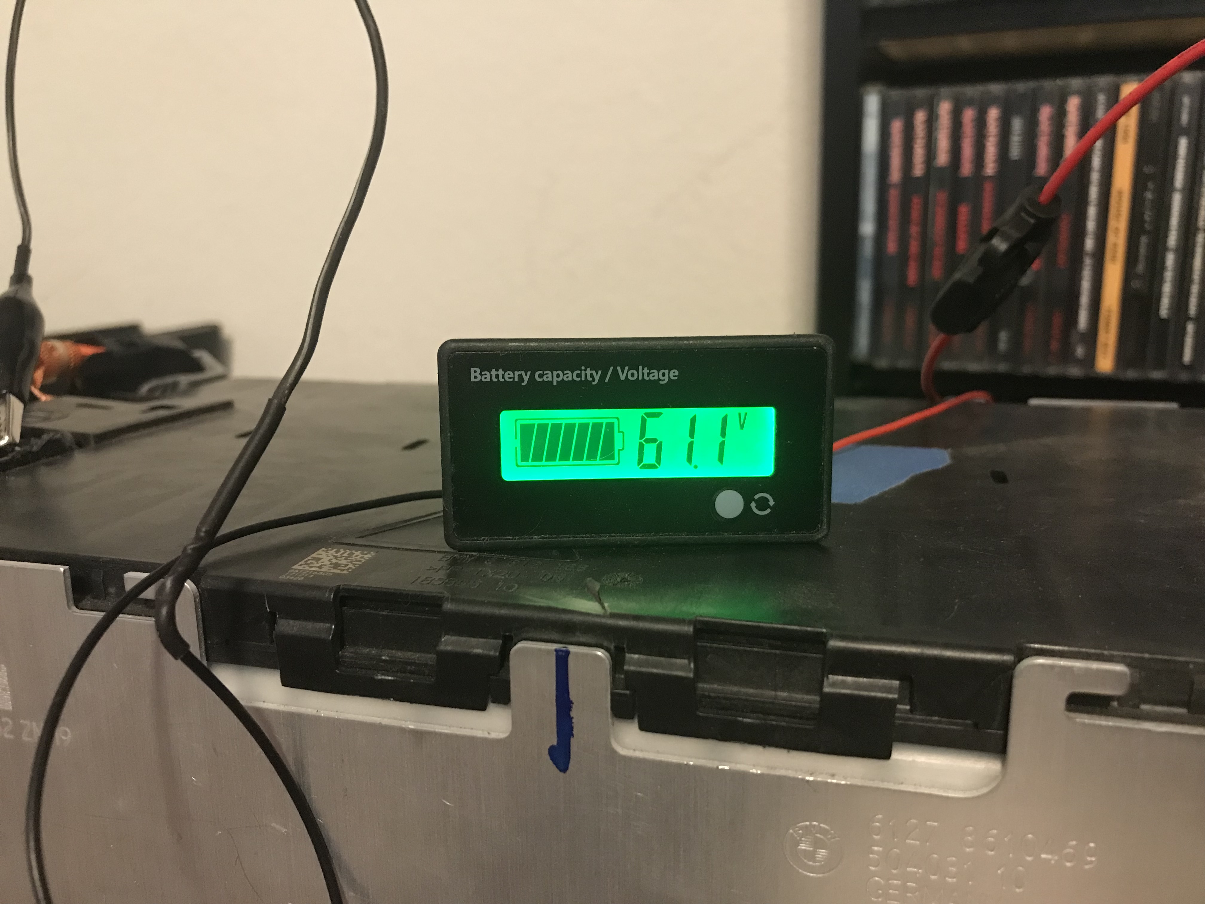

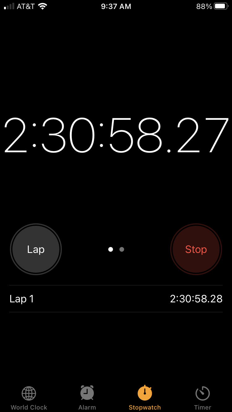

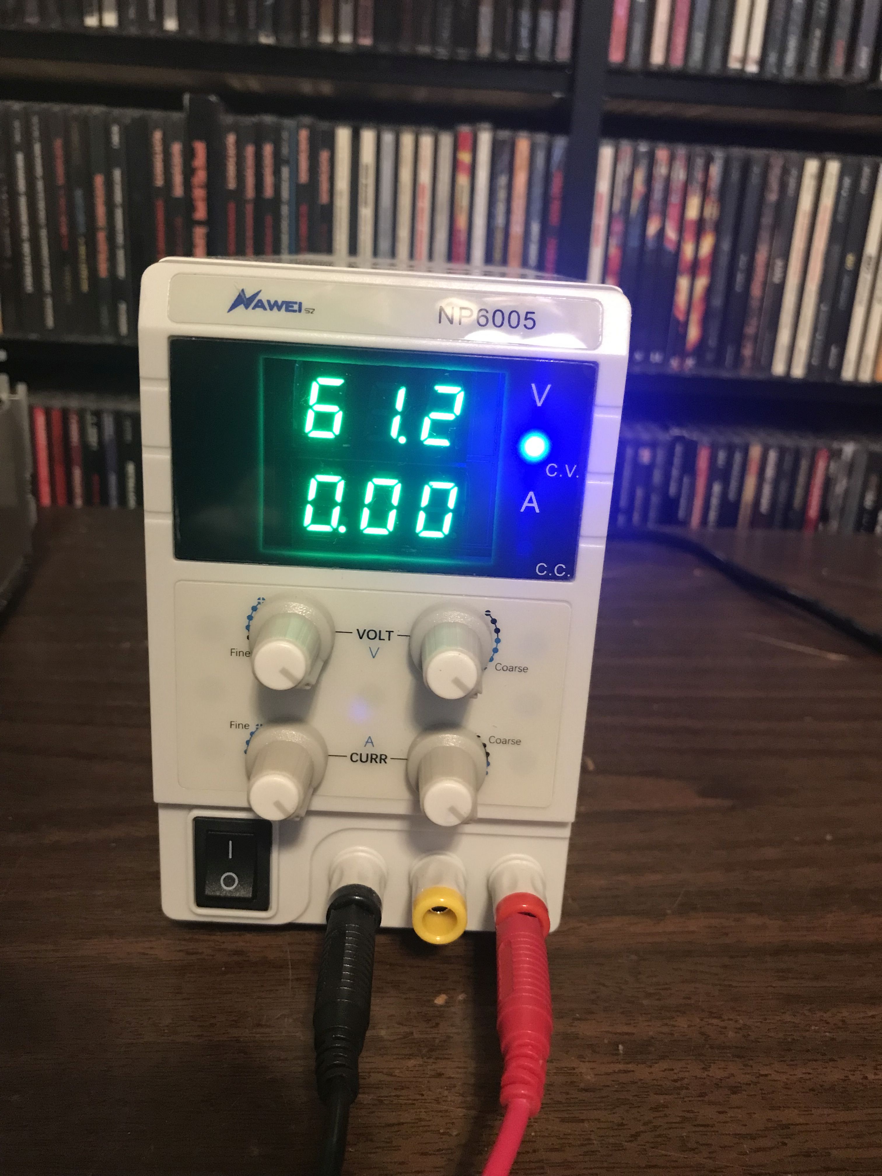

and I guess charged as much as we could to 61 volts after 2.5 hours
Gregski
Posts: 3158
Has thanked: 630 times
Been thanked: 1607 times
Re: Newb Asks: Can we charge a BMW PHEV single cell module with a bench power supply?
Post by Gregski »
so although technically you can charge using a bench power supply, the 60 volt unit is just not high enough to fully charge this cell module, if we go off that spec sheet we need to reach 66.33333333 volts to be fully charged or 4.145 volts per cell and we only reached 3.825 but it was fun and scratched an itch I had for a while to try this, thanks all for following along
and as far as in the truck charging I will either be using my Tesla Model S second gen charger or the first gen Chevy Volt one

Gregski wrote: Fri May 20, 2022 2:17 pm and finally at the max of what this PSU can put out, 5 amps DC

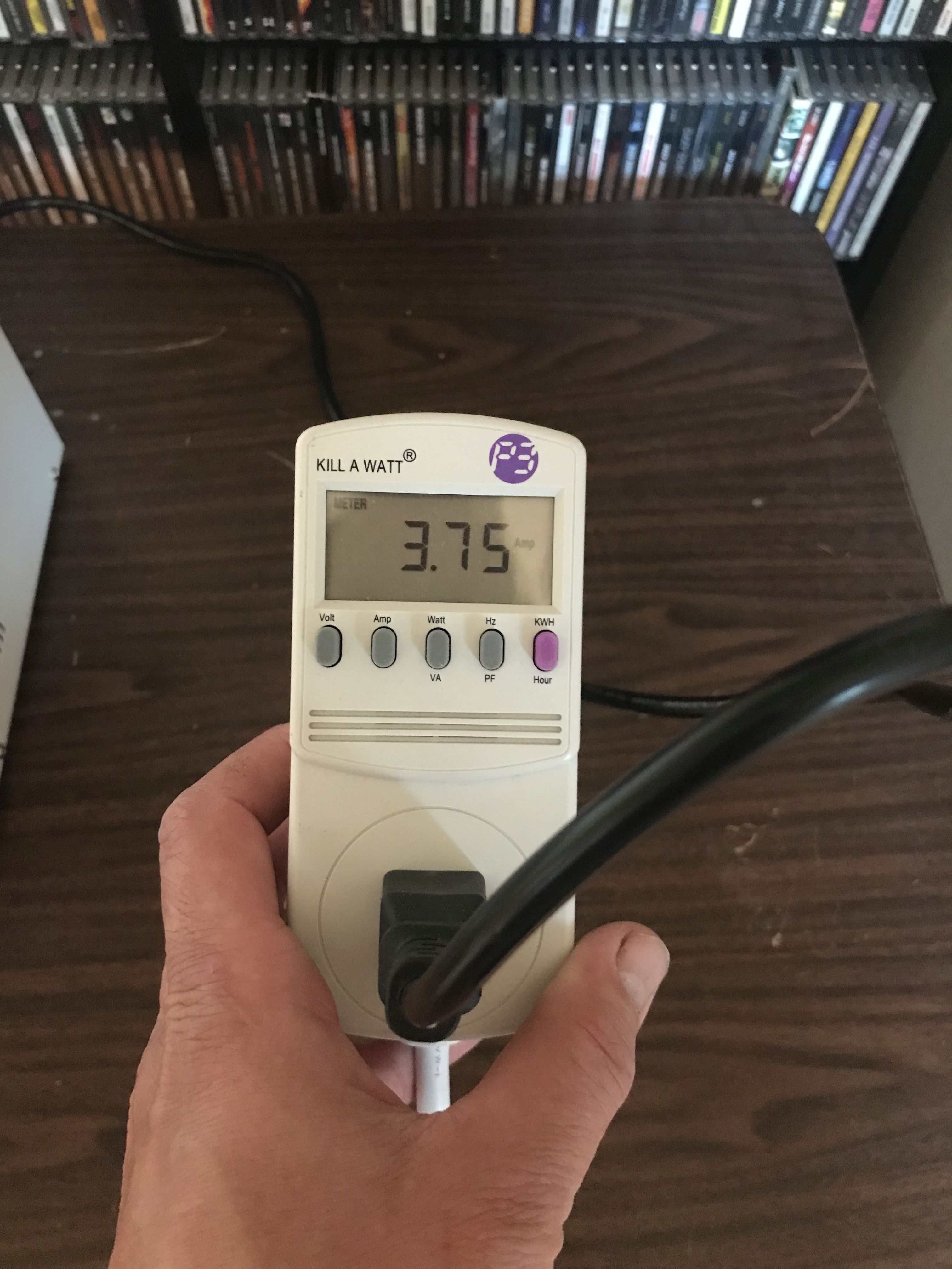

So the efficiency of your PSU is a little over 50%? 110v 5A in ~60V 5A out.
