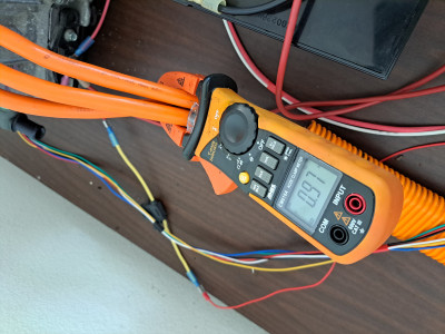

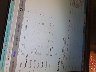

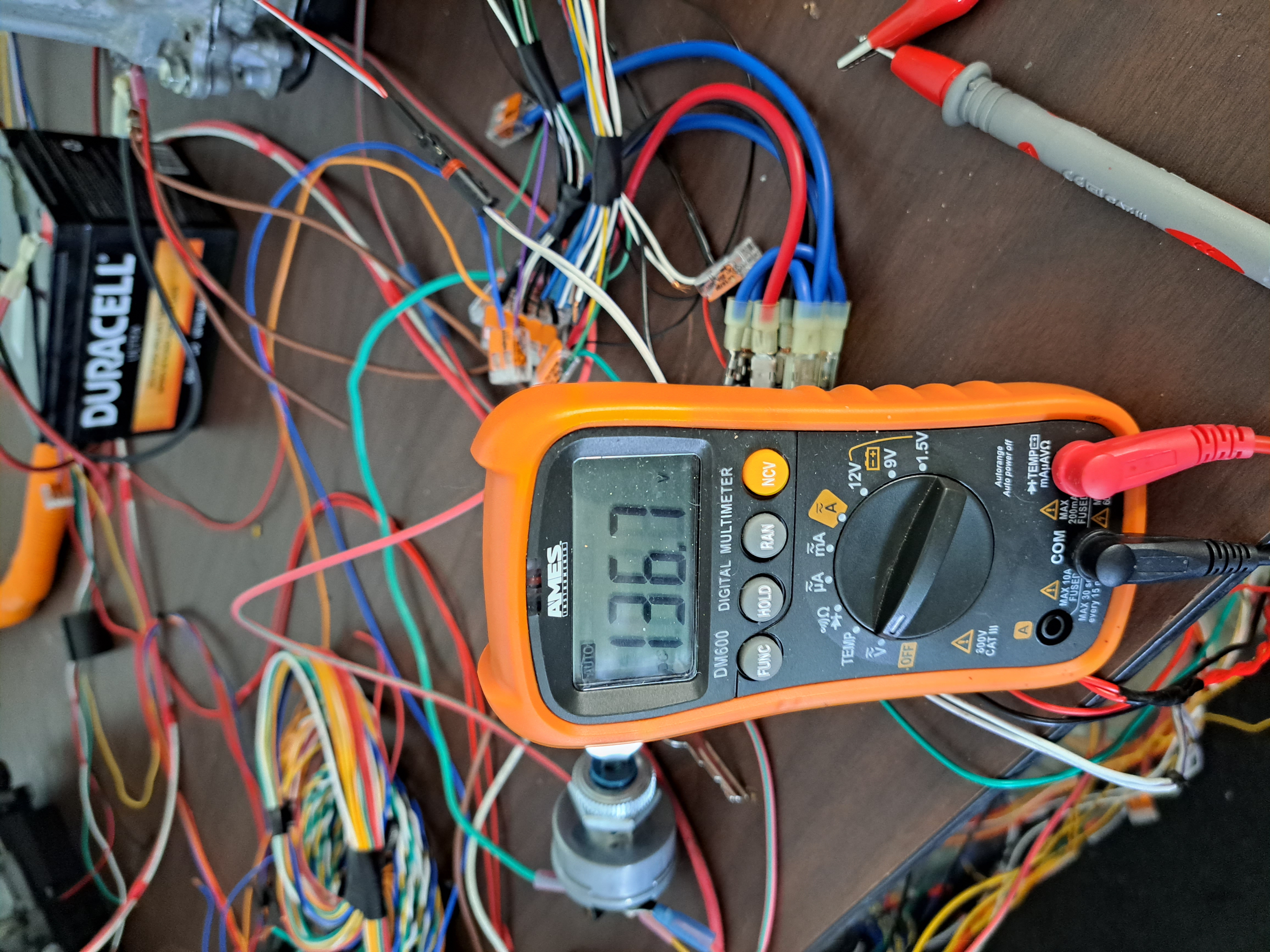

Re: 330e Hybrid Swap
Brought it back down to the 110v and I still get an overcurrent error. Pictures show conditions when it happens. Motor runs longer but still triggers overcurrent.
